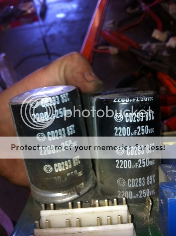

    Well needless to say I am a complete newbie to this type of stuff. I am a metal fabricator and my plasma cutter decided to explode. Upon further inspection I found that one of the capacitors had blown up. The Unit literally jumped off the ground about a foot when this happened. As I said I know nothing about capacitors, etc. . I looked through the FAQ and had a hard time trying to grasp what type these are and where I can find new ones.
    I really need help finding replacements as the manufacturer of the product is being unresponsive.
    CD293 85C 2200uf 250vdc
    Please help point me in the right direction

    Measure the diameter and height. Then select one of the Panasonics that will fit from digikey below. Shipping will cost around $3 USD and you should get the cap in 2 to 3 days.
    http://www.digikey.com/product-searc...20250v&stock=1
