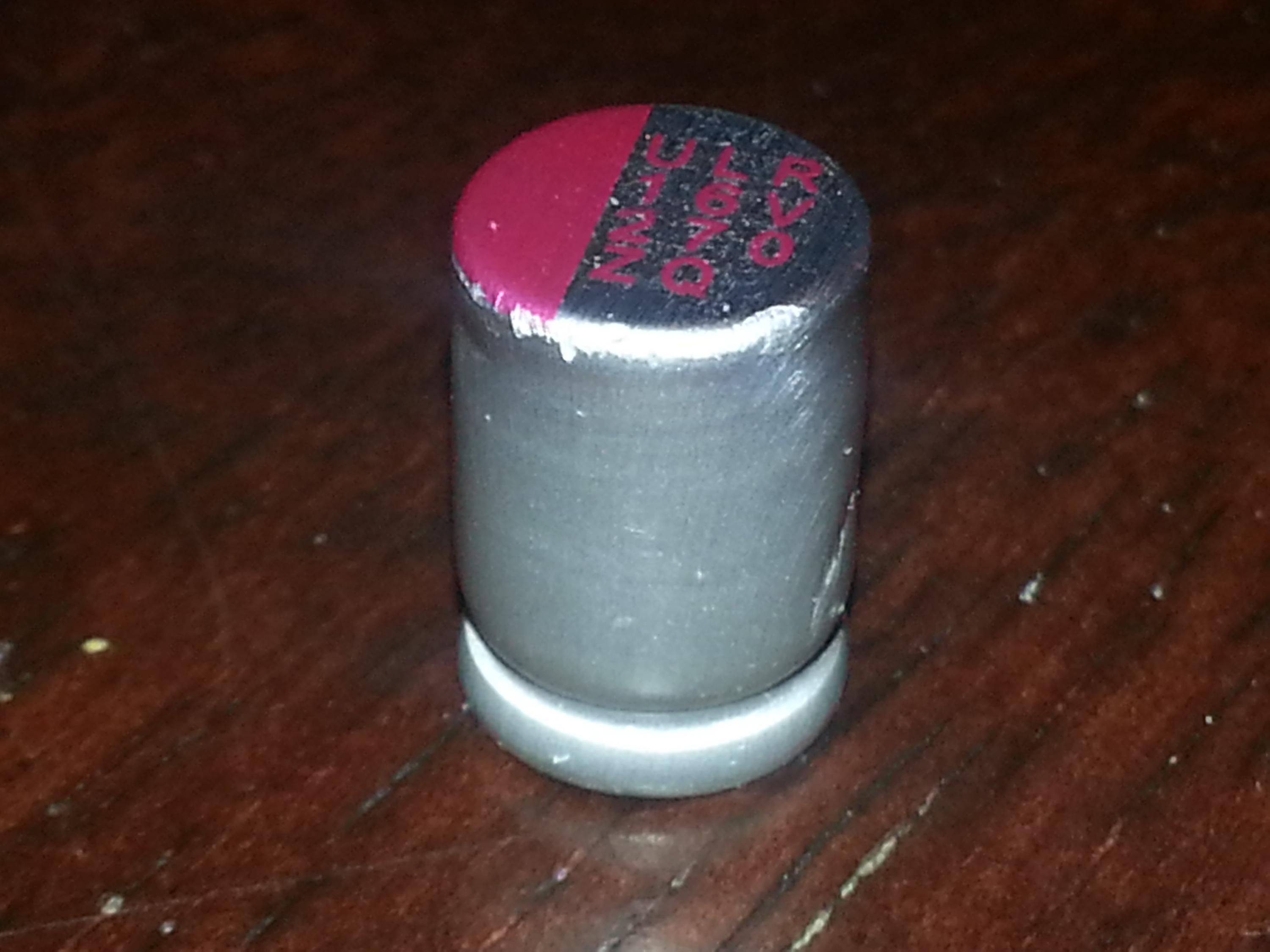

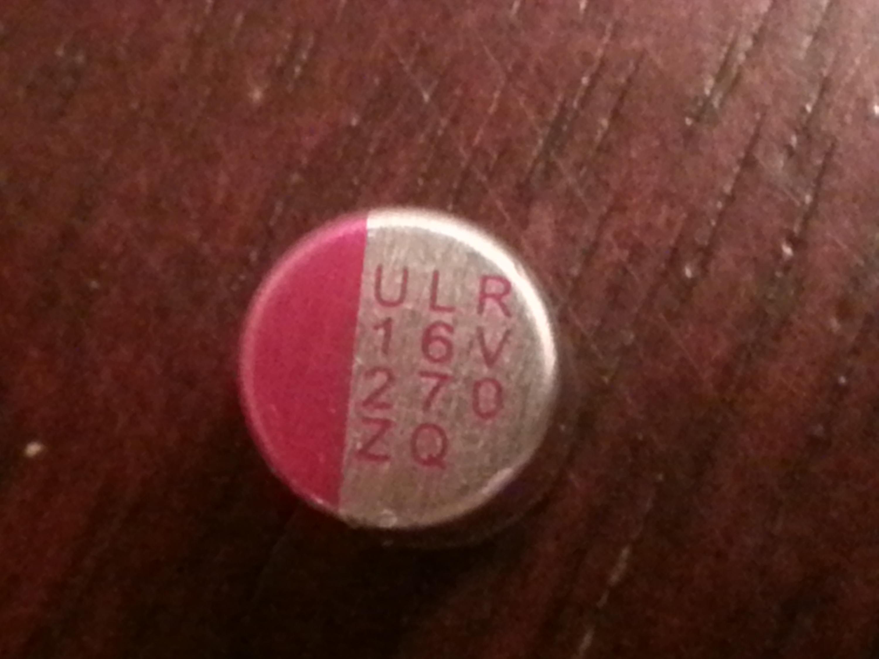

    I popped a cap tonight on my GTX 480 from EVGA. Changing cases and my after market cooler leaves a couple of caps accessible and my finger slipped and popped one. The 2 posts are still attached to the board but the casing is off.
    Info on the cap is ULR 16v 270u ZQ. I am looking for a replacement to order in hope that it help me find someone to repair it for me. If you have any suggestions on where to get repairs as well, I am up for any advice.
    Measurements are 8mm by 11.5mm with red and silver top. Can post a photo tomorrow if needed.
    Thanks in advance!

    Hi Volack and welcome. The capacitor is most likely a polymer. Without seeing it I would say its like the one in the pic here ?
    Unless one of the guys here have a better choice I would fit this
    http://www.digikey.com/product-detai...7-1-ND/2347917
    or this
    http://www.digikey.com/product-detai...018-ND/1136108
    As a replacement.

      Can you post a pic? ULR should be Samxon X-CON series... But usually they have some blue coloring, not red... Have never seen any problems with them before. What type of PSU are you using to feed the GTX 480?

            Re: ULR 16 270 ZQ replacement?
            Here are 2 pictures of the cap. The leads are still in the board as they separated from inside the cap.
            https://www.badcaps.net/forum/attach...1&d=1366859535
            Yes I am from the US and my experience is very little when it comes to soldering. Very minor stuff when I was a kid using a little 30w iron. Thanks for the suggestions on the 2 caps... the first one may just be a winner.

              Yes, those are certainly X-CON ULR.
              8x11.5mm 0.013 ESR 5000 Ripple
              The second cap is actually better rated and more economical.
