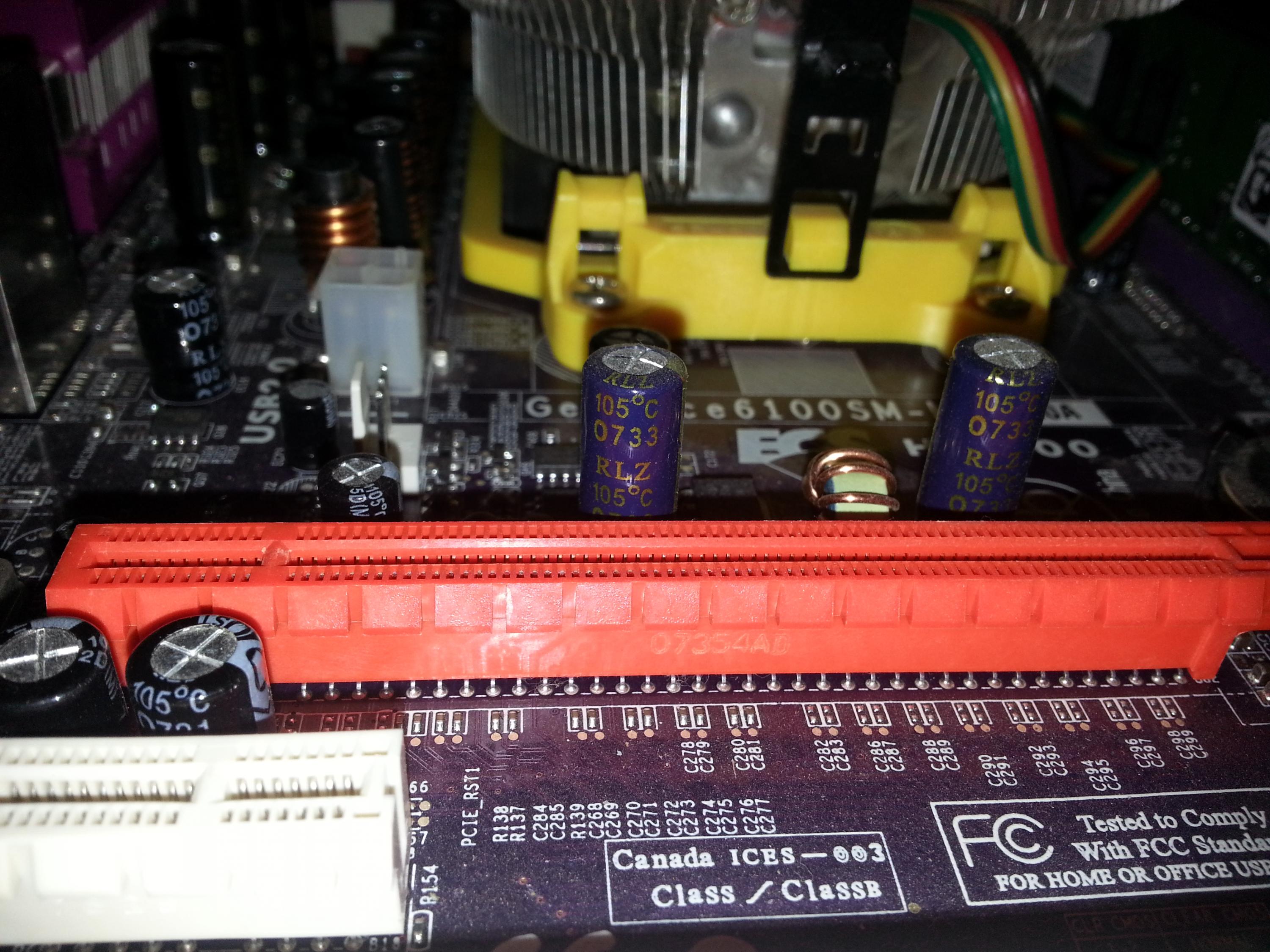

    ECS 6100SM-M | RLZ 0733 Identification
    Can you guys help me figure out what the specs on this is?
    ECS 6100SM-M
    RLZ
    0733
    105ºC
    There is 2 above the PCI-e slot and 2 buy the RAM slots.
    I already had to replaced the cpu power regulator caps with nichicon's 2 years ago. I like keeping this low power sempron system around.
    I found this thread but it references RLZ 0734 being OST 6.3v 1800uf. Think that's close enough?

    The capacitance and voltage will be printed on the other side.

      I will double check when I get home, but I'm pretty sure that it's just blue plastic wrap and the negative lead indicator.

        RLZ is the series name and 0733 is the date code. RLZ is a series made by OST and RLZ describes the internal properties. This cap was manufactured in the 33rd week of 2007. Look around the capacitors. You need to find the microfarad value (uf) and voltage (v) values.
