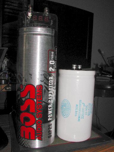

    A while ago I bought a 2F cap intending to use it as a spot welder. But when I got it, it was well below expectations. I don't have a meter that goes up to 2F but I found that it was around 220mF at most. ONE TENTH the expected value. It had a "snazzy" voltmeter on it but it was coming off for its intended application...
    I did not check its ESR yet, I didn't bother...
    It was BOSS branded.
    Anyone into high end car stereo and actually measured the capacitance in their caps? (I surely am not, but capacitors are capacitors ...)
    (Photographed: the 2F cap and a 220mF cap that I measured to be around the same in capacitance).

    That 220mF reading might be an artifact of your meter's measurement limitation. It may be that your meter recognizes the 2F cap as a cap, but is displaying the maximum value it can. Try charging it with a 1.5V battery through a 1K resistor, and see how long it takes to charge fully (the 10-20 M-Ohm internal resistance of your DMM should be irrelevant if you use a 1K charging resistor; OTOH, if you use a 10K or higher your charge time should be ginormous). With a 1K resistor the charge time will be pretty long, and the 2F cap should take 8X-10X the time for the 220mF cap.

      Yes, my Sencore LC meter tops out at around 200mF. I had to use another method which is pretty much what you suggest: I charged the cap with a power supply and counted how many seconds it took for a light bulb to extinguish during discharge. They both counted at around the same time so they are both around the same capacity -- which is way too small for 2F vs 220mF.
      I actually do have a constant voltage/constant current power supply, technically I could derive an exact capacitance by measuring the voltage increase over any fixed amount of time... But too lazy with accurately measuring voltage and time. Technically simply using CC/CV mode and timing how long it takes to get to 0 current flow should do it too...
