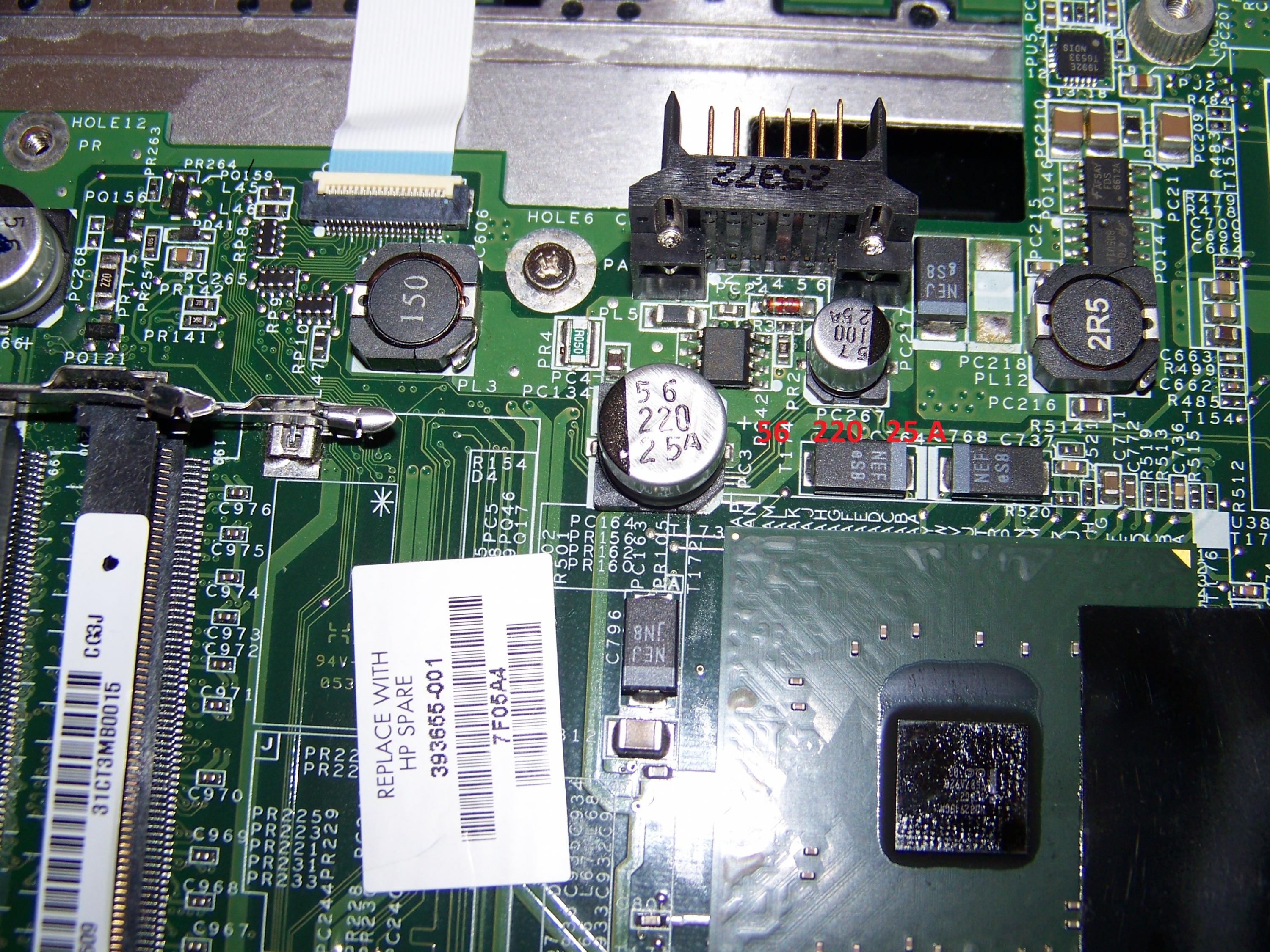

    Can someone please help me get the values of these capacitors I have posted. I believe one is 220uF at 25 volts. Please correct me or add your input. Thank you

    Re: Capacitor Identification
    Yes 220uf 25V and 100uF 25V. It's funny though that they would be 25V in a laptop motherboard.
      Its from an HP Pavillion DV 1000-I'm losing screen brightness-very low light. I switched the inverter board and it made no difference. Hopefully these new caps will work out. Thank you
          Looks like PL3 is cracked too.
              First--thank you for pointing that out-then--what is it. I see the crack--is that something that I can replace?? Thank you for your good eyes.
                PL3 and PL12 (the one with 2R5 written on it) seem to be both cracked.
                These are inductors - big coils of wire wrapped around a metalic or magnetic core. If they're cracked and it's not by design, they may no longer work as intended but rather as weaker inductors.
                PL3 is probably 150uH in value, the other one...I can't tell from the 2R5 code. However, you can't really replace it with any 150uH inductor, you need to know the peak current of that inductor (in Amps), the resistance (in mOhms)...
                It would be best to get a service manual for this laptop or another model from the same series, and see what the service manual lists for these.
