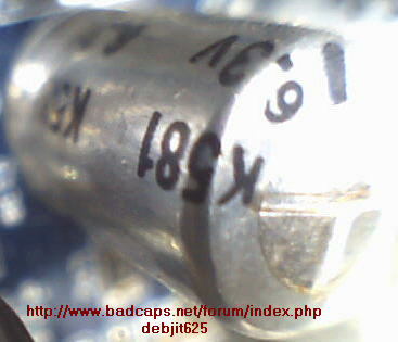

    Hi this is my first post...
    I was looking over a motherboard and I found some electrolytic capacitors, radial lead types having marking of "221 16V" I guess it is 220 micro farad 16 volt,but I never seen this kind of marking on an electrolytic radial lead capacitor PTH types,its very common on SMD electrolytic capacitors.
    Their are some more capacitors and their marking are like these "K581 6.3V" it may be 580 mfd and "K681 6.3" it may be 680 mfd.
    I can check them but I am asking you guys first...
    Am I correct?

    Best guess.
    220uF 16v
    680uF 6.3v
    There is no standard [industry requirement] for the marking method.
    They can use any method they want on any kind of cap.
    At first direct printing was least expensive way.
    Then using sleeves became less expensive.
    Now direct printing is cheaper again. [More advanced printers.]
    ~ But most factories are already set up to support using sleeves.

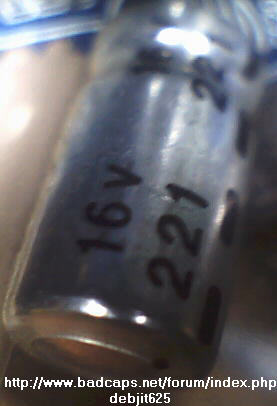

          Re: Marking on electrolytic capacitors
          I'd be interested in seeing a photo, never heard of electrolytics using 3-digit codes before either
            Common on ink marked caps.
            Also very common in the part number in the data sheet.
            Like so
            R33 = .33 uF
            3R3 = 3.3 uF
            330 = 33 uF
            331 = 330 uF
            332 = 3300 uF
            See Part Number column.
              It's a running motherboard with no problem ,so I don't want to desolder the capacitors.
              Some how I managed to take a few photo while they were on the board...
              Its a Zebronics motherboard old 845 chipset (GMCH) with P4
              http://www.zebronics.com/
              As I am learning to repair motherboards ,I just gave a look on it for better understanding of older motherboards.And I found it weird...

                Well if they look like the ones in your photos then it does have a problem, and it won't be running for much longer
                Like so
                R33 = .33 uF
                3R3 = 3.3 uF
                330 = 33 uF
                331 = 330 uF
                332 = 3300 uF
                But yeah, I've never seen aluminium can electrolytics without sleeves marked with a code rather than straight values like that before - you certainly do learn something every day!

                  I think both have issues.
                  The second is obvious, swollen... replace it. I think that one's 580uF 6.3v.
                  The one in the first picture looks to me like it's bottom is coming out, maybe inside gasses pushing it outside.. if so it's going bad so you should replace it.
                  If you want, post one or several pictures of the board, maybe our eyes can spot other possible issues or faulty capacitors.
                  Also keep in mind that if that capacitor is swollen chances are the ones in the same area were also abused in the past and on their way out, so you may have to replace others even if they look good.

                    Yes I know their is a problem with the second one but the first one seems all right, but again ESR can't be guessed by just looking at the capacitors so I will check them...
                    No it has been soldered like that, I have already checked it. I think the manufacturer did that mistake, but the board is good enough as it’s giving a service of 4 + years .
                    I just found the marking weird, so I thought may be only I don't have seen something like this before, but now after all your replies I am sure its weird...
                    Anyway when I will replace them, I will check the values of the capacitors and confirm it on this thread.

                              If you can show some pics of the board and where the caps are we can guess what ESR grade they need to be.
                              [Probably nothing fantastic anyway given their size.]
                              580uF is a weird size. You won't find it in a 'good brand'.
                              I'd up it to the next standard size. [680uF]
                              Lacking more info....
                              In general FC, PW, KY, LXZ or similar is fine for the 220uF 16v.
                              The other one 'might' actually need to have decent ESR so I'd use an FM or FR just to be on the safe side.
