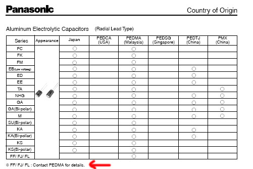

    ask your vendor to provide spec sheet for FL and we can compare. It is not listed at Panasonic site.

      hahaha bingo, finally found something official about FJ

        It appears that FJ and FL are made in Malaysia.
        Older ECS NF4 754 boards come with Matsushita FLs, while newer units are equipped with Chemicon KZJs. Perhaps the KZJs may be the better choice? No chance of getting specs for ECS.
        I'm not sure if the KZJs are made in Japan anymore.

            So there are real Panasonic FF and FJ? It still smells fishy, but I've seen a lot of these around now. No mention of HFA, though. It also shows FC and FK as being made at both Japan and Malaysia, so that may account for the quality variations - though I haven't seen a single failure in either.
            I'm just guessing - the ones with the fine, shallow scorings on the T-vent are Japanese, while the ones with the wide, deeper scorings are Malaysian. I've seen the former types in original Technics equipment sourced from Japan, so they're probably Japanese.

              yes it is an official panasonic document
              it is indeed rather irregular. i guess FF, FL, FJ are for asia market only. perhaps they are sold at cheaper price also. we are starting to see panasonic more on motherboards so it looks like they have become more interested in that sector.
              there is a possibility that they could have been designed in malaysia also, they do have R&D dept there. but if you check the PEDMA site they only have 3 chip type electrolytics on offer there?
