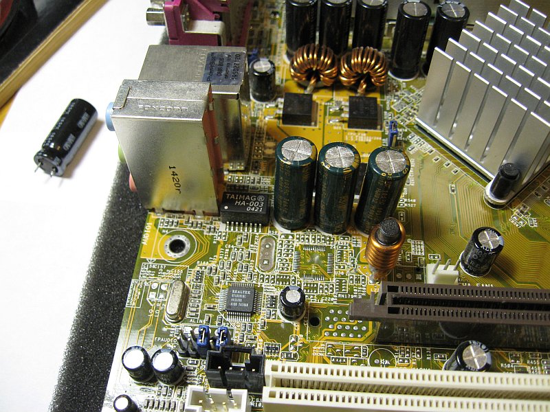

    Greetings,
    I've got Asus K7N8X-X motherboard. It has popped capacitors in the Video Card area. They are Nichicon 6.3V 3300uF 105C HM Series H0345.
    I don't really need this motherboard, but I still want to recap it. I've got Nichicon 16V 3300uF RS Series H0912. They look exactly the same, only difference is HM were black and these new RS are green.
    So my question is whether RS is a good replacement for HM. I know they may be not military spec but that's all I could find for 3300uF
    Thanks!

    Nichicon HM is a low-ESR capacitor. RS is general purpose. So, no RS is not a good replacement for HM.
    Nichicon HM has the following specs for ripple and esr, which are important when selecting a replacement motherboard capacitor.
    ESR: 12 mΩ
    Ripple: 2800 mA
    When selecting a replacement, you want a cap with the same or less ESR, and the same or more ripple. RS 16V 3300uF only has 1460 mA ripple, and are much larger than the HM so they may not fit.
    According to the datasheet, RS 16V 3300uF are 18x15mm in size. HM are 10x25. If your RS are the same size as your HM, they may be counterfeit.
    It just so happens that the owner of badcaps.net sells Rubycon MBZ in the right value and are a perfect replacement:
    https://www.badcaps.net/store/produc...products_id=30
    Nichicon HM from before 2005 had a manufacturing defect causing them to fail. Your capacitors are from 2003 (H0345 = 2003, week 45). Given that your capacitors are from the time when they were known to be bad, be sure to replace all the HM on the board. Even those that have not failed yet may do so at any time, or may have failed internally without showing any external signs.

      New stock HM is also a good replacement for the older, defective HM on your motherboard.

        Elaboration.
        Nichicon HM and HN made from 2001 thru 2004 were defective.
        The "H0345" makes yours from week 45 of 2003 - they are bad.
        Simply getting new ones of the the same would fix it.
        Sanyo WG, Rubycon MBZ or MCZ, or Panasonic FL or FJ will also do it.
        You should be able to get Rubycons right here.
        https://www.badcaps.net/pages.php?vid=22
        Beware of eBay. Lots of counterfeits there. [And I mean LOTS!]

            So basically I have to resolder all caps on this motherboard No, not worth it - it's just an old socket A. In fact I already put these fake RS Nichicons on it. I got them at Sayal, it's a pretty famous store for components in Toronto area, I didn't expect them to sell fake capacitors. Oh well, never stop learning I guess...
            According to Nichicon Datasheets RS series has to be fat and short (18x15mm), when mine are skinny and tall (10x29mm). Also, RS only goes to 85 degrees, when mine say 105C. So they are 100% fake, Nichicon doesn't make these capacitors. Buyer beware!
            Attachment: In the top part you can see original HM series (not bloated yet), in the centre - fake "Nichicon RS" series.
