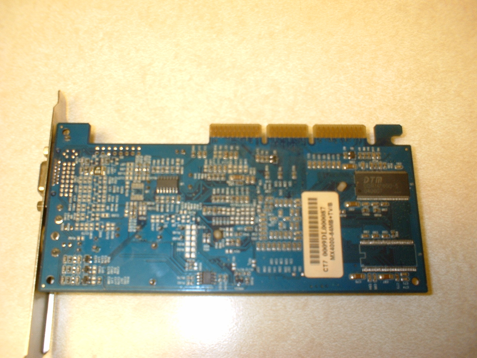

    Hey guys awesome forum. Found this site looking for info on a tv that died and figure why not ask about my card also.
    I have a apollo mx4000 that stopped working long ago that had swollen caps. I don't remember exactly what it would do but i'm thinking it wouldn't even show up or would give an error at post.
    After reading here i see there are more to caps than i thought. I never even knew they were made of different materials. I was wondering if you guys/gals could help me chose what caps to buy as replacements since i have to order some for my tv today?

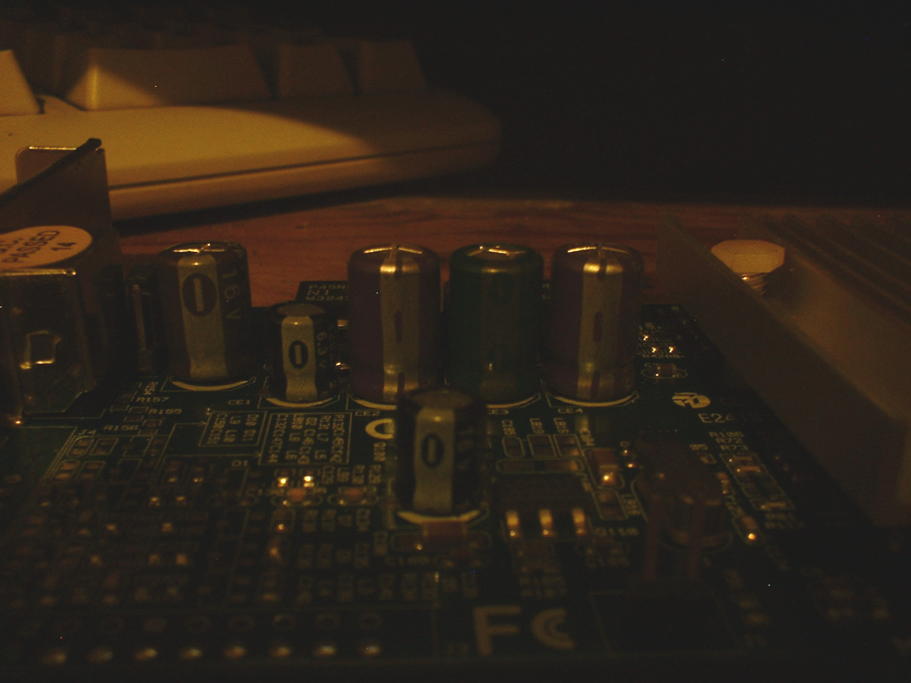

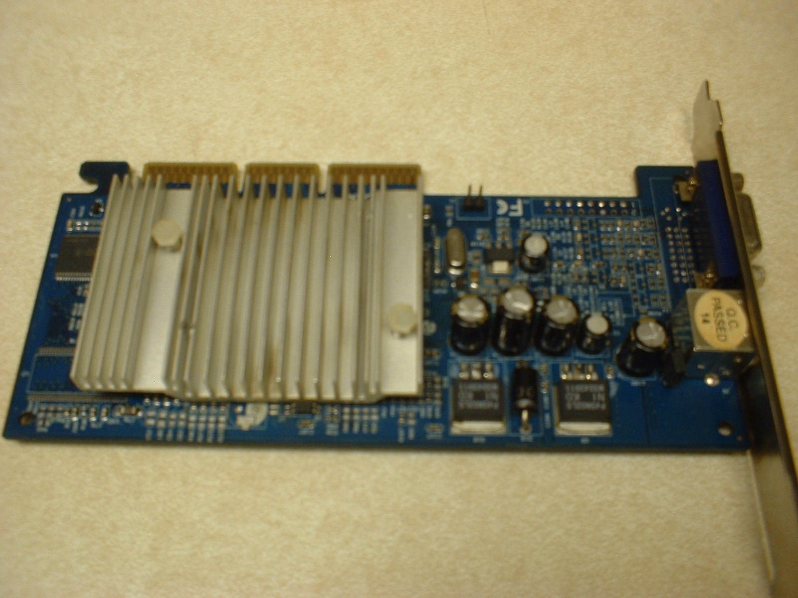

    Here are the ones i took off of it.
    Rifeking 1000uf 6.3v other side says vent -40-105°C
    leg space is ~3mm and can is 8mm wide x 12mm long
    Rifeking 470uf 16v other side says vent -40-105°C
    FZ 10v 680uf other side says 105°C R6A
    R.K. 220uf 6.3v other side says -40-105°C
    leg space is ~2.5mm and can is 6mm wide x 8mm long
    Sorry for the bad pic.

    For the 1000uF Rifeking Caps, use these
    For the 680uF FZ Caps, use these(note that they are a bit longer but they will work, you may not be able to use the next PCI slot)
    For the 470uF Rifeking Caps, use these
    For the 220uF RK Caps, use these
    Yes, it is OK to change the voltage as the rating is simply the maximum the cap can handle.

      Well i replaced all but the 220uf caps and nothing. PC won't even try to boot with the card in. I think it may be a lost cause.

          might help if pics were in focus ;-)
          • junktv
            • Nov 2010
            • 3063
            Re: Replacement cap help nvidia mx4000
            Ya they are bad as all get out but it's an old fuji a200 and these kind of pics are not really in it's range. Really close it does great and far away not so bad. If you can tell me how to fix my phone after the OS crashed and burned i could try with it. Since it's not recognized by usb it seems bricked though.
            I could borrow a better cam if it would help but visually i don't see any thing wrong.

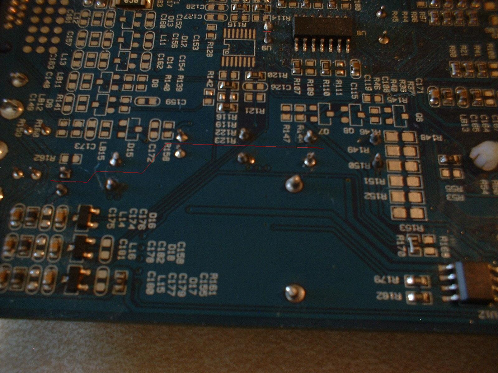

                • shovenose
                  Send Doge Memes
                  • Aug 2010
                  • 6575
                  can you take close up pics of your solder job?
                  • junktv
                    • Nov 2010
                    • 3063
                    I can but i would rather show one of other ones. This one is ugly with a bit of over solder. Using solder that measures .039" and it has tiny ports(?).
                    Batteries are charging so will be in the morning but i'll post them.
                    • junktv
                      • Nov 2010
                      • 3063
                      Here is a pic of the soldering. I'm not a pro as you can see but do better on on bigger boards.
