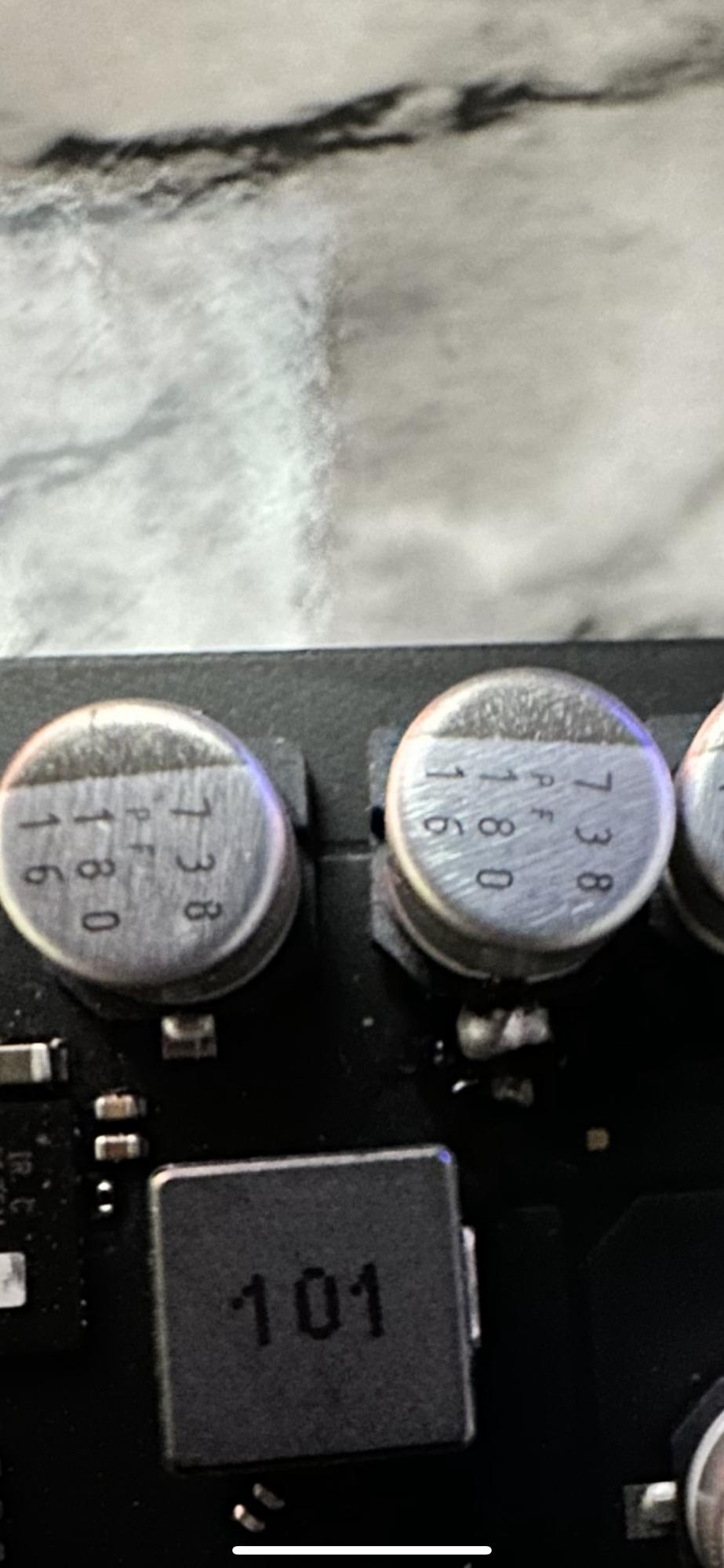

    How do I read this Capacitor or where do I buy this one
    I am attaching picture of the capacitor that came of from apple motherboard need to order replacement, can anyone suggest how do I order this capacitor or equivalent capacitor?
    Thanks in advance…
    • 31170
    Re: How do I read this Capacitor or where do I buy this one
    180uf 16v PF series.
    now you need to find who makes it.
    • kiransband
      • May 2023
      • 8
      Thank you very much for your response, do you know what is 738 stands for ?
      also somone from this forum suggested this
      hope i can used that as a replacement.
        • 31170
        probably 38th week of 2007 datecode
        • kiransband
          • May 2023
          • 8
          Oh Ok Thank you, please let me know if i can use this as a replacement.
            • 31170
            probably good,
