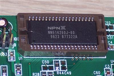

    SOIC
    Stands for Small Outline Integrated Circuit. Looks like a DIP, but way smaller and surface mount. Used in tight spaces.

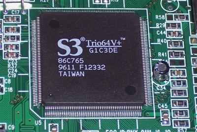

    QFP
    Stands for Quad Flat Pack. It's a large chip with legs on all four sides and SMT.

    Your SMT devices are both "J-lead", i.e. the leads bend outward. Gull-wing (IIRC) leads bend inward, under the device. SOIC packages are often identified by the number of pins, e.g. SO-8, SO-14, or SO-16. I've seen some power MOSFETs in SO-8 packages.
    There also are BGA, "Ball Grid Array", parts, which have an array of little balls of solder on the bottom; you have similar little solder balls on the PBC, and the solder is reflowed for installation.
    On the small side, you may find reference ICs in SOT-23 packages, and op-amps or comparators in SOT-23-5 (5-pin) packages.
