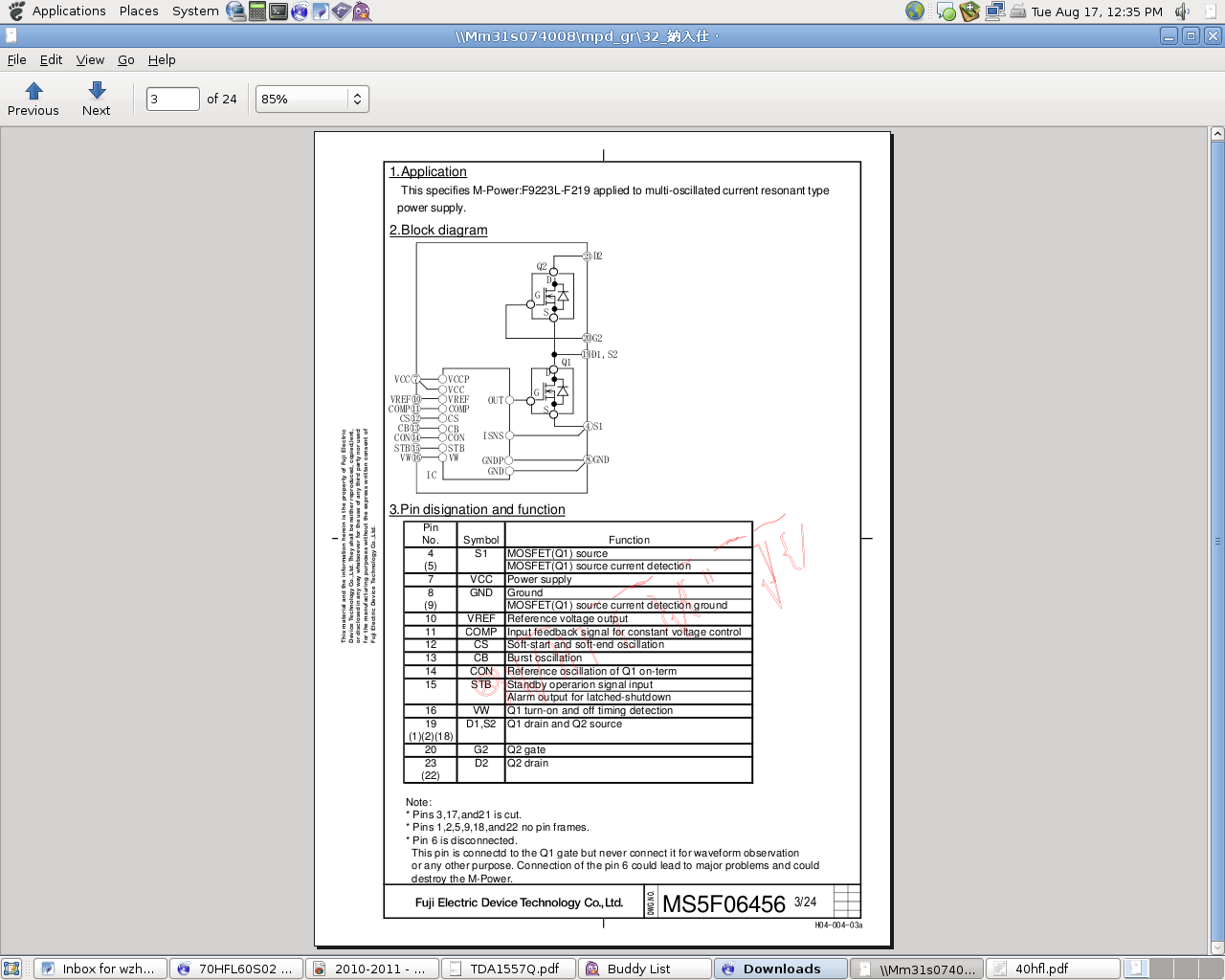

              Just found this chip's block diagram on internet, see attachment1. I measured pin 20 and pin 19 with a scope, see attachment2&3. It seems the IC is modulating output voltage at full duty cycle, but output still too low.

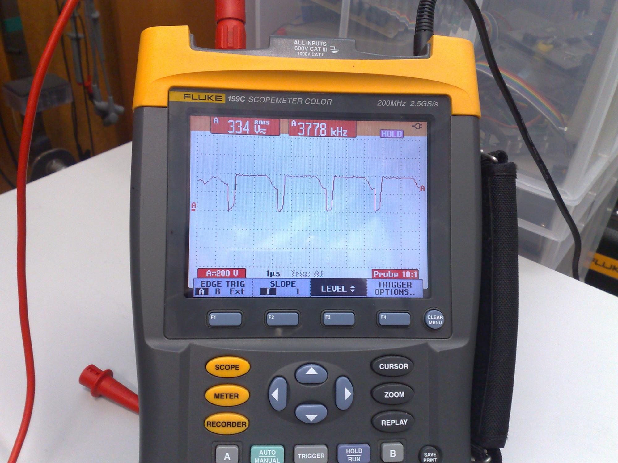

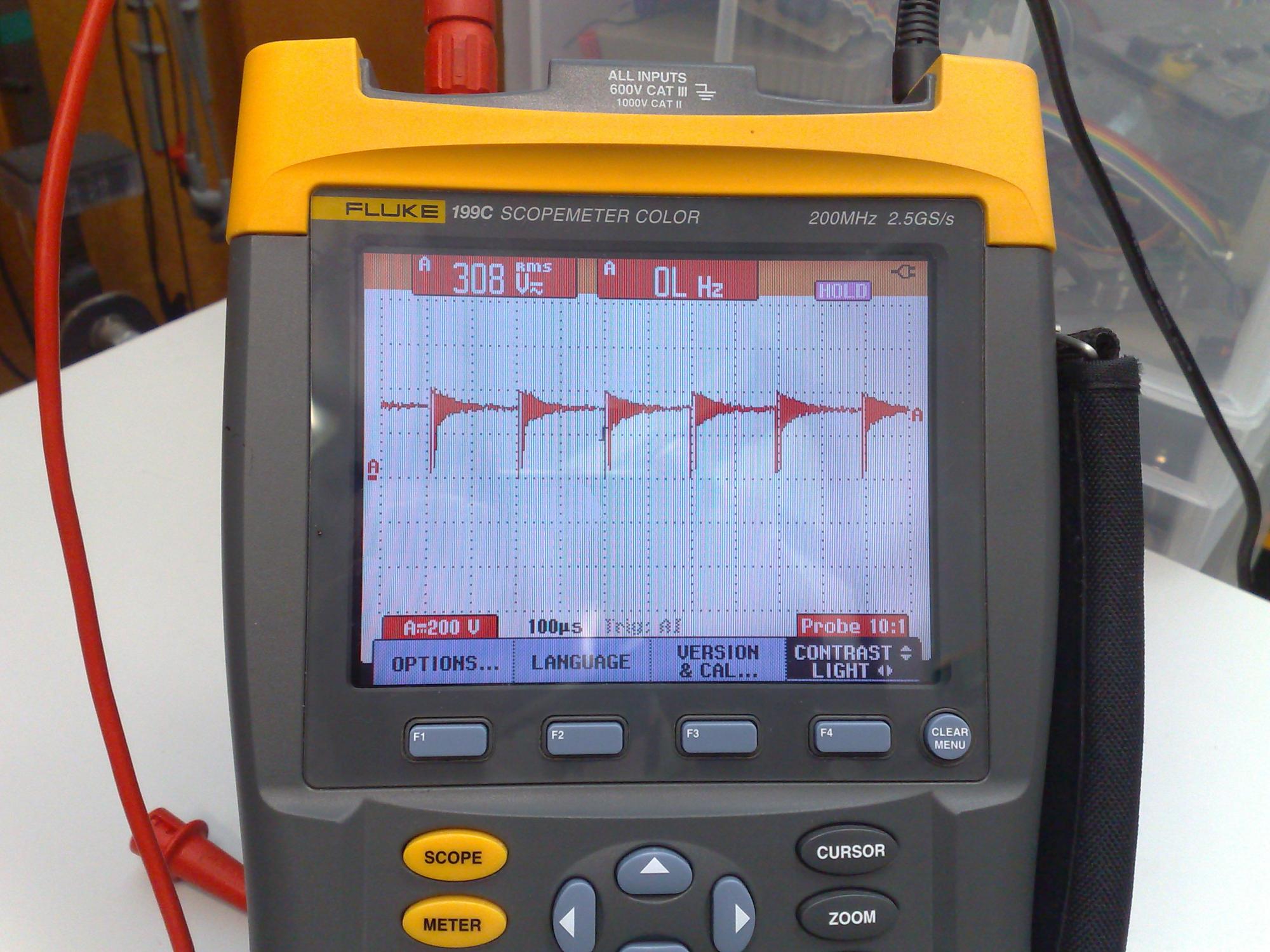

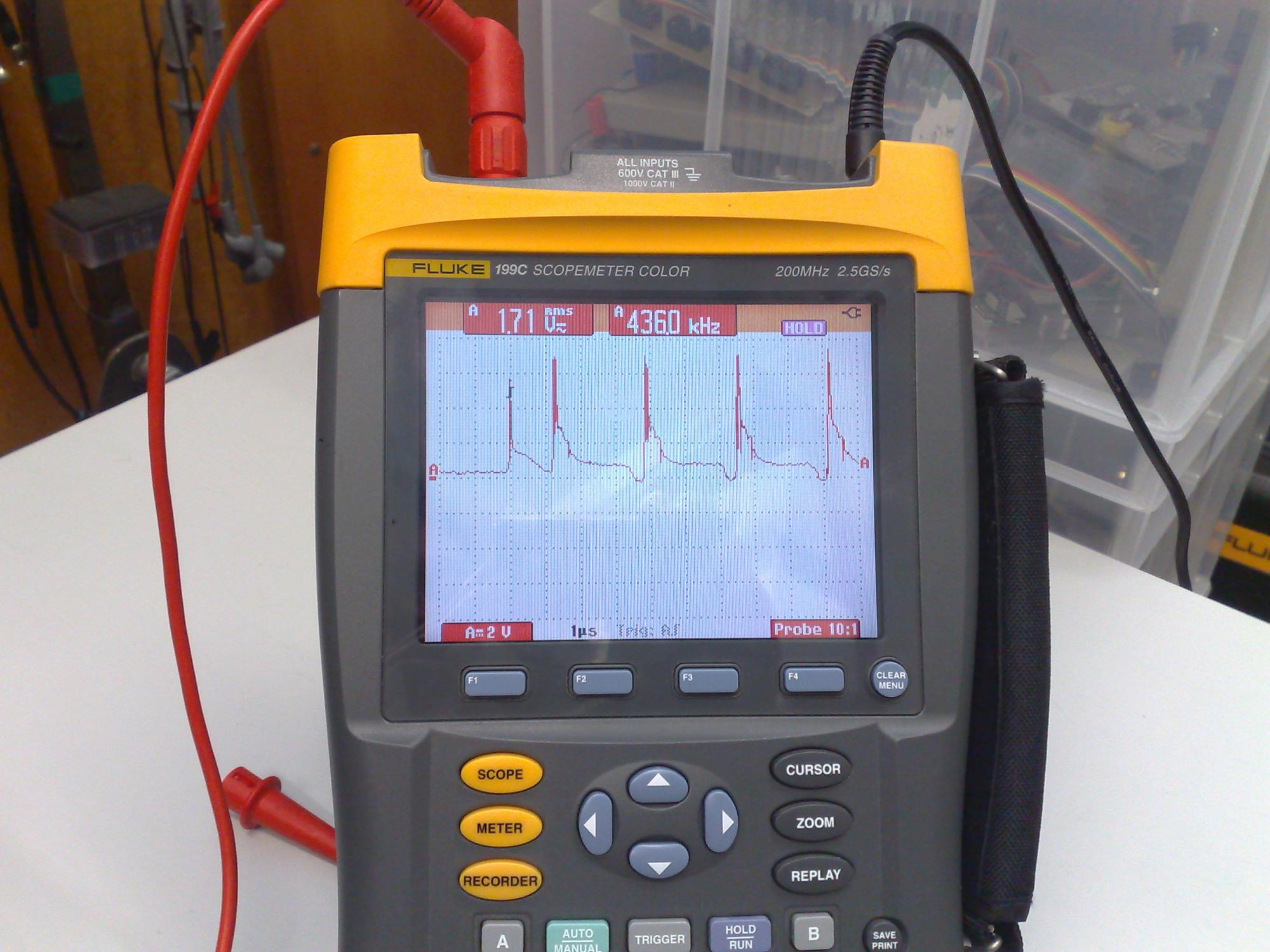

                Then I measure the switching component before the PFC module, see attached pics.
                Looks like some weird things happening here? It is not modulated properly, the 1st pic is QP801S Gate pin, 2nd one is Drain. The 3rd one is also Drain but in bigger time scale.
                This MOSFET is not modulated in full time, just like a "part time" working guy. However CP812 still gets a smooth 380VDC.
                Anyone can tell me this is normal or not?

                  Re: Powersupply proble, SAMSUNG LA32R71B
                  Connect the fluke across the transformer primary winding, or perhaps one of the secondaries to tell what duty cycle/pulse width the 9222 outputs.
                  I would also carefully check the error amp circuit (ZDTM851 which is a standard TL431A) and measure across RM855, you should have 2.5VDC here if voltage loop is in "balance", lower voltage indicate too low output voltage and primary controller should increase pulse width to compensate.
                  Also take a look on optocoupler PC803S and measure both ledside and transistorside. This signal is then fed to pin 11 of the 9222 which seems to be the dutycycle control input.
                  The above measurements could tell if the fault is in the error amp circuitry or in the primary controller.

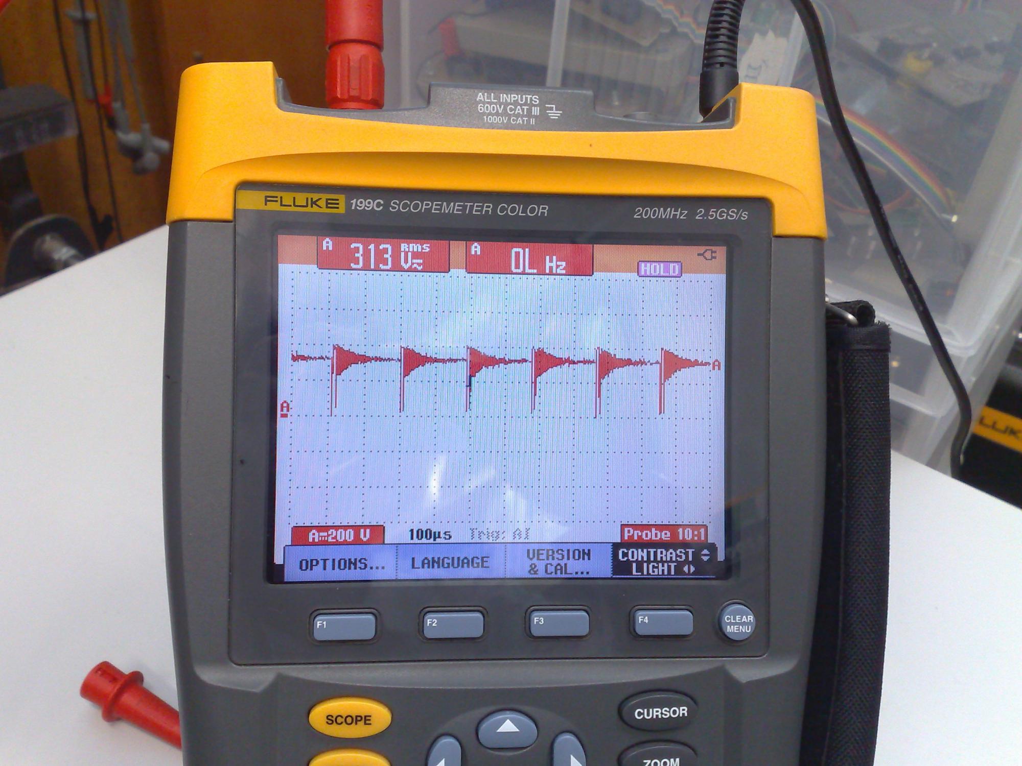

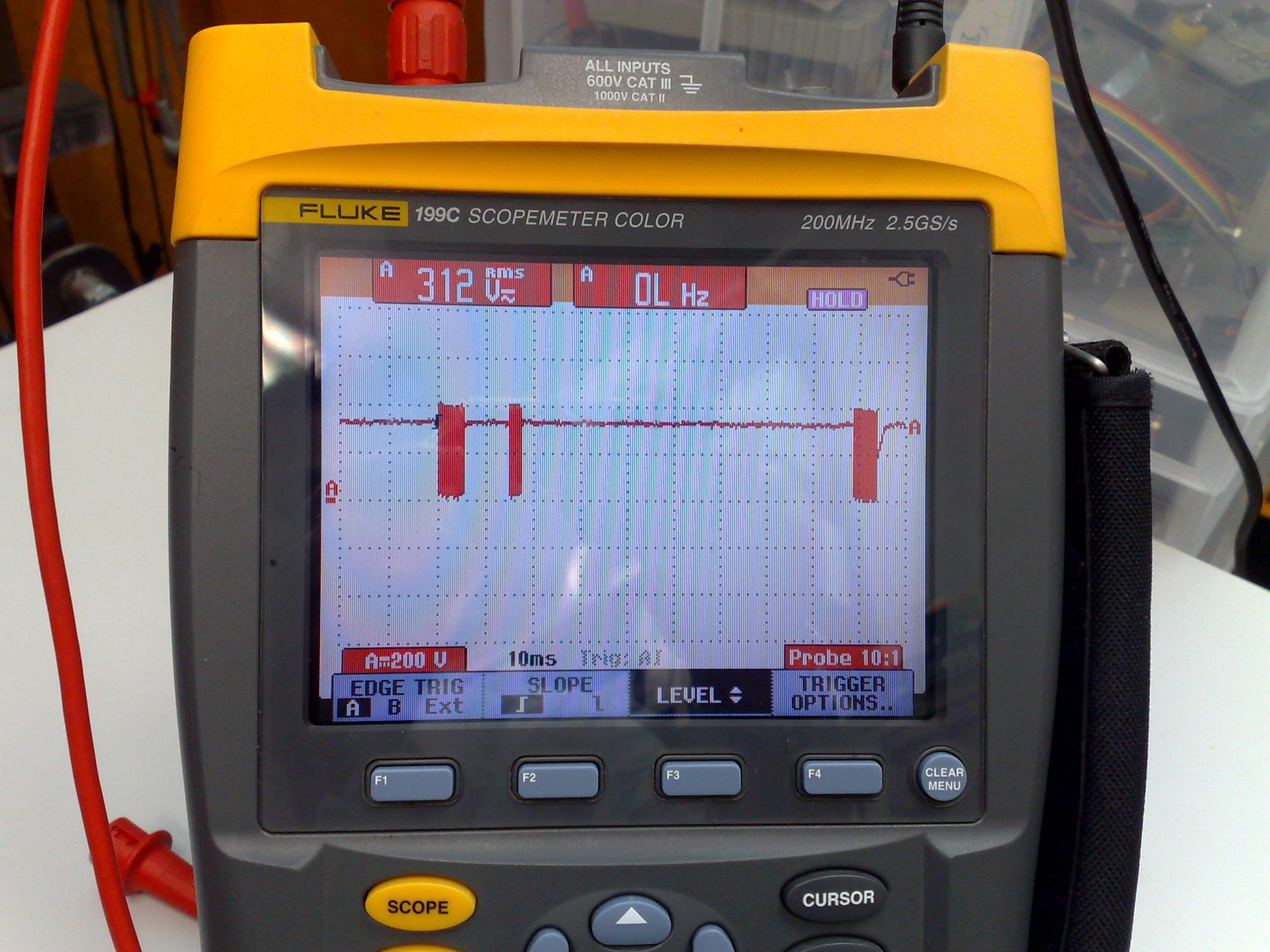

                    Windings' waveforms are all like full duty cycle... I already checked the feedback circuit and changed KA431 and the opto-coupler as well, not their problems.
                    Come back to my previous suspicion, QP801S, the main switching MOSFET is not modulated as I expected. I looked at the switching IC, ICP801S, its power supply was a bit noisy, followed this track, found the stand-by power switching IC's power supply was noisy also(IPS801S). Noise ripple was about 5V. Pretty sure its not filtering caps' problem.
