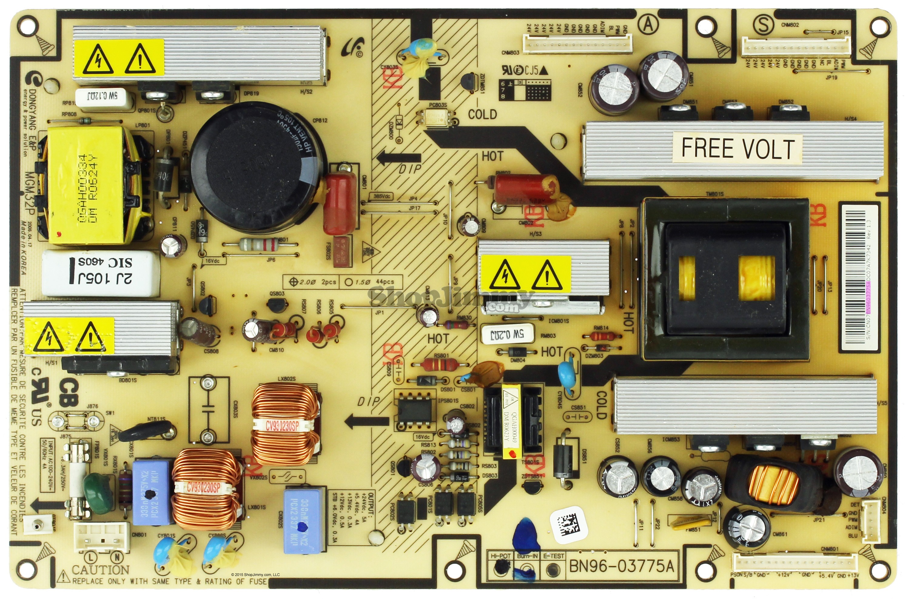

            Re: Powersupply proble, SAMSUNG LA32R71B
            Pictures of the board?
            Power supply board number? BNXX-XXXXXX?
            One of these your board?
            http://www.shopjimmy.com/catalogsear...?q=BN96-03775A
            Are you getting low 12V, 24V?
            If it is, then check the capacitance of CM802.

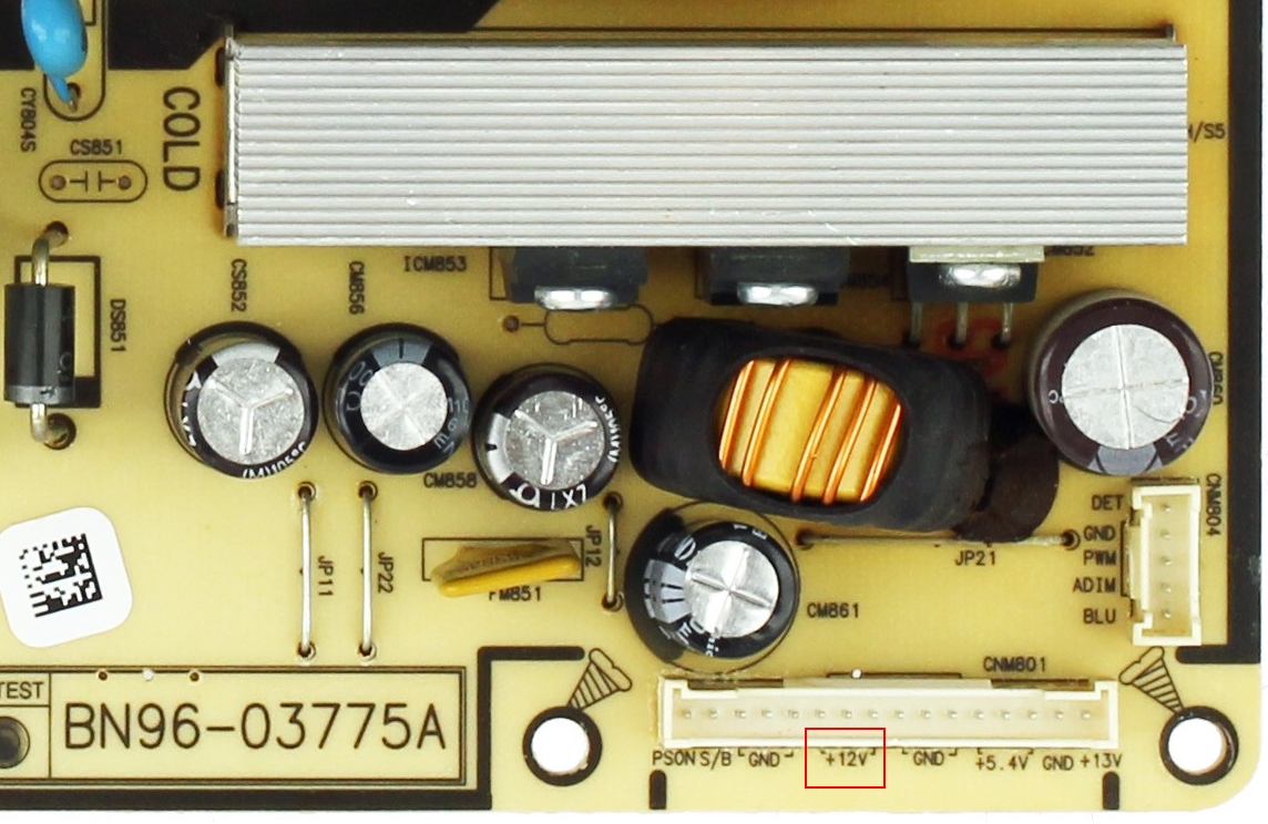

                The connectors have pin names next to them.
                CM802 is special poly film, you need cap meter to verify the capacitance.
                Pictures provided by Shopjimmy.
                BTW, those yellow glues that turned dark brown MUST be removed, it is corrosive and conductive when they turn brown.

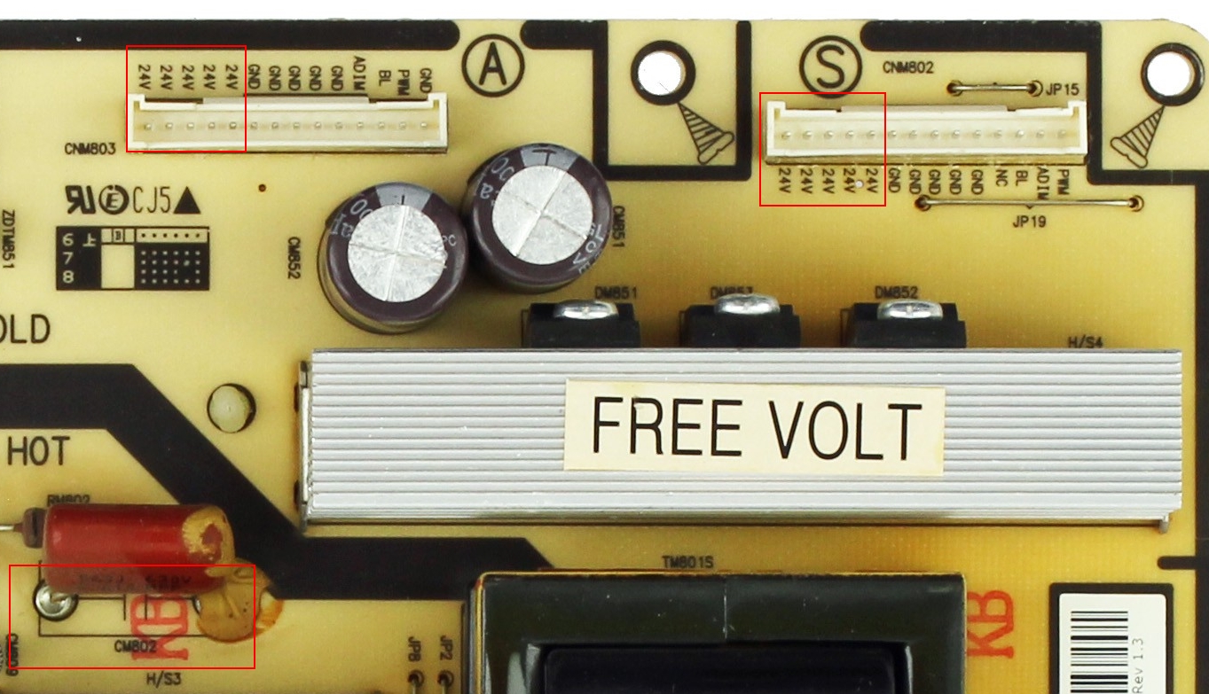

                      Check first if you do have 12V AND 24V on the connectors, black probe on the metal chassis and red probe on the 12V, 24v pins.
                      If the cap CM802 is bad you will get low Voltages on the 24V and the 12V pins.
