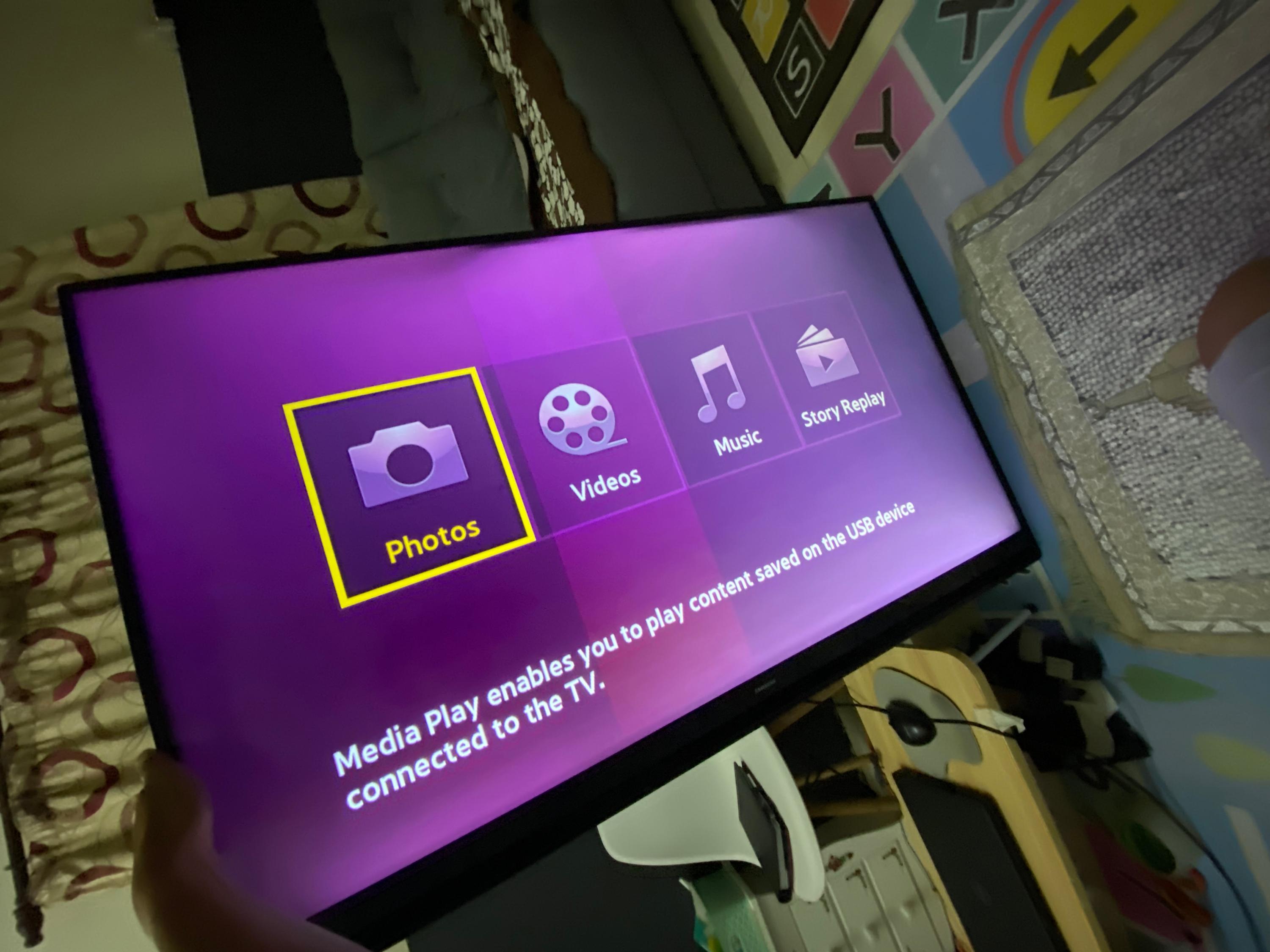

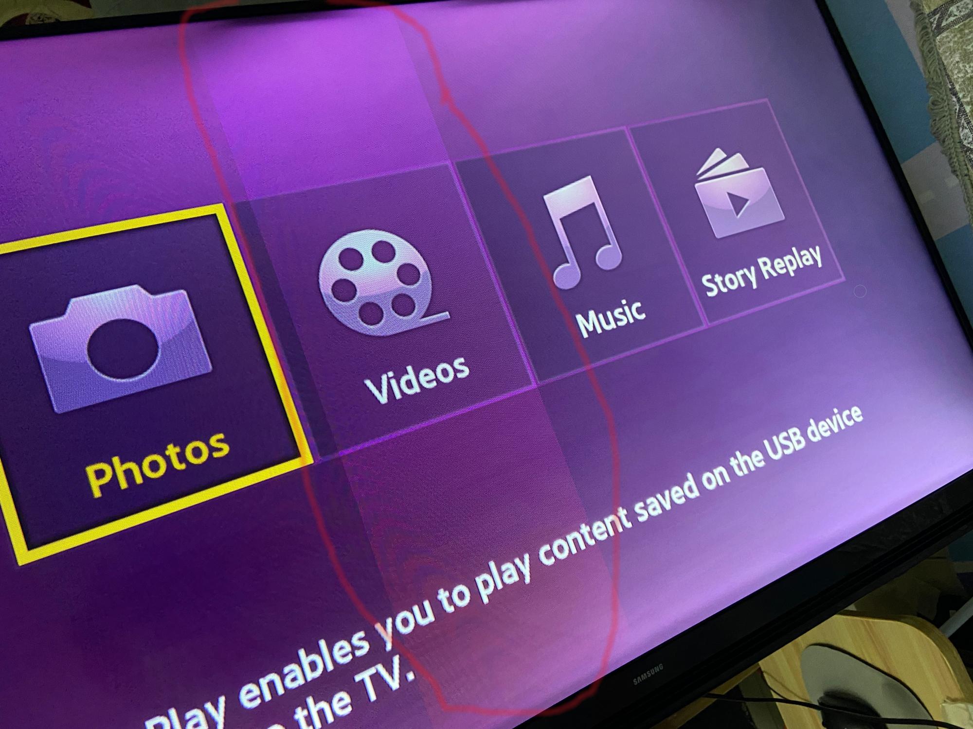

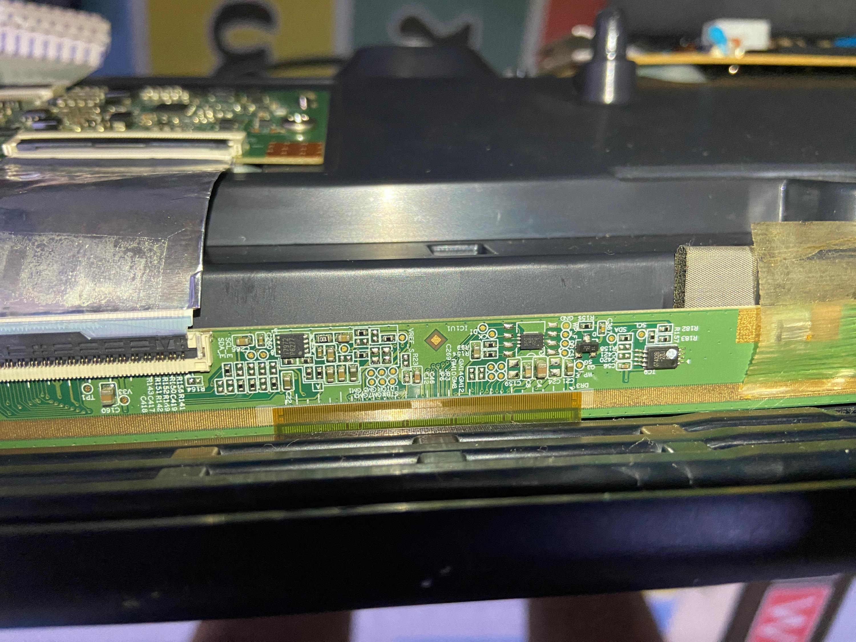

    Hello guys,
    i have Samsung UA49K5100 with a quite visible vertical bar on the left side of the screen (refer pictures, marked with a circular thingy in the picture)
    Anyone had similar problem and managed to fix it? appreciate your assistance on how to go about this..
    just to note that i have tried the tape method but can get the bar go away.
    Thanks.

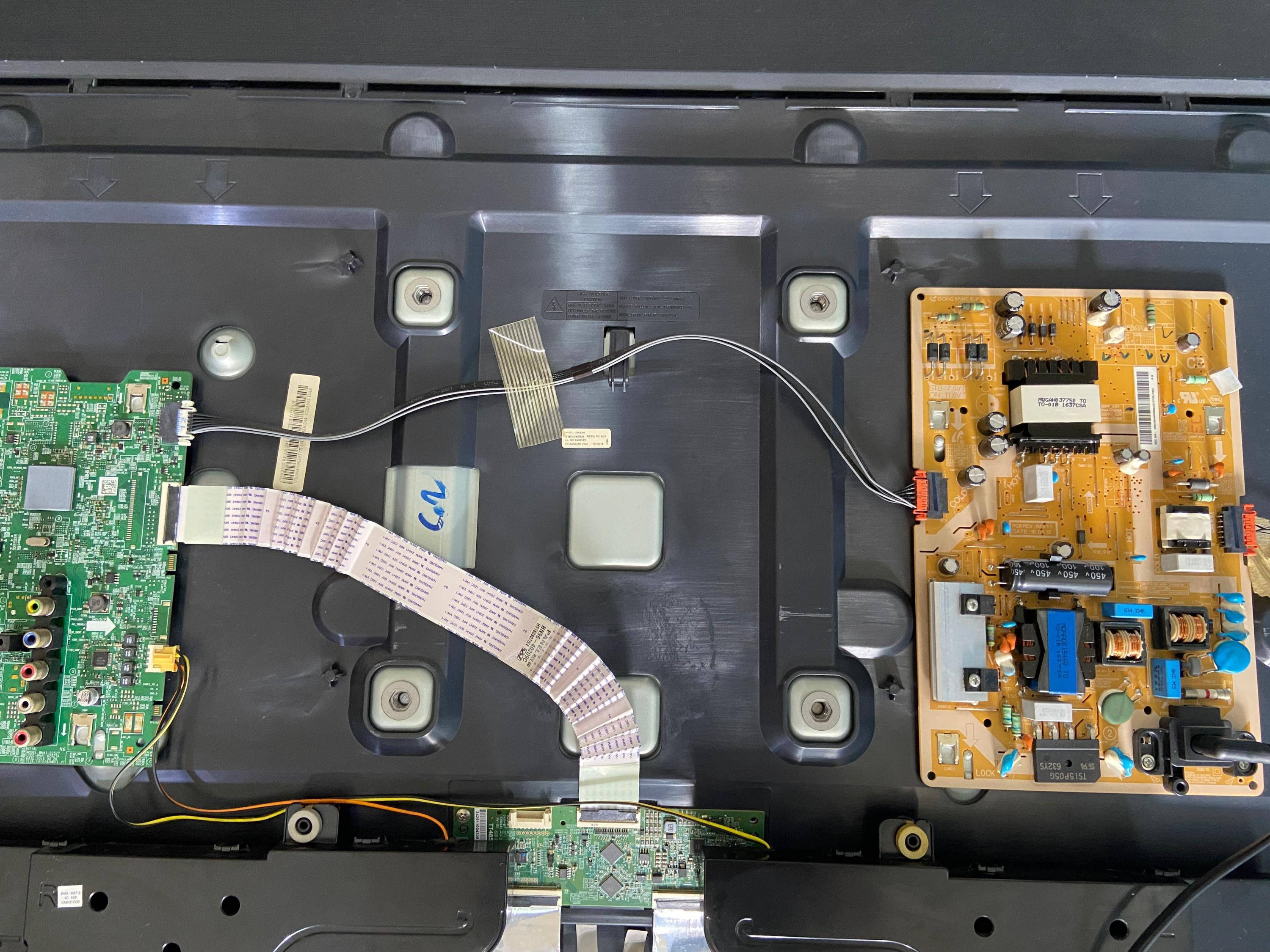

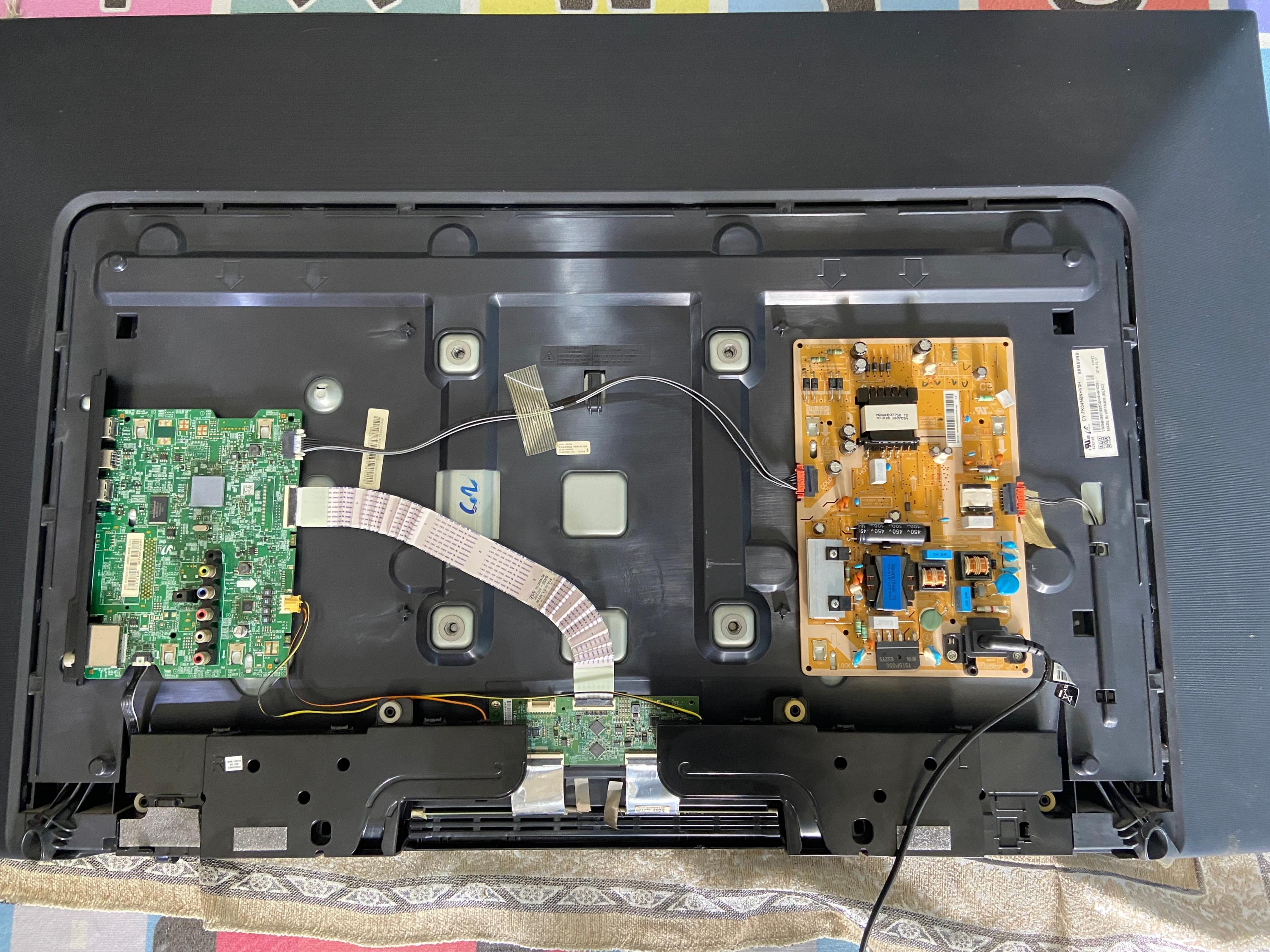

    Re: Samsung UA49K5100 vertical bar

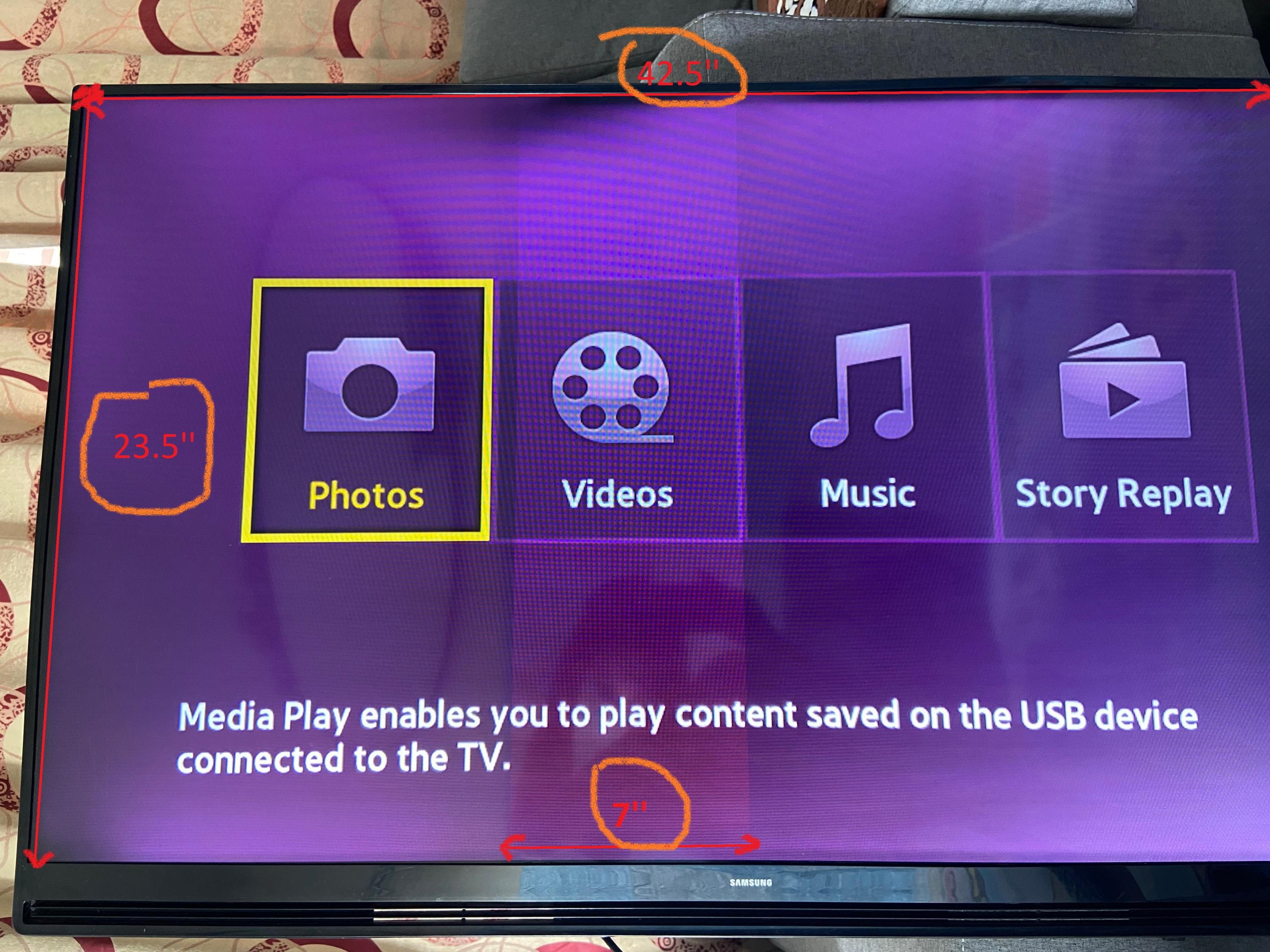

    1. Please post detailed pictures of back side
    2, Measure width of that bar vs width of the screen

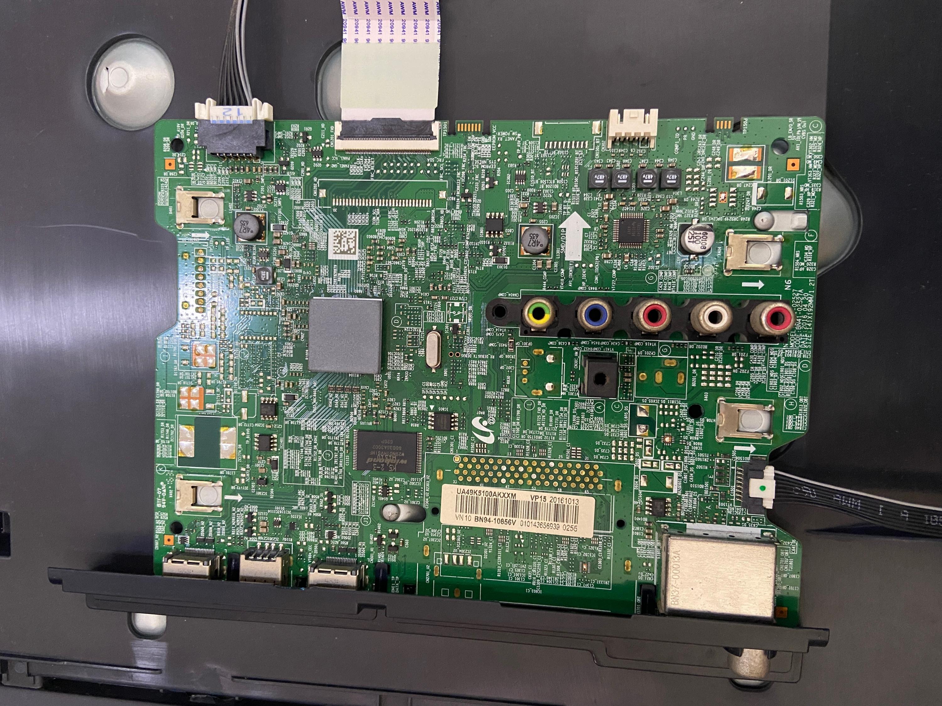

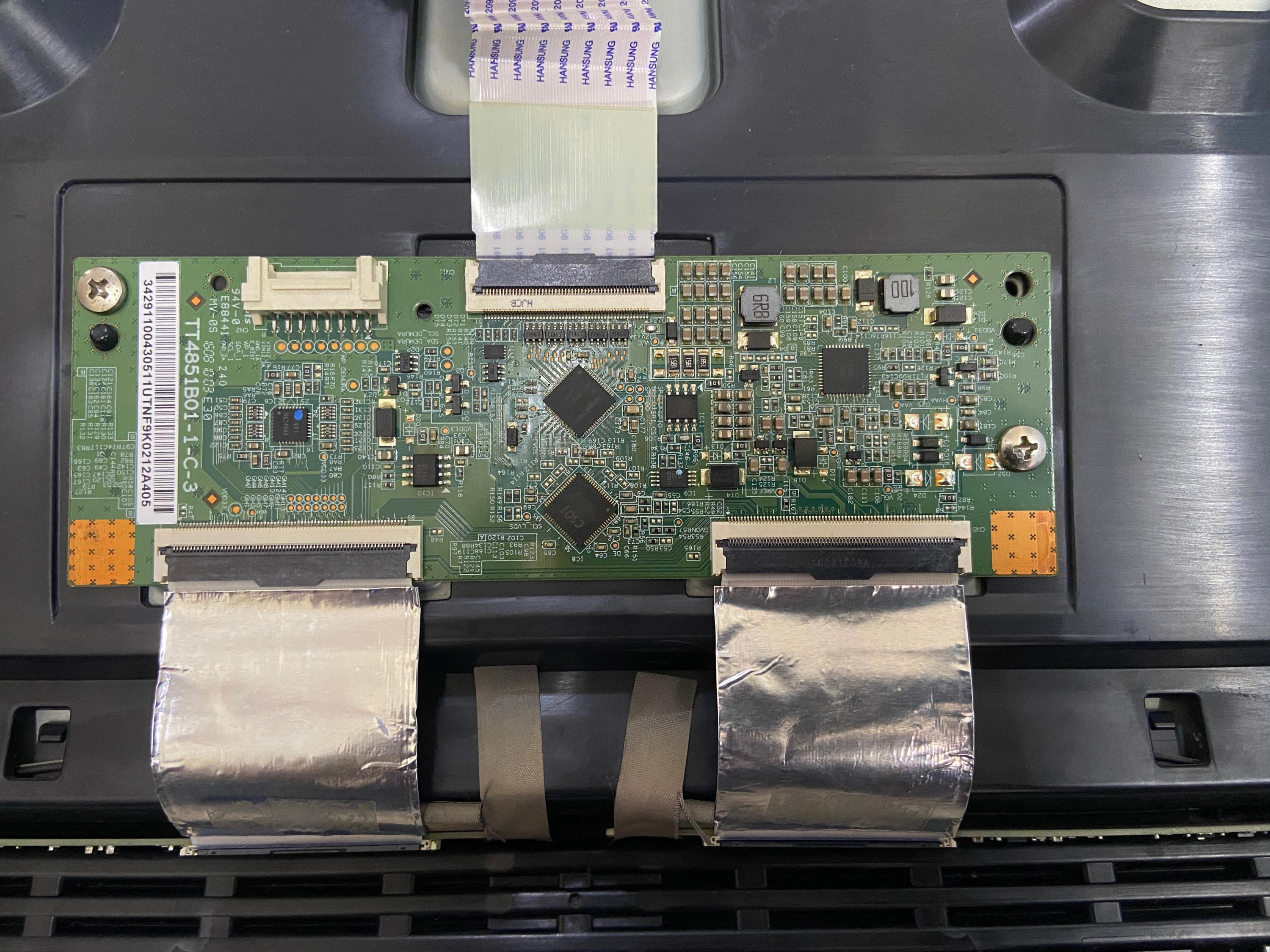

      hi alfatv, thank you for the reply..
      1. i attached some pictures here ya
      2. the width of that bar is 7 inches (18cm) and width the screen size is 23.5 inches. just to note that the bar is not visible if the background color is black
      thanks

      • alfatv
        • Sep 2020
        • 353
        Please read this thread, your case looks similar. I guess you know what to do next.
        https://www.badcaps.net/forum/showthread.php?t=95234

          ok thanks for the heads up and the thread link..so u did this before and successful
          just mine is not corroded. The board looks clean at the cof area..but let me do some thorough inspection

            maybe something to do with some of the chips near the cof area?

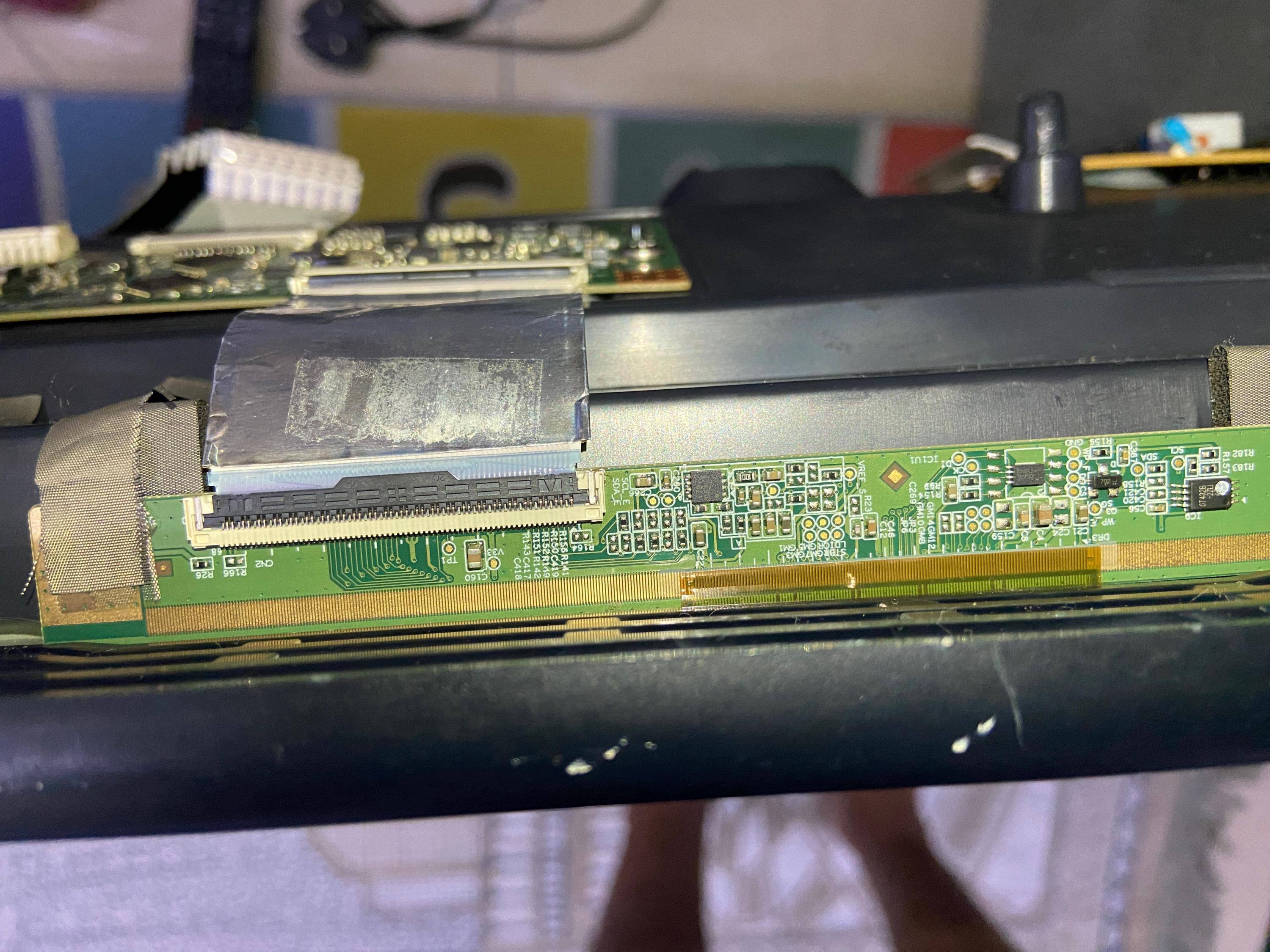

              One or more incorrect gamma voltages are causing this.
              They are generated on t-con and common for all cofs.
              You have to look at the cof corresponding to problem bar, take a picture of it.
              I see the pictures you posted, it should be that cof.
              Gamma voltages are GM1 to GM14, measure all of them and look at connections.

                ic..if you mind.. where are the points to test with multimeter? and what is the normal voltage?
