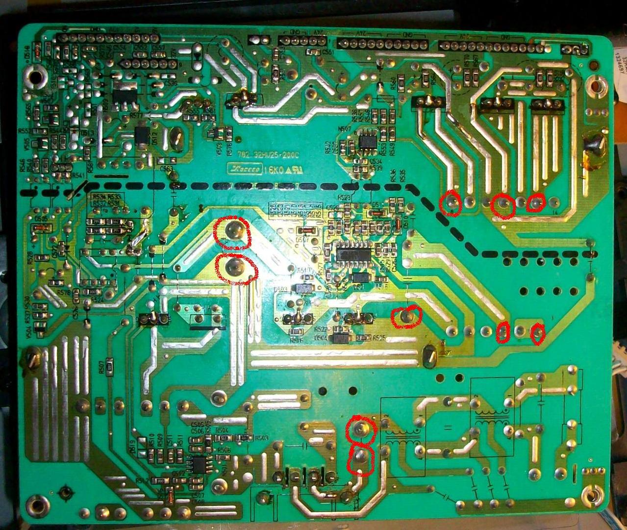

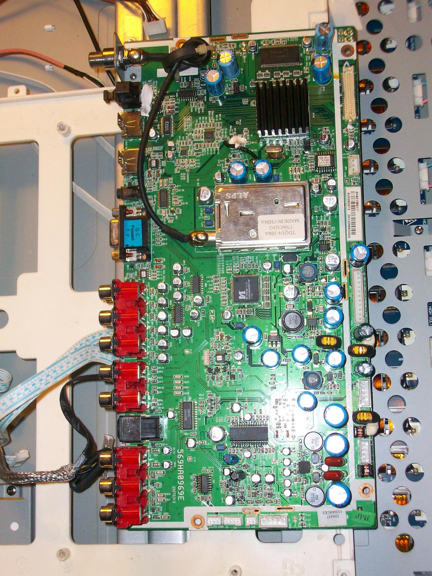

                      #30
                      Re: Insignia 32" LCD TV Model# NS-32LCD
                      Thanks for the info. I've took everything apart and i noticed that i have 24v from the power cord to the fuse fu501 and about 6v at fu502. I have no fu503. when i connect the cables up completely to the logic board, i loose all power to fu502 fuse. ( pulling my hair out at this point) lol. so i started disconnecting each cable one at a time until i have power again to fu502. All cables have to be disconnected from the logic board inorder to get power back to the fu502 fuse. I'm wondering if i either have to hold the on switch inorder to complete the circuit or the logic board is bad. I will post pics asap.
                      • davidlm1967
                        • Aug 2010
                        • 8
                        #31
                        Here are the pics, the caps i replaced were 470ul 35w
                        • retiredcaps
                          • Apr 2010
                          • 9271
                          #32
                          What brand/make/series did you use for replacement caps?
                          Also, this could be a long shot, but there seems to be a lot of suspect solder joints? I circled what looks suspect in your picture, but you have the best view.

                                #35
                                The caps that i used were brought from radio shack 470uf electroytic cap, 3w vdc max, -40 to + 85c, tolerance +- 20%, lead spacing 5.0mm.
                                And i had to keep pushing the on botton until the light turned green, thats when it would come on. Now the light comes on for a split second and thats it, nothing. Yes i will replace this cap. it's looks bubbled actually i didn't even notice it until you pointed me to that. Thanks for the help and i will post when i have completed this step. David

                                  #36
                                  Also, those caps may not be acceptable. They are only rated for 85c, and from everything I've read, you need 105c caps, and furthermore, I've heard the ones from Radio Shack aren't good enough, so its possible those have failed again. Something about being low ESR and they aren't or something. Someone will comment on that I'm sure. Were they blue? I have a LCD monitor I'm working on also in this forum that was recapped with blue Xicons from Radio Shack and it failed again. (however after recapping it still isn't working yet, so they may not be the culprit...) The other ones from Radio shack have a green radioactive symbol on them, I've heard those are better, but maybe still not up to the quality and demands of these devices... Again, this is all hearsay, I'll submit to the experienced ones on this thread to confirm/deny what I've said.

                                      #38
                                      awww man, thanks for the heads up. I will order the caps with 105c from a company other than radio shack. I will let you know what happenes when they come in .
                                      dave
                                      Since no one has chimed in, folks here are picky about their caps choices. The favoured 3 are Rubycon, United Chemicon and Panasonic. See
                                      https://www.badcaps.net/forum/showthread.php?t=2280
                                      You want low ESR caps.

                                        #39
                                        update. I just checked out my logic board where i replaced 3 of the caps. and all the caps on this board the readings are as follows.... 470uf, 35v, 85degree , 1000uf 35v 85degree c. theses are the orginal caps on this board. So i'm guess that insignia installed these caps rated at 85c instead of 105c. I order the 150uf 450v 105c cap for the power board, which the orginal is bubbled up a bit and it's reading is 150uf 450v and "105c" so should all the caps on both boards be rated at 105c instead of 85c. Is this a possible mistake?
