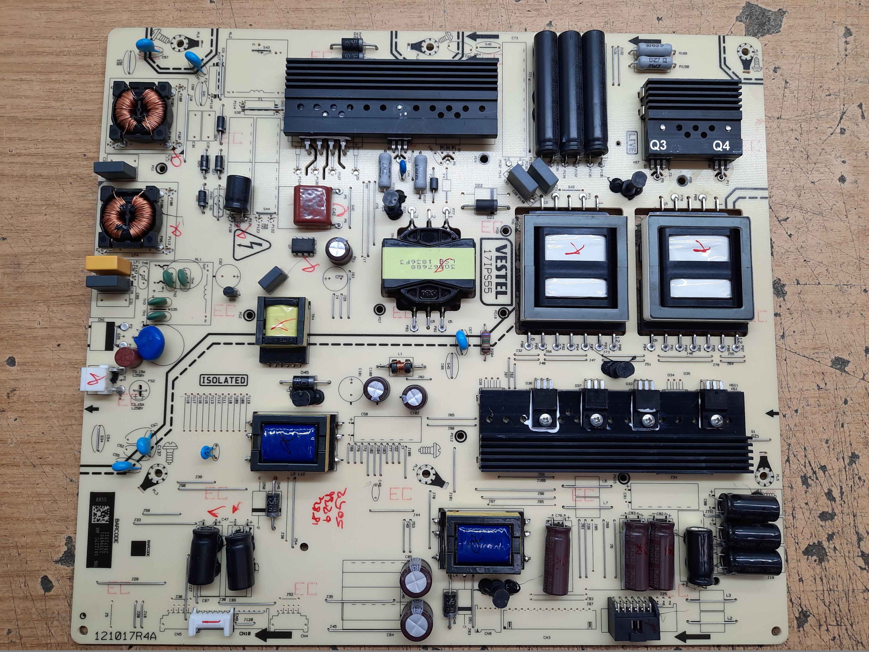

    P/N 23396951
    Schematic might be handy.

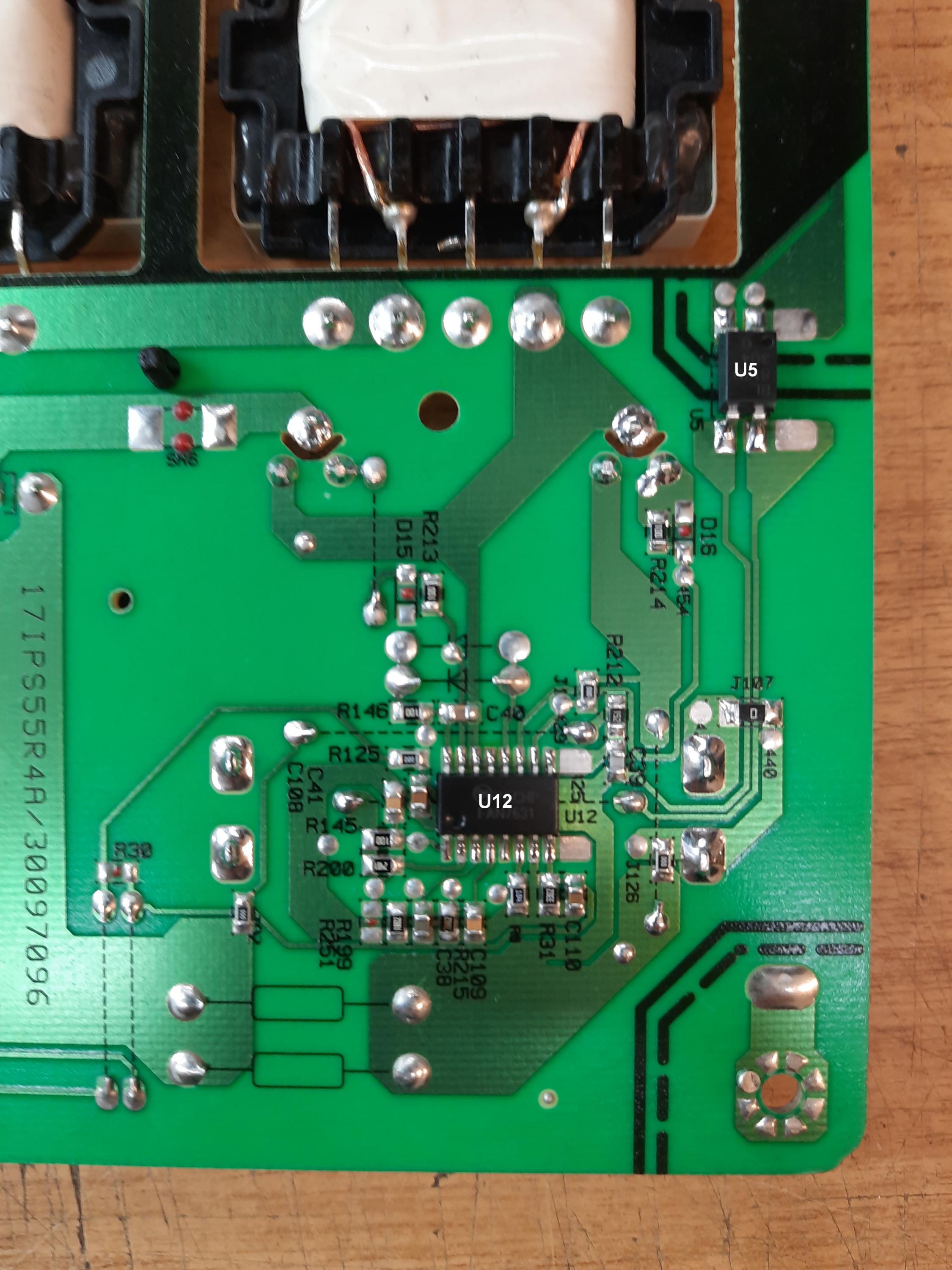

    First casualties
    Q4 (Magnachip MDF13N50) S/C
    As a precaution also replace Q3 which is same type.
    Both replace using B version of FET.
    Re: 17IPS55 Vestel PSU repair.
    Replace
    U12 (FAN7631), which is the gate drive chip for FETS.
    U5 (817) OPTO, which had a strange reading first time I checked it.
    Now working on test.
      what fault did the board have?
        Hi
        Customer complained of not powering.
        I didn't actually plug the set in myself as i discovered FETS were short on a cold test, which is my normal M.O to prevent further damage.
