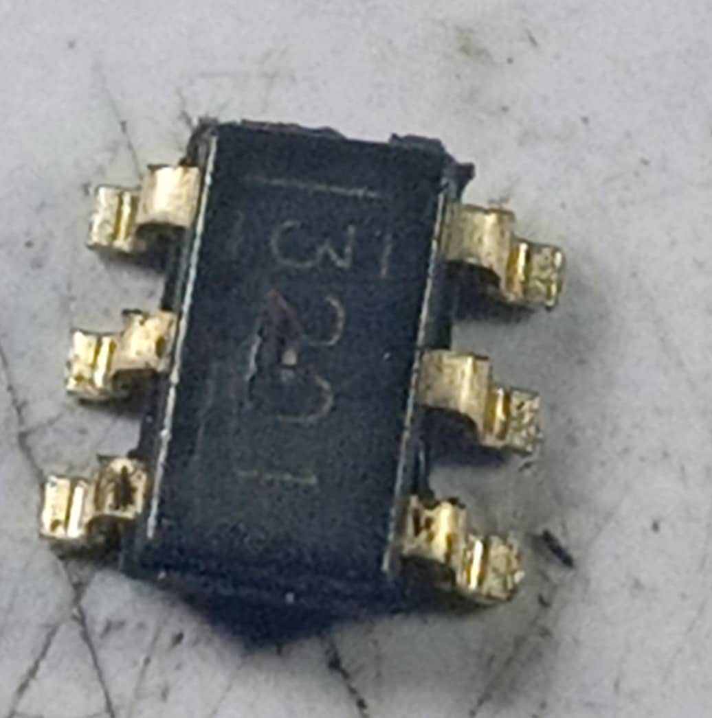

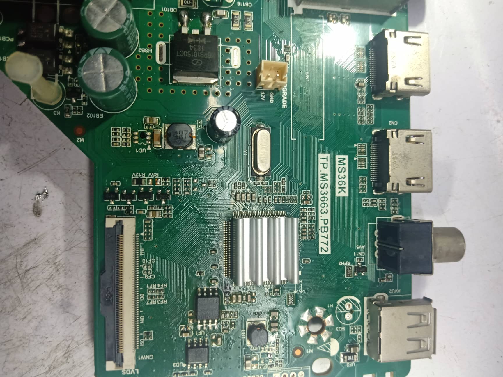

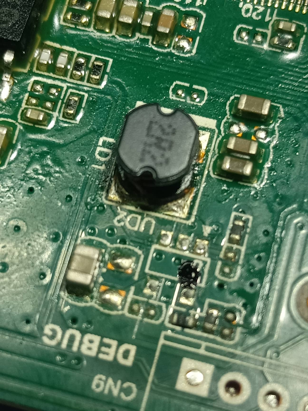

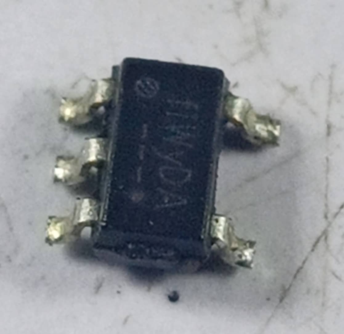

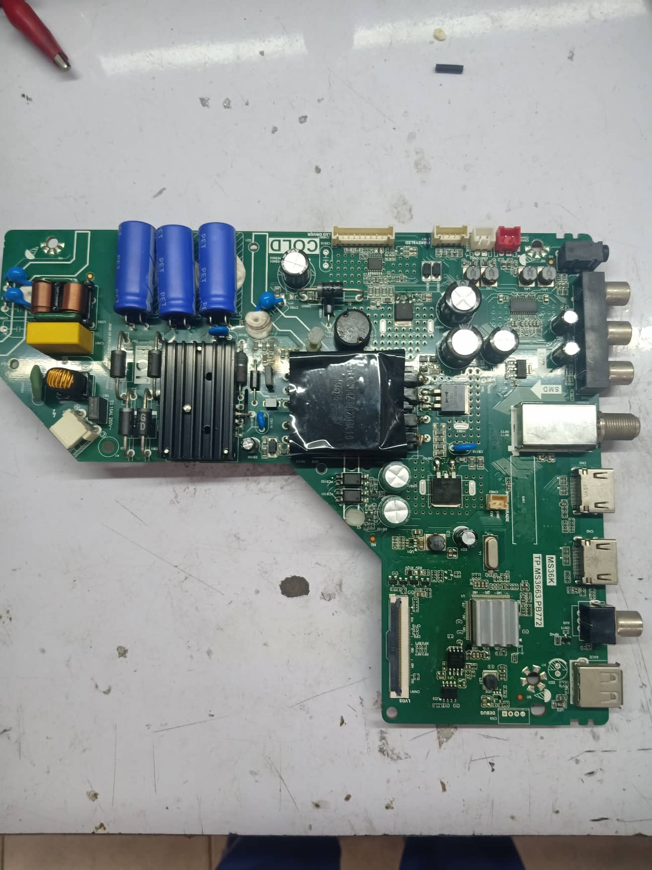

    Need help guys.. Trying to fix this TCL 40D3000D
    find a shorted 6pins smd 3201 and 5 pins fiWyDA ic.
    smd code 3201 = tps563201
    i don't know the fiWyDA code..
    i truly appreciate it if you can share a copy of
    TCL40D3000D schematics..
    see attached photos.. thanks in advance

    Re: TCL 40D3000D LCD TV need SMD CODE fiWyDA
    fiWxxx - FP6378A
      Originally posted by lotas
      fiWxxx - FP6378A
      thank you very much!!
