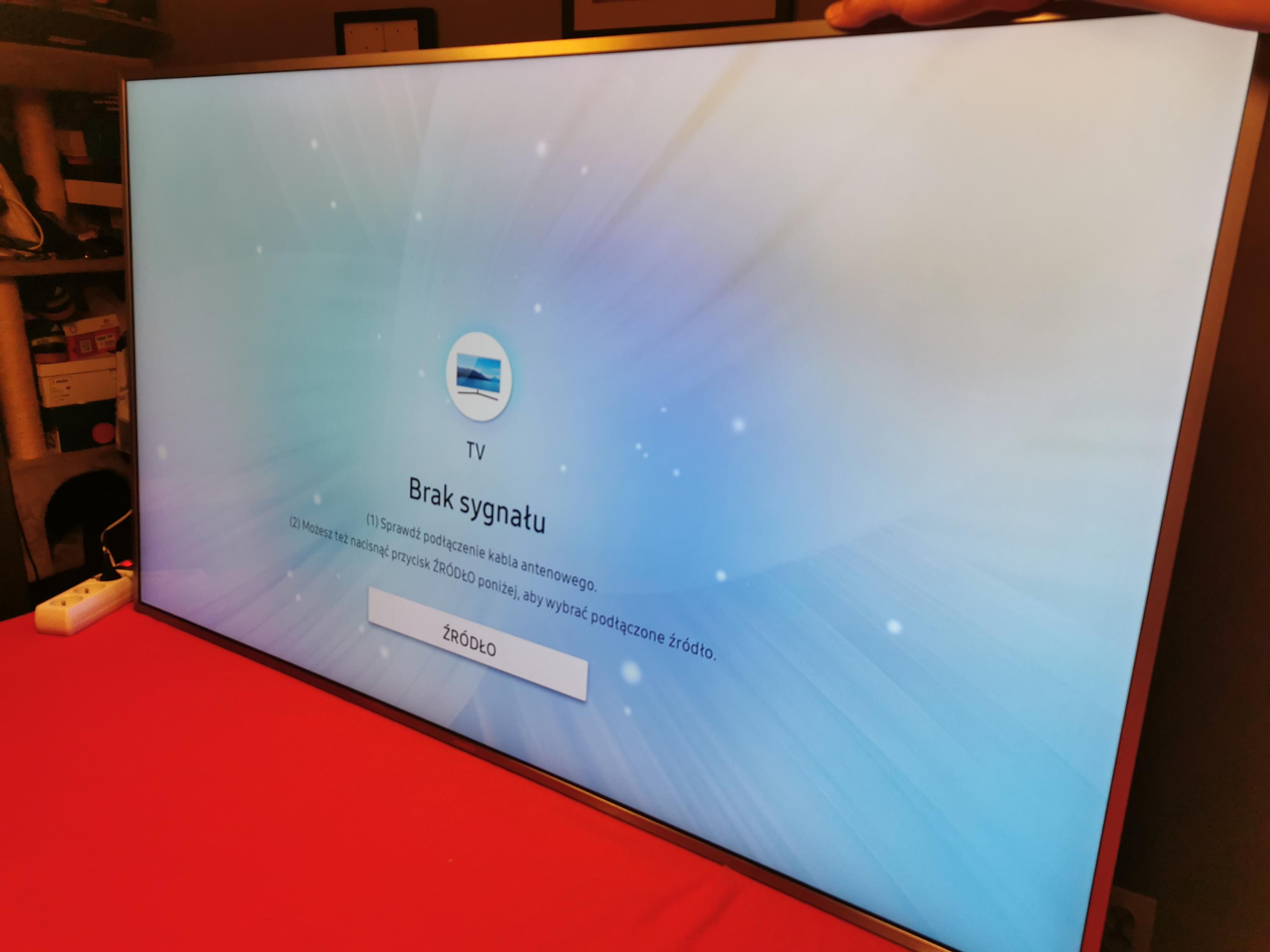

    Hi i have Samsung UE55MU6442
    the tv will not turn on, there is no standby light,
    Main board BN41-02568B (BN94-11958M)
    Screen CY-KM055HGAV2H
    when i remove the psu cable to main board i get backlight
    attached my dump file from 25Q40
    Can someone send me the right file please?

    Try.

          Re: SAMSUNG UE55MU6442 - no standby
          Originally posted by lotas
          Try.
          lotas! I love you!
          Works from first try
