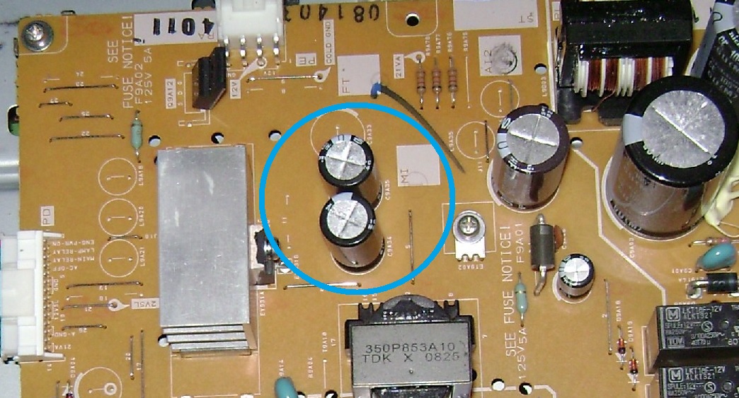

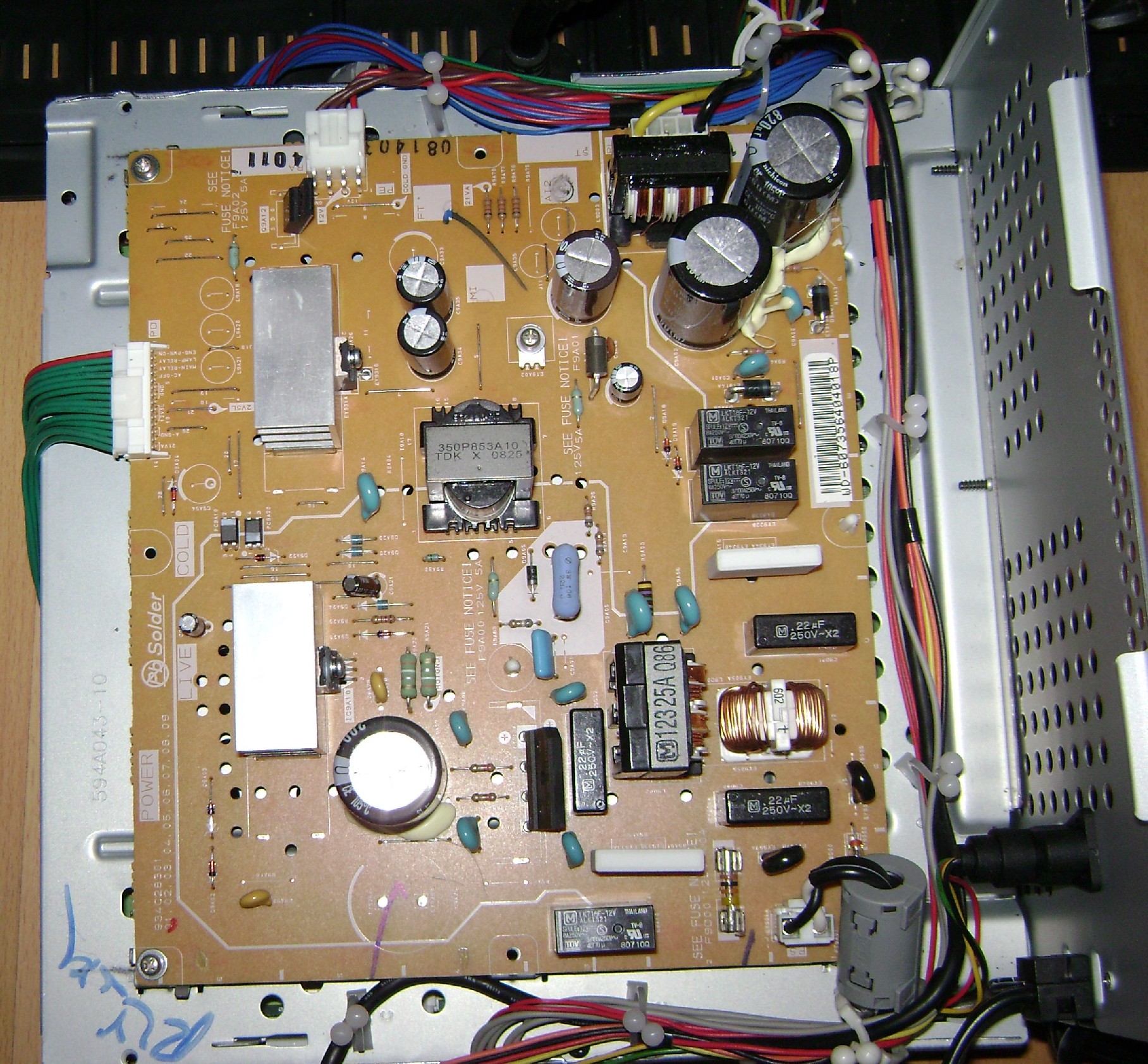

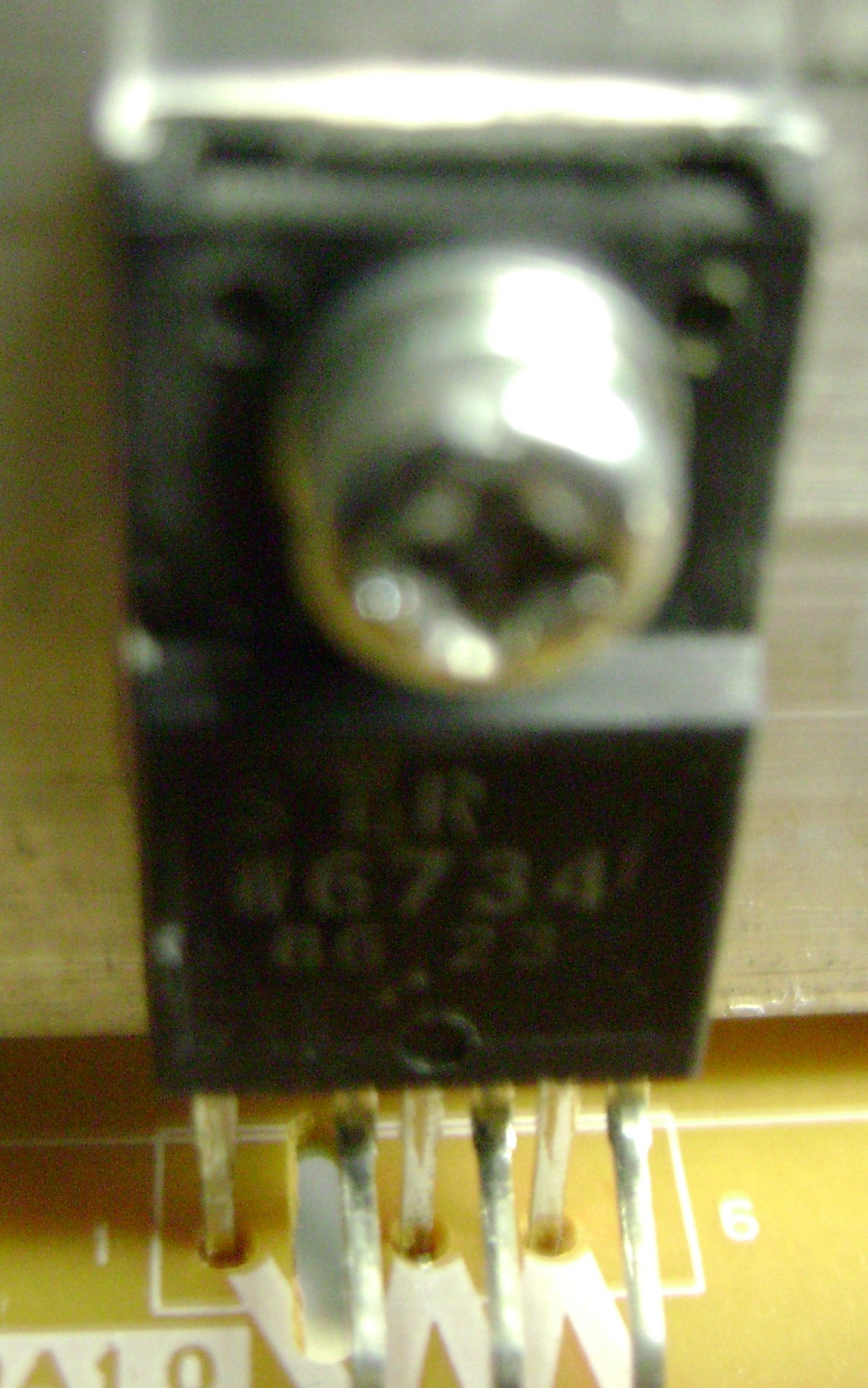

Unconfigured Ad
Mitsubishi DLP WD60735
  • Dgtech
    E. Technician
    • Apr 2009
    • 1462
    • Steeler
    Mitsubishi DLP WD60735
    Ok so a co-worker brought me this TV today to be repaired. The symptoms are - Blinking orange power LED - no video or sound - just a relay click when plugged in.
    I cannot find a service manual for this model.
    Here's what I have, all caps and fuses are OK.
    I have limited knowledge about DLP power supply requirements. I already notice voltages coming back in from other devices, probably for monitoring...etc. This supply board has a STR-W6734 PWM chip. I think this one is defective but I need verification.
    Voltages on STR-W6734'
    Pin 1 = 160VDC
    Pin 2 = There is no pin 2 for this chip.
    Pin 3 = GND
    Pin 4 = Vcc 17.7VDC
    Pin 5 = 0 VDC
    Pin 6 = FB 1.4VDC
    Pin 7 = .6 VDC
    There is a datasheed for this chip that is generic at best. Has no indication even what VCC should be.
    I will post photos after dinner - priorities.
  • PlainBill
    • Feb 2009
    • 7034
    Re: Mitsubishi DLP WD60735
    Originally posted by Dgtech
    Ok so a co-worker brought me this TV today to be repaired. The symptoms are - Blinking orange power LED - no video or sound - just a relay click when plugged in.
    I cannot find a service manual for this model.
    Here's what I have, all caps and fuses are OK.
    I have limited knowledge about DLP power supply requirements. I already notice voltages coming back in from other devices, probably for monitoring...etc. This supply board has a STR-W6734 PWM chip. I think this one is defective but I need verification.
    Voltages on STR-W6734'
    Pin 1 = 160VDC
    Pin 2 = There is no pin 2 for this chip.
    Pin 3 = GND
    Pin 4 = Vcc 17.7VDC
    Pin 5 = 0 VDC
    Pin 6 = FB 1.4VDC
    Pin 7 = .6 VDC
    There is a datasheed for this chip that is generic at best. Has no indication even what VCC should be.
    I will post photos after dinner - priorities.
    The service manual is available at Elektrotanya.
    PlainBill
    • Dgtech
      E. Technician
      • Apr 2009
      • 1462
      • Steeler
      Re: Mitsubishi DLP WD60735
      Thanks for the link.
      I worked on a unit before that had an STRT-G6153 chip that I found to be bad due to a more simple design.
      Any tips on how to test this chip? The voltages are above. I'll try to take a picture of the waveform from my scope tomorrow and post it. I really dont want to suspect this chip cause I can not find one for sale.
      • PlainBill
        • Feb 2009
        • 7034
        Re: Mitsubishi DLP WD60735
        Originally posted by Dgtech
        Thanks for the link.
        I worked on a unit before that had an STRT-G6153 chip that I found to be bad due to a more simple design.
        Any tips on how to test this chip? The voltages are above. I'll try to take a picture of the waveform from my scope tomorrow and post it. I really dont want to suspect this chip cause I can not find one for sale.
        This is a fairly straightforward design, at least compared the a plasma supply. It appears there are only three outputs from the main power transformer - 21 volts for the audio; Vcc for this controller, and 12 volts for the main power supply. If you have them, the chip is working properly.
        Of course, using an isolation transformer is mandatory. The waveform at pin 1 would be instructive. Depending on the AC supply, 160 volts is a little low for the rectified AC, but is right in line with what I would expect if the power supply is providing only standby voltage.
        PlainBill
        • Dgtech
          E. Technician
          • Apr 2009
          • 1462
          • Steeler
          Re: Mitsubishi DLP WD60735
          Well to close this one out, sometimes you have to refer to that old saying (K.I.S.S.).
          In my first post on this thread I refered to a blinking orange power LED. The plate in front of the indicator LED's was missing and the wrong assumption was made that this was the Power LED. Instead it was the Lamp LED. In the service manual, (thanks again Plainbill), the slow blinking lamp LED code means the access pannel to the lamp is not secured. With the back off, I located a simple wisker type of micro switch for the door and activated it. After powering the unit up - we have life.
          Basically, the switch was not activating due to a misplaced screw from someone else probably switching the lamp cartridge. The switch most likely activated but was close enough to the threshold of not activating and one day switched over. This switch is not on or near the power supply but however is a permissive for getting out of stanby mode in which activates some of the voltages on the power supply board.
          • pclaptop
            • Dec 2014
            • 13
            • US
            Re: Mitsubishi DLP WD60735
            I will start a new thread but have to make a few posts first. My WD60735 has the BLINKING green light and nothing past that! A google says the caps have gone bad on the PWR board!
            So rather than go into more detail here I will start a new thread!
            Pclaptop
            • pclaptop
              • Dec 2014
              • 13
              • US
              Re: Mitsubishi DLP WD60735
              For some reason I still cant start a new thread . . . . but concerning the blinkging green light ONLY problem, when I search google, "WD60735 has blinking green light", EVERY bad cap result/post for this Mitsubishi say change the "7" bad 1000uf caps (to 680uf) on the power board!
              There are no 1000uf caps (never the less "7" of them) on the PWR board! I see two 2200uf caps!
              If I have committed a major faux pas, could an admin move this to a "new thread" post?
              thanks don't mean to be a newbie hemmorhoid!
              • failinx@yahoo.com
                • Jan 2016
                • 2
                • usa
                Re: Mitsubishi DLP WD60735
                Any closure on this. My set is doing the same thing
                • acedogblast
                  by acedogblast
                  11-02-2024, 05:13 PM
                  Common SPI bios chip programming Questions and Answers
                  by SMDFlea
                  Common SPI bios chip programming Questions and Answers
                  Q: I have a bios request,i can`t post my backup as i can`t read from the chip.
                  A: If you can`t read from it how do you expect to write to it ?.
                  Q: Why is my bios chip unreadable ?.
                  A: The programmer is faulty or has a worn or broken zif socket.
                  The USB cable is frayed,connector pins worn or some other physical damage.
                  Not enough amperage or voltage to power the programmer properly.
                  Bad...
                  09-02-2021, 04:40 PM
                • BMCappelletti
                  Asus Chromebox CN62 - wrong chip put on BIOS reader
                  by BMCappelletti
                  Long story short:
                  - dad converted Asus Chromebox CN62 into Windows compatible, with mrchromebox BIOS, years and years ago
                  - gave the computer to his son a couple years later
                  - son now decided to revert it to Chrome OS, to sell it as original (re-writing BIOS with the backup one created by his dad)
                  - too lazy to remove the board from the case, thought a voltage regulator was the BIOS chip (you know... it has 8 legs)
                  (seems like the story was not that short)
                  He used alligator clips to read the chip. No luck reading it. Removed chip and placed on a SOC-8...
                  01-08-2025, 07:27 PM
                • Troystain
                  Help EZP2023+ updated chip database for w25q256jveq?
                  by Troystain
                  Hello, anyone here have updated ezp2023+ chip database in .dat file format.
                  I need to add w25q256jveq chip but I do not know what data should I type.
                  I'm using the ezp chip dabase editor posted from here https://www.badcaps.net/forum/troubl...ro-programmers
                  The currenty unit model that I am trying to detect is HP elitebook 640 g9 which is currently locked on admin bios....
                  11-25-2024, 12:53 AM
                • inck243
                  Acer e15-e5-576g-5762 bricked. Bios chip won't interface in AsProgrammer.
                  by inck243
                  Thanks for any help. The board version is DAZAARMB6E0 REV: E. The bios chip is winbond 25Q64JVSIQ1736. W25Q64JV is not available in AsProgrammer -- only BV CV FV or FW_1.8c. The chip won't interface with asProgrammer and a CH341A. When I have this chip on the board, the laptop will not post but when I plug it in to power, the blue LED lights up, also the orange when the battery is connected. When I push the power on button, keyboard backlight turns on and the fan starts briefely then turns off. But I can't do anything to program this bios chip so I bought another one.
                  The BIOS...
                  07-25-2024, 09:17 AM
