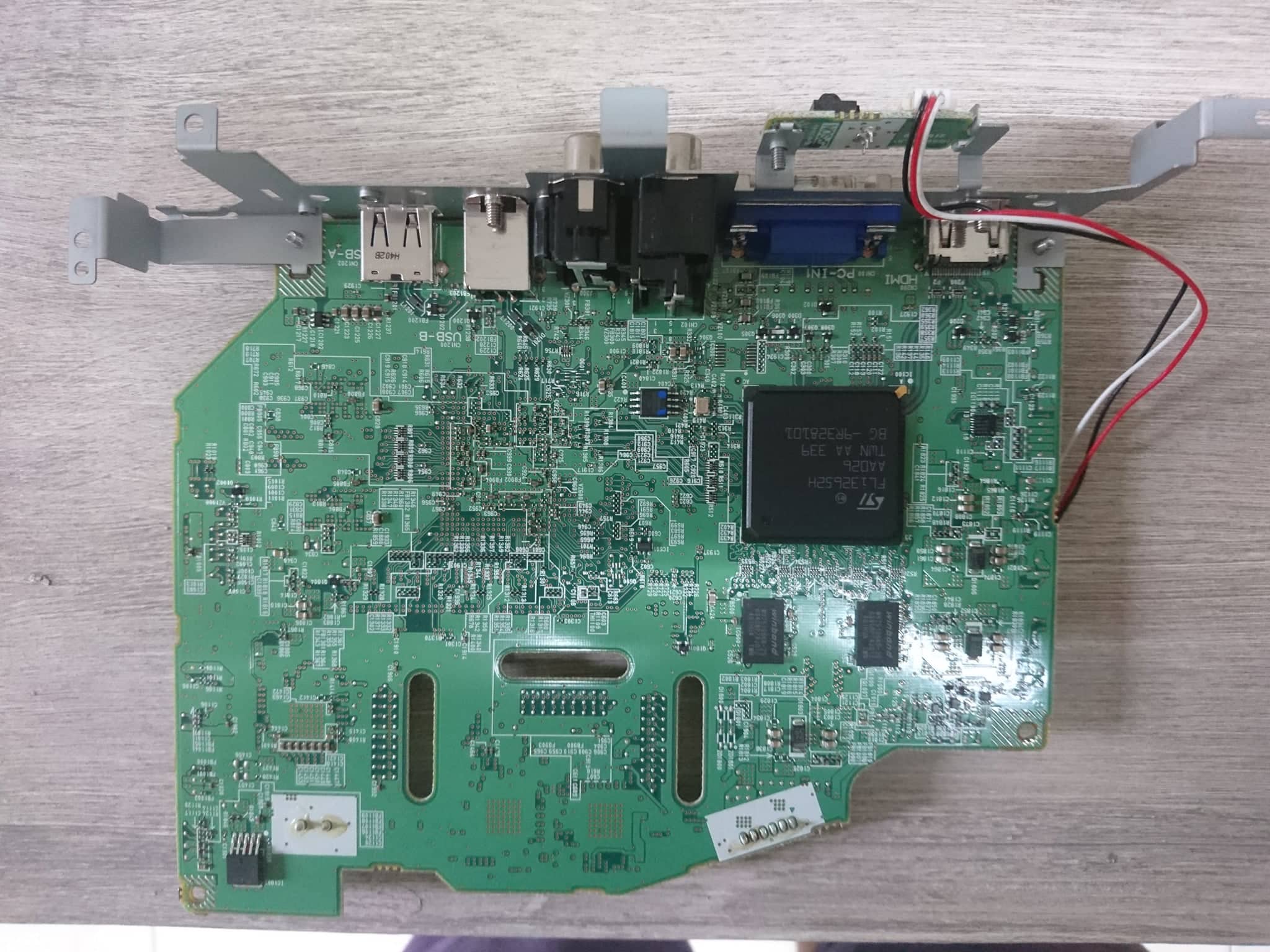

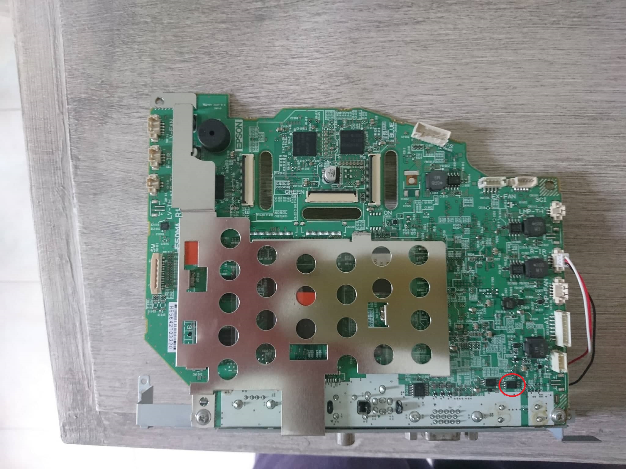

    Good afternoon
    I have the hdmi input of an Epson EB-S03 projector that does not work, in the attached photos there is the card which is a H550M_R1, I read somewhere that replacing the eprom circled in red solves the problem and among others things does not need software, just replace it, the eprom is a tssop 24c02, has anyone ever dealt with this type of repair? Thank you

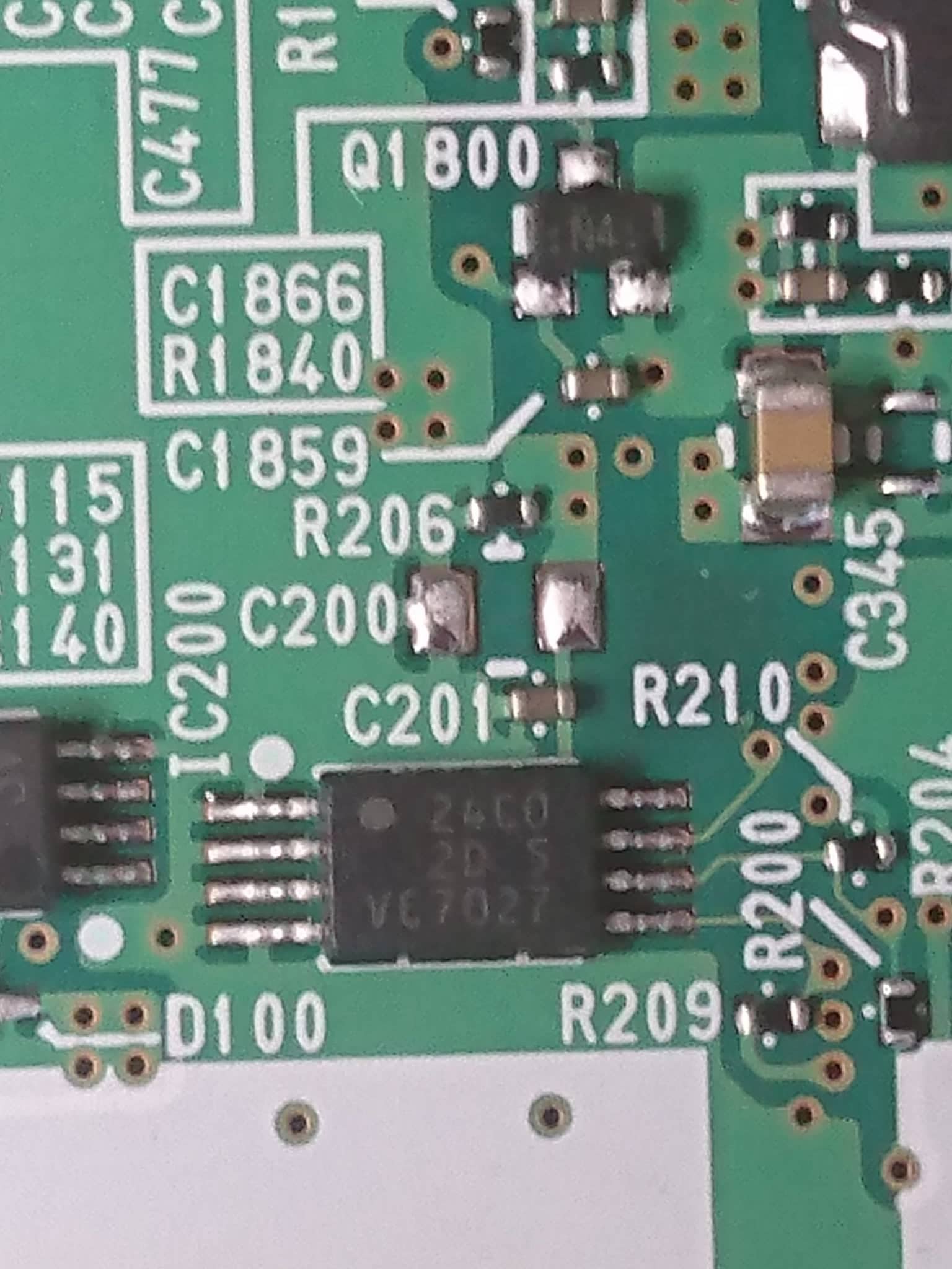

    Re: Epson EB-S03 Hdmi Problem
    this is the eeprom
      did you tried VGA port??
        The vga working
          then you have weak HDMI signal.
            And so?
              test with feeding hdmi port from signal generator
