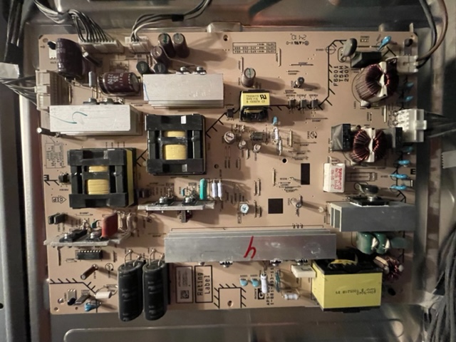

    Last week our home was hit hard by lightning, so much so that 4 transformers on our street were blown out.
    Items lost....DirecTV box, Cable TV box and initially Sony 55"....all inputs hooked up via HDMI. We have since purchased new set but wanted to at least try and see if this TV can be fixed.
    Initially while T/S, found all inputs fine except T-Con_ON = 0VDC

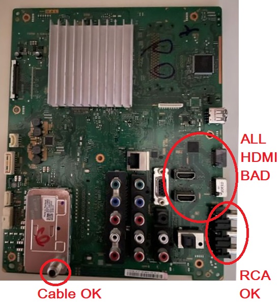

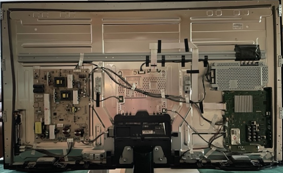

    but front panel had 3 red blinks. Yesterday took Pwr Supply and Main Board out to check for any noticeable failures. Coincident or not, after replacing both boards the TV started working fine but only when hooked up to Cable TV or RCA inputs. All HDMI inputs bad.

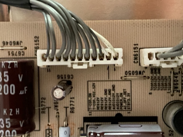

    Voltages when ON....
    1 STBY 3.3V = 3.3
    2 AC_OFF_DET = 3.3
    3 PWR ON = 3.27
    4 Audio12V = 12.68
    5 GND
    6 GND
    7 GND
    8 REG12v = 12.68
    9 REG12v = 12.68
    10 T-CON.VCC.12V =12.68
    11 T-CON_ON = 3.33
    Is it indeed possible by removing/replacing CCA's that it caused things to be flushed and all is well....excluding HDMI inputs that don't work.
    If I can find a Main Board for this 10 year old TV, is there an update I'll have to apply to TV ?

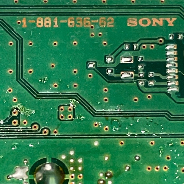

    Main Board P/N 1-881-636-62....SHOPJIMMY says Out of Stock.
    Any comments/suggestions welcomed

    All HDMI are bad tell me yours HDMI Cable cooked by lighting

              could be it fried your hdmi chip, new chip might work or new mainboard.

                well Lighting always its damage the main Soc or Tuner.. qt your case i would think its BGA on the Soc related to HDMI. sony had diagnose service menu.. try to call it to see if there any error register at it.

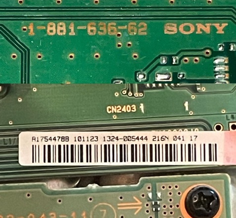

                      Thanks....the board number matches but the part # A1754478A is different from mine on the last digit....A1754478B
                      Is there a way to find out if the boards are in actuality the same ?

                        I think they are the same part, here's some info from shopjimmy: https://www.youtube.com/watch?v=Aodz2LHkzbY

                          Received a Main Board replacement purchased from Davids TV repair in Houston TX.
                          After installing, rcvd green and amber blinking lights which supposedly denotes needing firmware update. Sony terminated my model updates Jan this year. TV repair guy thru his contacts is sending me Firmware update via USB. Will update further after applying update.

                              Applied firmware and after about 3rd try with lights still blinking green/amber, took a few minute break. On return, the update was surprisingly showing complete and all HDMI inputs now working.
