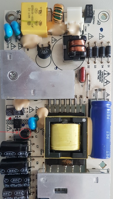

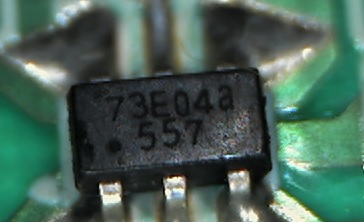

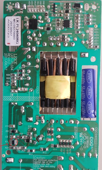

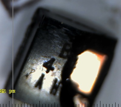

    Hi everyone,
    I have this LEKE LKP-PL034 PSU from a Blaupunkt 23/157I TV and need help identifying some components, namely the pwm controller and some blown up component near the optocoupler.
    Thx in advance for any info.

    Re: Help with TV PSU LEKE LKP-PL034
    1. Pwm - ob2273
    2. Tl431
      Thx for info, i will report back after i get the parts.
