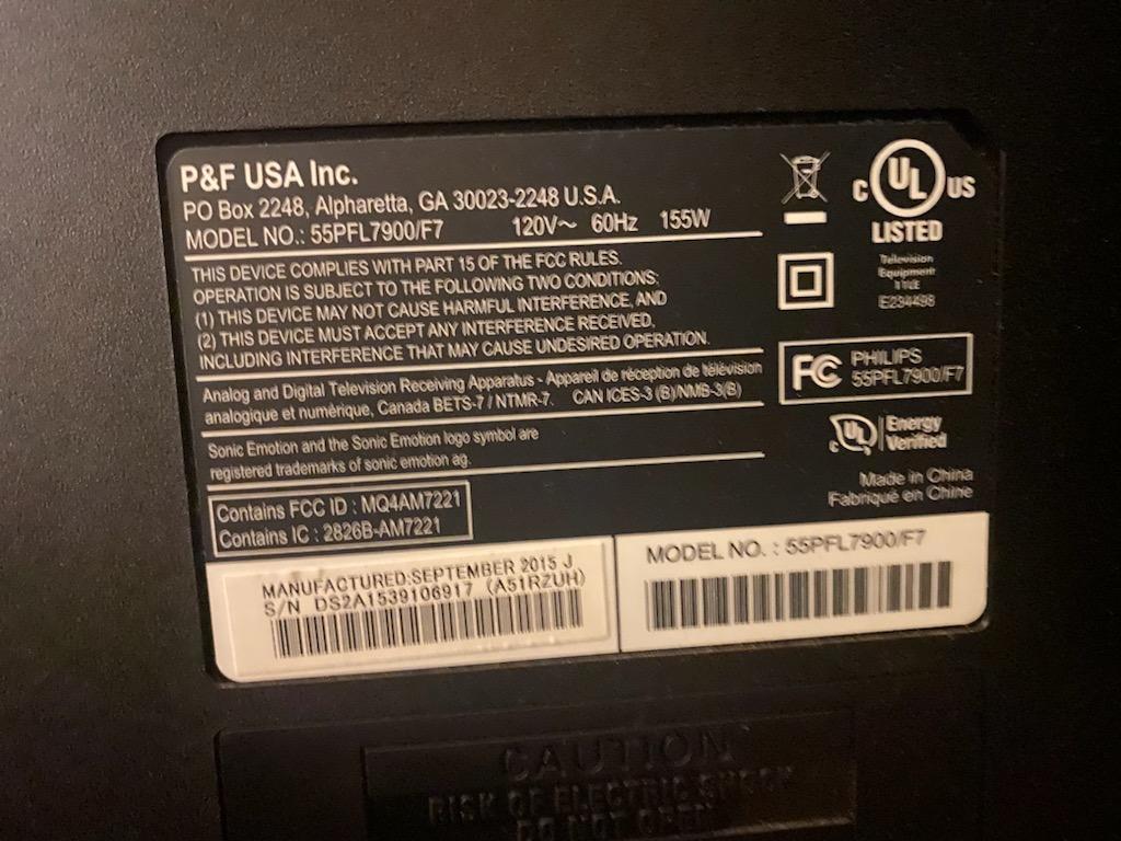

    QUICK QUESTION! P&F 55PFL7900 F7 - Is this panel damage?
    i have this question every so often when looking at a TV.
    it LOOKS a lot like panel damage,
    but could it be explained by something else?
    could the mainboard or tcon possibly cause the vertical separation of the image seen in the video?
    or could it be something on the panel driver boards that can be repaired?
    i would love to hear what others think based on their experiences.
    https://youtu.be/RSJsiJ8Z8Qc
    thanks for playing!
