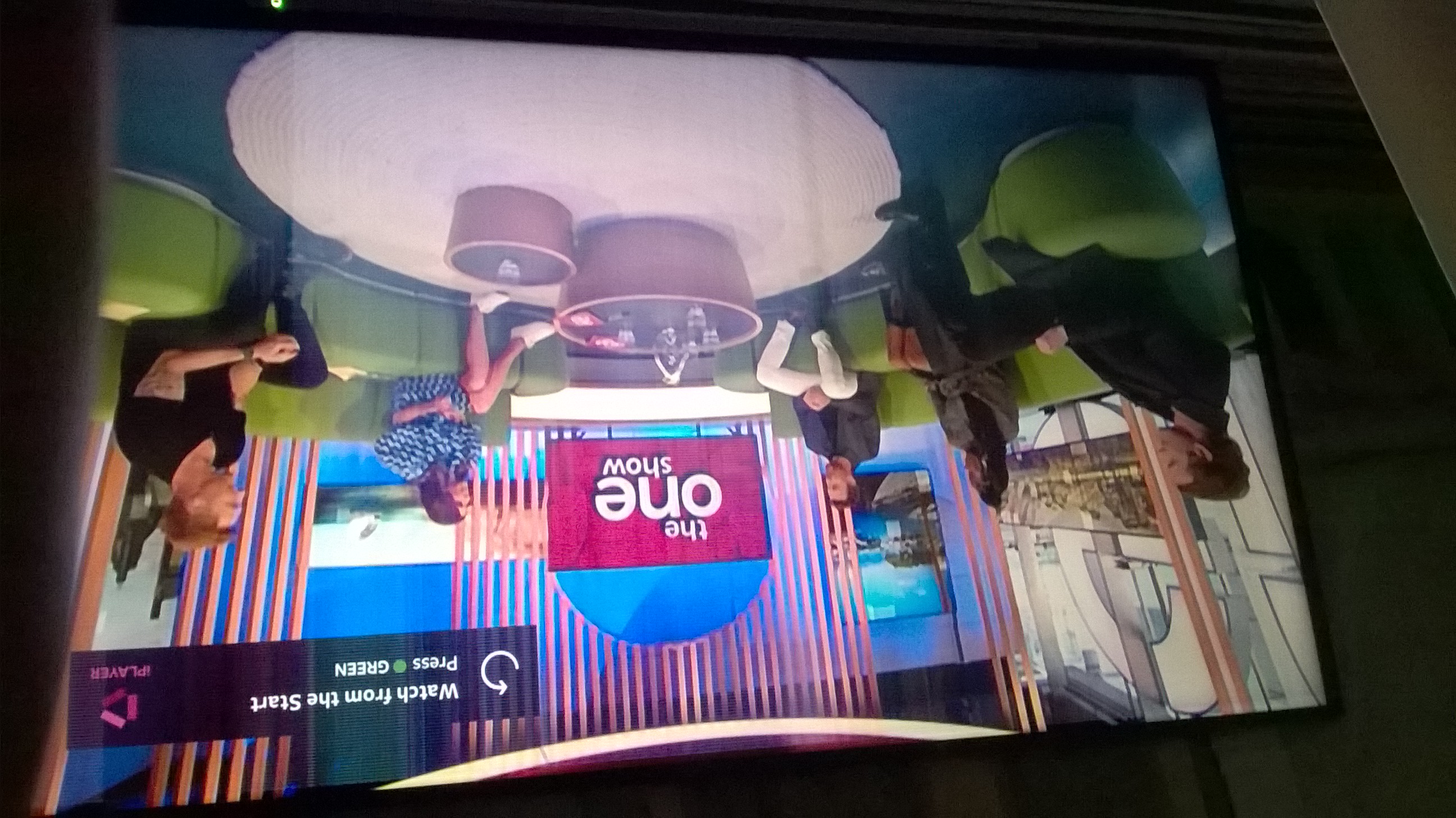

    Toshiba 58UL2B63DB Suspected Bad Panel
    I'm guessing that the panel is faulty, but I've never seen one do this before. Can anyone confirm this before I sell it for spare parts.

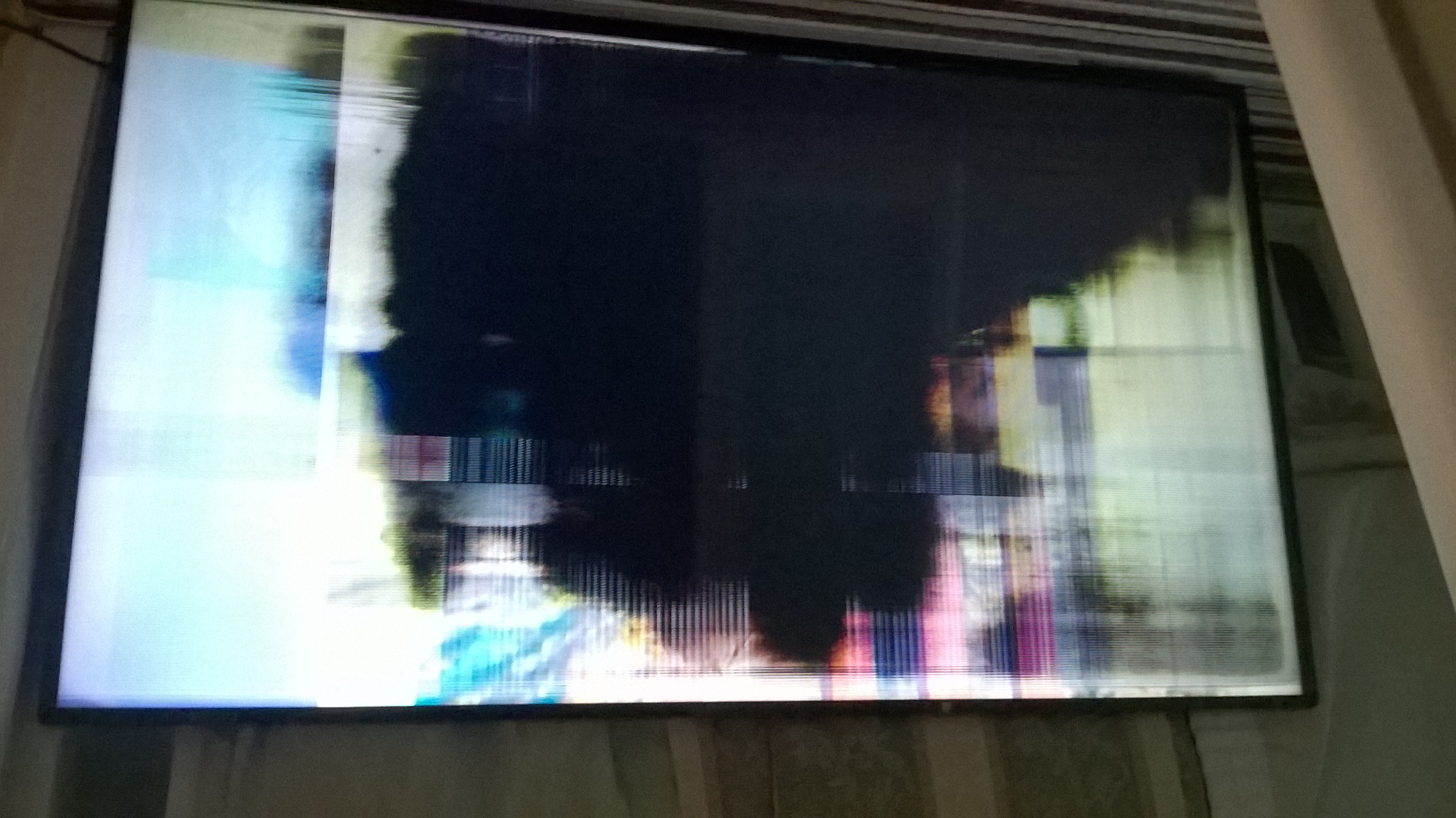

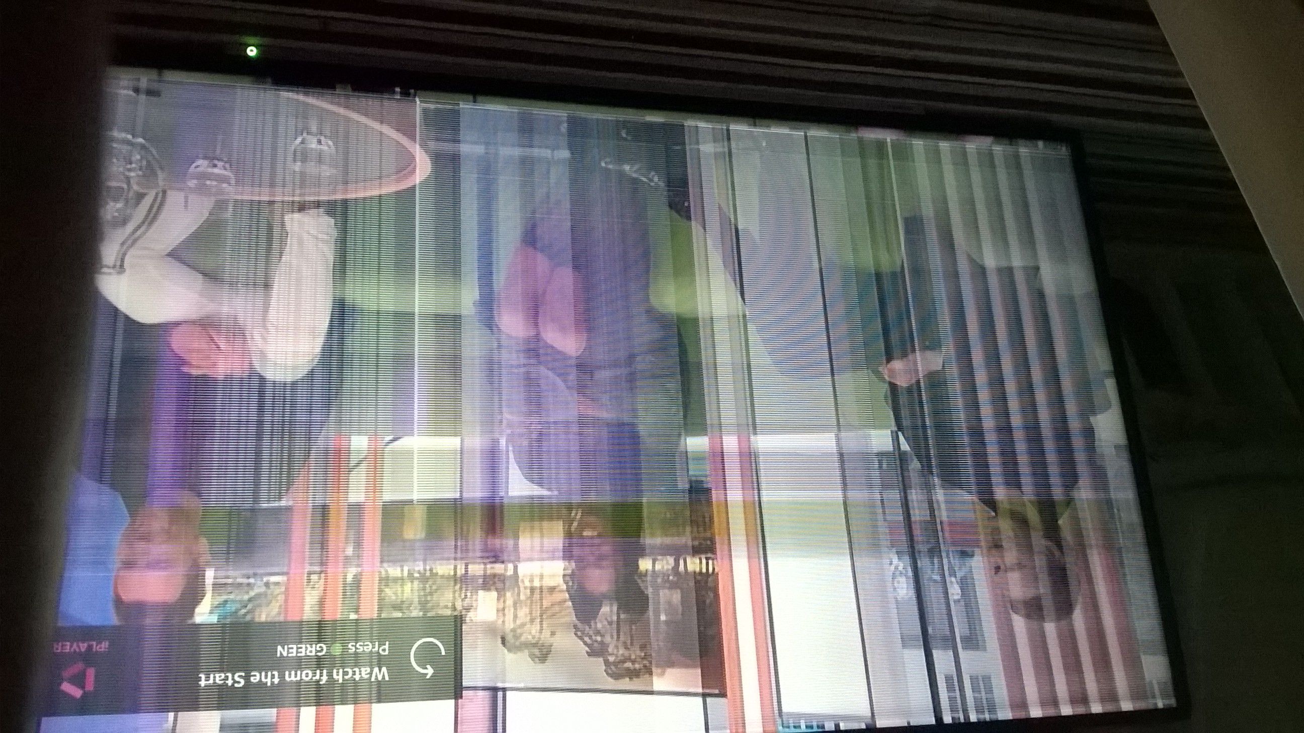

            Re: Toshiba 58UL2B63DB Suspected Bad Panel
            My pictures show what happens in sequence when turning on from cold. In the final one the picture freezes and the screen goes about 90% black, the sound carries on working normally, this all happens within a minute or so.
            Squeezing the bezel at any point makes no difference.
              With the left ribbon disconnected the right half of the screen works perfectly
              With the right ribbon disconnected the left half of the screen has the problem
                        Both ribbons connected and voltages have come back. full picture with no fade to black but random faint vertical striping.
                        Shouldn't VCOM left and right be the same?
                              vertical stripes or partial vertical stripes can be tcon issue. maybe cleaning the ribbon cables going to panel might help, some use pencil eraser some use q-tip and isopropyl alcohol, not to vigorous they can be delicate, be sure and let it dry a while. Check the side going to the mainboard too.
                                I tried the tape method using a paper strip just wide enough to cover 8 contacts. The TV works now with no problems. I watched these two videos to help.
                                Thanks for everyone who helped.
