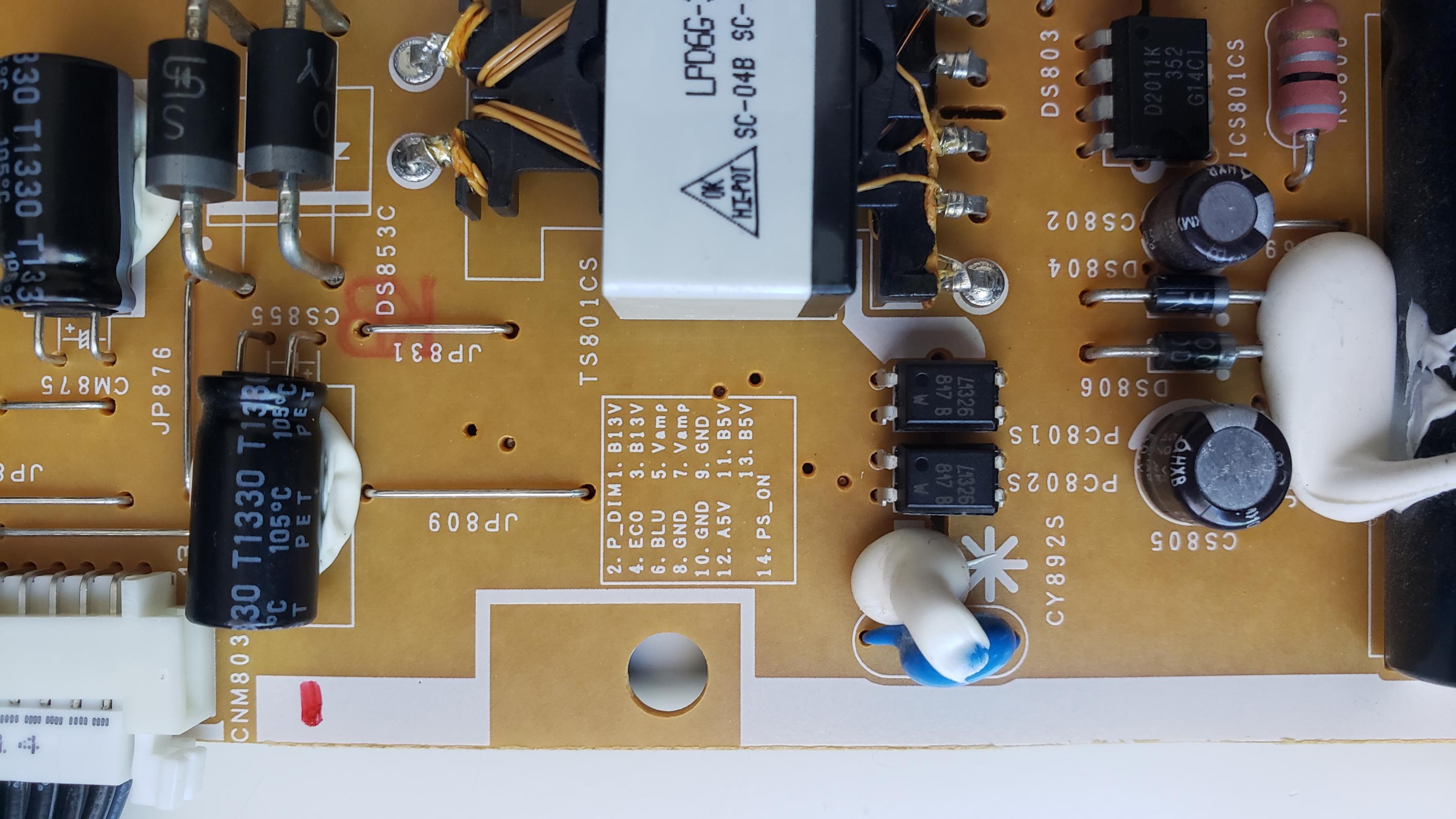

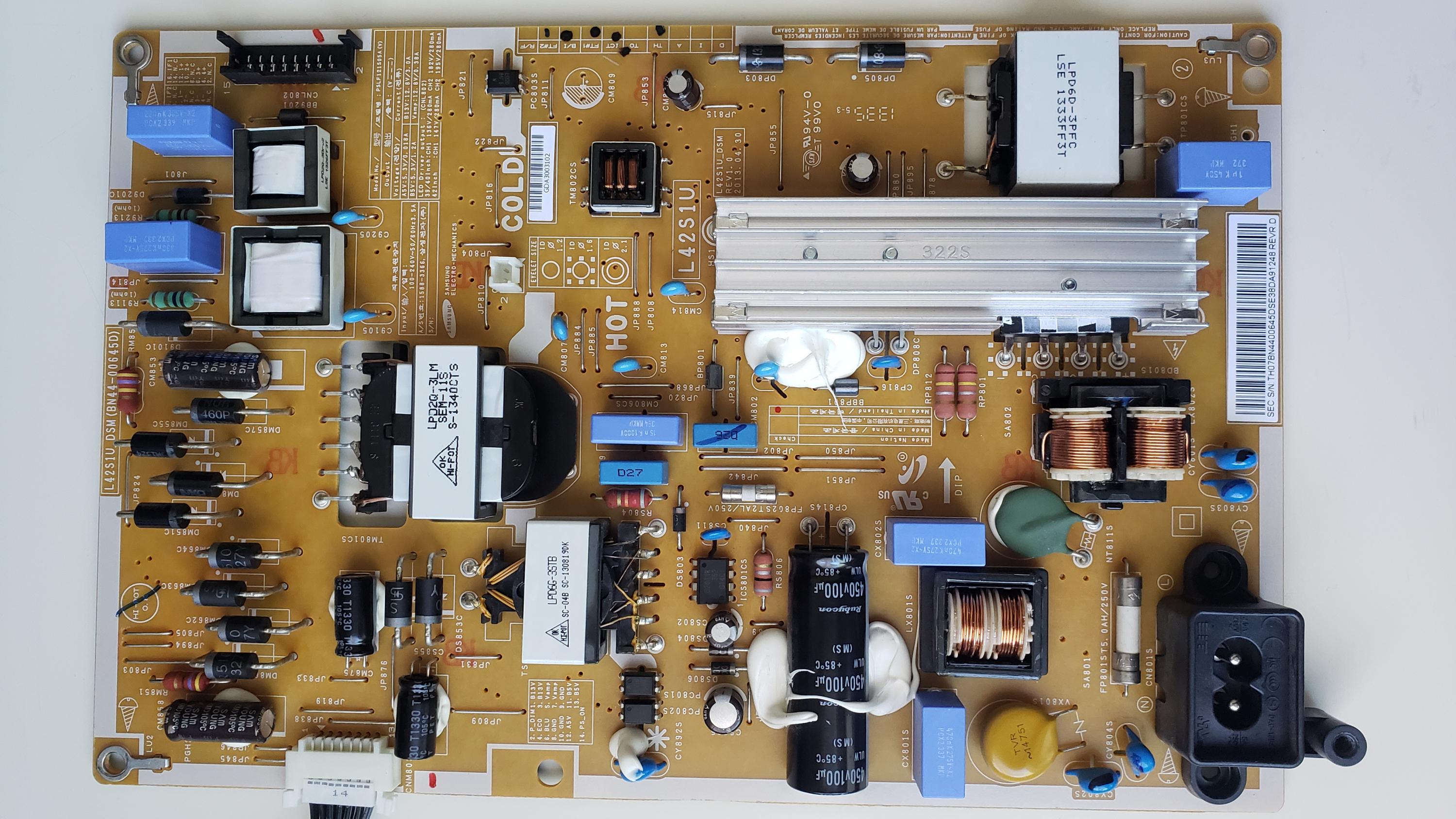

    I have this tv where PSU is not working as expected and tv is not turning on. Backlights are not on where mainboard is disconnected. Tested all the strips and looks like one of the strip has bad LEDs. However even after disconnecting mainboard and led strips, the voltage on the main caps is not stable and jumping from 171v to 230v. Below are the reading on the power connector to mainboard -
    Pin1 (B13v) - Jumping between 5.9v to 6.5v
    Pin2 (P Dim) - Jumping between 2.1v to 2.5v
    Pin3 (B13v) - Jumping between 5.9v to 6.5v
    Pin4 (ECO) - 0V
    Pin5 (Vamp) - Jumping between 5.9v to 6.5v
    Pin6 (BLU) - Jumping between 1.9v to 2.3v
    Pin7 (Vamp) - Jumping between 5.9v to 6.5v
    Pin8 (GND)
    Pin9 (GND)
    Pin10 (GND)
    Pin11 (B5v) - Jumping between 3.7v to 4.2v
    Pin12 (A5v) - 5.3v
    Pin13 (B5v) - Jumping between 3.7v to 4.2v
    Pin14 (PS_ON) - 3.3v
    Can somebody give me starting point to investigate the issue?

    Re: Samsung UN40F5500 - PSU not working
    What do you get on main cap. when you push power button.

        Start by checking all the diodes in the secondary side, It looks like the power supply sis shutting down to to a high load.

          May also have a PFC fault.

            If all the diodes check out ok, I might suspect one of those 3 electrolytic caps right there by the connector, try heating them up with a hairdyer, see if tv comes on for a bit.

                  Tested all the diodes by removing one leg from the board and looks good. The voltage is jumping on 13V line which is causing jumping on B5V line as well. Not sure if it's primary or secondary side at fault. I suspect the primary as the voltage is not stable on main caps also. After bridge rectifier it jumps on all the components.
                  Found this schematic of similar board not the exact same but those are replacement for each other on few tv models. https://cdn.badcaps-static.com/pdfs/...a77e44cdba.pdf
                  Update : I get 0v on the Source and Drain of the IC QP801CS (part# 60R360P).
                      On the schematic, QP801CS is the pfc mosfet, if you get 0 volts (reference to HOT ground) on the drain, check for bad connections tp801cs and BBP801, I suspect you have a wrong voltage reading
                          My bad! 0v readings are on Gate and Source, 173v present on Drain and it's stable. I'm using main caps -ve terminal as a ground.
                          I have removed the PSU and not not connected to anything, however it should be on in case of Samsung I believe. Also no change if I connect mainboard.
                          Addition: I believe Source is connected to GMD only so 0v is expected (ideally I should not measure that ).
                          Update: ZDP803 tested with Diode mode read 0v and shows continuity while remaining on the board. Could this be issue?

                            Check your voltage across CS802, CS805 and then CP812. It may be that CS805 is bad, it is the cap that supplies the vcc voltage to the pfc ic via QS801
                              CS805 - 18v
                              CS812 - 9.1v
                              CS802 - 6.3v
                              All voltages are stable.
                              ZDP803 tested with Diode mode read 0v and shows continuity while remaining on the board, as mentioned in post#13. Could this be issue?

                                What is the voltage across CS805? I don't think ZDP803 is on the board. I think you are likely checking BEP801 (coil)

                                    CS802 is likely ok, CS805 does seem to be a bit low, I would thing it should be above 20v, I would try replacing CS805 47µf/50v
                                    The voltage across CP812 should be around 15v
