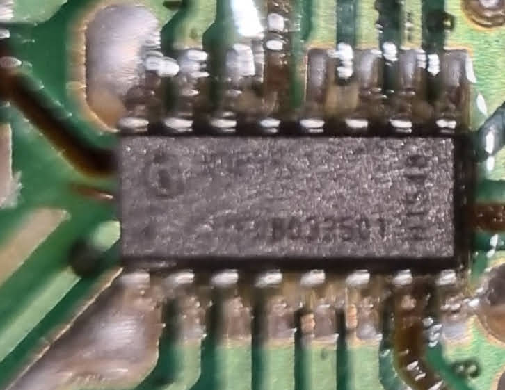

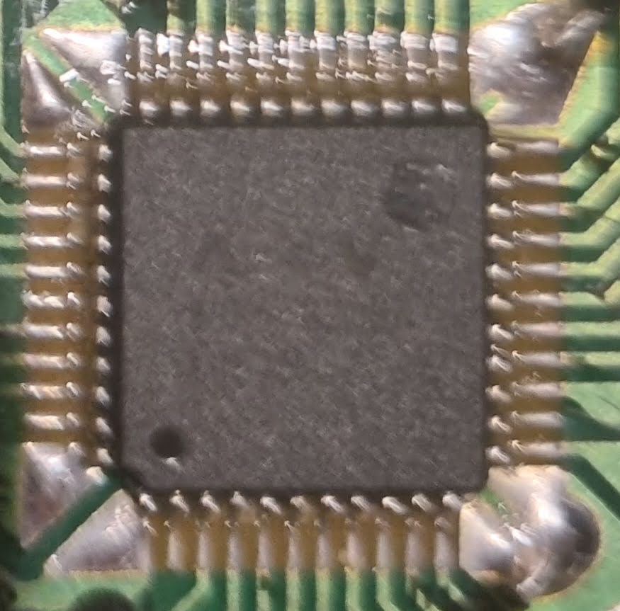

      Re: LG 65UH652T won't turn on
      Originally posted by dskall
      I really need to know what the part numbers are on those 2 controllers on the back.
      Here are the two controllers. I can't make out much on the square one unfortunately and this is the best photo I managed to get.
              Without controller # I can't really help you. I suspect controller is not starting up. Need to check vcc to controller. I would also check diodes on heatsink. Still seems like a short that is shutting controller down. R_J would be the one who could help.
