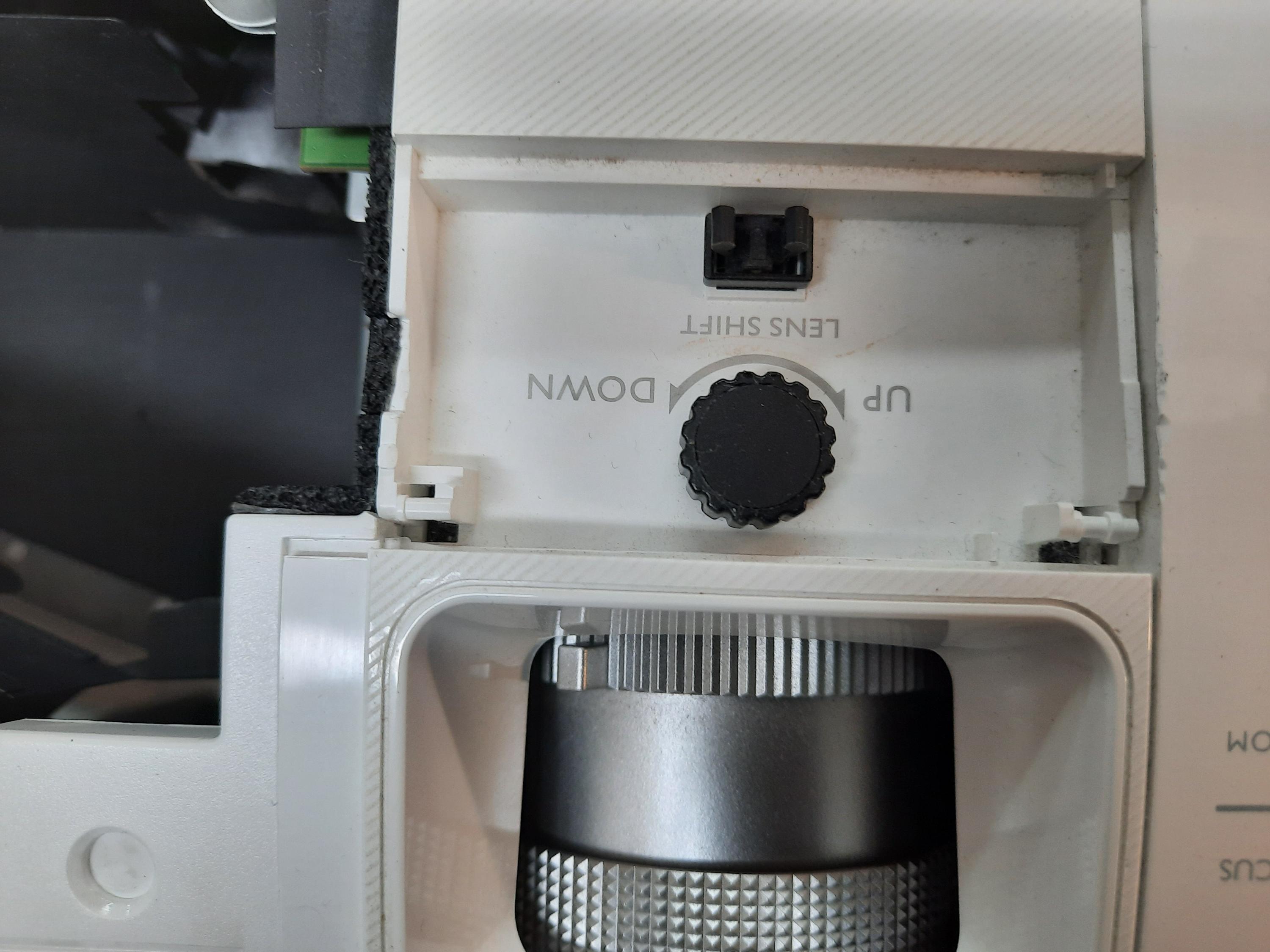

    Hi all
    This is my next challenge .
    Has a PSU issue , but cannot even start , as top cover won't come off .
    Have removed all screws , but cannot seem to pull lens shift control off , so that i can remove top cover .
    Don't want to force too much & break it .
    Anyone experienced this ?

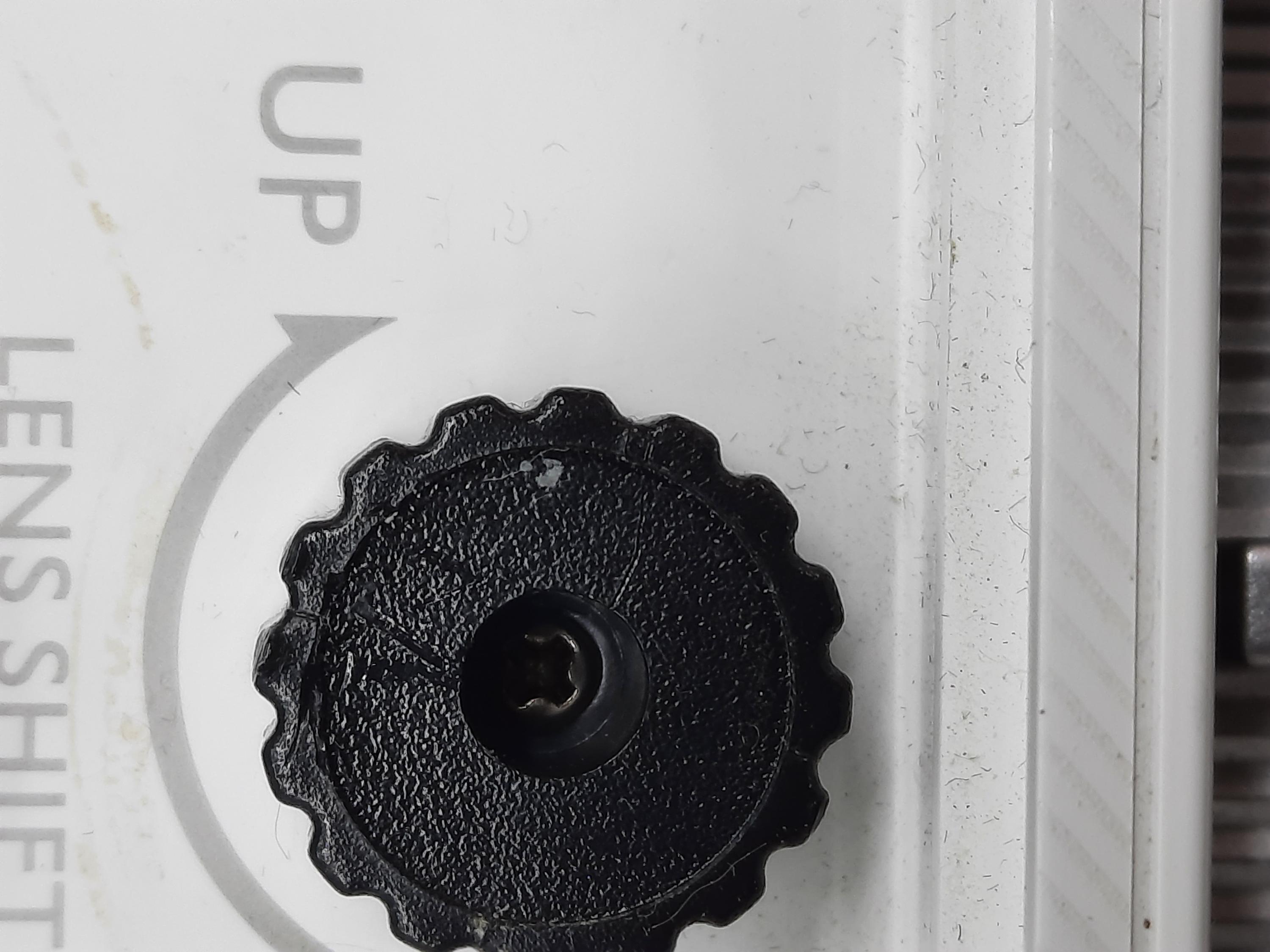

    I have the same problem with a Benq W1400. I am not able to remove the vertical lens-shift screw.
    EDIT: LoL, just found out myself: There is small black plastic plate on top of the black plastic wheel. I removed it by accident when trying things. Anyways, inside the center of the wheel is a small metal screw. After removing it, you can lift the top panel.

      Re: W1400 BENQ project help
      Thanks very much
      Will give it a shot .
      • zen
        • 511
        Yep spot on .
        Not sure how i managed to miss that .

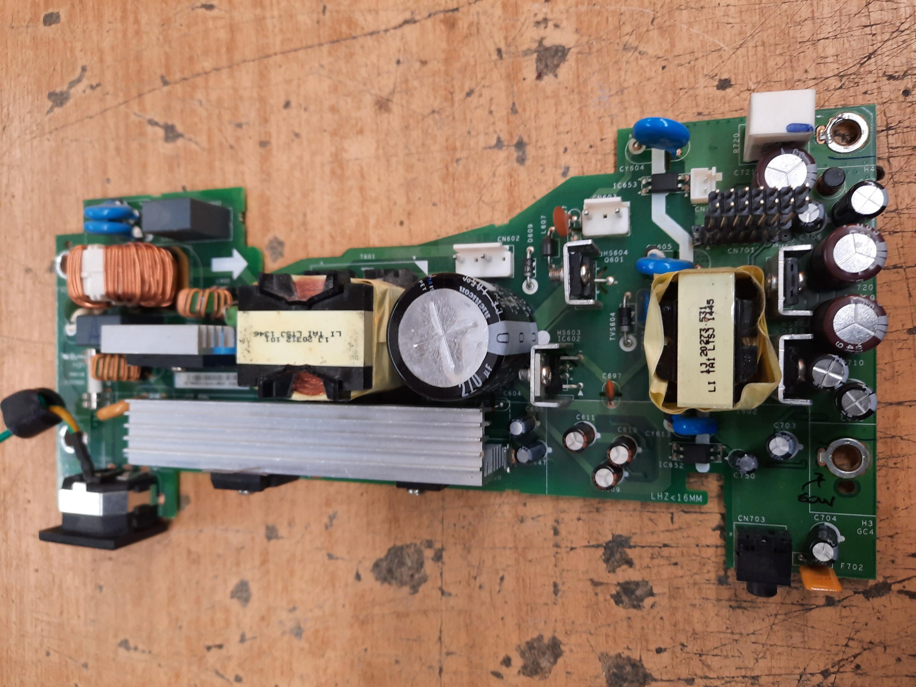

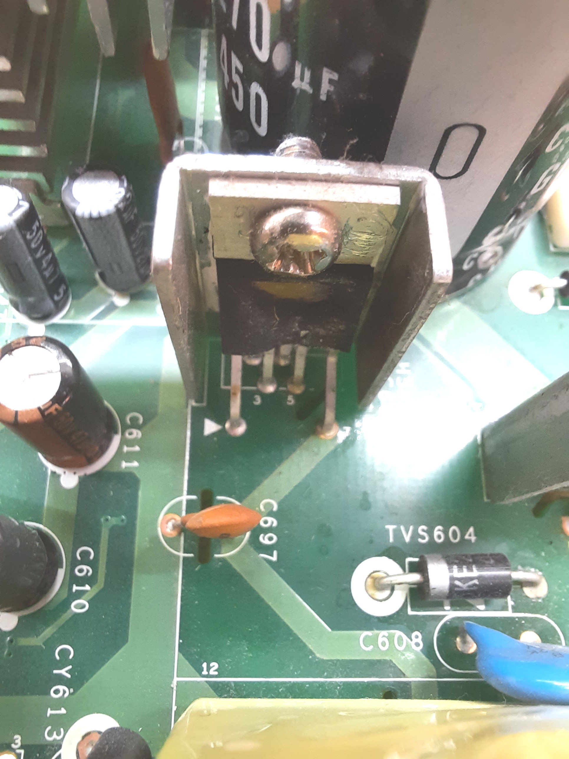

          Now onto the PSU issues .
          IC602 ( TOP256YN ) , blown apart .
