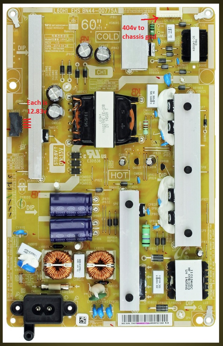

    Now the TV turns on. The back-light stays on, but no image. The open voltage test to the LEDs is 404v to chassis ground, and I get 12.83v to the digital/tuner/mother board with the cable connected to the power supply.
    I get no sound. The power LED on the lower right flickers when I change channels on the remote.
    What can I do next? Is 12.83v a little low since the silkscreen says 13v on the power supply board?

    check and see if you have 12 volts on each side of the fuse on the tcon board, black probe on chassis ground.

                The voltage at the T-Con fuse was 12.25v on both sides of that fuse, and that is a 7amp fuse by the way....

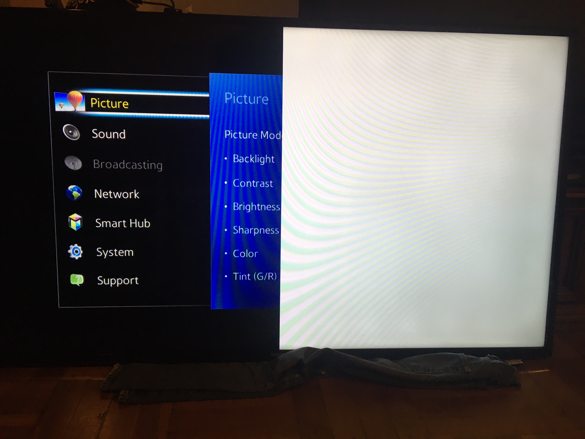

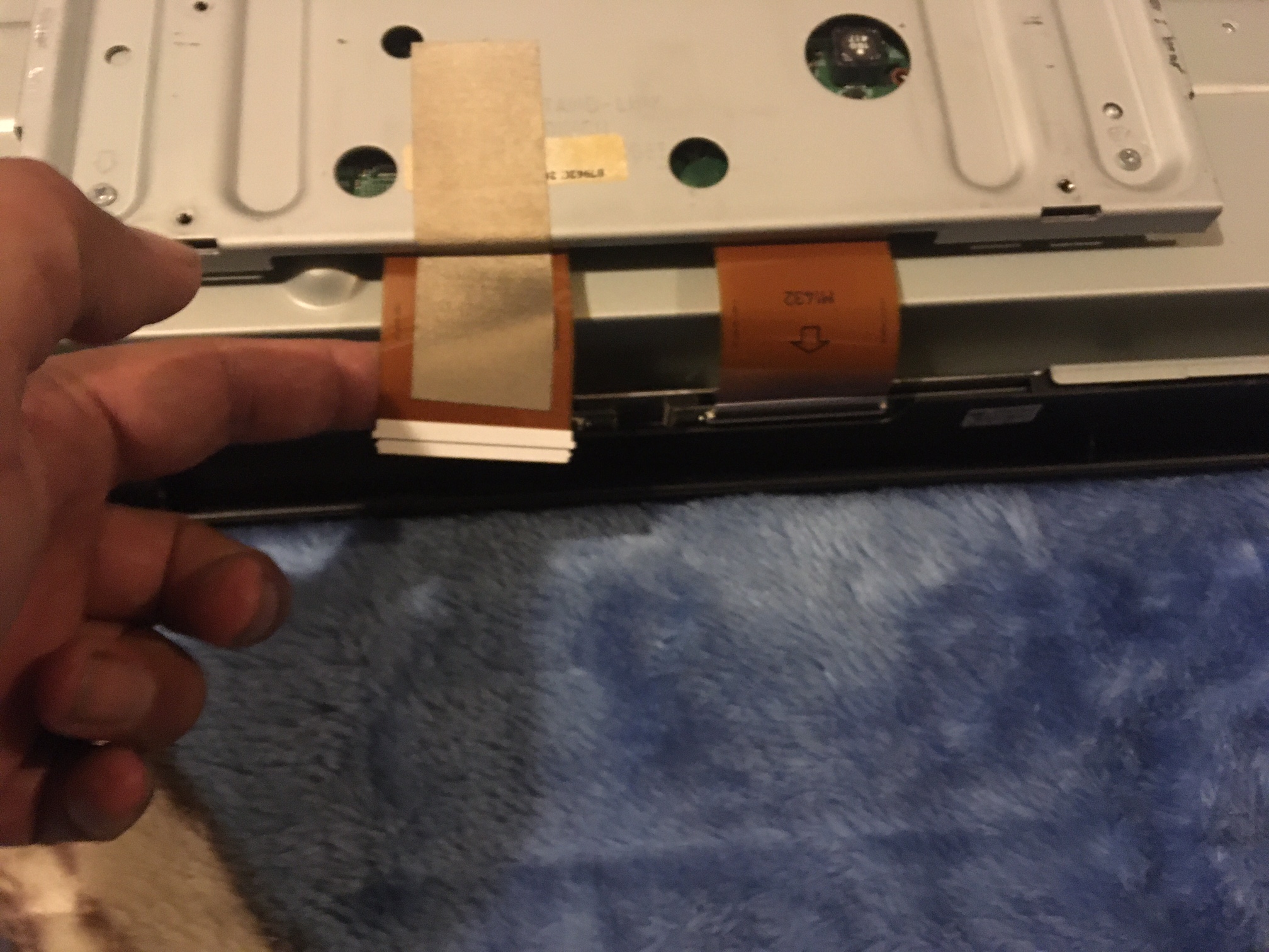

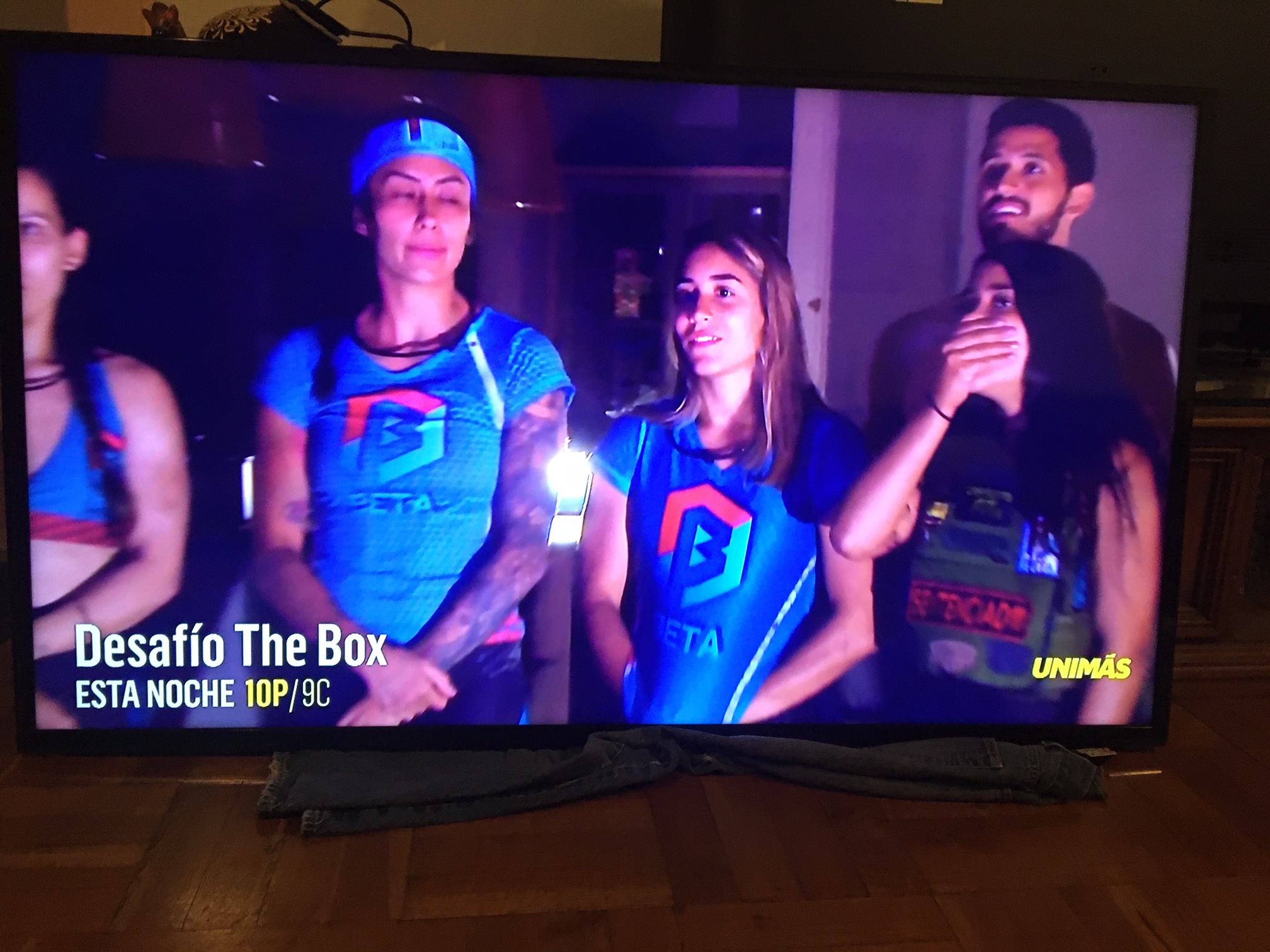

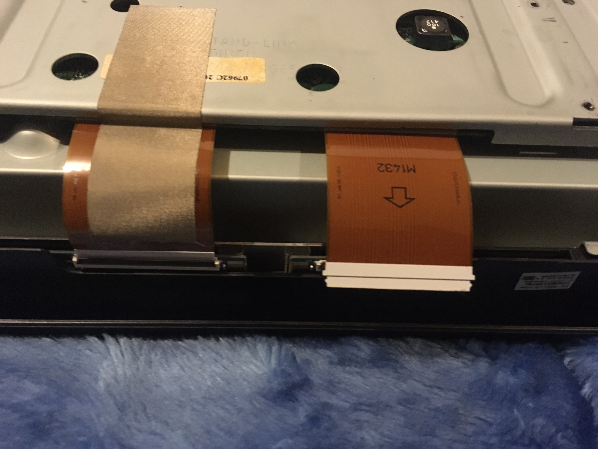

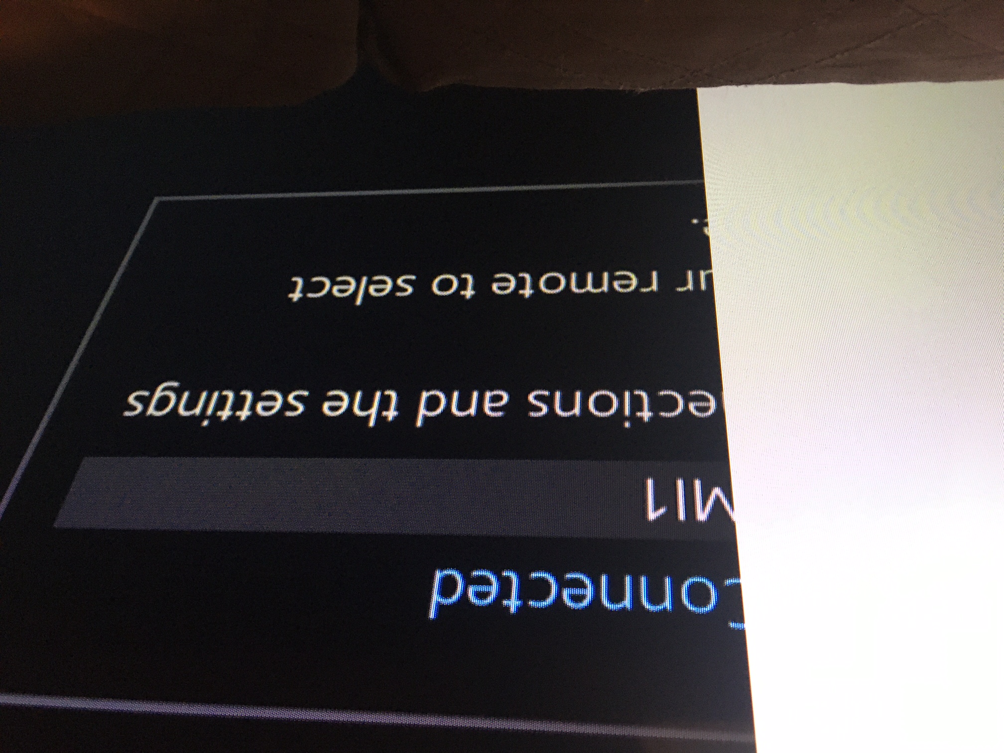

                I was not going to disconnect one side of the T-Con cables-What the heck was it going to do?? Well to my surprise, I got half the screen to WORK!!!! I shut down the set, and I tried the other side of the T-Con cable. The other side works. For giggles lets plug the cable back in and turn on the set, and what do you know. Whole set worked!!!!!
                So imeadatly I lowered the LED intensity to like 3 or 4, and selected the input source from HDMI to Areal TV reception. The TV scanned the channels, and it works like a charm...
                What gives that it did not work before?
