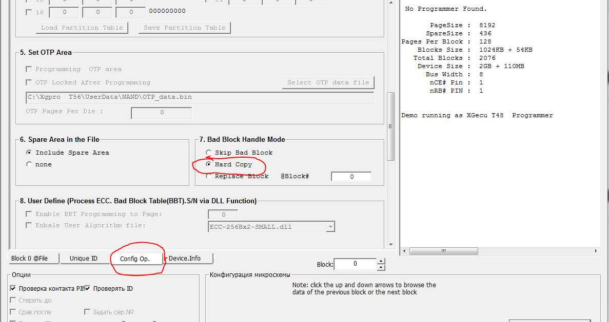

                #67
                Re: Ue55mu6172uxxh, bn94-12438k
                Originally posted by alex39t
                this the bad blocks after erase
                Try it, write it down as is (Hard Copy), no need to check the box to skip bad blocks.

                  #68
                  I test it but still loop to the tv i made some thing wrong with programmer?
                    What it is hard copy?

                      #70
                      hard copy
