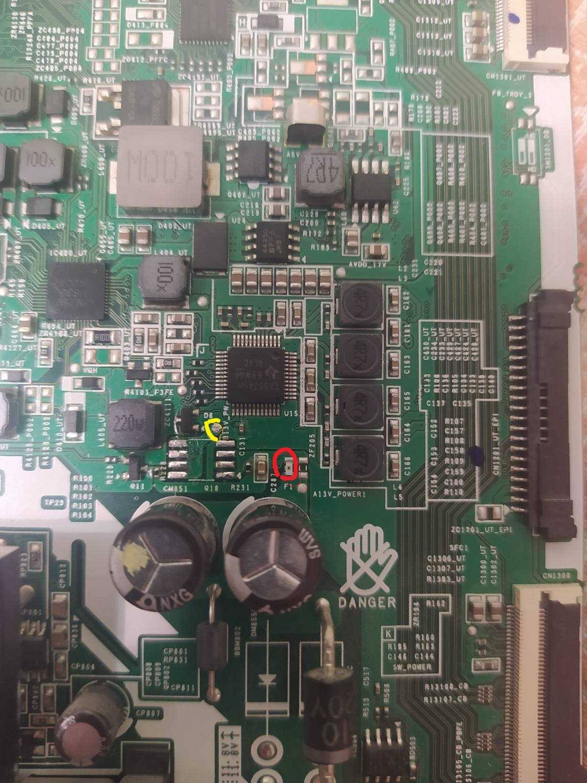

                  I have a BN96-46782A stuck in standby that tries to get out of standby every 10 seconds or so, no backlight, no picture. Red led flashes. Already tested with another board and it works fine but I wanna repair the original one. Is by any chance a faulty eeprom? I think its fine but can iotas please check it?

                    But you have a completely different chassis, BN96-46782A belongs to the "NU" series three in one (power supply, motherboard, t-con), there were cases of smd fuse burned out at 13v due to a short circuit of the ceramic capacitor on this bus, dump your not much different from others, slightly corrected, check.

                      I had 2 cases with burned fuse. I fixed both of them. 2 shorted chips as far as I remember. This was was previously worked by another tech and had few missing components. Also 2 caps 470v 35v(those in the picture that you posted above) were replaced. I replaced everything from a scrap board but now the tv makes a slight buzz and tries to start up and fails then it repeats. Every voltage is fine about 400v on main cap, 12v, 2.5, 1.2, 3.3, processor gets warm(in these series it should get very hot). Don't know what else to check. I will flash the dump tomorrow and I will report back. Thank you

                        You should also have 5v. Do you have voltage at pin 8 of eeprom?
                        • ducky29
                          • Dec 2015
                          • 369
                          • Europe
                          Re: Ue55mu6172uxxh, bn94-12438k
                          Only 3.3v on pin 8
                          • dskall
                            • Oct 2016
                            • 2905
                            • usa
                            You have no 5v anywhere? 2.5v doesn't look right to me. If you have buzz, I would be checking for shorts on power rails.
                            Also you need around 1v on your oscillator.
                            • ducky29
                              • Dec 2015
                              • 369
                              • Europe
                              I just checked 5v is fine as well just dissapears when the tv retries.
                              There is also about 260v on the leds but they never light up.
                              56 leds in total
                              • dskall
                                • Oct 2016
                                • 2905
                                • usa
                                So it seems it's coming out of standby. Maybe shutting down because of backlights. Do you get optical port to light up? What backlight voltage did you get on other board?
                                • ducky29
                                  • Dec 2015
                                  • 369
                                  • Europe
                                  I get 96v on the leds on the other board. Backlights are ok i checked with led tester and with the other board.
