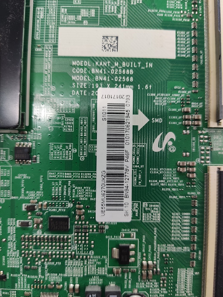

                                    Meanwhile, this topic looks like a perfect for me
                                    I own a similiar model: UE55MU6272U, (curved glass) with the same infamous failure: no standby light, and backlight only when mainboard is disconnected.
                                    I readout IC801, IC1603 and IC1604, please find them in attachment. If they can be saved, I would be grateful.
                                    I have Xgecu TL866II Plus programmer.

                                      Try.
