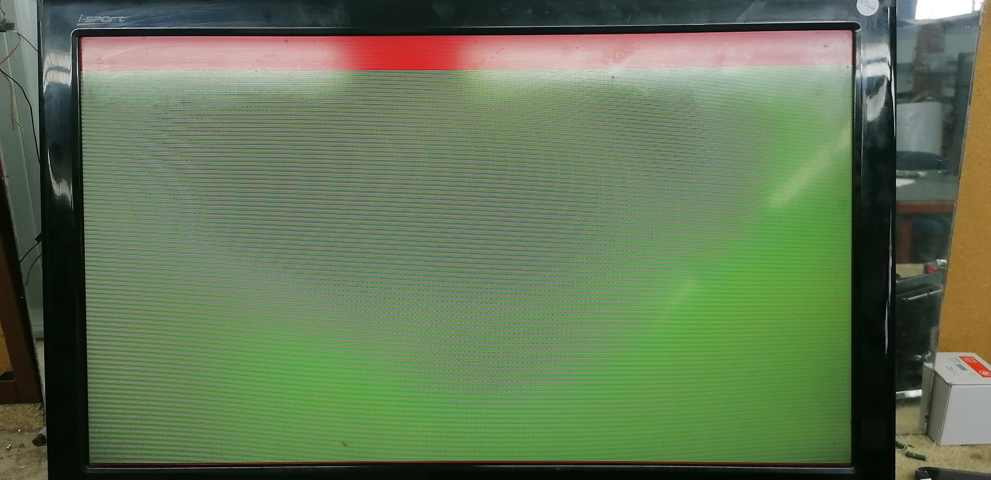

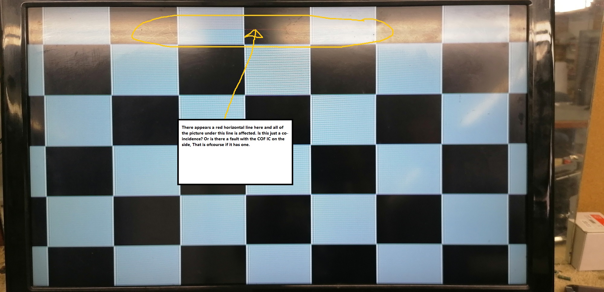

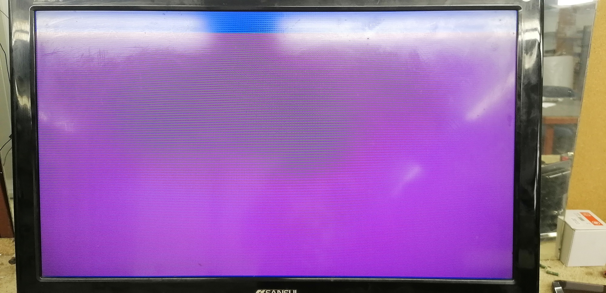

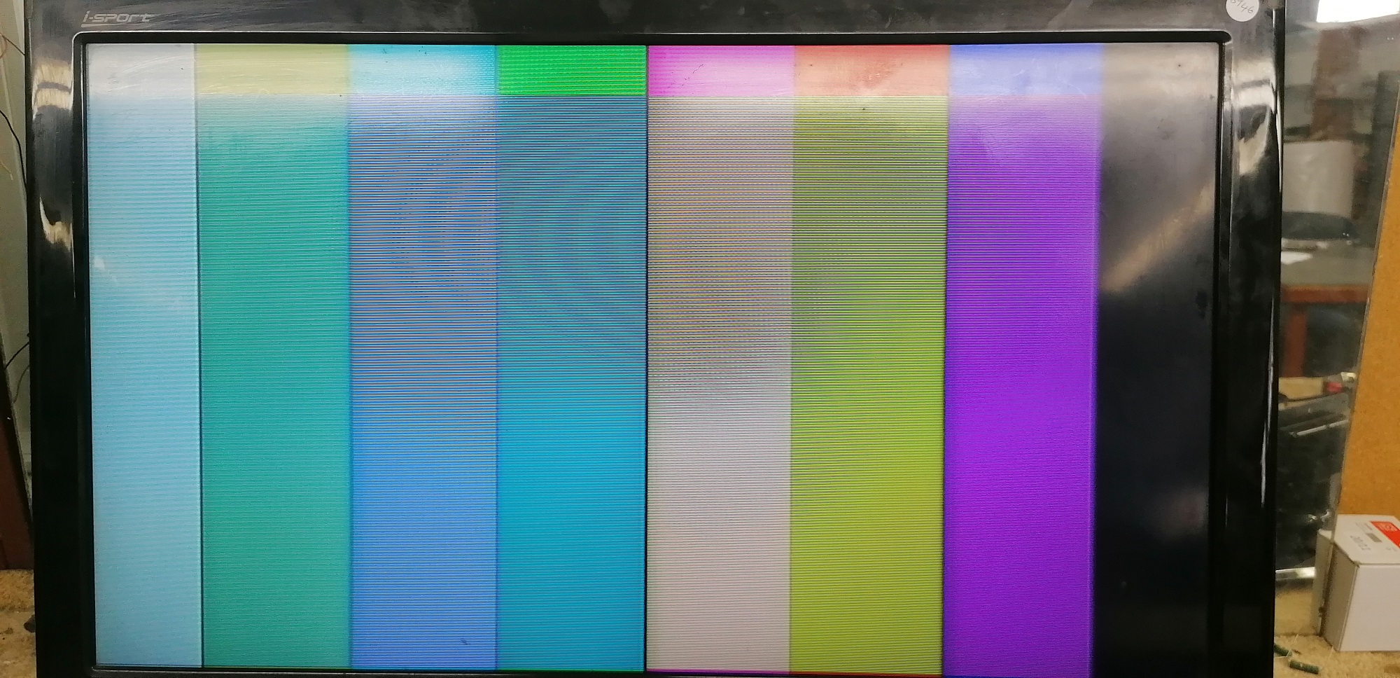

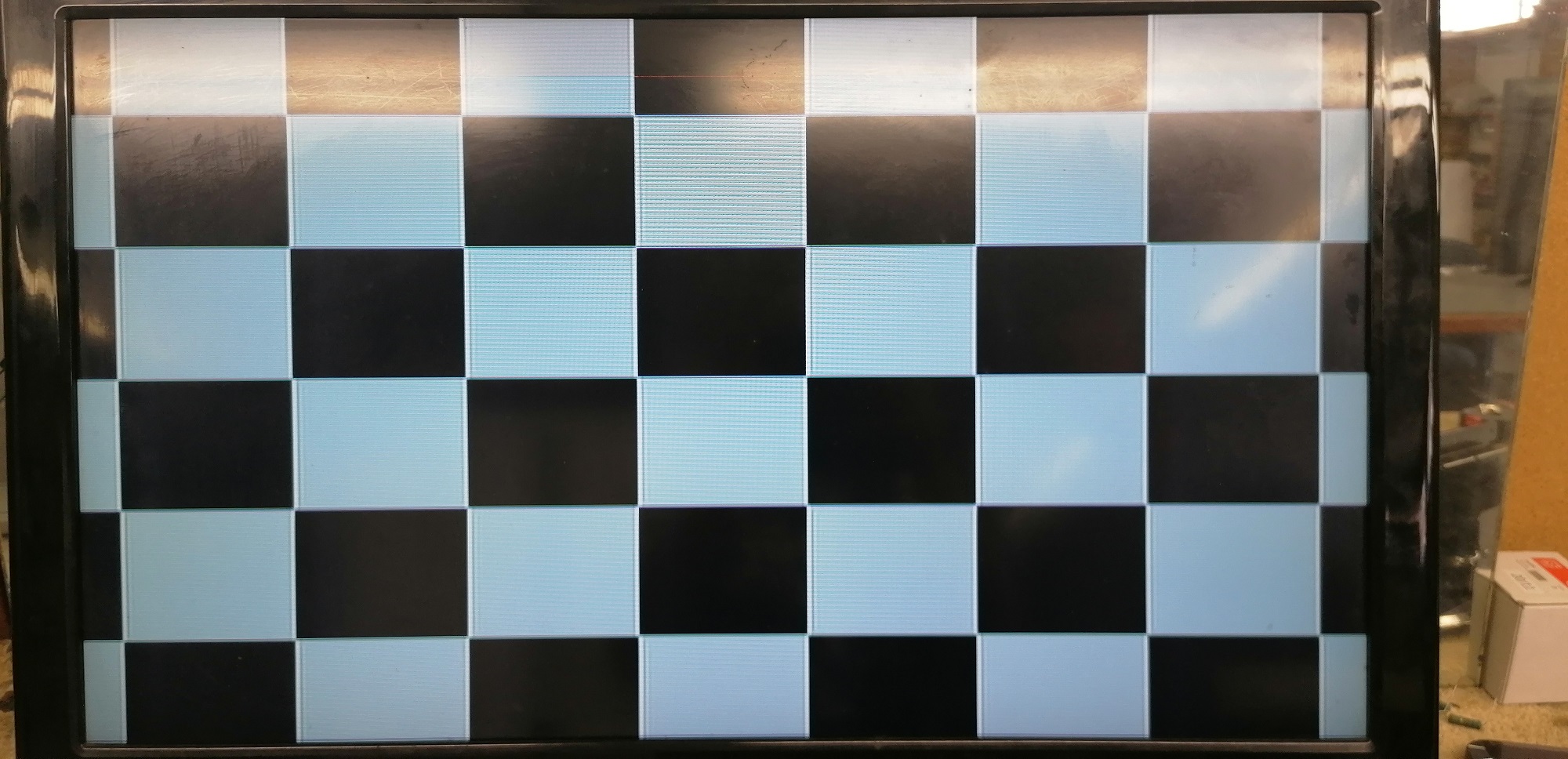

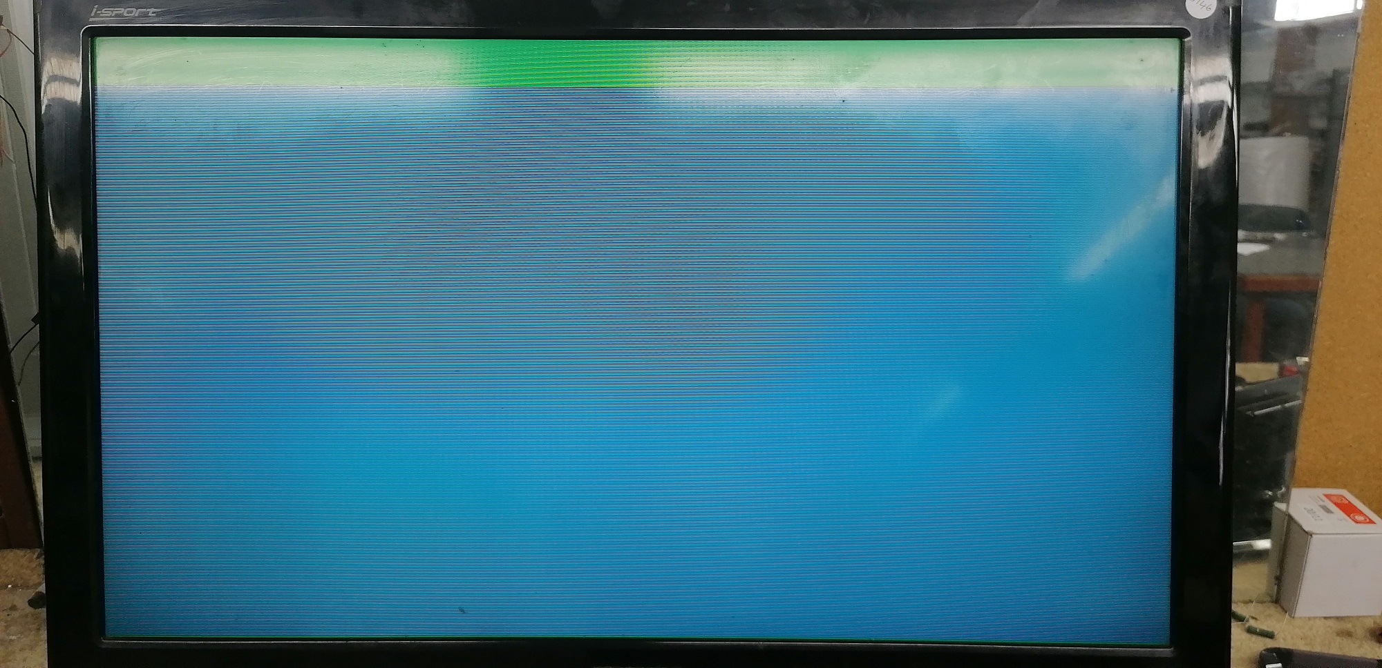

    Hi Guys, i have this set that seems to show the colors all wrong. This is not a solarized image but just seems to light up the wrong colors in a horizontal sense. I have added some still images so that you can see. I have a pattern generator so i set it up for you to see the following picture.
    1. Red raster
    2. Blue Raster
    3. Green Raster
    4. Checkered blocks
    5. Color bars
    I have also added a video of the tv so you can see it.
    https://youtu.be/MA_PnKLacoY
    As you can see the screen updates fine its just a color jumbled image with the first top inch being perfect.
    The question is, is it TCON or panel fault?
    Your input would be greatly appreciated,
    Regards
    Angelos

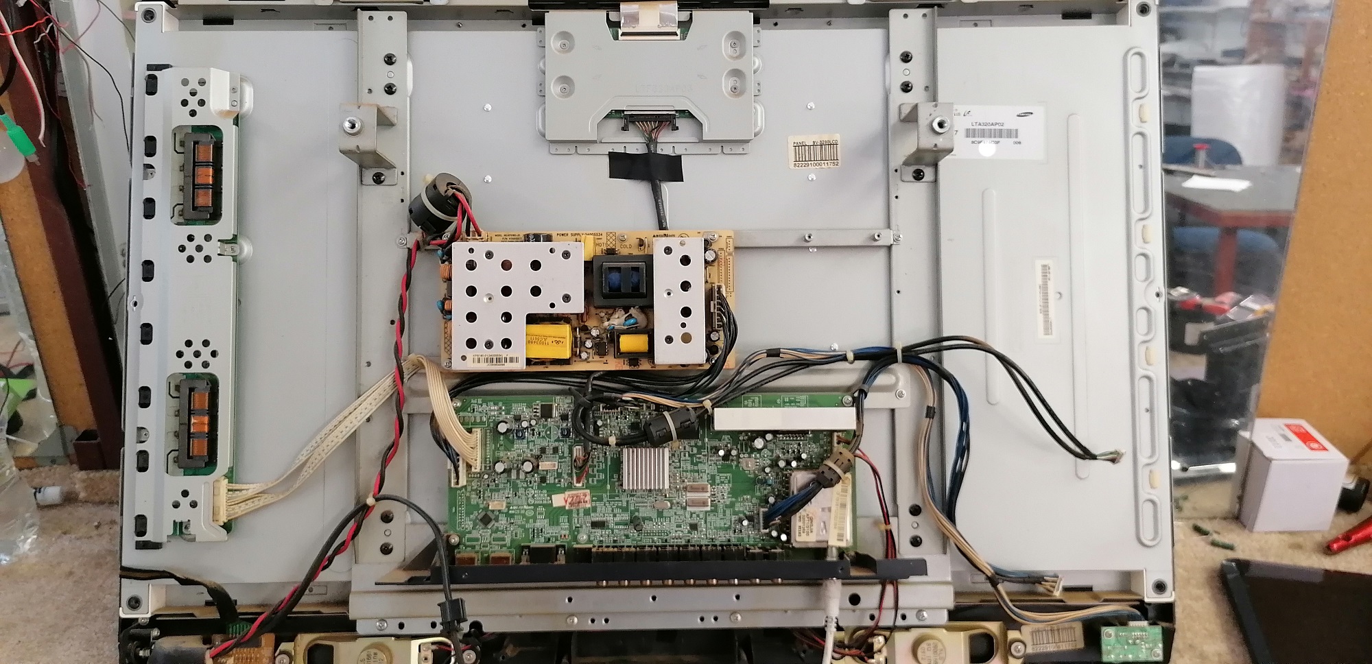

    Here is the layout of the back of the TV.

          Nope, its not the entire screen doing this but rather 90% of it. The other 10% is perfect always. The first inch on top is fine, check the photo's.

              Re: Sansui 32" LCD TV Model SV-3208LCD bad color
              Check the photo I have attached for a proper explanation of the fault.
