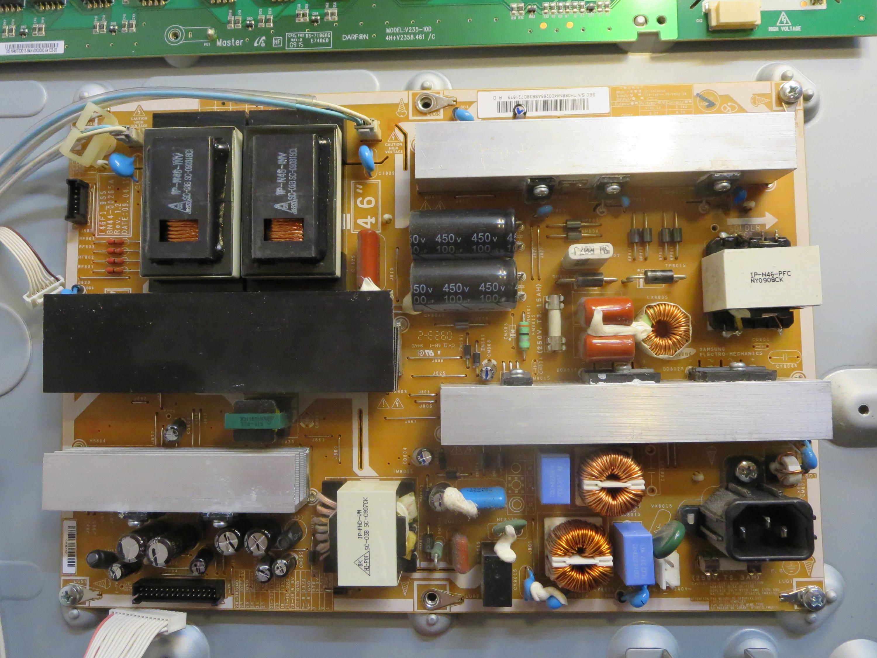

    Samsung LE46B650 leds turn off in less than a minute.
    TV itself is working fine otherwise. Disconnecting AV board shows the same behavior. Typically LEDs will be turned off in about 10 seconds.

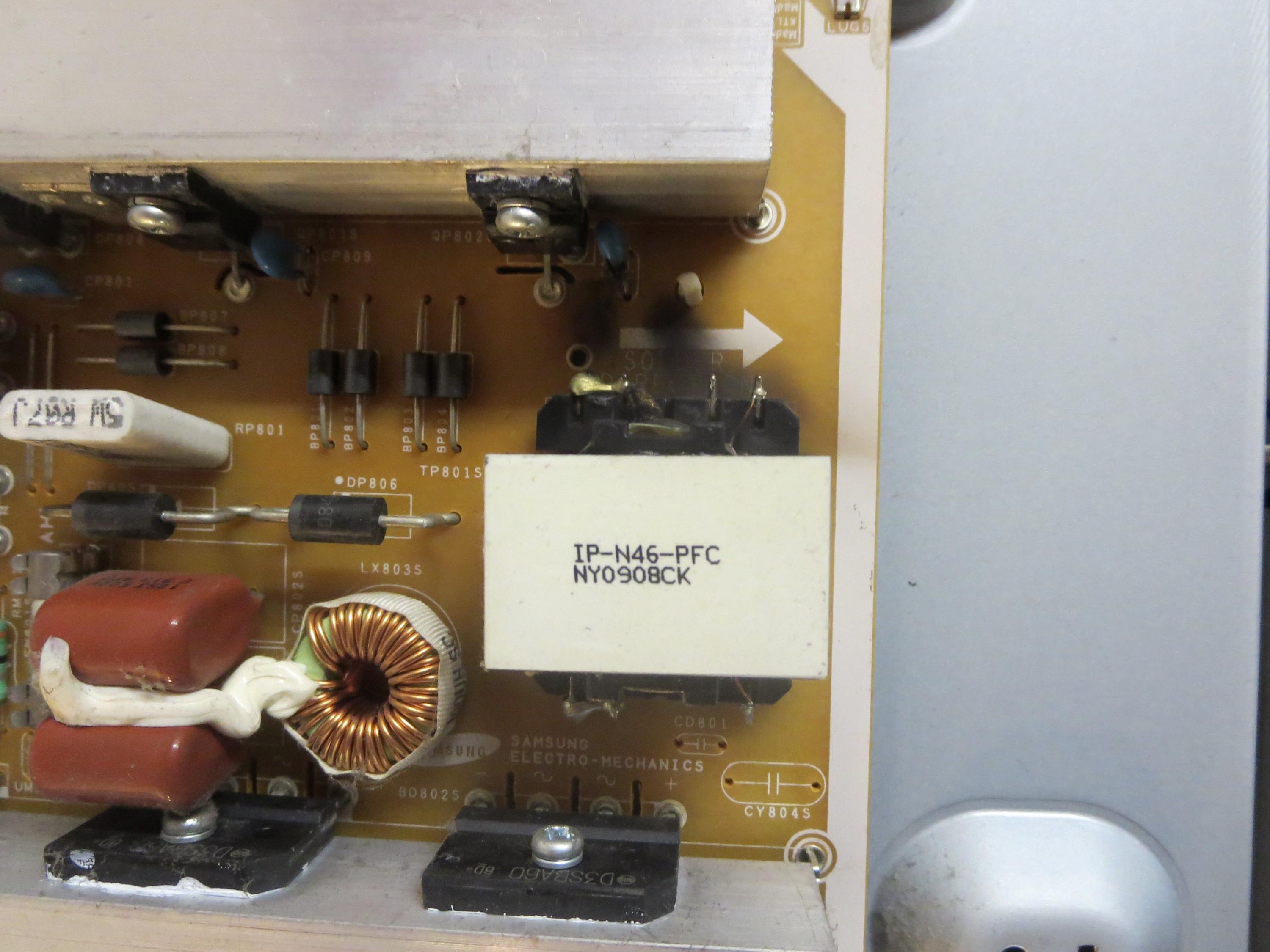

    IP board is a BN44-00265A. I found a bad Capacitor and replaced it.
    Near that Capacitor is a Transformer: IP-N46-PFC which looks burned but it could have been from the Capacitor nearby.
    I measured 13.x V on the primary Side and nearly nothing on the secondary. I suspect I would have to replace it but I am not sure about that. Both coils have next to no resistance (0.001 Ohm).
    Trying to find a replacement however gave no results on search engines. Maybe someone has an idea on which transformer could replace it? Sadly I could not find a schematic on BN44-00265A.
    I have read about older CCFL pulling more current. That could explain the shutdown of LEDS too... replacing the transformer to me looks more promising at the moment.

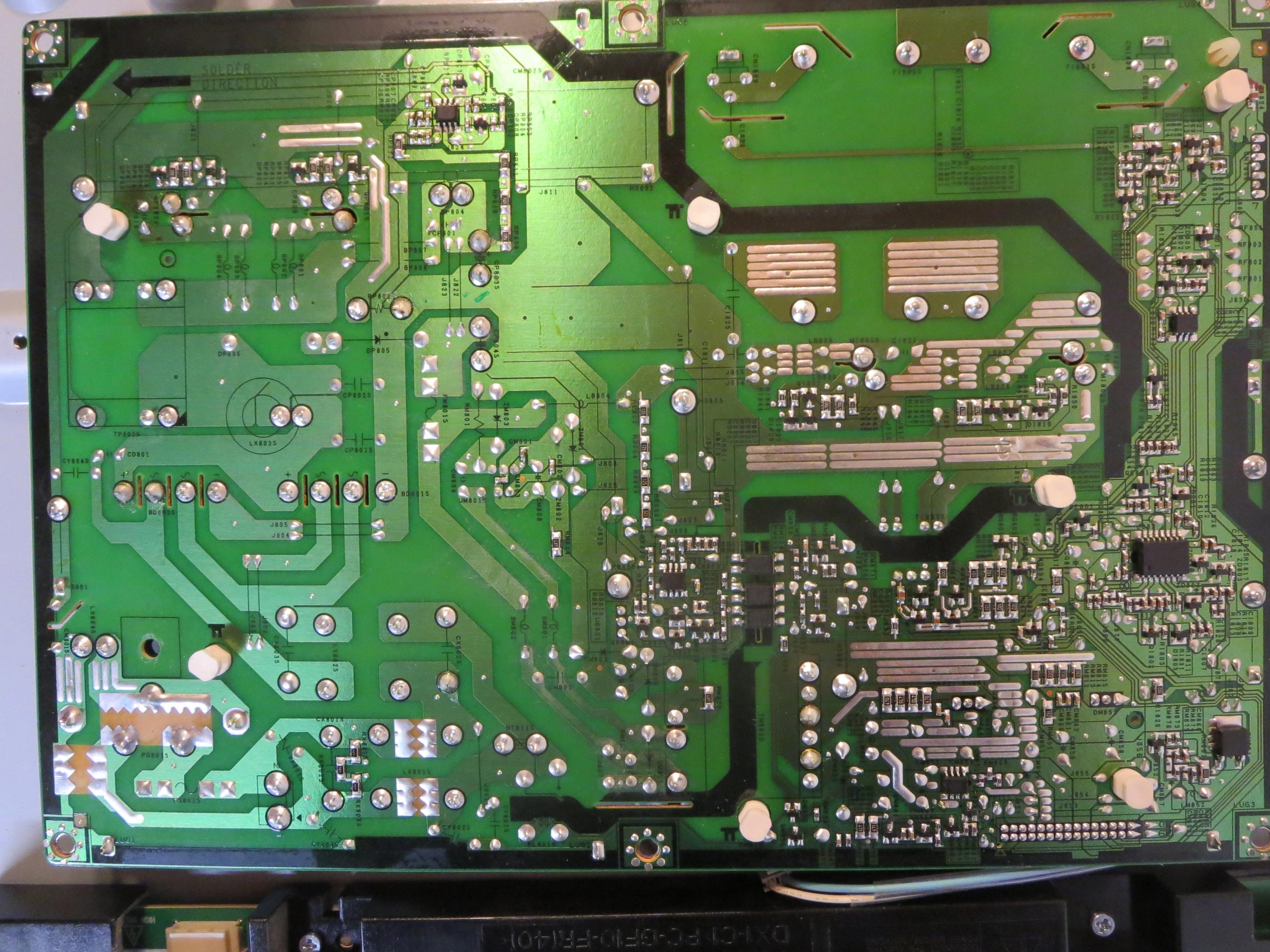

    Those are good clear pictures, can you post one of the underside?
            Sure thing!

              Re: Samsung LE46B650 leds turn off in less than a minute.
              That transformer is the pfc transformer, it should be ok, Check the voltage across one of the main filter capacitors (100µf/450v), when the tv is in standby it should be (based on 230vac line voltage) around 325vdc, when the tv is powered ON it should rise to about 385vdc

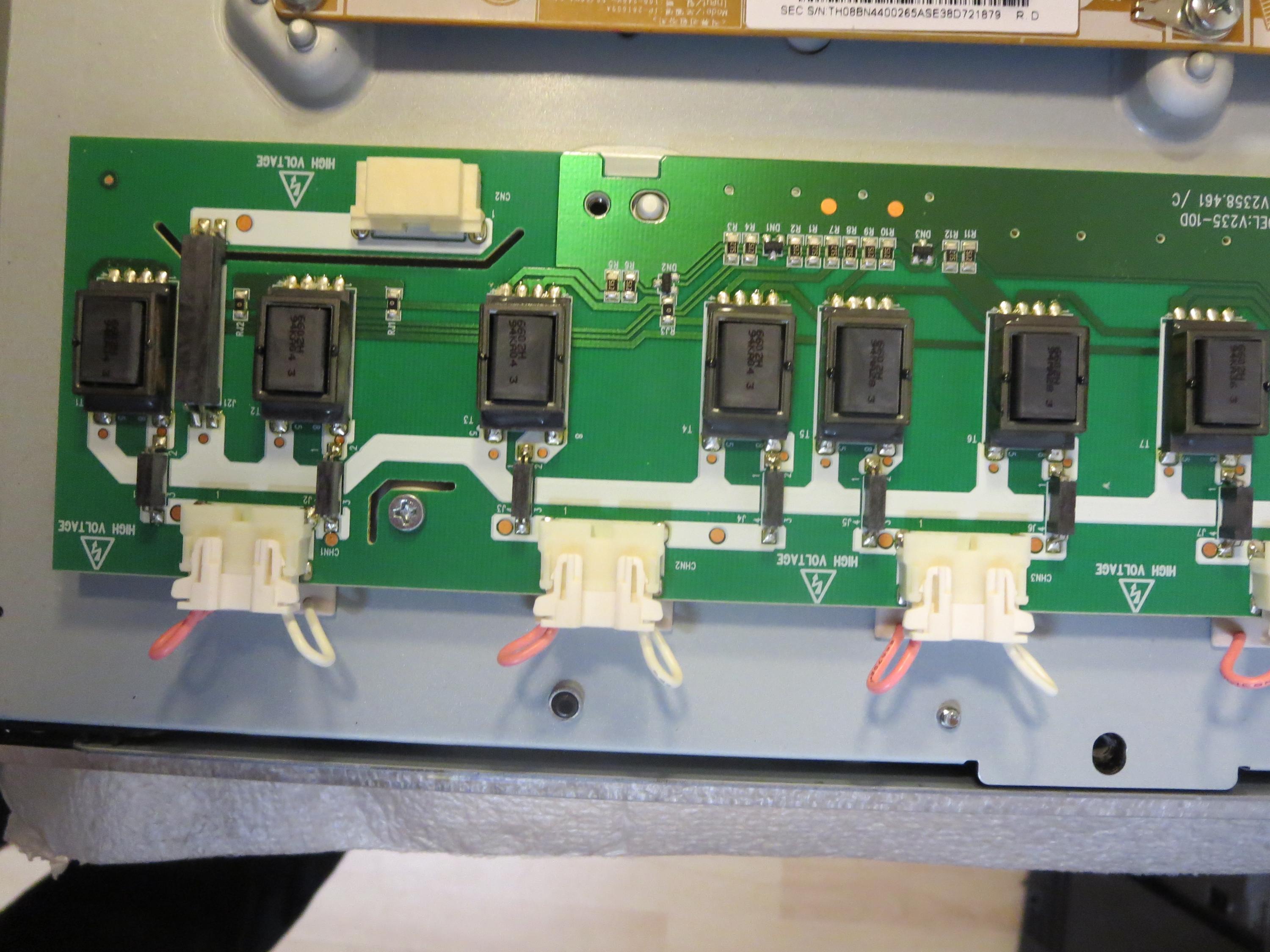

                Inverter testing there, heed HIGH voltage warning: https://www.youtube.com/watch?v=oE6K4xBVweA

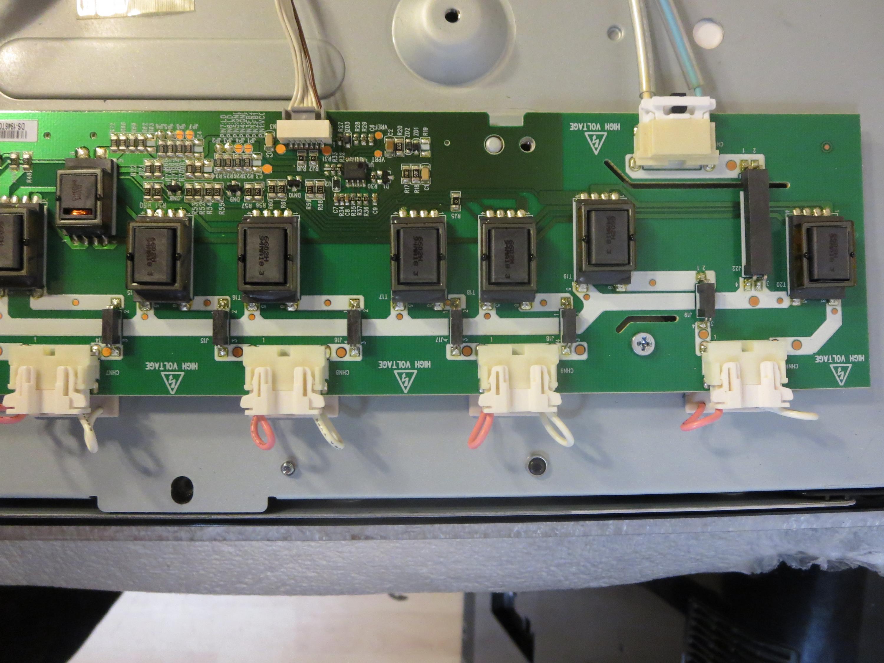

                    nomoresonys@: yes, that is a very nice video on how to find a faulty CCFL. Since I have measured all transistors on the inverter board and they all had the same resistances within 5% deviation or so I suspect a faulty Lamp at this time.

                          Yep, that video IS what you want to follow if you have a bad lamp, it takes the bad lamp out of the equation. It doesn't work on all tvs but the ones like yours with many mini transformers on the inverter it works for, I did one last year worked fine, down one tube but like he shows there, you will not notice it unless you look real hard. Watch closely he explains how he finds the problem, when he powers up the bad one jumps way up in voltage compared to the others, right before shutdown.

                                  - connecting ground of voltmeter to - (minus) of one of the two 450V/100uF capacitors and trying to measure voltage at measure dots on HOT side reveals about 132V but instantly causes backlights to go out, voltage of 132V however, stays.
                                  Any measurements you are taking on the inverter board are to frame, Or cold side. On your backside picture of power board. Everything inside the black line is HOT side. Everything else is referenced to frame ground.
