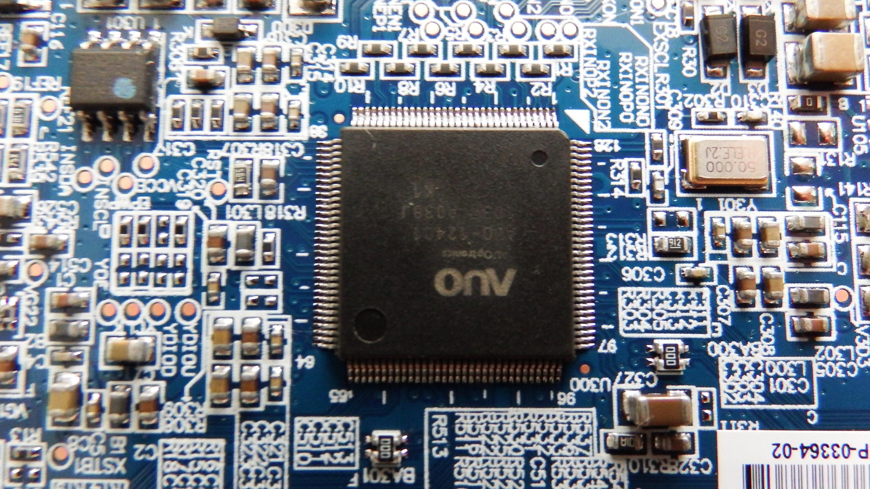

    AS15 analogs: AS15-G, AS15-F, TSL1014IF, SL1014I, HX8915, HX8915-A, RM5101, EC5575.

      Then I guess it's a faulty chip on the card, I can't see why every video I have see view where by either the card or chip change solves the issue.

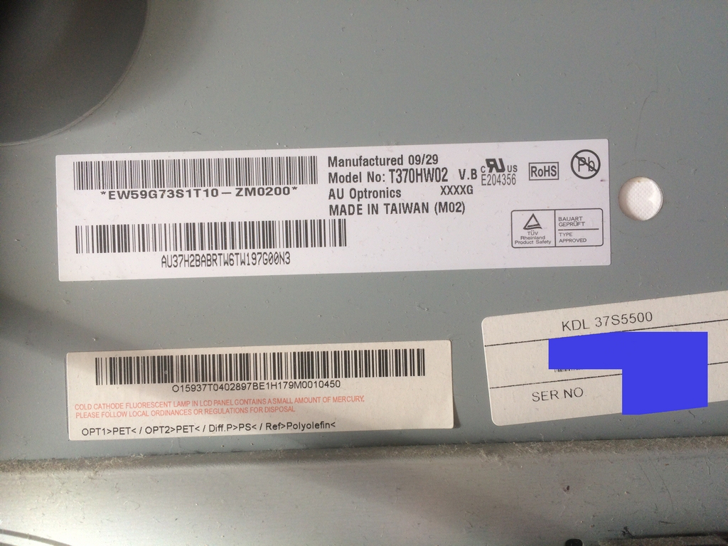

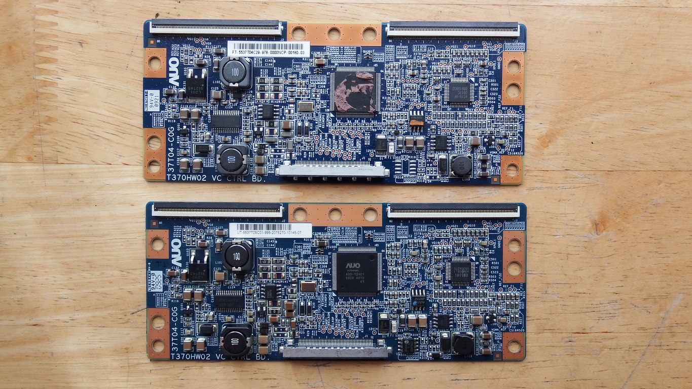

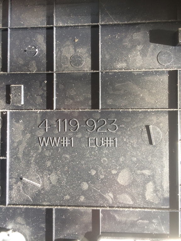

              Hi Everyone
              I have gone back to the card supplier. They say that you have different screen T370HW03 V.B and that I got is T370HW03 V.0
              I could not see any V.X
              As you will see the boards versions match so I am not sure if this is true.
              I attach a photo of the boards top was original one.
              Any advise regarding this, welcome.

                Re: Help with Sony KDL-37S5500 TV Display issue please
                It isnt clear, so WHICH of those is YOUR panel number?

                    #29
                    Hi nomoresonys
                    Please find attached photo's of the numbers inside the TV panel bar the serial number which I've blocked out.
                          Check this one, notice the panel number listed matches yours, so all those boards should work: https://www.shopjimmy.com/auo-55-37t...c-t-con-board/
                          • nomoresonys
                            • Jan 2013
                            • 12276
                            • U.S.
                            #33
                            If you notice, both those tcons are there, so they should both work, looks like your instinct was right, seller is apparently mistaken, I would get the refund.
                            • nomoresonys
                              • Jan 2013
                              • 12276
                              • U.S.
                              #34
                              Seller could be misinformed or they could just be trying to make it look like your fault for ordering wrong board, I think it's the right board, shop jimmy usually don't miss.
                                different t-con. if he refused to refund. try switch the spi flash of yours original on the replacment..
                                  If you have changed out t-con with another and have exact same problem, logic would tell you to start focusing on other possible causes.

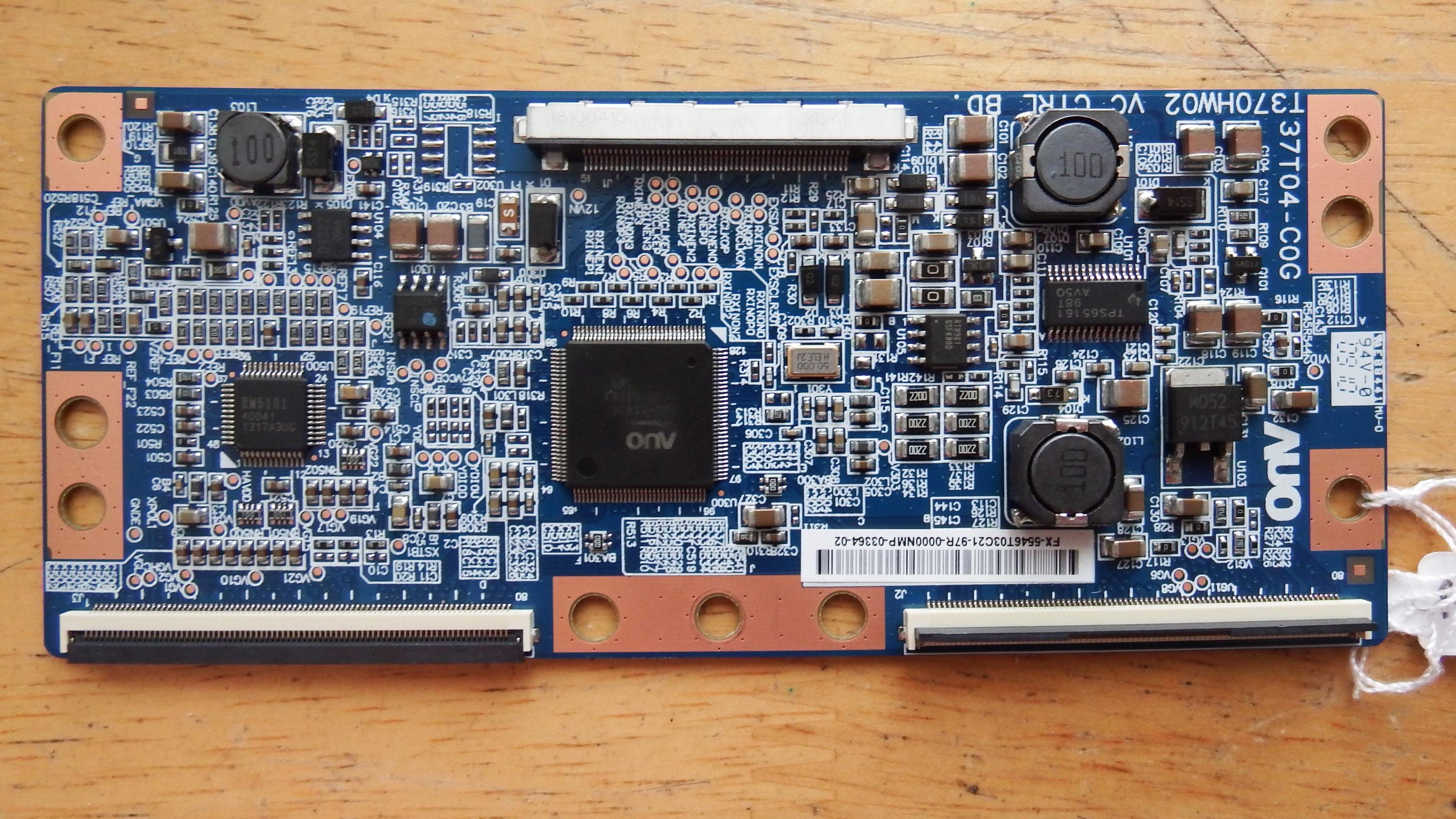

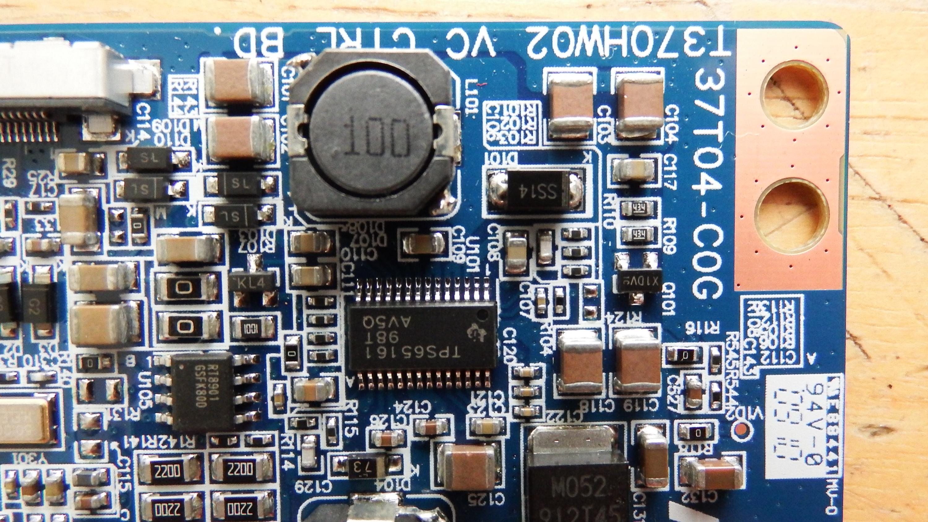

                                    Hi
                                    Is there a way how I tell that this card is either:
                                    T370HW03 V.B
                                    Or
                                    T370HW03 V.0
                                    I did try another card but it did not seat as easy on the ribbon cable. It also did not solve the issue.
                                    Also does anyone know where I can download the update for this to put on to a USB flash drive please.
                                    I have attached the other card, but the central chip looks like it's had something on it. another used card sold as new.
                                      that card there is version C, see the writing on it, T37OHWO2 VC.
                                      • nomoresonys
                                        • Jan 2013
                                        • 12276
                                        • U.S.
                                        #39
                                        that board is listed as a match for your panel number.
                                          Thank you nomoresonys
                                          It had the same issue as the original card but I could get both sides to work as well as the other card.
                                          So then I though do I put the old card back in and try via the USB and update if I can locate one.
                                          Or does in need re tuning from aerial after the card install.
                                          Else does know what other main component could cause the issue as everyone points to the card I have just replaced.
