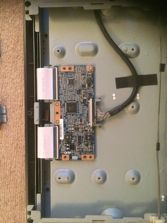

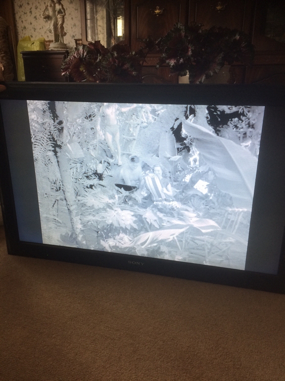

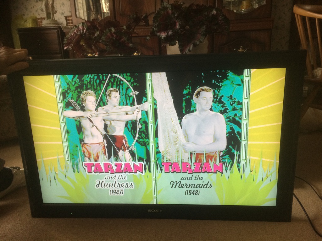

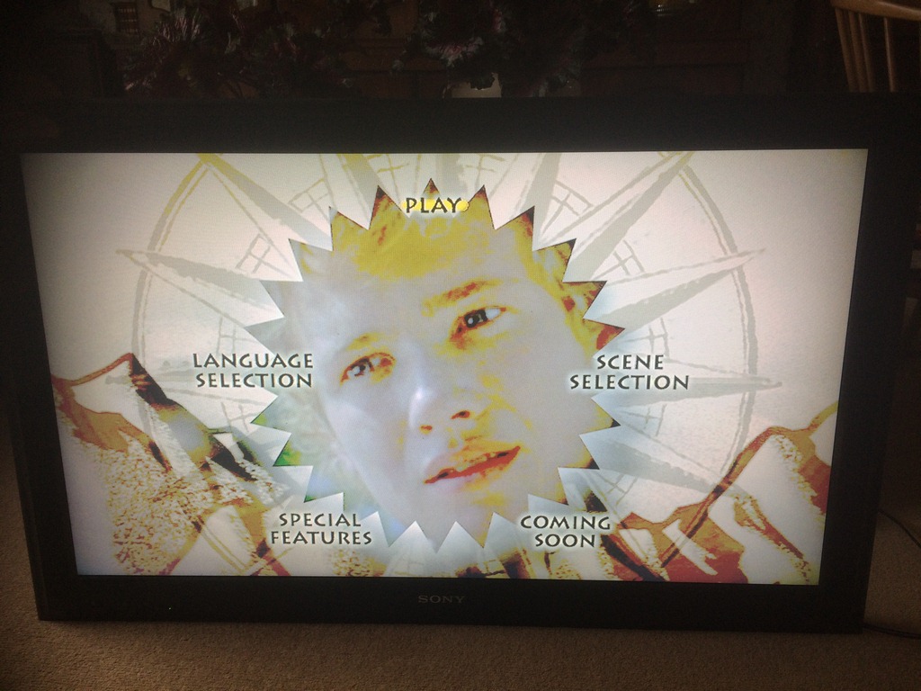

    Hello everyone thank you in advance for taking your time to help me solve this issue.
    I have a screen that is showing a negative look or low pixel resolution. I have attached a photo here of the current issue.
    I did some research and everyone pointed to a small chip on one PCB that's was the cause on the T-CON LVDS BOARD. So I managed to locate another board same version. I swapped out the board only not to have solved the problem to my disappointment.
    So here I am asking if anyone has some advice in regards to this, is there another main cause.
    All the cables where cleaned and re-seated.

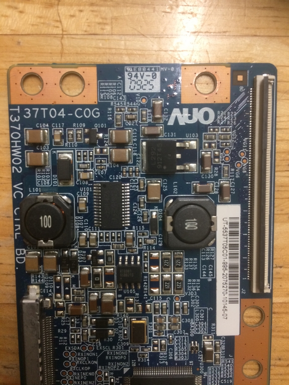

    I've also attached the board that I changed out.
    Thank you all in advance for any help.

    Try a factory reset, no joy, try a firmware update, two pretty easy things to try. Can you take a better close up picture of the tcon? can't see any detail in that one.

      Any other work done to it? Maybe wrong format.

          To nomoresonys : Please see attached files of T-con board close up.

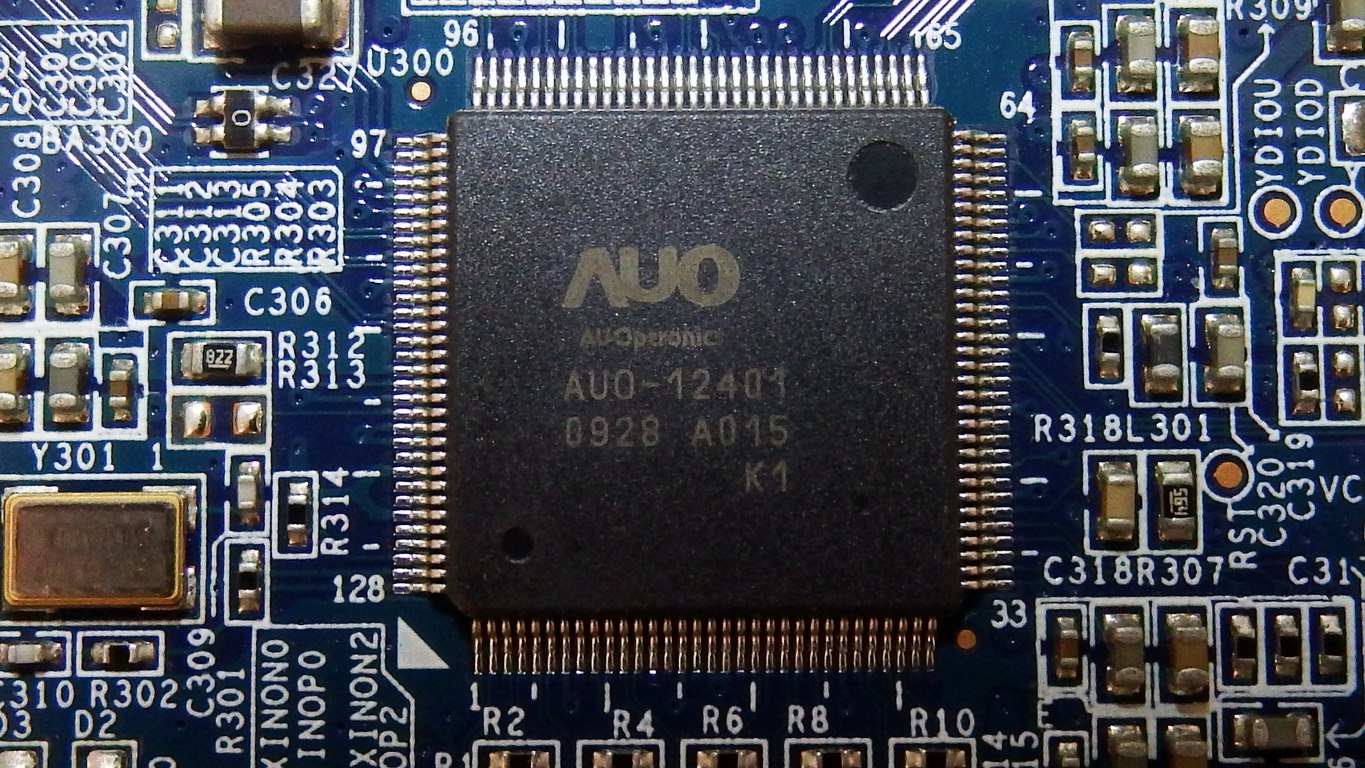

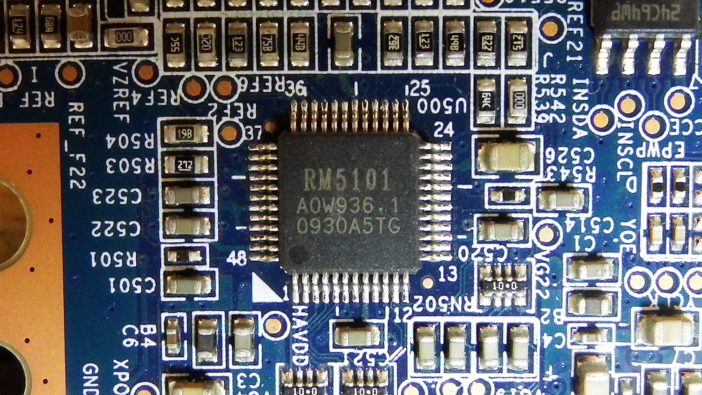

            write over here the main chip label of the t-con not clear at photo.. some certain chips known by Gama fault.
            • lotas
              • Jan 2016
              • 4717
              • Russia
              Re: Help with Sony KDL-37S5500 TV Display issue please
              He has the RM5101 (AS15) gamma.

                Check the VG voltages and right them down. The test points are VG1 ~ VG21
                VG1-- __
                VG2-- __
                VG21-- __
                The voltage should be fairly liner from VG1 to VG21

                        Diah : I have attached better photo's in macro so you can read the chip ID better.
                        Lotas : Please see attached, does this chip have a gamma issue, and which chipset should I have to avoid this issue.

                          yours photo .. yes this is the fault gama chip

                            They are scattered but VG1 > vg19 are test points. I would access service menu and make sure you are on right lvds format.

                                Just found this:
                                https://www.youtube.com/watch?v=bAQrDV_AOg0
                                Same board he replace's the IC with AS15 G at 8.21 in the video and solves the issue.
                                Please correct me if I am wrong but the replacement IC's are
                                AS15F, AS15 G, AS15 U, AS15 H, AS15 HF, AS15 AF.
                                This replaces the:
                                RW5101
                                A0W936.1
                                0930A5TG
                                Advice please.

                                  No guarantee on this chip.. could remain good over 15 years and more or after one months cut the gamma so replace it same with out thinking on good or better,

                                    It looks like the RM5101 replaces the AS15-xx
                                    • Diah
                                      • Feb 2013
                                      • 6430
                                      RM is Original Taiwanese .. AS Chinese ( Main Land ) COPY
                                      • cheeky2
                                        • Dec 2012
                                        • 337
                                        • uk
                                        Indeed the AS15X replace this one. If you find a RM5101 they are far more expensive than the AS15x range. The RM5101 are far more reliable than the AS15X ics though I have found.
