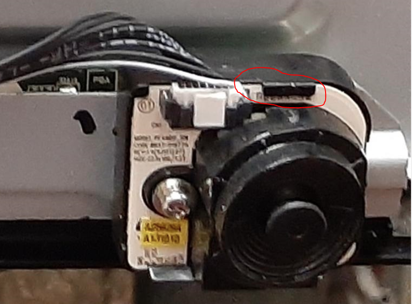

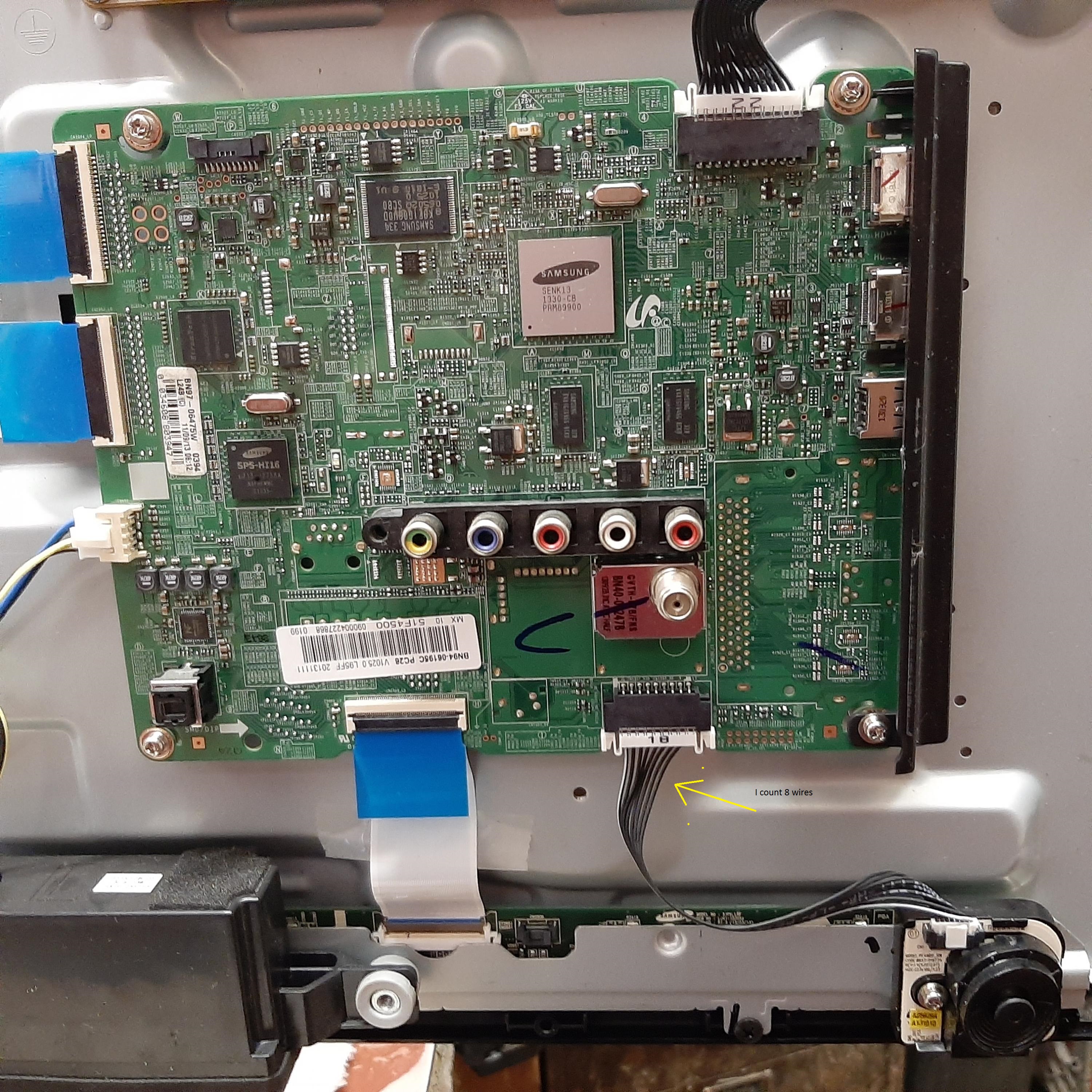

    on this tv - only one row of 7 pins goes into that black connector (you show 2 rows but the connector only has 1 row of 7 pins - 7 wires). I may have checked voltages on wrong pins - i'll check them again tomorrow.
    there is nothing else that plugs into main board except speaker connector, power board connector, and ribbon connectors.

      Re: samsung BN44-00599A PWB
      Is this your board? if it is there are two rows of pins, the row exposed on the top of the main board do not connect to the joystick board
      The connector has 18 pins, two rows of 9 pins. Unplug the connector and look at the plug.
      I still count 8 wires on the plug between the joystick board and the main board.
          that is my main bd - obviously it has 8 wires. I was looking at post #16 (lotas) pinout. I'll measure voltages shortly and report back.
            with joy button 8 pin connector disconnected. orig main bd in - all pins had 12-15 Mvolts except ground pin. with new EBAY main bd - all pins had 205 Mvolts except ground. NO 3.3 VOLTS on any main bd joy button connector pins. tells me I have 2 bad main boards.
            standby was 3.3V and 5V was 5.1 volts. on main board PWB connector

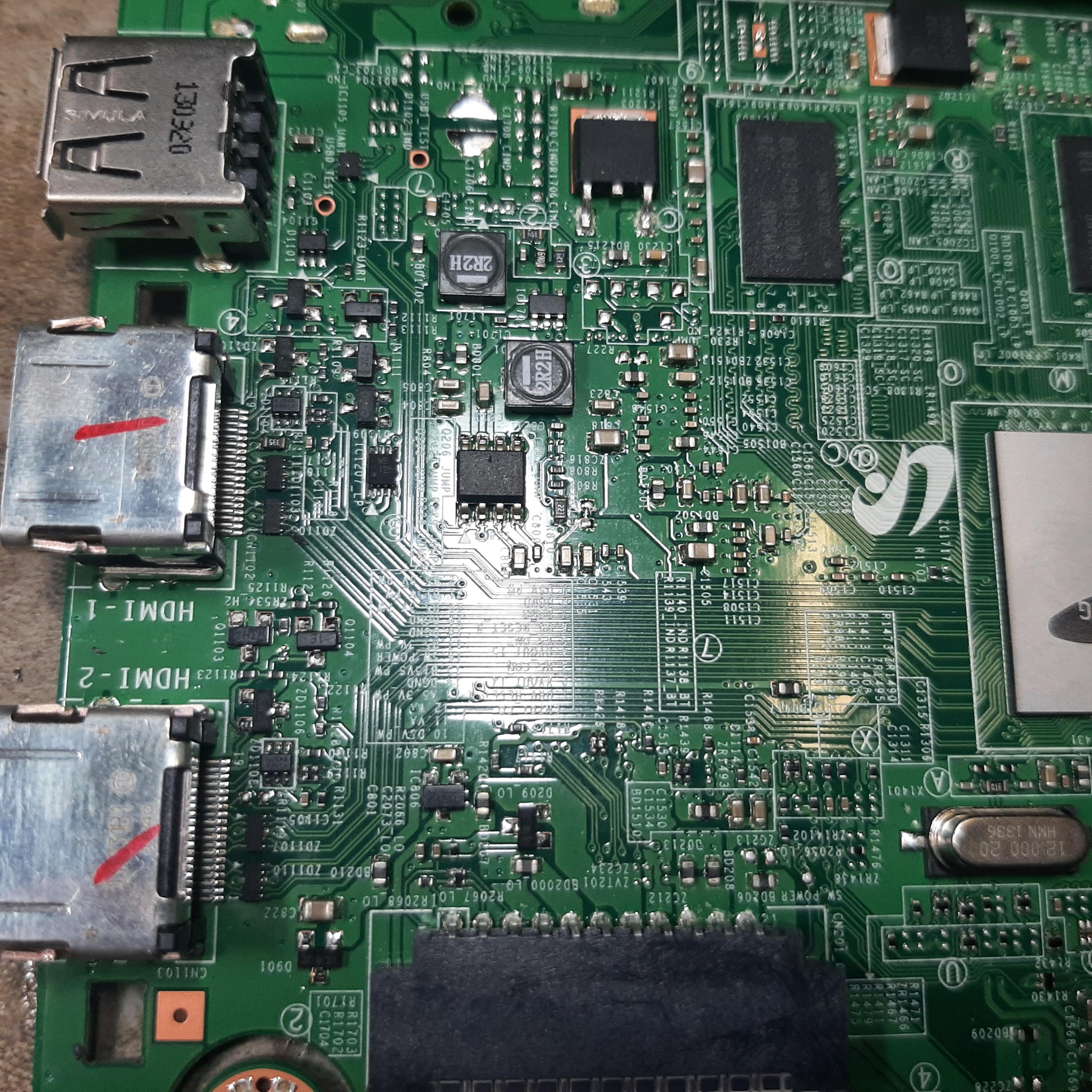

                There should be buck regulators on the board, they would take the A5v and drop it to 3.3v They usually are an 8 pin ic with a coil near it, there look like a couple circuits like that near the hdmi1 port.
                Look up or post the numbers on the ic to see if they are regulator ic's
                There are also 3 pin ic regulators with numbers like LD1117
                You can also try tracing back from the A3.3V test point using your meter in resistance mode.

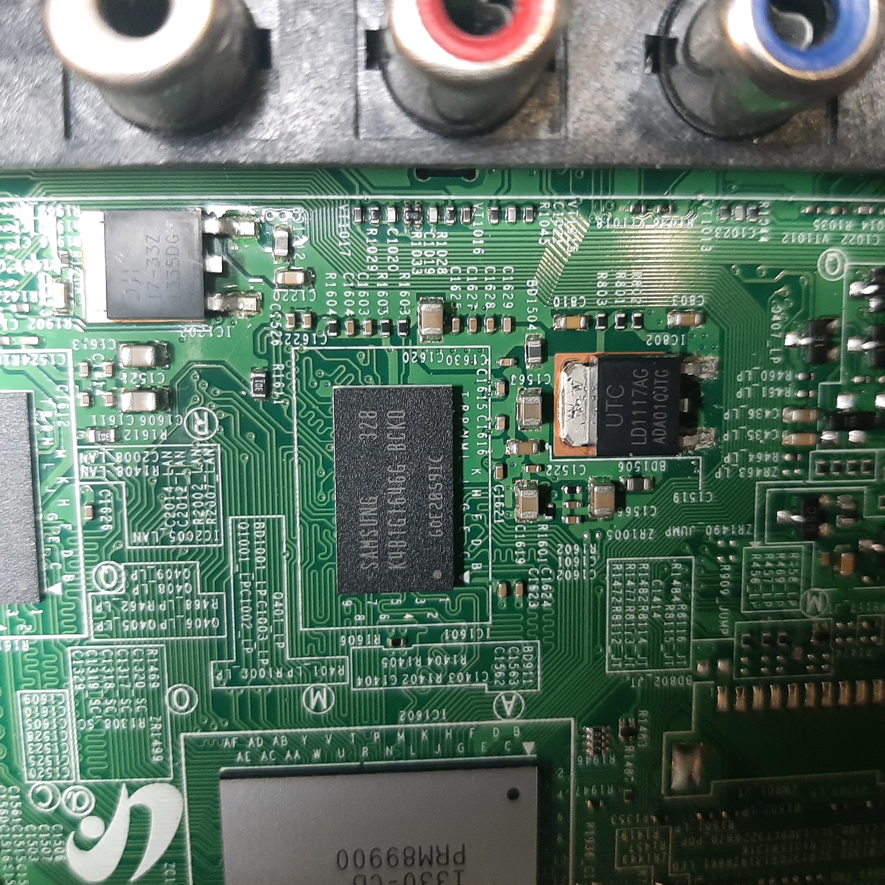

                        joystick button CN1202 Pin 3 (A3.3V) is shorted to ground (joystick is disconnected). USB connector VCC is not attached to LD1117 anywhere. maybe goes thru resistor to USB port. The two LD1117 i found are not shorted. this board is a nightmare without schematic. Tab of LD1117 is VCC-out and can't locate where it goes. Also LD1117 VCC-in doesn't go directly to standby (PWB)

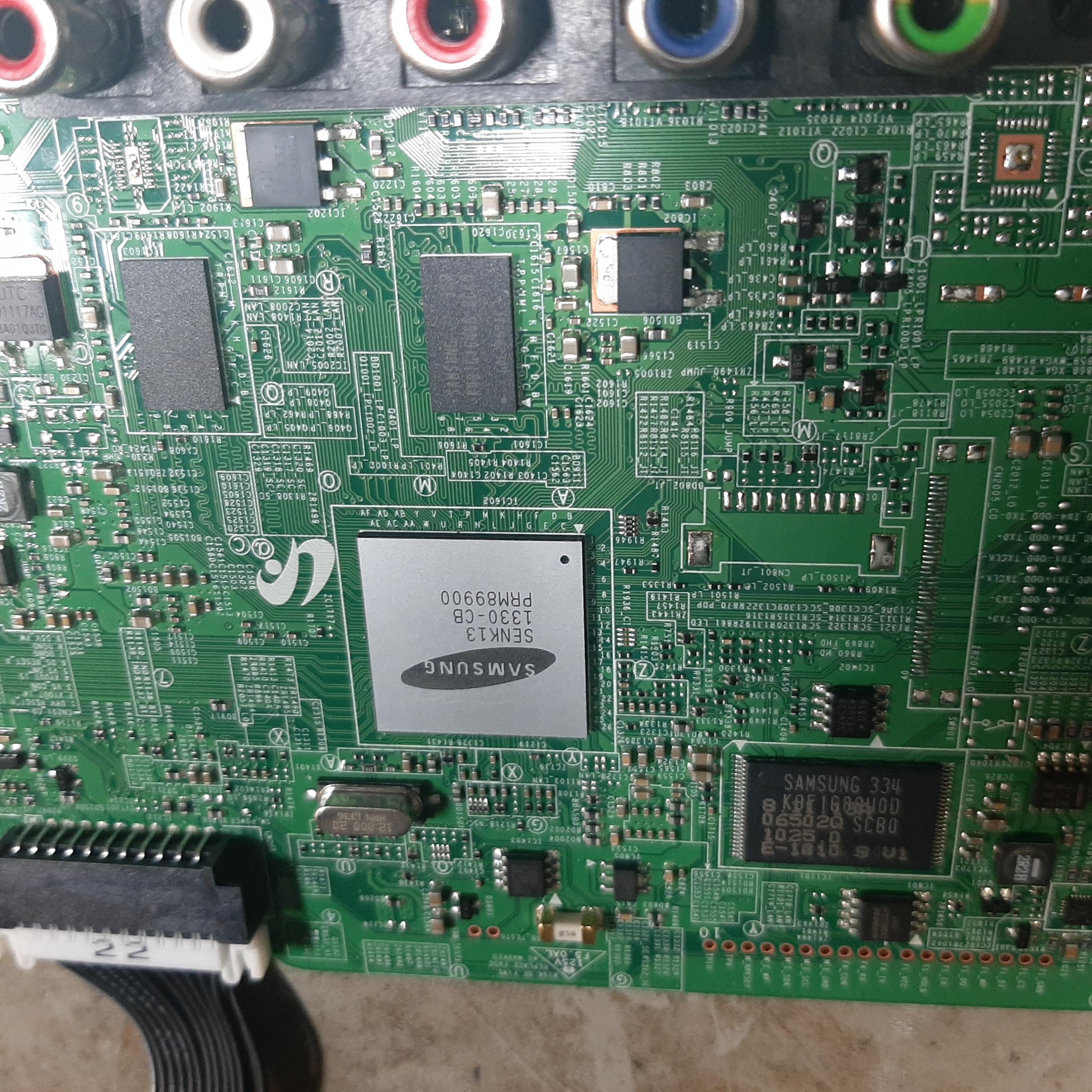

                          Main bd pics

                            traced CN201 (main bd conn to PWB) standby voltage to Samsung prop chip sps-HI16.
                            all buck regulators (found 3) have 0 volts at input with main power on.
                            I give up - main board is a nightmare to trace. not worth my time.
