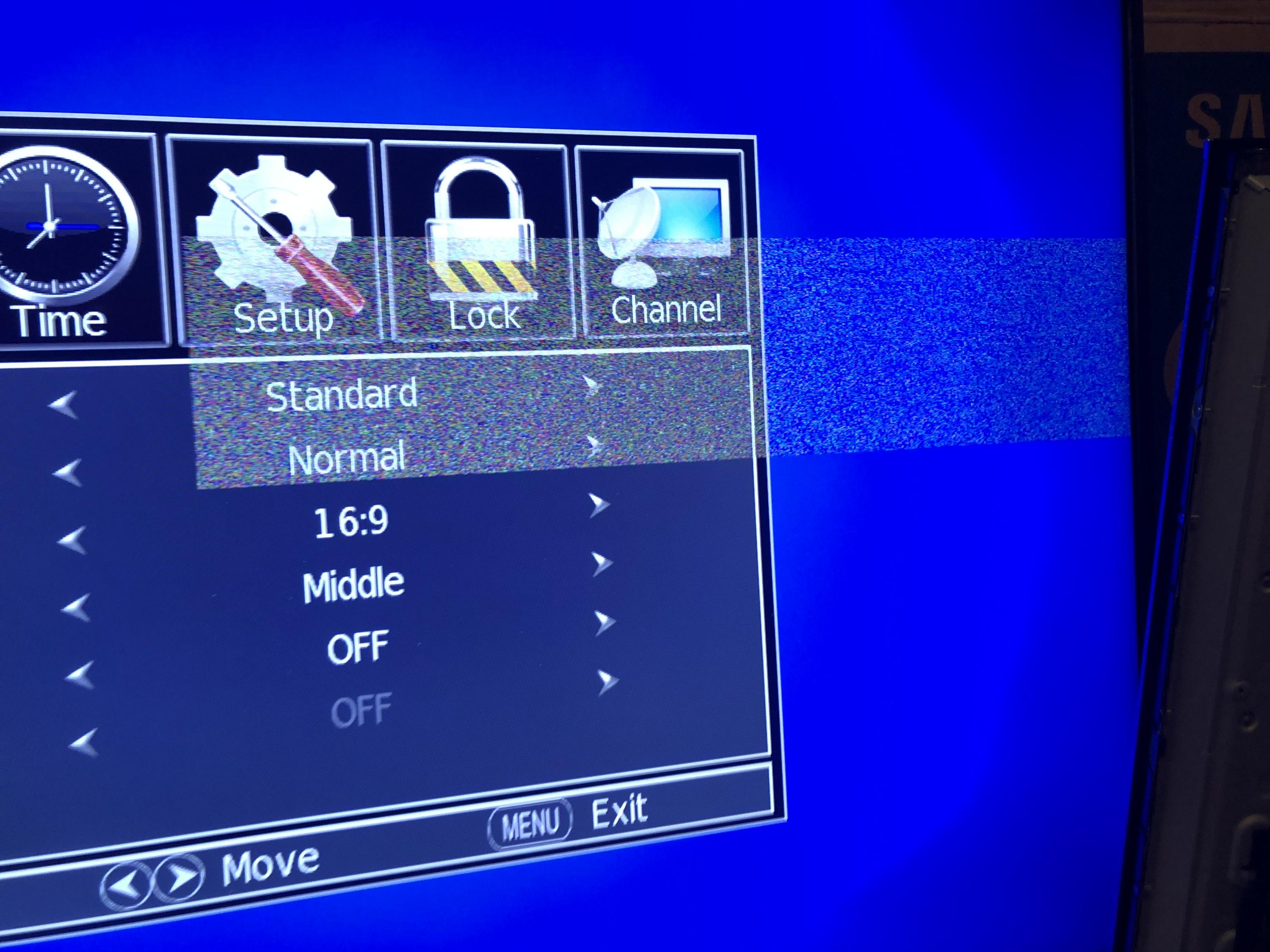

RCA RTRU5540-D noise on right side of the panel
  • alfatv
    • Sep 2020
    • 353
    Got a TV with strange problem.
    There is noise on the panel right side, sometimes blocky as in the picture, sometimes all over the place like lots of bad pixels. On a black image it's like night sky with stars.
    It feels to me like poor signal integrity.
    So far tried another T-Con and it was the same.
    Reseating connectors, applying heat, touching and flexing didn't reveal any clues.
    It seems like panel issue, but I'd like to hear other opinions especially if something similar was seen before.
