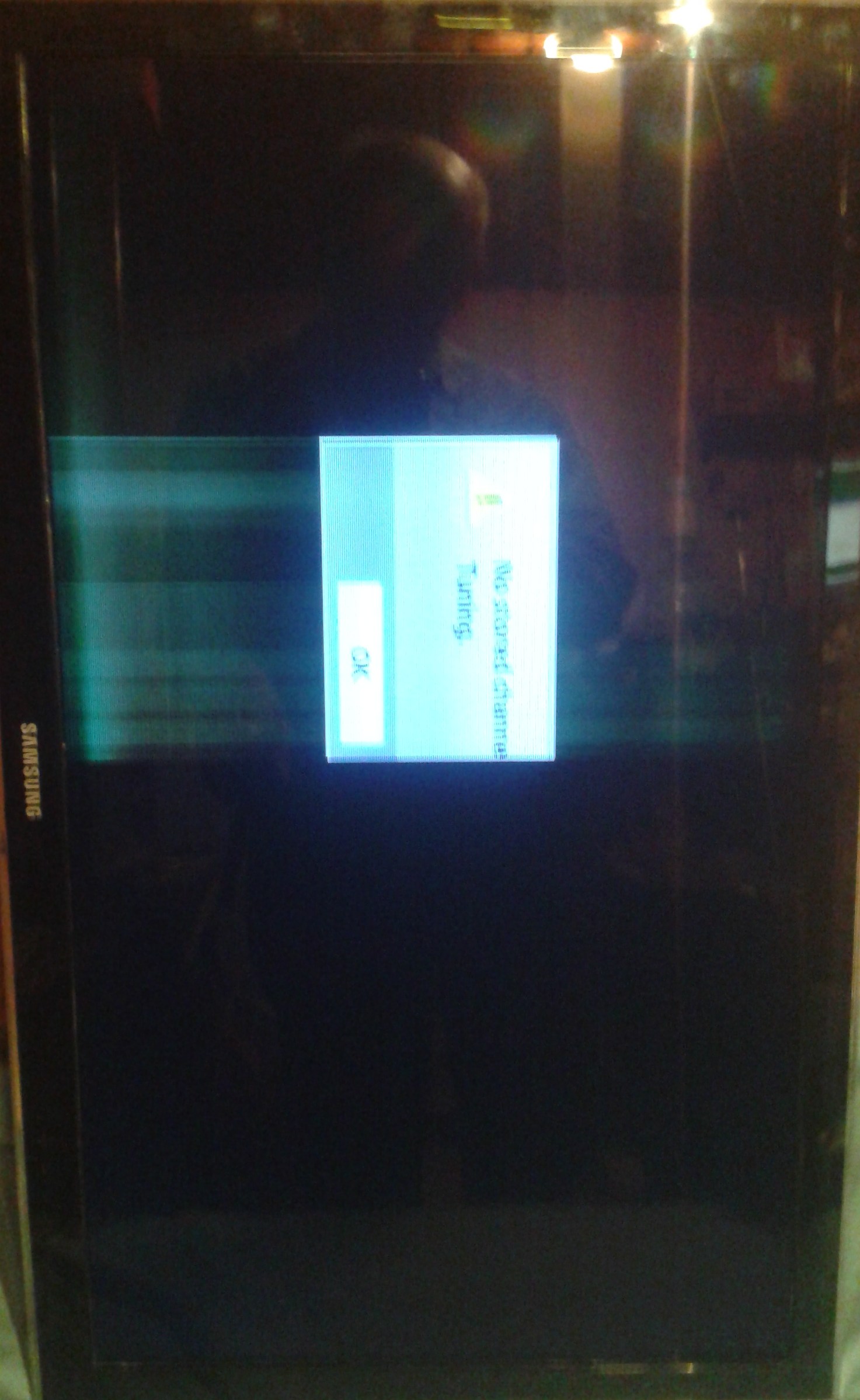

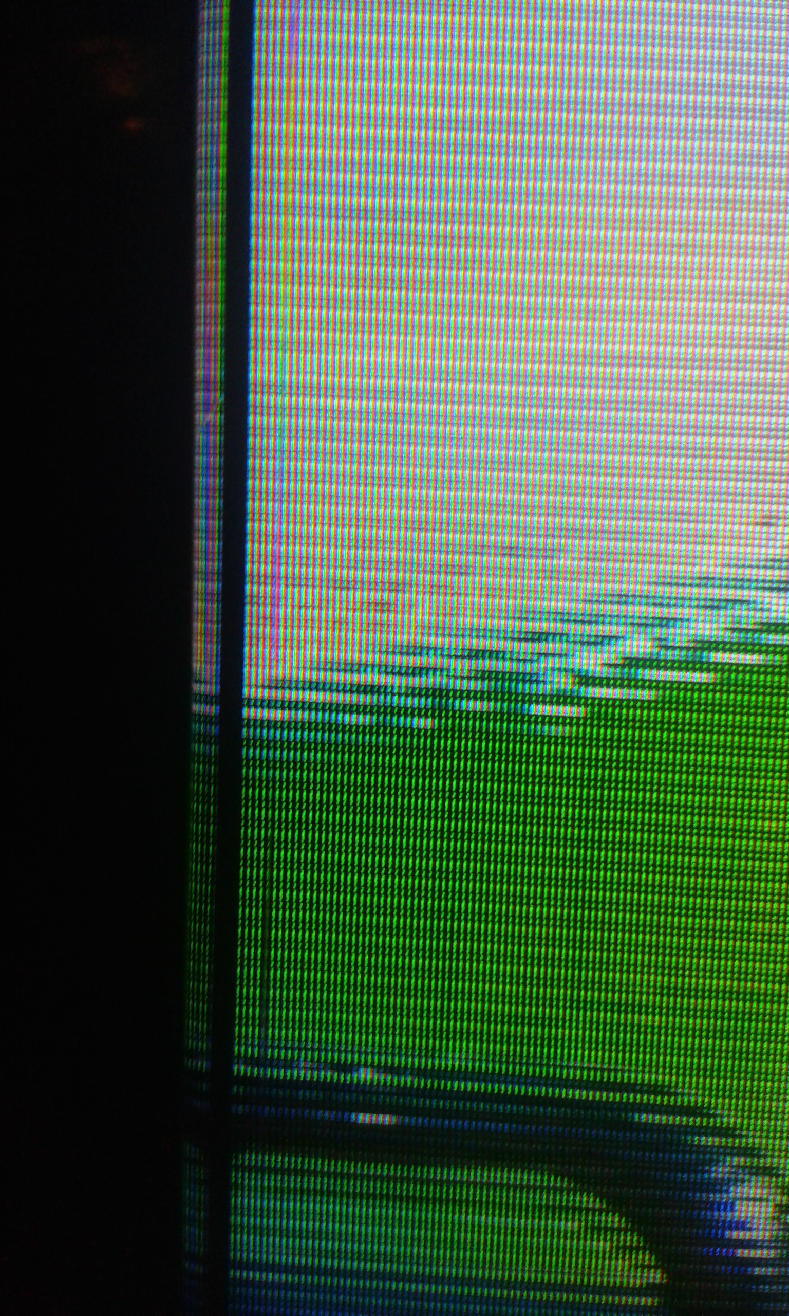

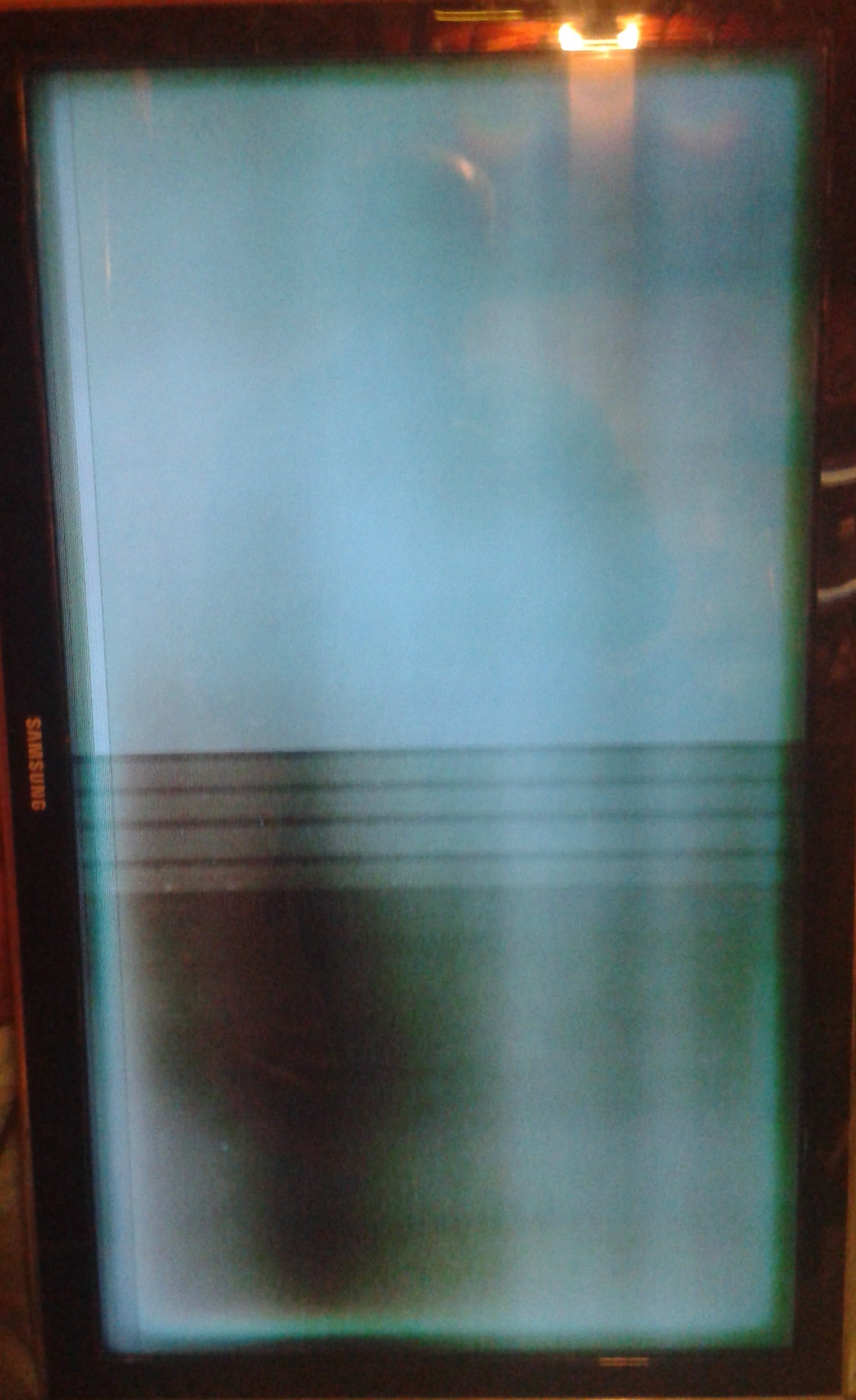

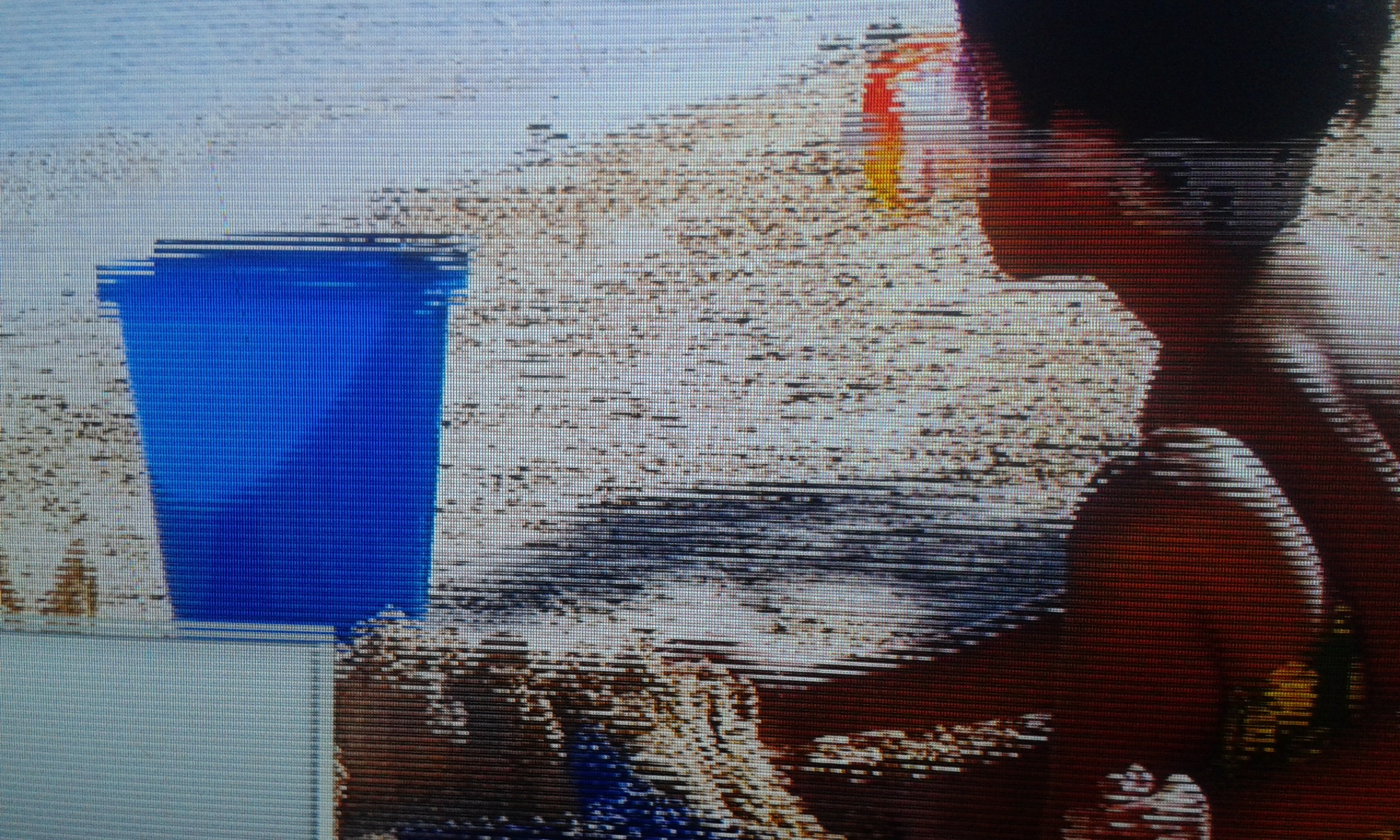

    Problematic horizontal lines and picture scattering are visible in attached images.
    Please help determine where the malfunction occurred. I checked all the cables and connectors on all the boards inside the TV. There are no visible defective elements on the boards.
    Factory reset also done but no improvement.
    Which board could be wrong?

    Re: Please, help with Samsung UE32D5000 diagnostic problem
    Looks like timing control problem. Possible panel problem.
      Problem with one side gate drivers, seems lagged, needs a picture of entire screen, maybe fault begin from a certain line, tipical, one of the solutions the masking tape method..

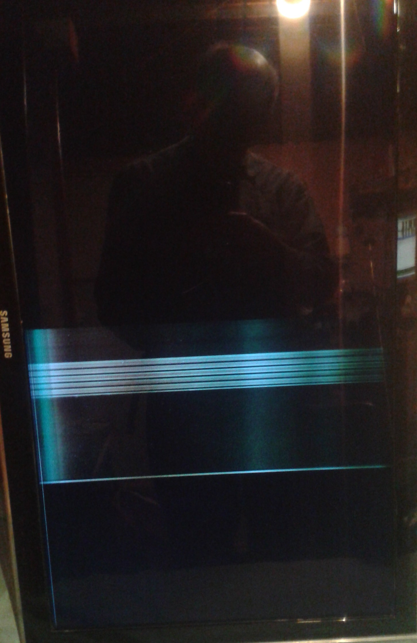

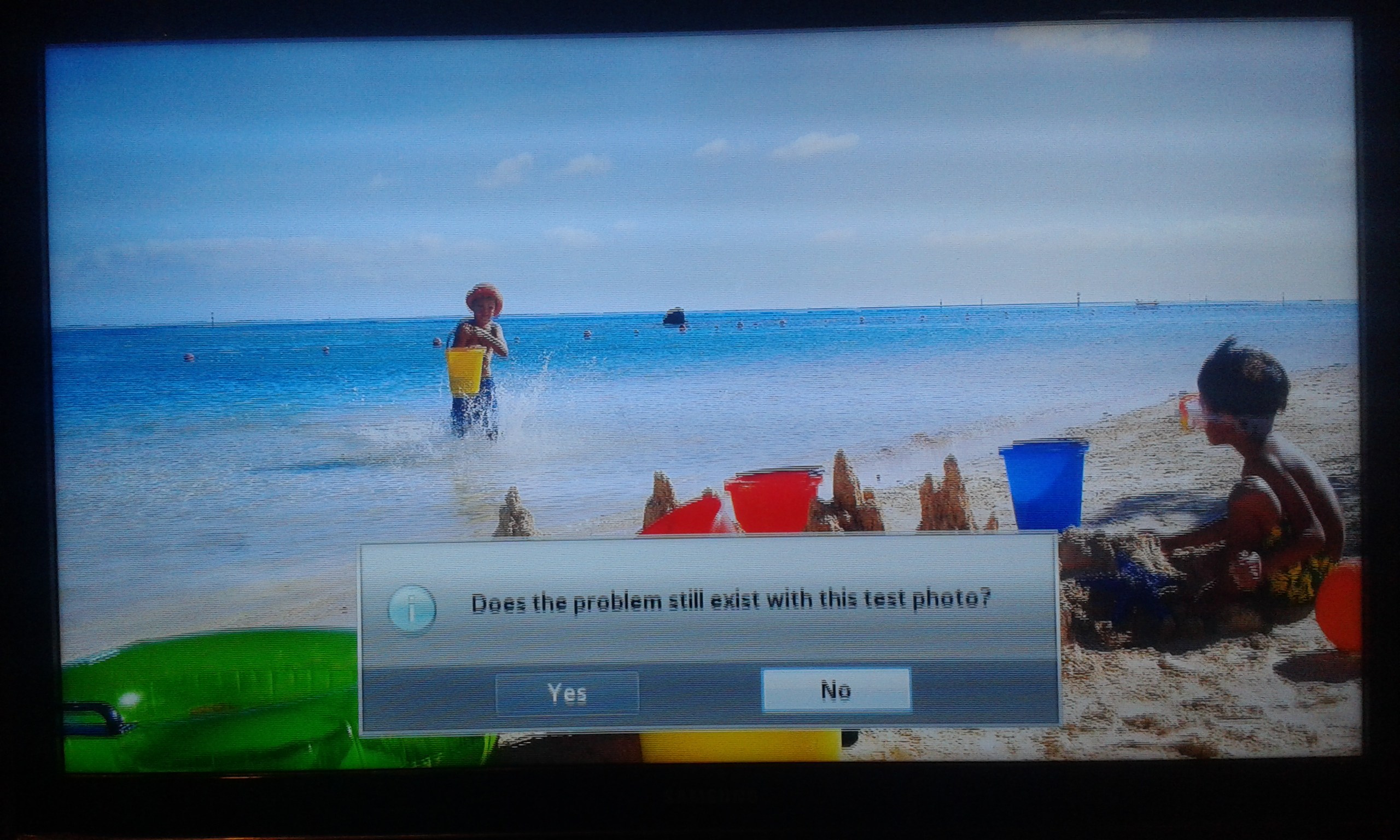

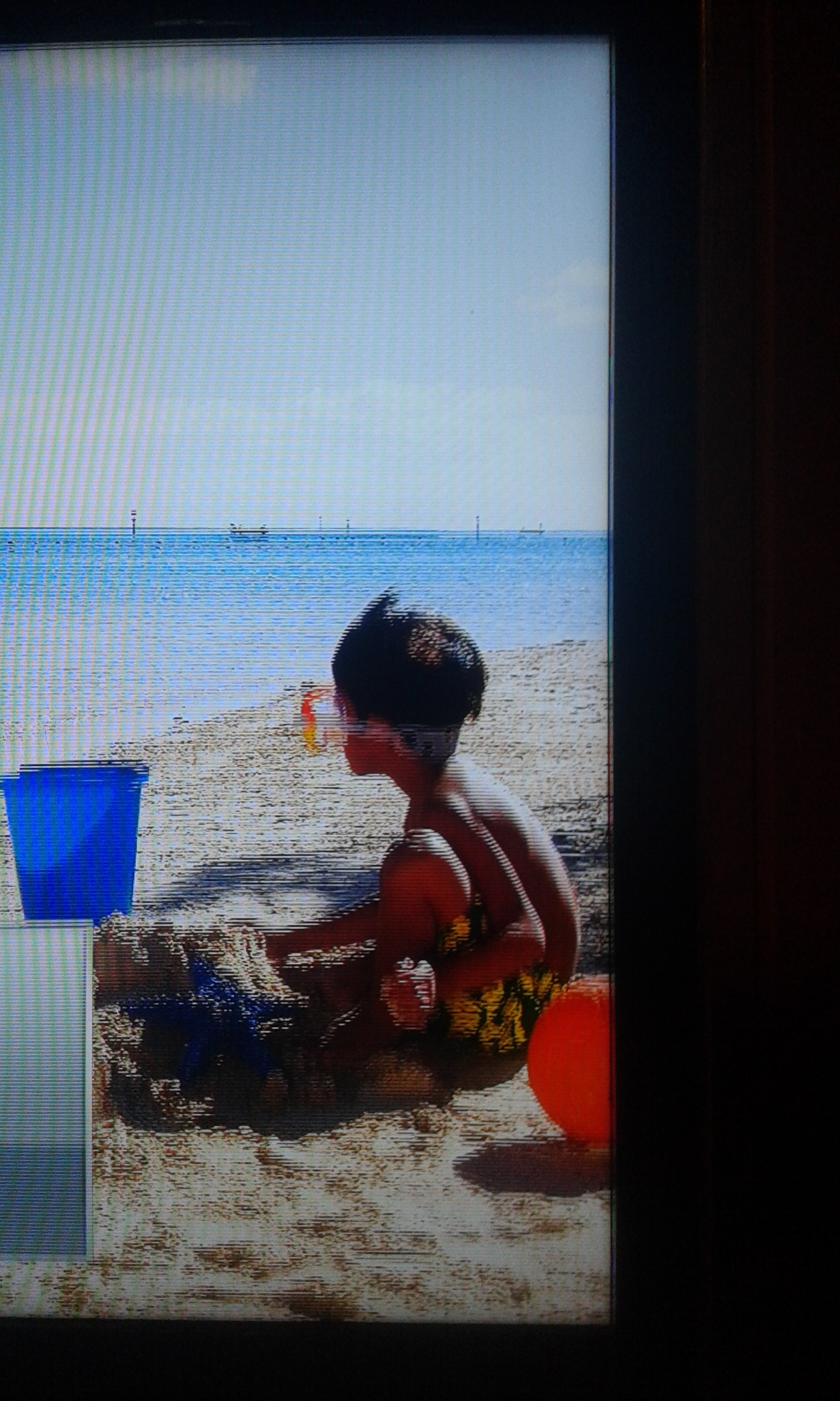

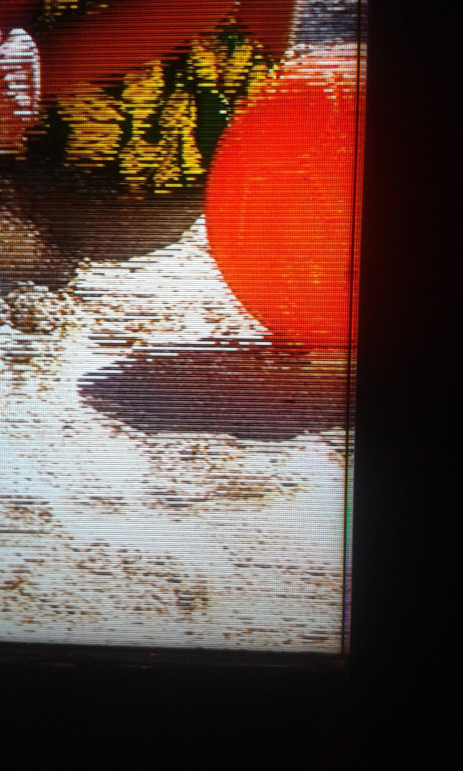

        Thanks for the quick answer.
        I photographed the whole screen and additionally each side separately. I think the resolution is poor to see the details, so I still shot every corner in macro mode.
        I hope that helps.
          The whole screen is affected, so detach one tcon output cable at a time and see if you have an half good image situation.

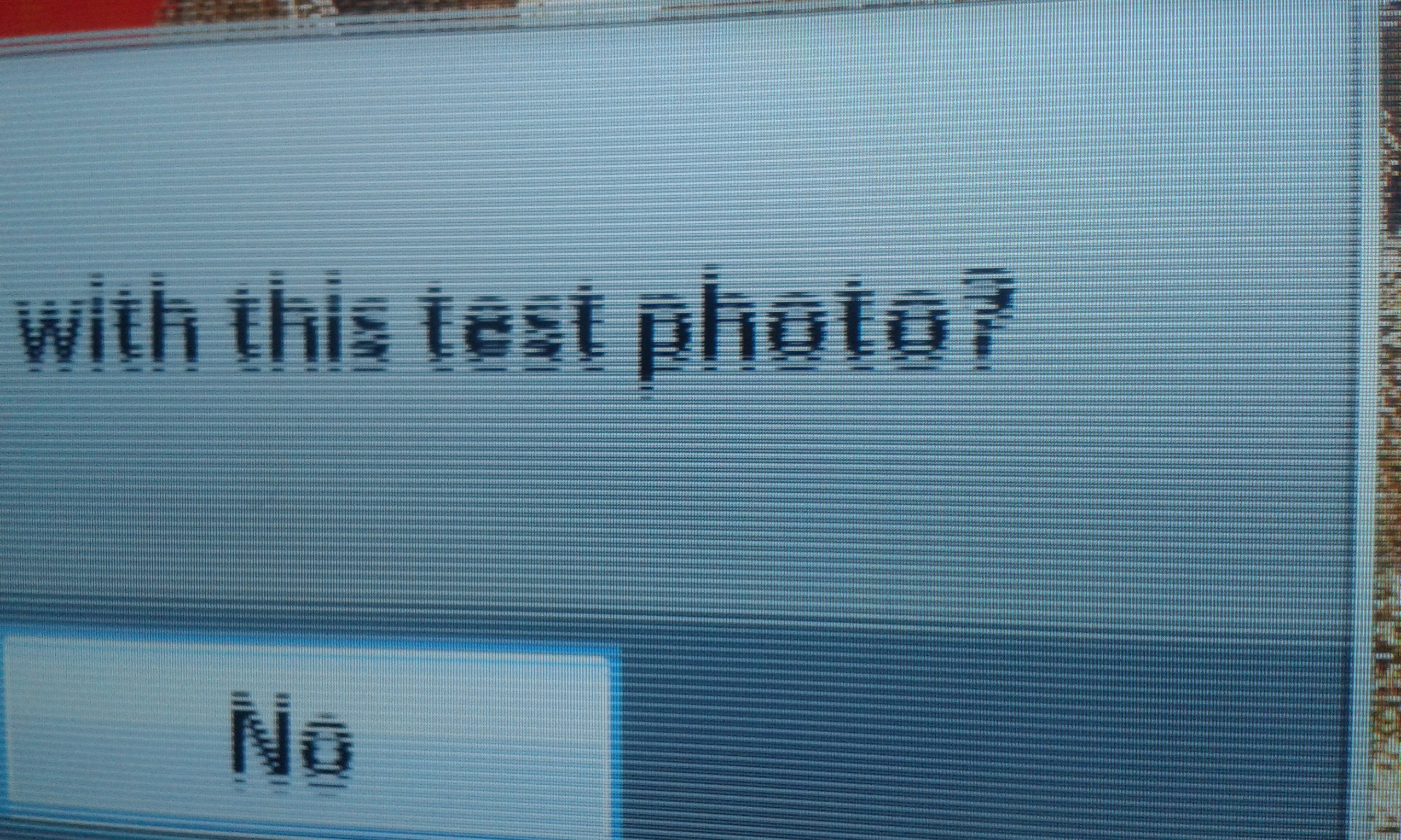

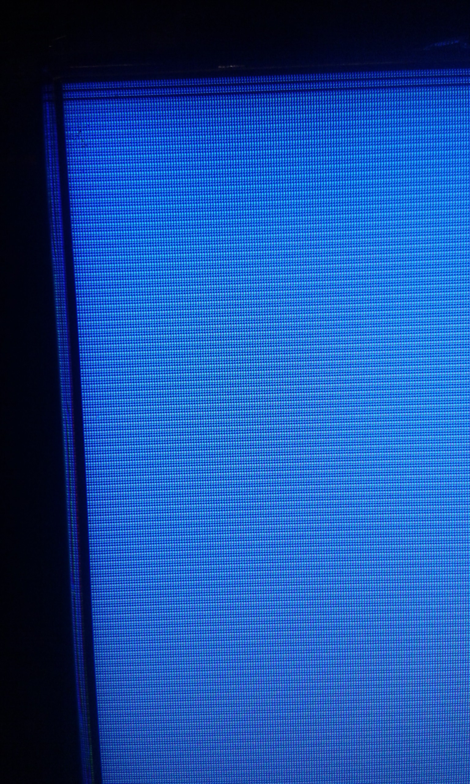

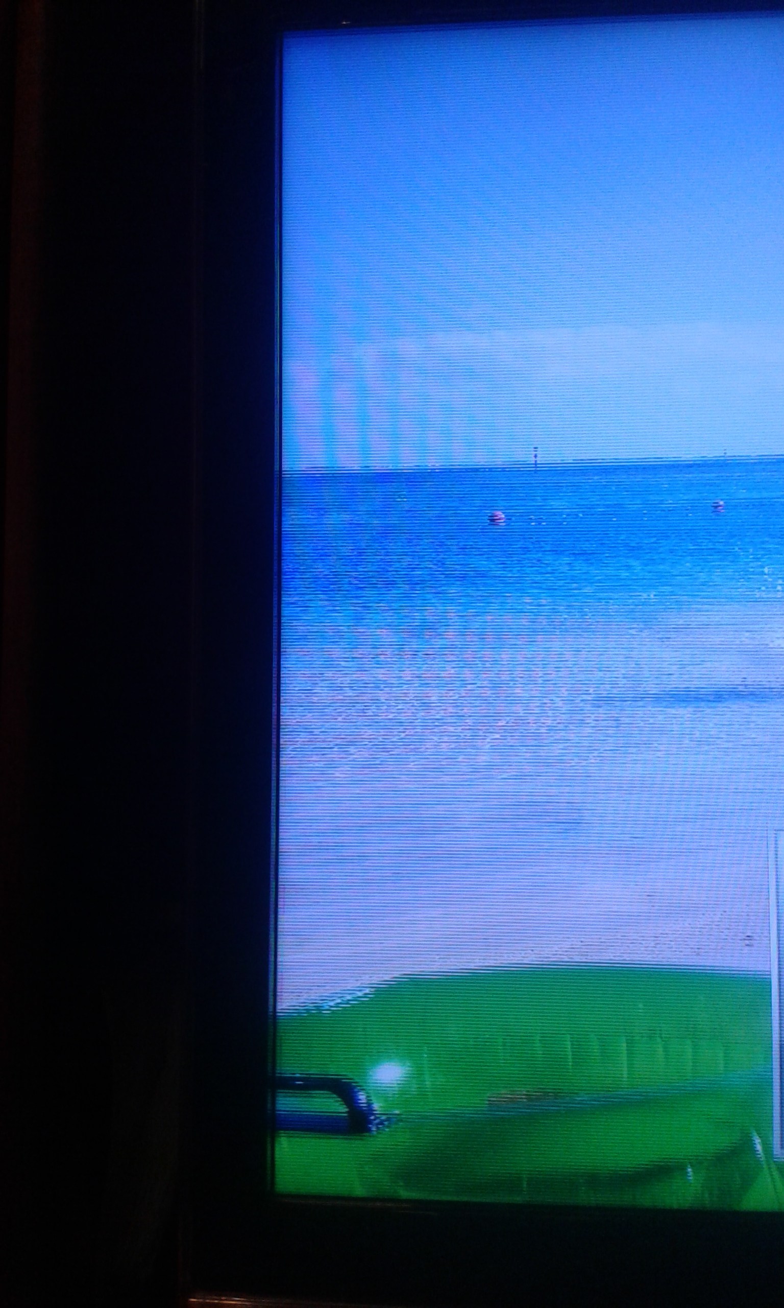

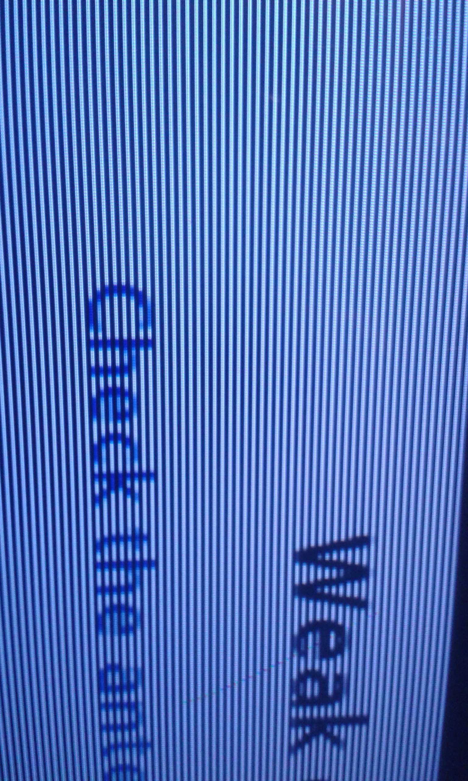

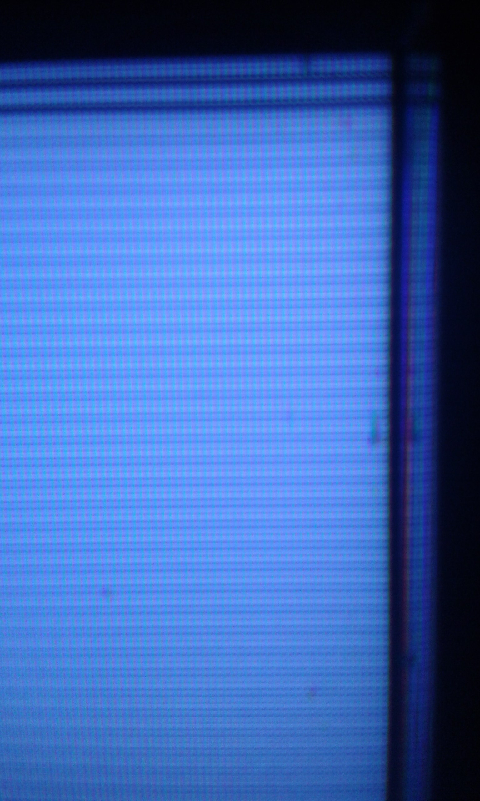

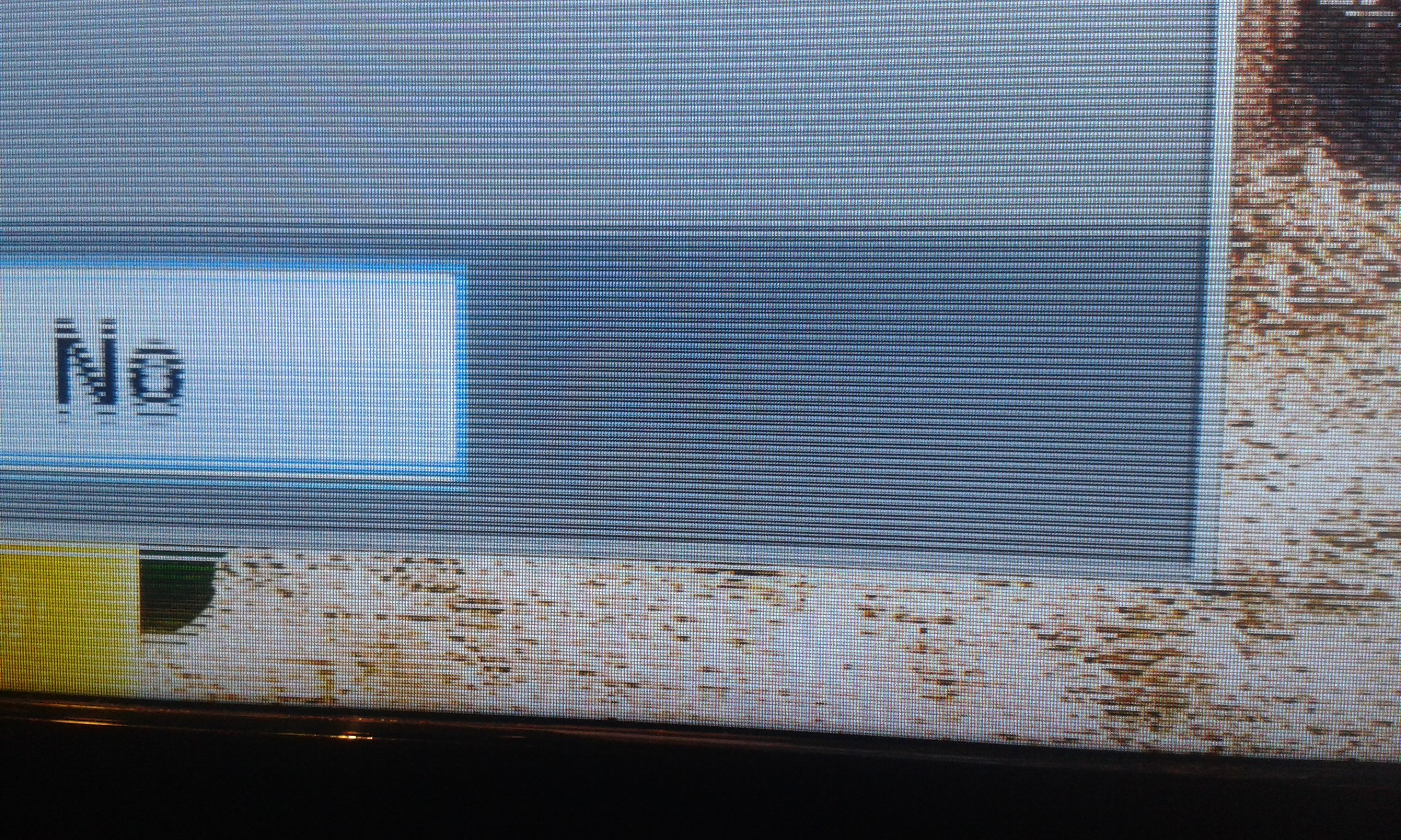

            When the left output connector is disconnected on the t-con it is obtained as in the picture (discon_left_t-con.jpg) and the visible part of the message on the screen is clean lines but every 2nd line is black (message_macro.jpg).
            When the right output connector is disconnected on the t-con, it is obtained as in the picture (discon_right_t-con.jpg) and the screen darkens completely in ten seconds (discon_right_after10s_t-con.jpg). The expected second half of the message is not displayed at all.
            Still wondering where the fault is, on the t-con board or the panel is gone?

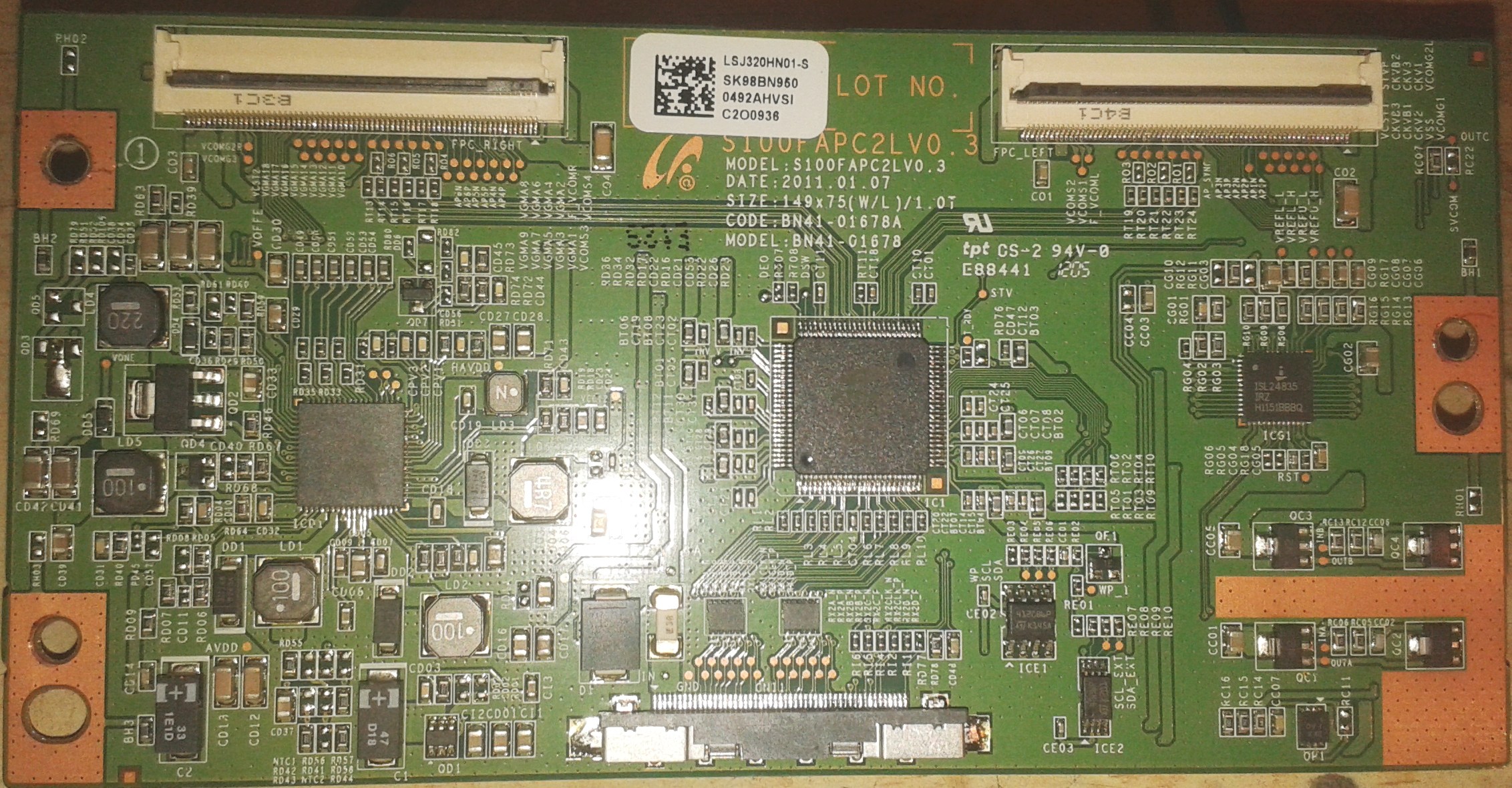

              The fault is on the panel maybe you can fix it nearly well with tape masking method, post photo of tcon with visible serigraphs
                Panel fault means the TV is a waste.
                So I would definitely try that method of masking, to save what can be saved. T-con image is attached, which pins and on which connector should be masked?
                  Everything starting with CK, on the connector of the faulty side that is the one that shows almost black, there are testpoints near right connector but are paralled to the left.. you can also try to block each one at a time that wil preserve more signals but it's longer to do.. you have at minimum 2 faulty lines..
