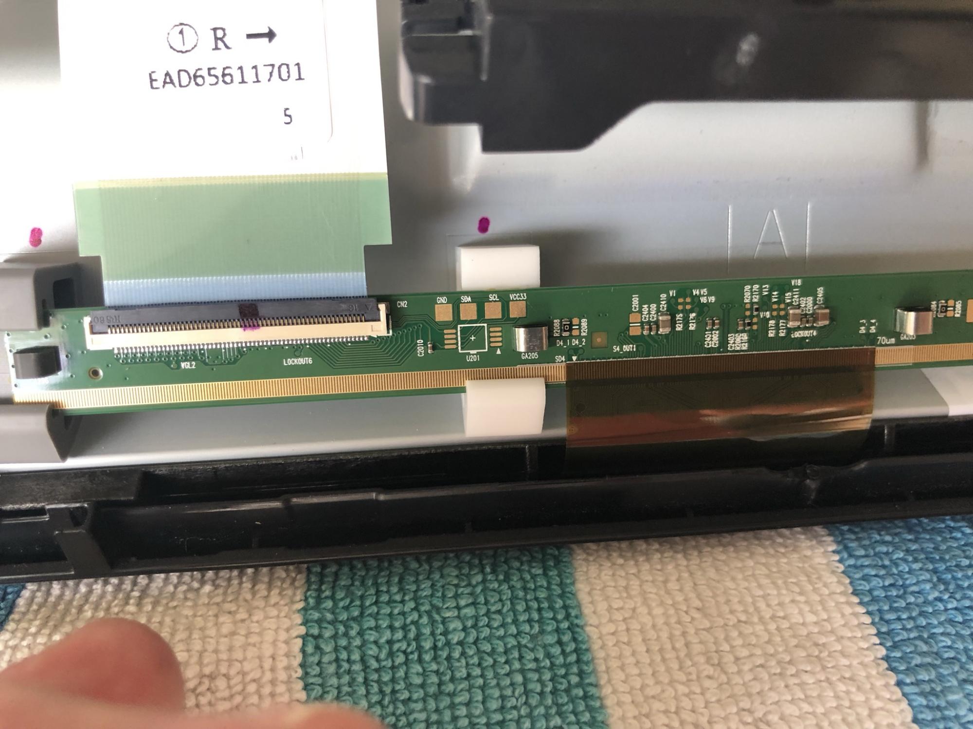

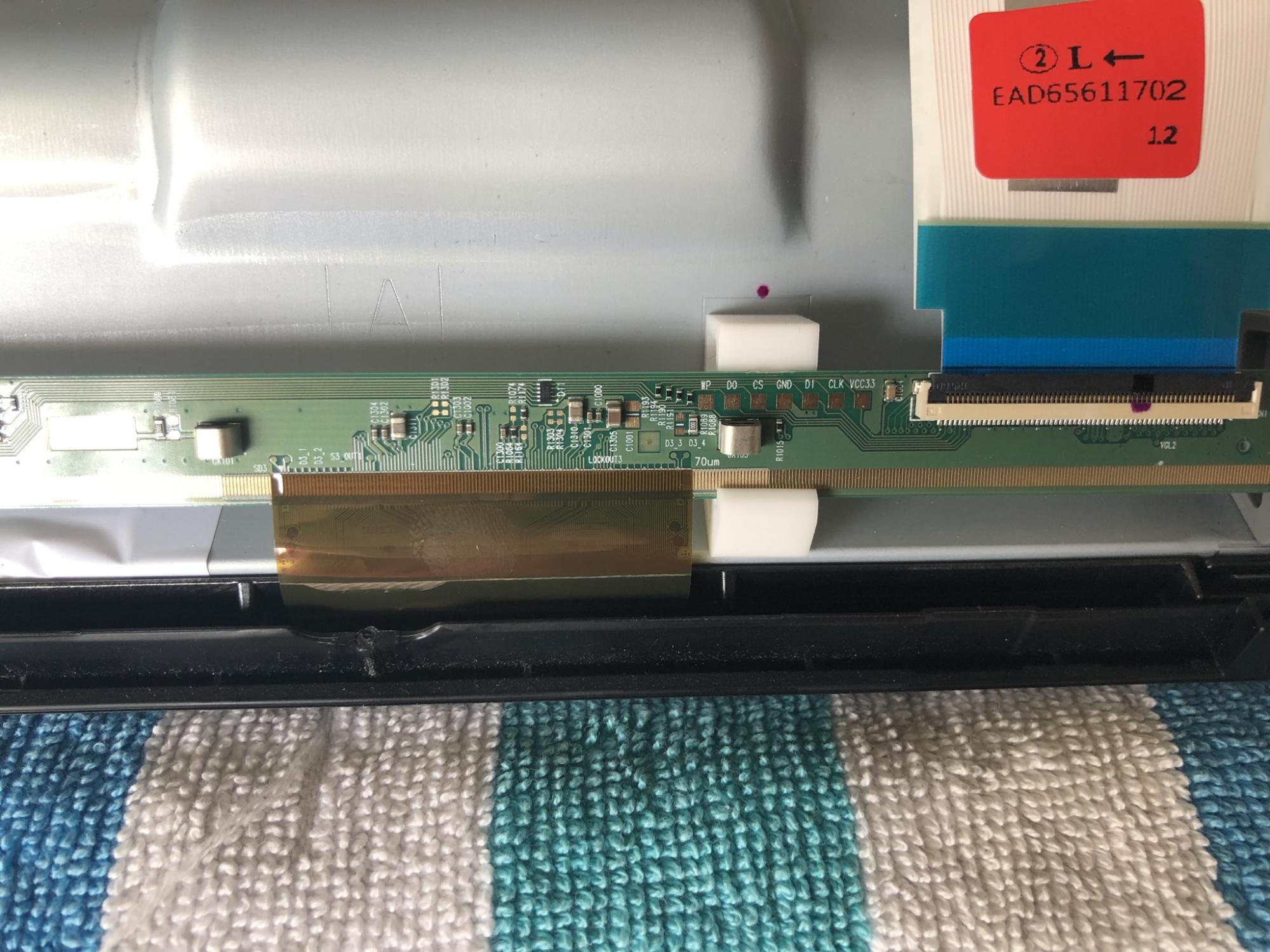

    I've started taking some reading from the buffer strips on the panel itself but I'm not sure what the reading should be.
    Here's the current readings
    LEFT SIDE BUFFER
    VCC33. 3.35 VDC
    CLK 70 ohms
    DI 130 ohms
    GND. gnd
    CS 3.27 VDC
    DO. open
    WP. OPEN
    RIGHT SIDE BUFFER
    VCC33. Open
    SCL. Open
    SDA open
    GND GND
    Has anyone had issues like this.
    The tv is only around 4 months old
    Thanks in advance

    Unplug the ribbons and see what you have in the picture.
      Re: LG 55UN6955ZUF. Help
      I have tried unplugging each side individually.
      Made no difference.
      Same result .No video
