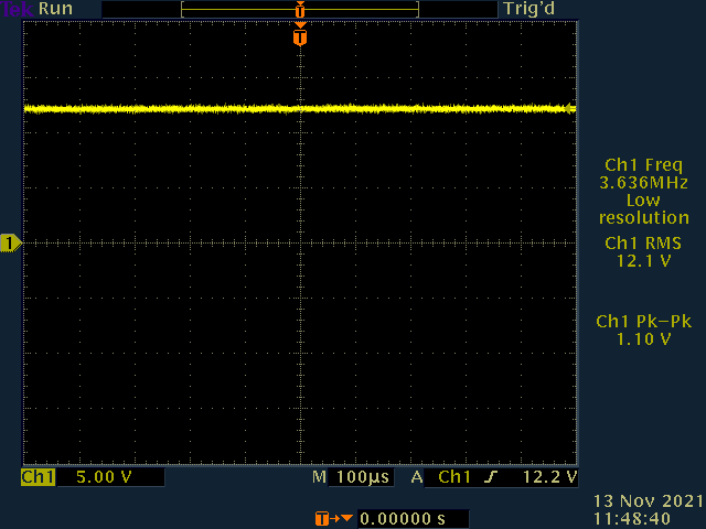

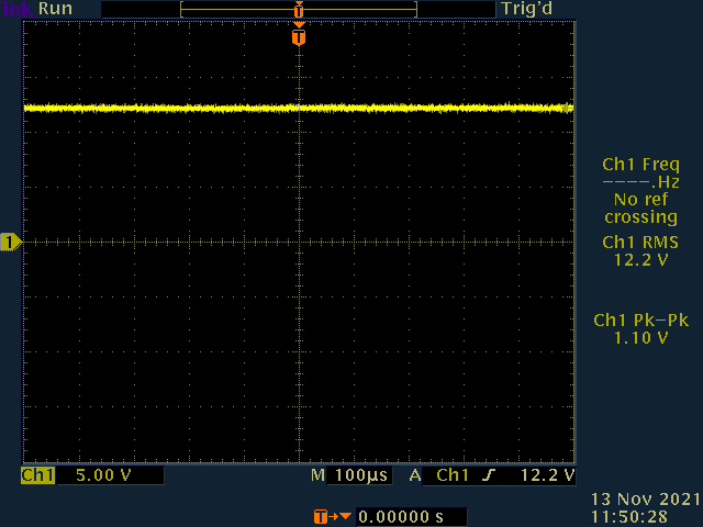

                                    • HellasTechn1
                                      • Sep 2015
                                      • 176
                                      • Greece
                                      Re: Philips 43PUH4900/88 will not power up
                                      I took out my Oscope and took pictures of the supply pins of LD5532GS and C9304.
                                      They both have a nice and steady 12.1V supply.
                                      I dont know why i saw a swinging voltage with the DMM...
                                      Here are the pictures:
