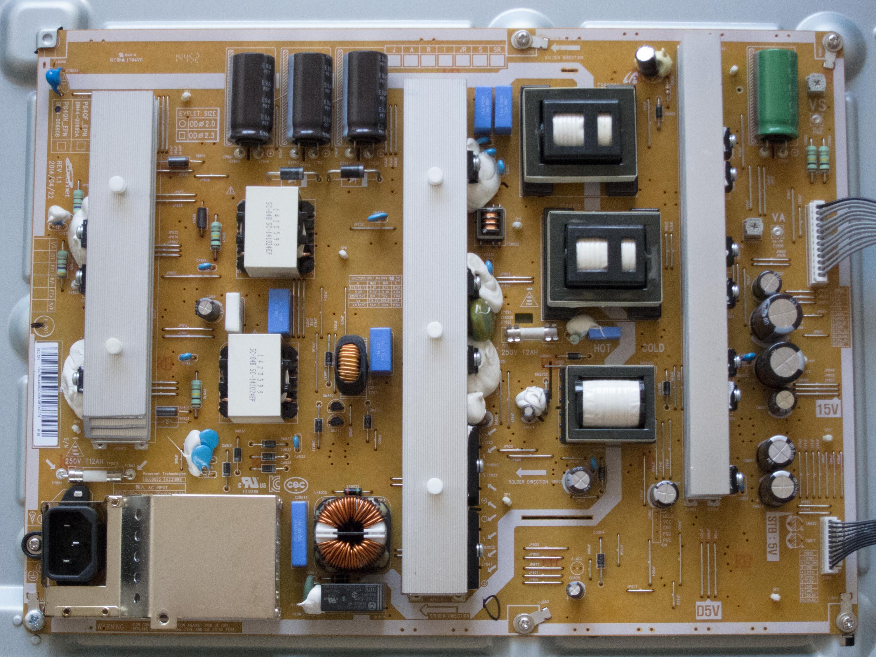

    It may be worth inspecting your circuit boards for any poor joints that have aged / cracked over the years especially around any coils or heatsinked components.
    Also check the voltages as given on the label at the rear of the plasma panel match the voltages read at the test points.

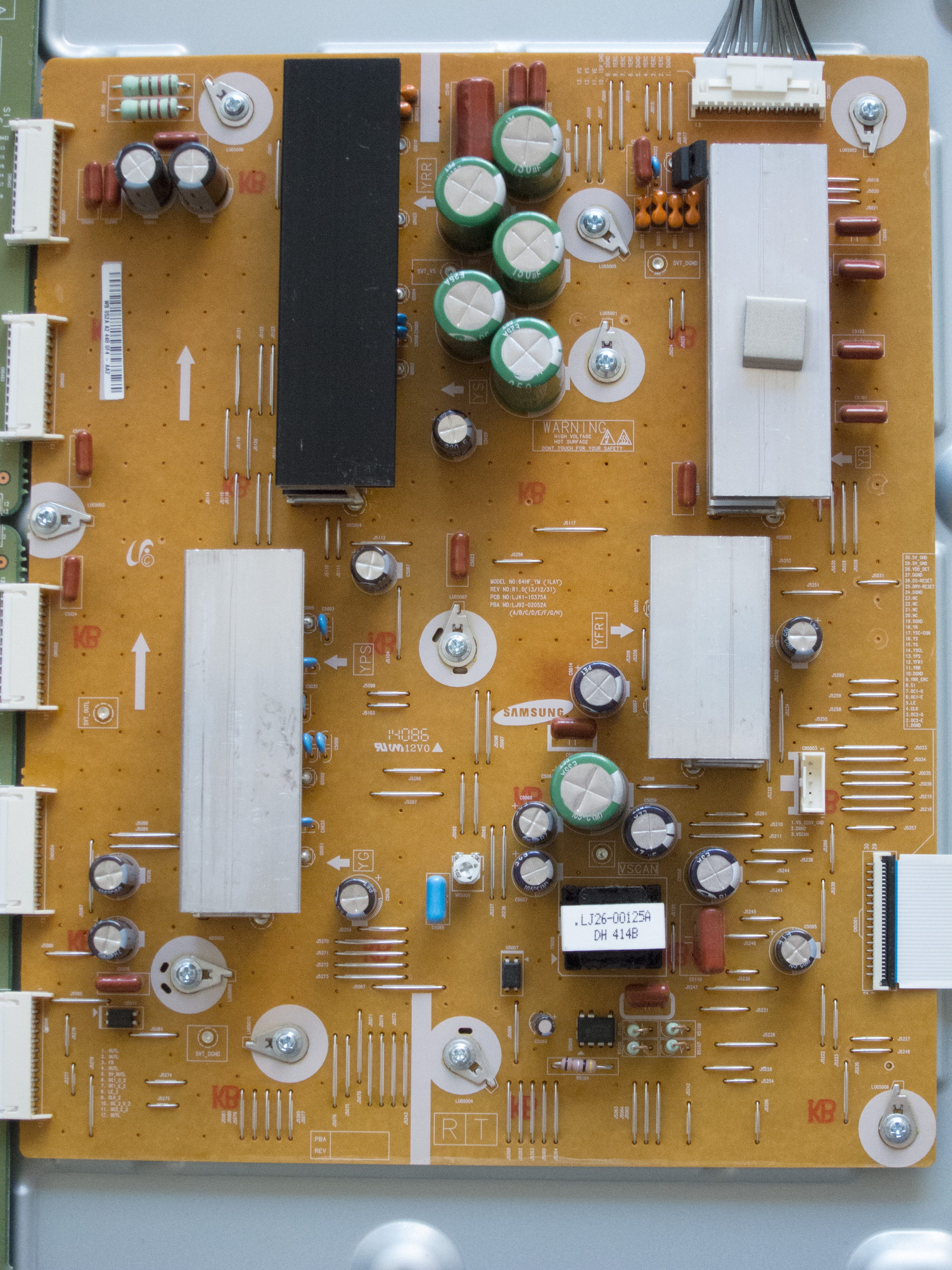

      Because the screen is dated, you can get such image errors. The software in the logic board can no longer sufficiently compensate for the image. Sometimes it helps to change the VS voltage a bit but the wear on the screen remains, the problem can only become less visible.

              Turn VS up by 2 volts, turn the contrast up as high as it will go without clipping the highlights which is usually going to be between 93 to 97, turn -Vy and Vscan down a bit and adjust Set_up and Set_dn on the No Signal screen for deepest black until you get a small amount of sparklies uniform across this screen. The No Signal screen is "blacker than black" levels and you will not get this level under normal program content, and even if you do, the only thing that needs to be done is turning the brightness up by 1 click in the regular picture menu.

                Minor update: while watching t.v. last night, it powered off/on/off a few times in succession, then refused to turn back on. I tried the unplug / hold power button gag, but now when I plug it in, it clicks five times and still refuses to power on.
                Managed to wrangle it onto the couch and pull the back off, and didn't seen anything obviously burned, nor bulging caps. Will post photos tomorrow.
                • meeotch
                  • Aug 2021
                  • 8

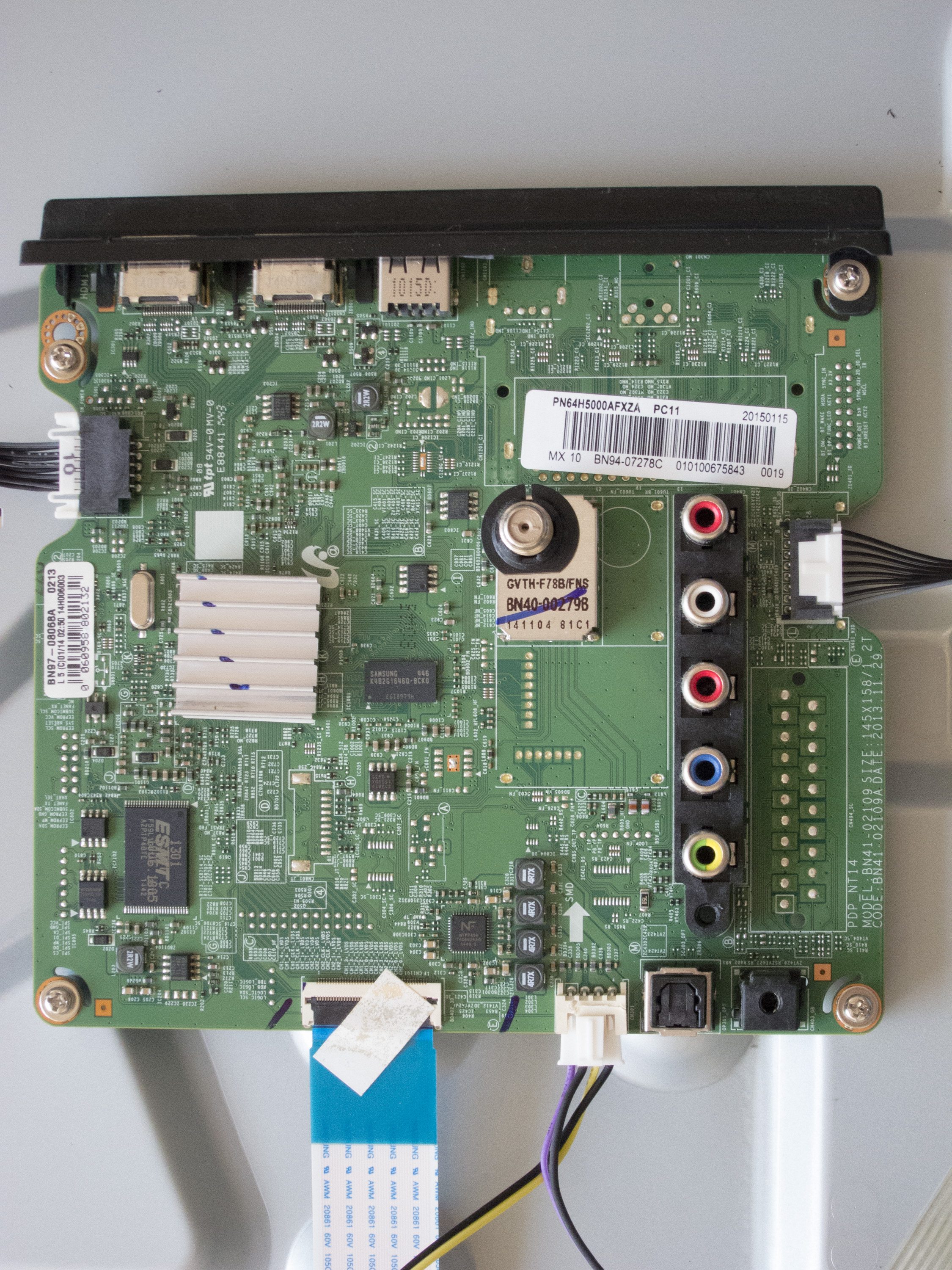

                  Re: Samsung PN64H5000 flickering magenta problem
                  Here are the board images. The power board appears to be a bn44-00690B, and is the source of the clicking noise when first plugged in.
                  I'll post a separate thread about the new won't-power-on problem, but if anyone's still watching this thread and spots something, feel free to post here.
