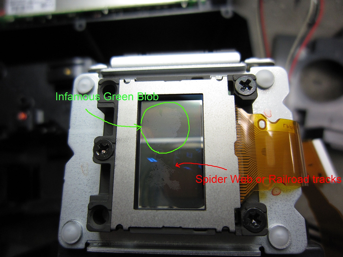

                  Bringing this topic back from the dead my friend just gave me his KDS-60A2000 sony SXRD with the dreaded greent tinit issue (im using to type this post) the green tint is not all over the screen mosylt on the bottom and middleleft....should i try to clean it or just go for a refurbed unit? i am waiting for a price quote from tri-state ..around $300 ..i hope
                  i know per our original discussion that these tv's are not always worth the time or money but i figure if i can get it going for around $300 it might be worth it

                    If TSM had the LCD panel it is pretty easy to change and about $70.

                      I have read in this forum about a gy who took his part cleaned everything but still wound up get a new unit because it was the red (i think) that was known to go bad on that particular unit... i look at it like this...the unit is 5 years old with a known issue with the light engine so replacing on LCD would just be prolonging the inevitable fact that the light engine needs a total rebuild so I dont think i will even bother trying to clean it ill just go for the rebuilt from TSM...but they only give a 6 month warranty so at this point it really is just a crap shoot...if i got a year out of it for $300 i would not complain
                      thnx for you response
                      S!
                      UPDATE: TSM just told me it would cost $299...but the parts are on indefinate back order i may not be able to get it fixed

                        FYI: The picture shows an LCD panel that is being replaced. Both of the famous problems are seen on this one panel.
                        All the cleaning in the world will not change a single thing on this panel.

                          I want to say i read somewhere (maybe here) about some one replacing the tint that was burned off ....is that possible?
                          BTW when i am booting on to win7 the upper right corner is blue like it should be but as you look diagonal to the left all the way to the lower left corner it gets darker and darker grreen till it is all dark green in the lower left.
                          if TSM does not have the part(s) i neeed is there another place i should try?

                            I would not know what is possible. If you have a Sony LCD projection that needs an optical block there are several parts that may need to be replaced according to the actual fault.
                            If you do the work, take the optical block apart and you will see on the components inside and the faults or lack of.. on one or more of the LCD panels. If you decide that you are going to change the panels they require an alignment. NEVER change more than one panel without making the alignment. Then go on to the second panel. TSM may have the parts you need. This has only recently become a service option so I know of no other source.
