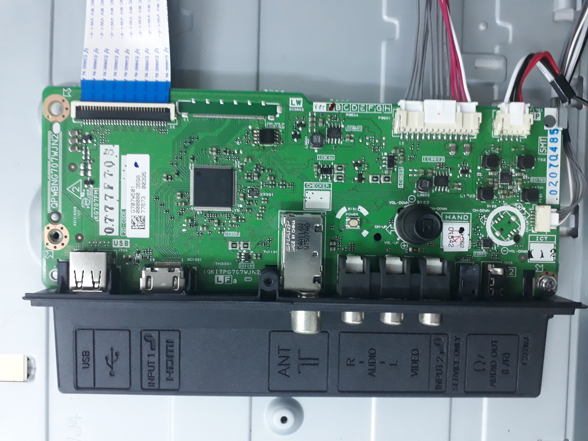

    Hi all
    I have two sharp 32" tv LC-32LE185M with same problem after surge current , no power led "red" or "green"
    I checked tv power supply it's supply 12 volt without problem, I checked power converter in main board , 5.0 and 1.2 and 3.3 volts is ok
    I flashed Eeprom without new , i cant find service manual or schematic
    any tips for solving problem?
    thanks

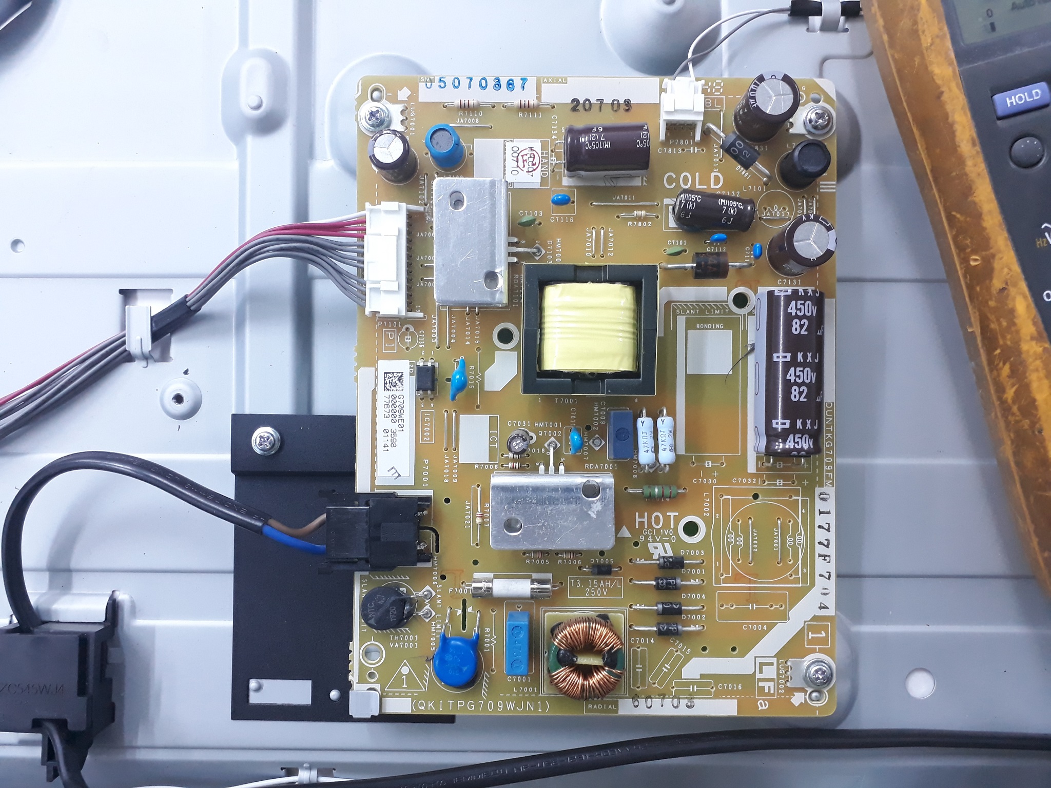

    Re: LC-32LE185M no led indicator
    Some photos of your power supply could prove helpful.
      the output of power supply only 12volt

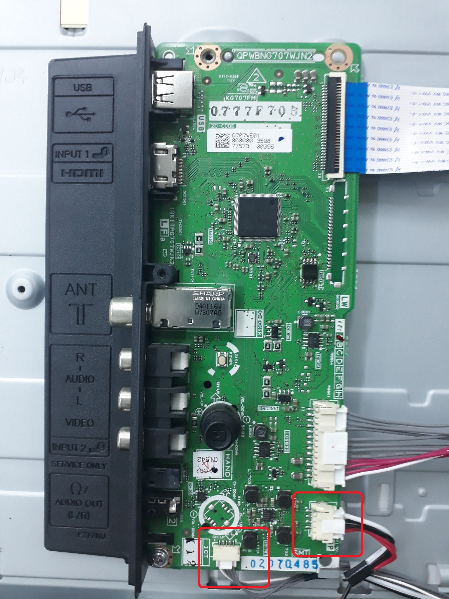

        Where do the cables on the two connectors go?
        • freeman3020
          • Jun 2019
          • 30
          • Palmo
          IR sensor , speakers
          i connect usb to serial to service port , i got his MHDHg3e2u▒▒▒▒y▒▒▒
          repeatly on port speed 115200
