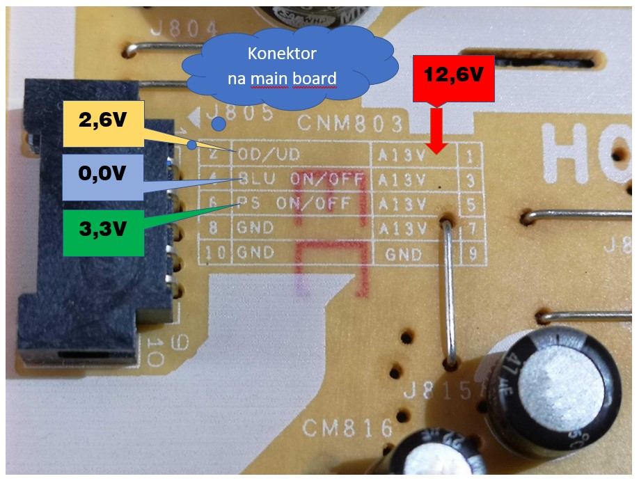

            Re: LED Samsung UE40J6272 flashing red led 6x
            measured voltage on
            mainboard connectors
              The backlight signal from the mainboard to turn on the backlights is missing according to your photo in post #6
              The slightly lower voltage on the 12V line can be ignorned.
