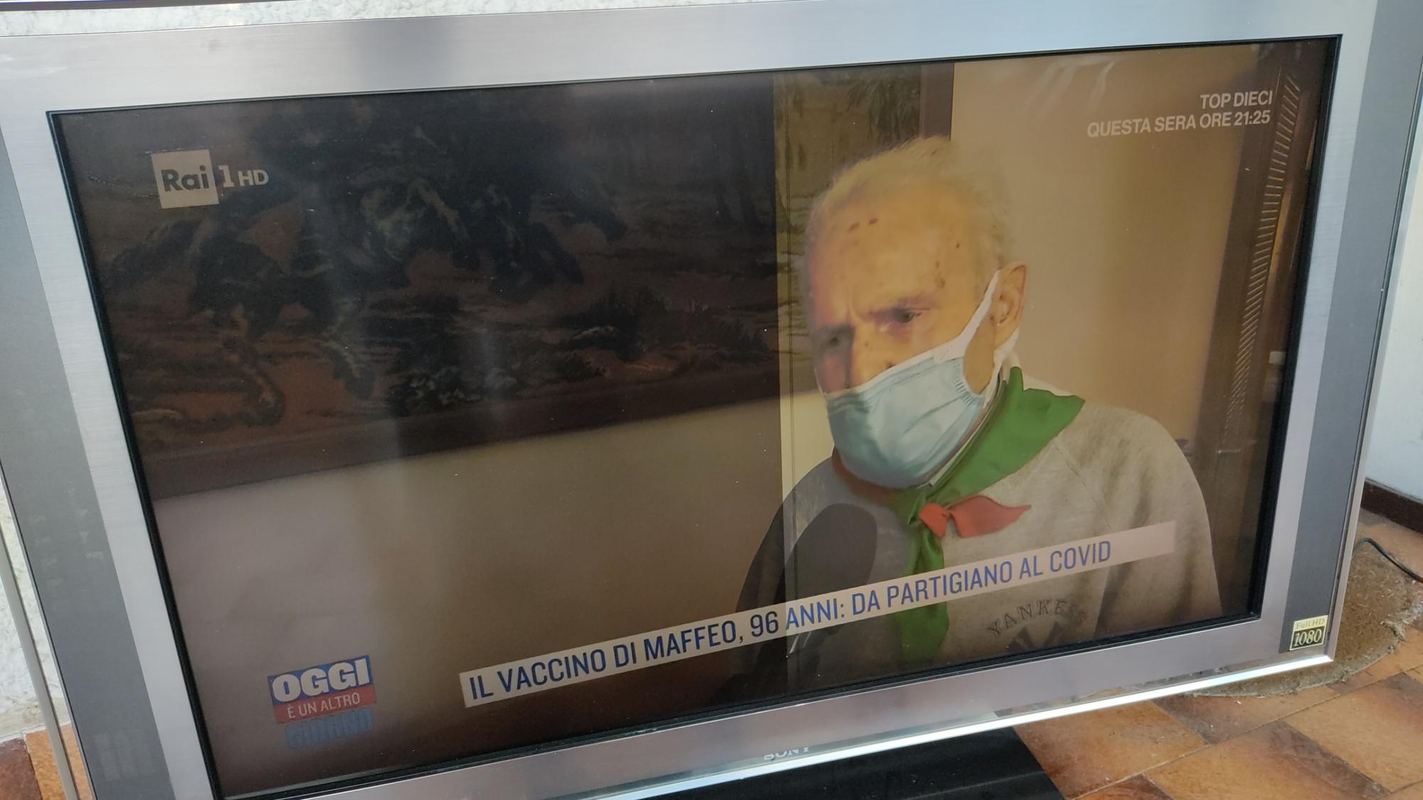

    Hello.
    A friend gave me this old piece of behemoth (it "only" weighs 49 kg).
    The problem is as shown in the attachment: the right part is more clear than the left part.
    I guess that's the T-Con that's somekind faulty, I found lightly different voltages between the left lcd electronic board and the right one on the VDD and AVDD test points.
    The T-Con is a 404652HHC8LV1.8. Googling around I found that in this forum there's someone that already dealed with this same T-Con, but for a different problem (if I hadn't misunderstood). This is the thread I'm referring to: https://www.badcaps.net/forum/showthread.php?t=88259
    Can someone help me track down where's the possibly fault?
    Thanks!
