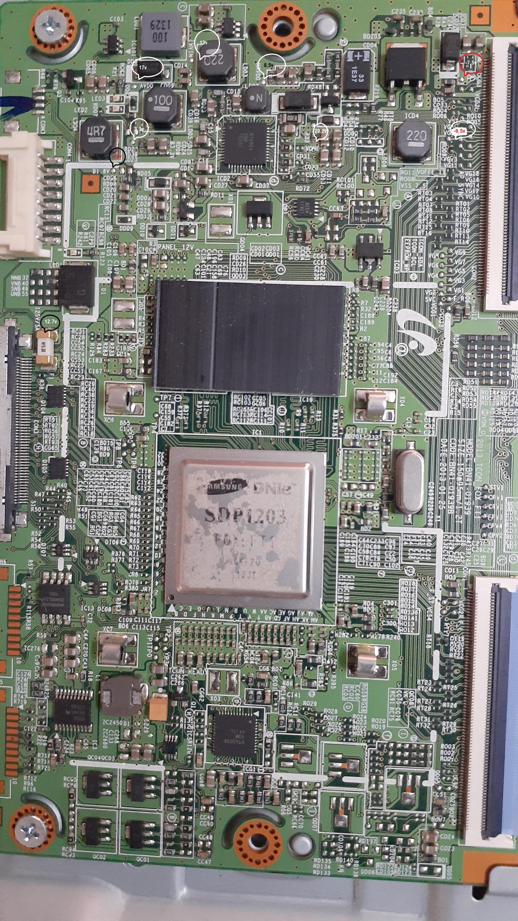

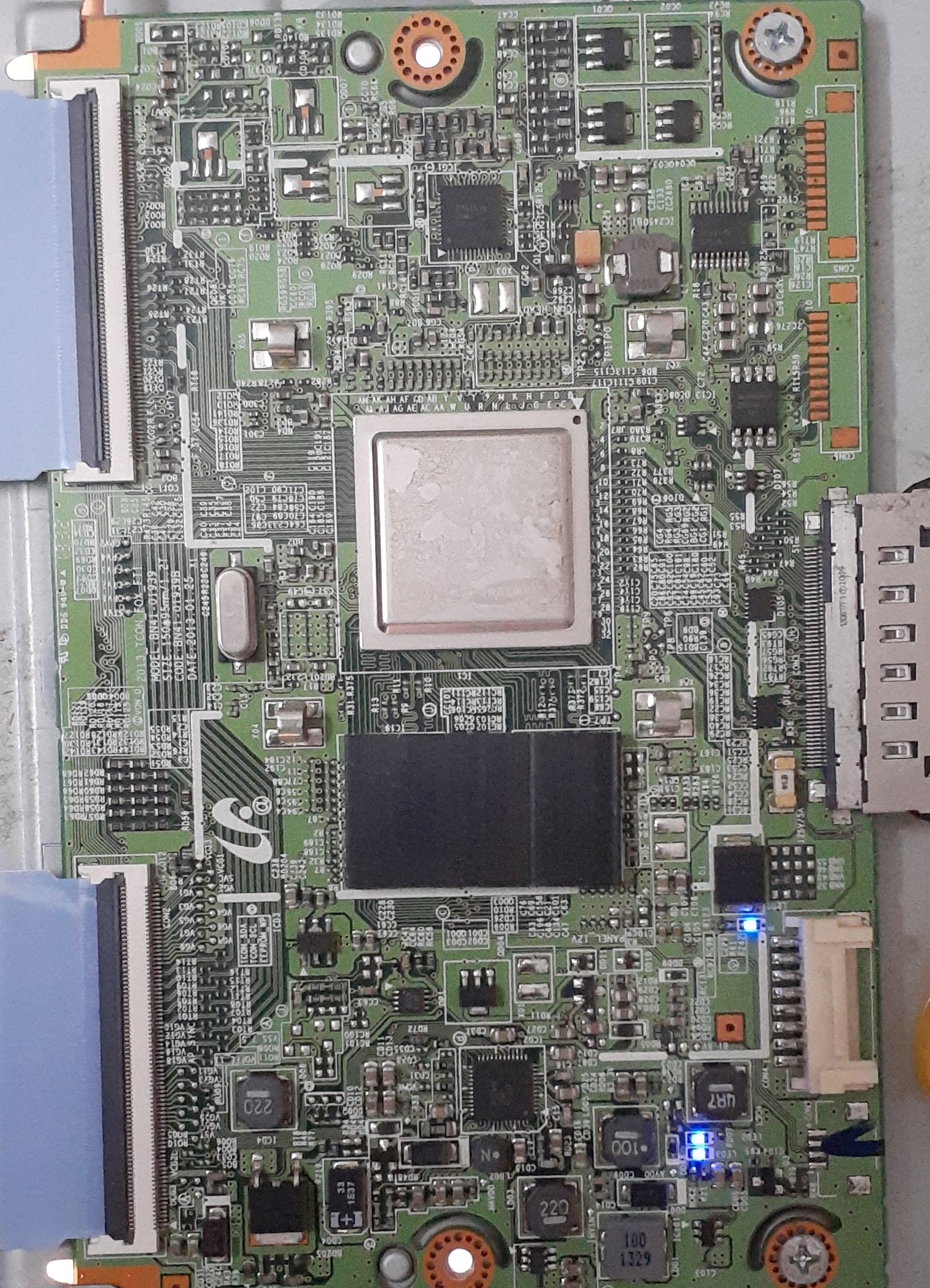

    Dear all,
    I have Samsung TV, which reboots continuously and I opened the TV and checked for loose connection - disconnect and reconnect all cables.
    When I power ON and noticed that its entered into Burn mode (RED/GREEN/BLUE) screen and I turned off and checked the cables again but this time it turned into white screen only. No matter how many times I restart the TV the result is same. But Sound is OK.
    Needed your help and expert advise, whether it is the TCON faulty or Total Panel Failure??
    TV Model: UA40F6400
    T-Con Model: BN41-01939B
    Below are the Voltage measurement.
    TCON LED status: All 3 Blue LEDs are ON.
    Panel: 12.7v
    AVDD:17v
    HAVDD:8.5v
    Fuse:12.7v
    B1.8:1.7v
    B3.3:3.3v
    HVin:13v
    VonE:29.2v
    VoffE: -9.5v
    Vss: -7.5v

    Re: Samsung UN40F6400 No Picture Bad T-Con or Panel!!!
    What voltage do you have at the Panel_12V point?
