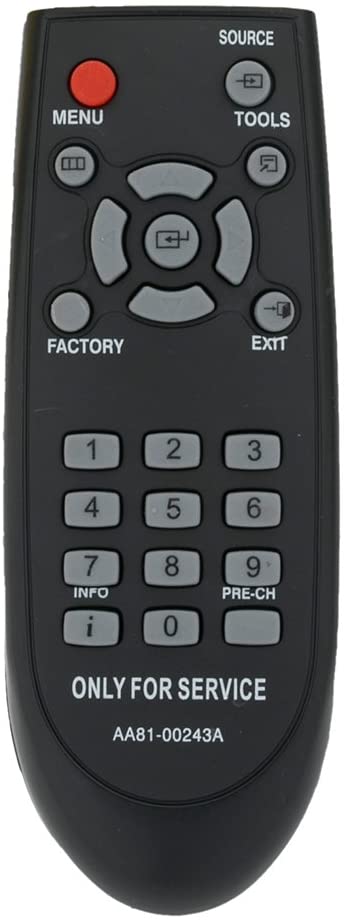

          In service menu, go to Advanced and press the (0) button four times to see the "Picture" menu
          If you don't have the Factory remote control, you can't control some menus (Expert, Advanced menu)
          There does seem to be a HV Flip option in the factory menu "Option", options are HV Flip / H Flip /OFF

                    There is a factory service remote (TM930) and it has a "Factory" button to access some of the sub menu's There is also a apk file to put on a phone so you can use it as the remote.
                      Cheers for that. Is the APK file pretty easy to track down or is it going to be a fun hunt on my part?
                      Also, from your recollection, is access to the "Type", "Local Set", "SW Model" and "BOM Model" options only allowed, with the use of a factory remote?
                      Also, as I can access it and did find the MRT Option submenu to do it, what, out of the options I listed in the OP, should "Front Colour Option" be set to?

                              In your experience as a technician, if someone doesn't have a service remote and is simply accessing the Service Menu via Info+Menu+Mute+Power, would "Type", "Local Set", "SW Model" and "BOM Model" all be greyed out due to access being restricted, because a service remote isn't being used, or would it be due to a faulty EEPROM, where those locations couldn't be written to. The fact that "SW Model" and "BOM Model" still have their settings intact, has me suspecting it's the former, but I know that these things can be less than straightforward.
                              Just wondering if I might need to track down a cheap EEPROM writer. I know from the thread I referenced initially in this thread, that the 24C256 is the culprit if that's the case, and that from what I've read, if the chip is damaged, I can replace it with a 24LC256, which costs around $6AUD locally and which has equivalent specs in most areas, while having a greater voltage range, which includes the voltage range of the 24c256.
                              • R_J
                                • Jun 2012
                                • 9551
                                Re: Samsung UA50F6400AMXXY help needed
                                It is likely greyed out to prevent customers from changing the data. I rarely need to go into the service menu. These settings as a rule never need to be changed. Changing certain things in the service menu can lead to a blank screen and then there is no way to go in and change the data.
                                I have not had to change anything in the service menu on these models so I can't really give you any advice.

                                      I ordered a service remote from O/S weeks ago but thanks to the current global situation, it'll be here next week, right after I head back home again LOL. Any chance you have a link to the APK file handy? I checked the Google Play store but it doesn't seem to be publicly available. I also went into the MRT Option submenu and the HV Flip option, along with half of the other functions in that submenu, that should be there according to the service manual, are hidden. Looks like I'm not getting at amything I need to without the press of a factory button.
                                      • dick_barton
                                        • Aug 2015
                                        • 6643
                                        • Wales
                                        This may be the one you are looking for.
