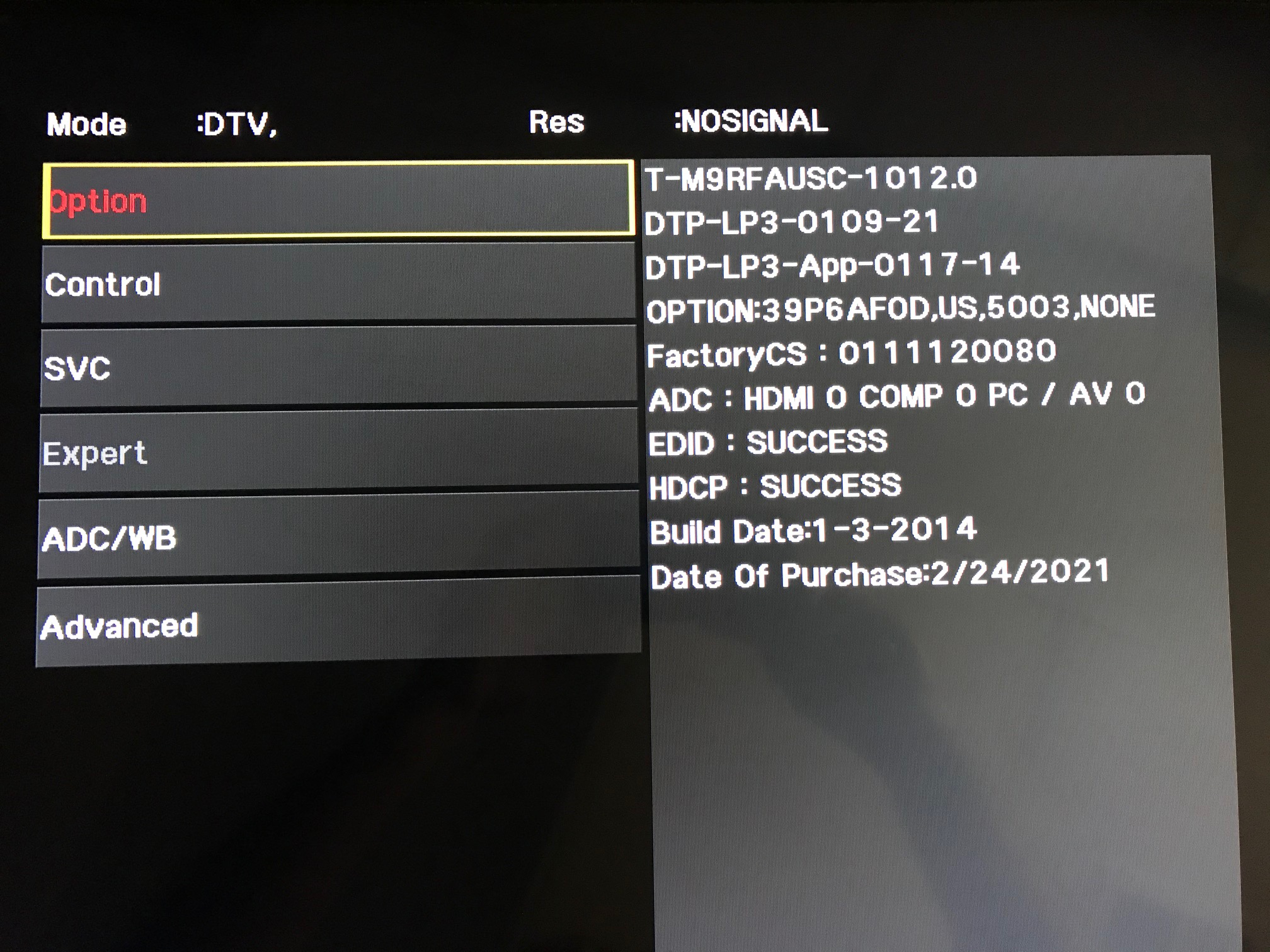

                            Ok, so life happened and I was just able to get back to this today.
                            Yes, replacing the main board is quite likely to fix this, but there's little fun in replacing the whole board. Not a lot learned from that so its really a total last resort, maybe. lol
                            I just built an Arduino IR blaster and used this code to send INFO > FACTORY: https://github.com/ironman977/SamsungIRRemote
                            This popped up the factory stuff, and I did a Factory Reset. Unit shutdown and then auto-powered back up. But, the problem persists. It will not stay off/standby.
                            I didn't try the FACTORY+3SPEED option. Is there anything in there?
                            Thanks again for sticking with me on this!

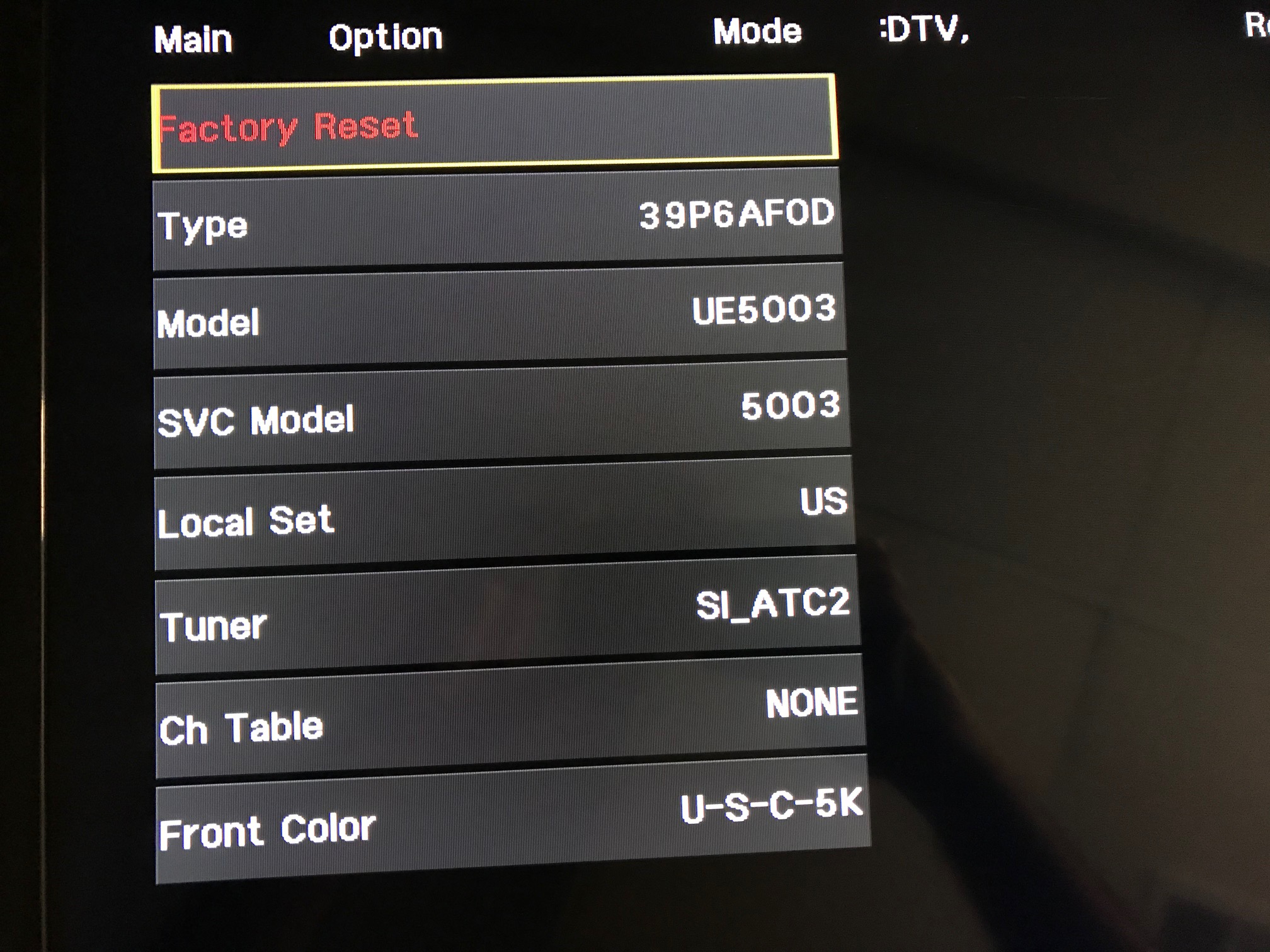

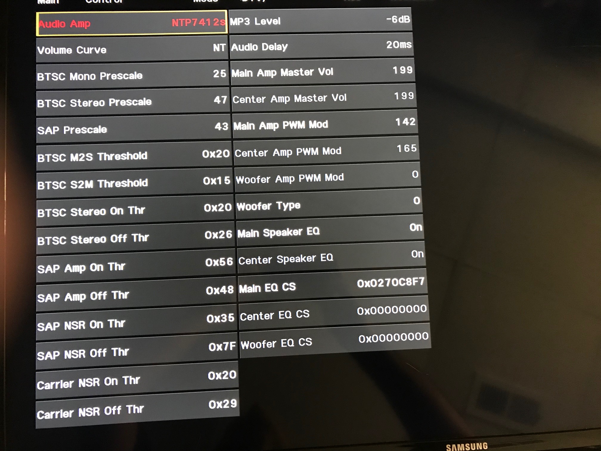

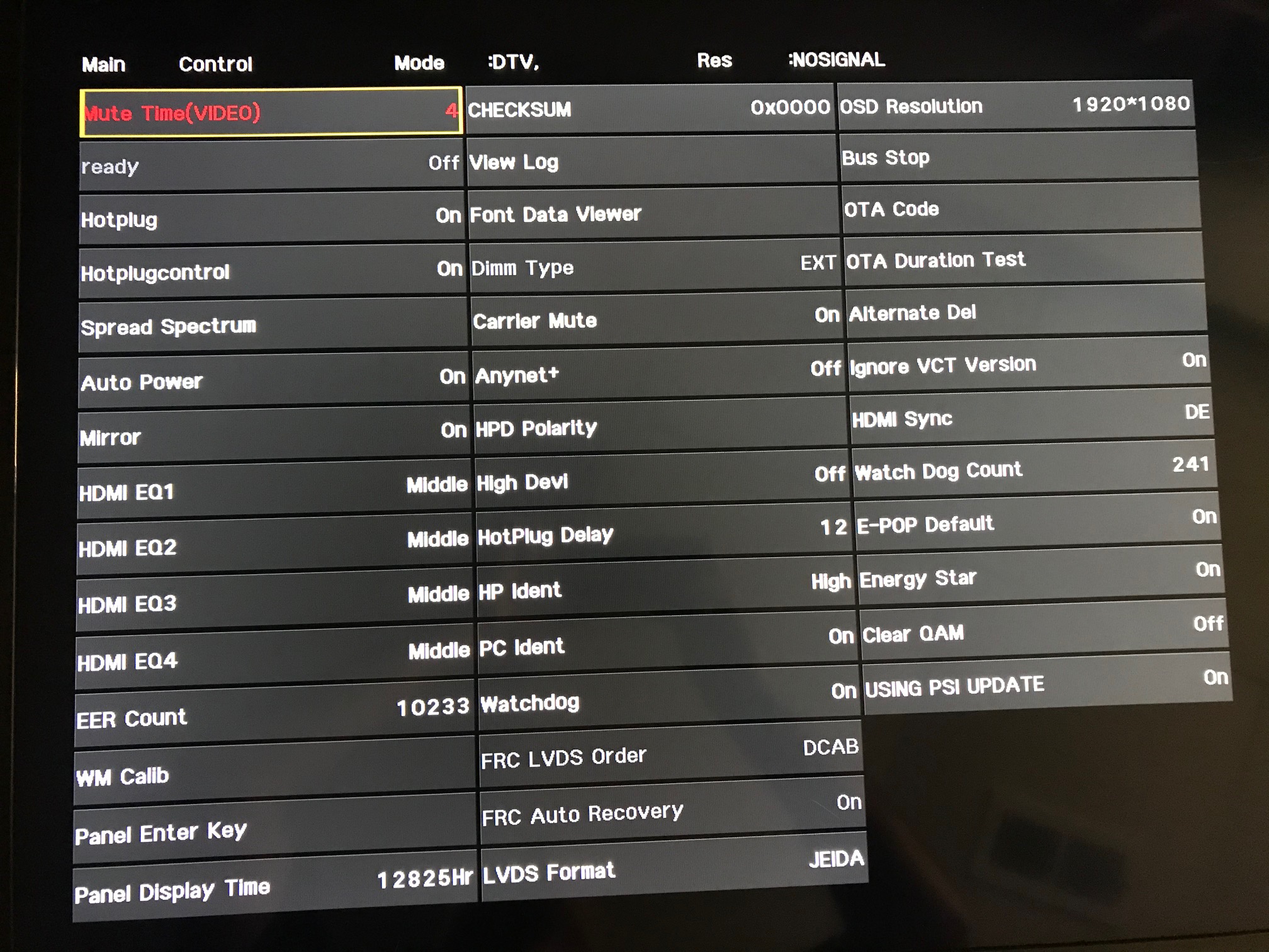

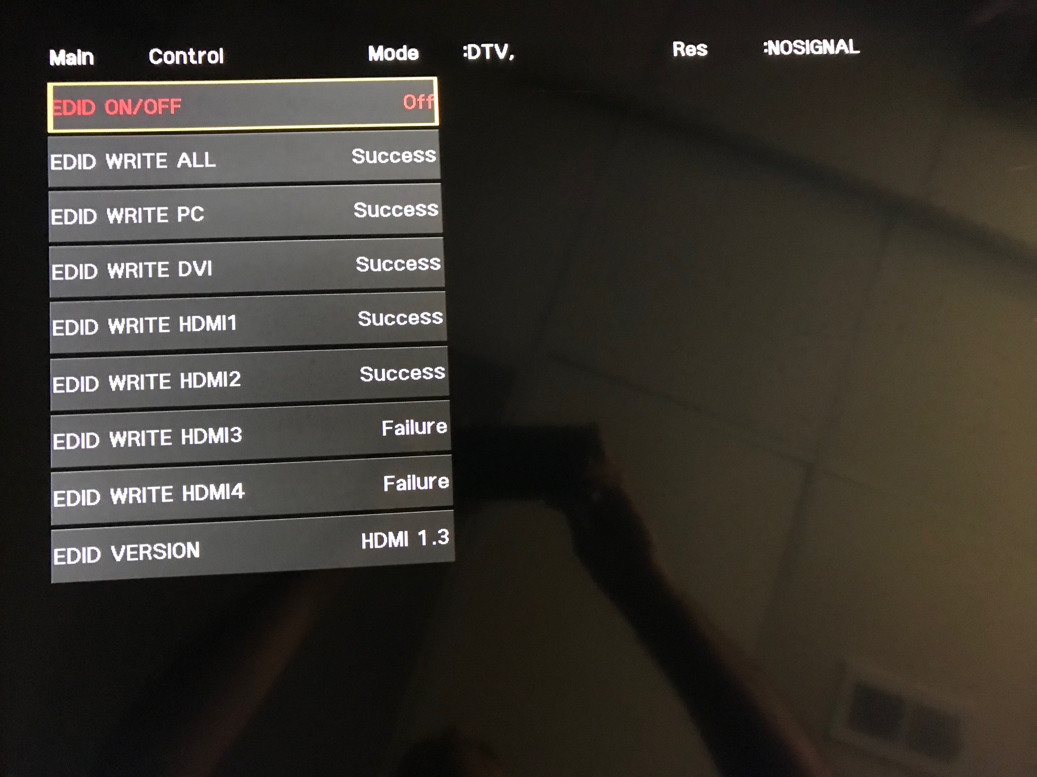

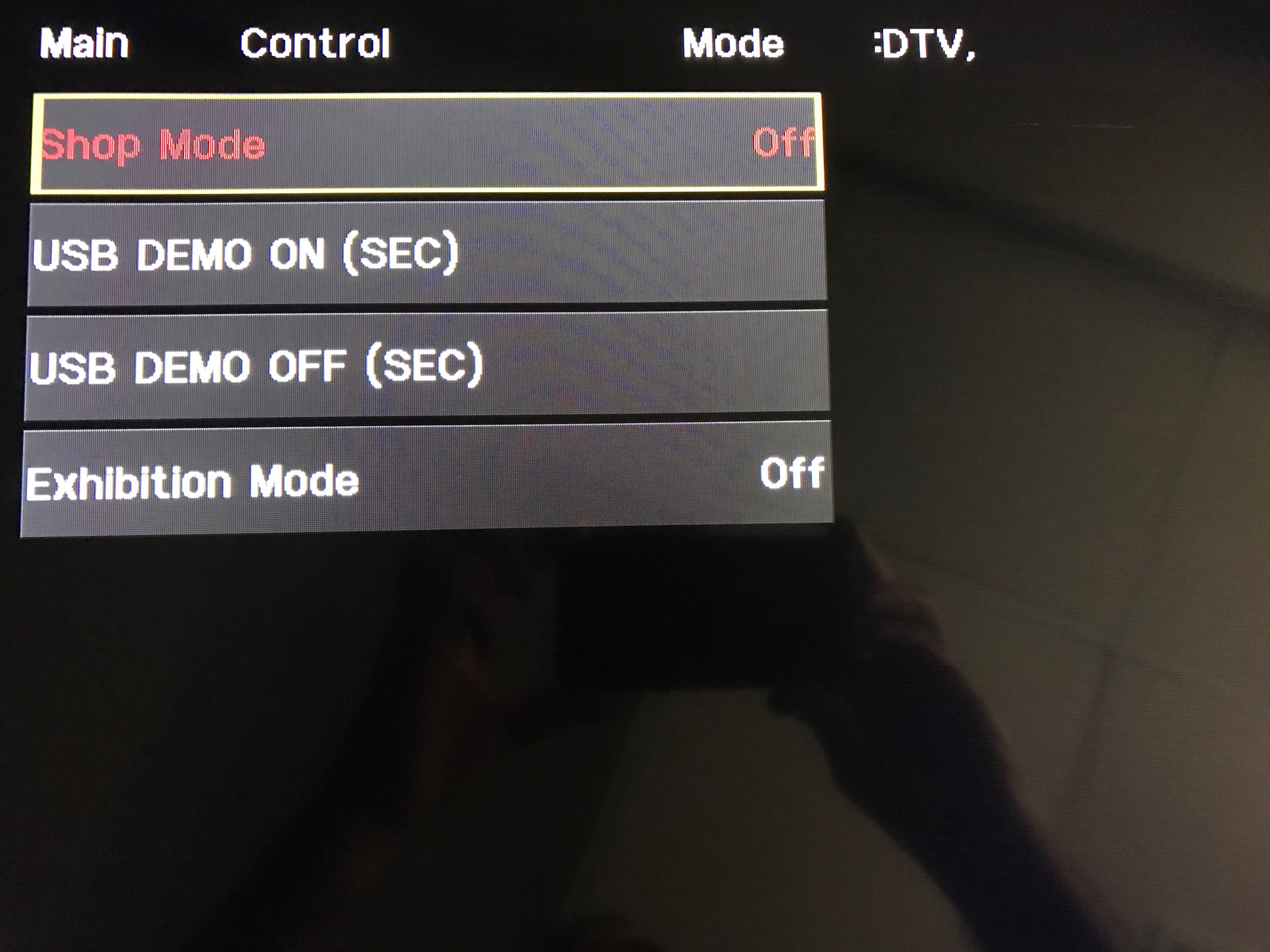

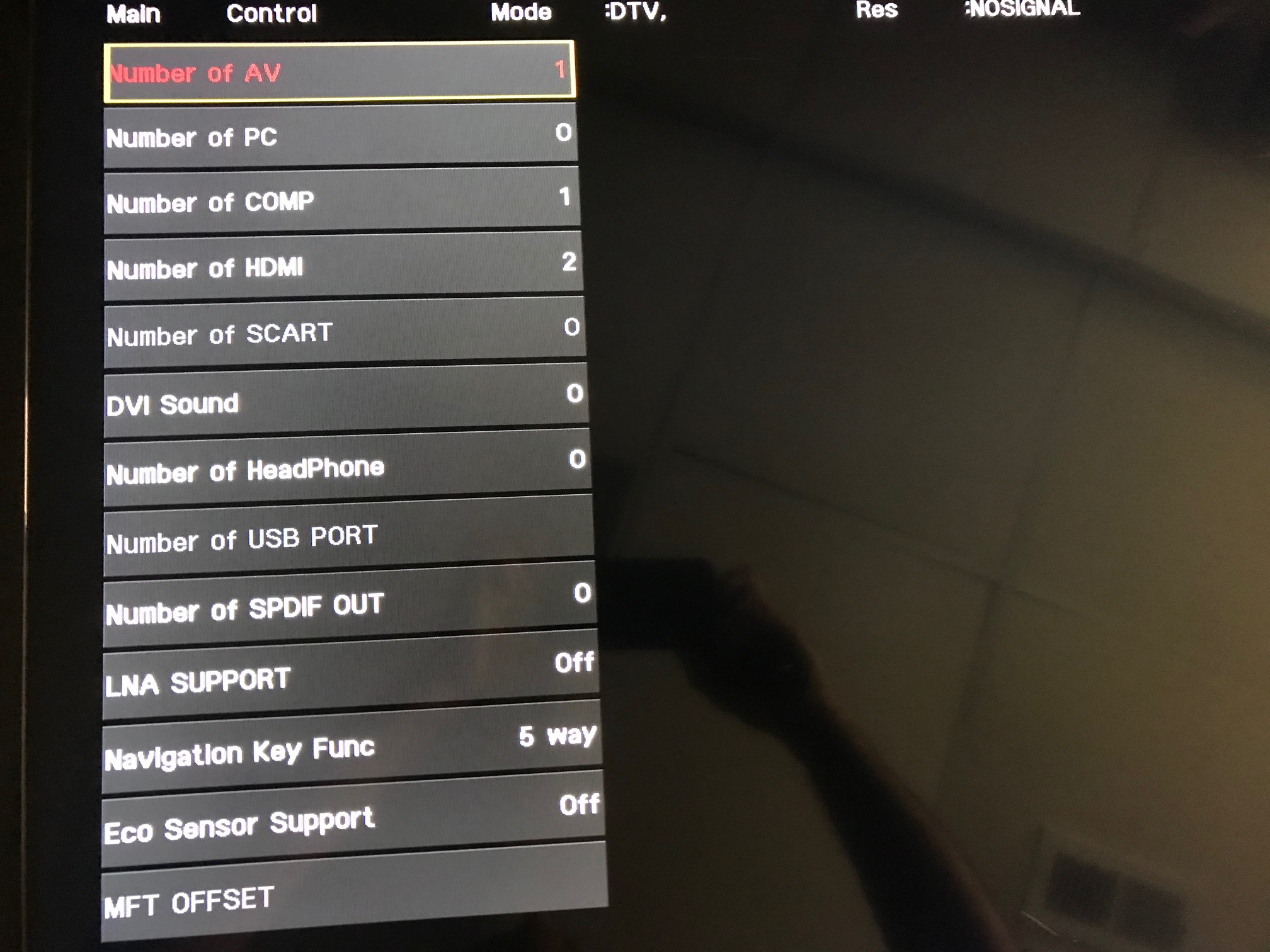

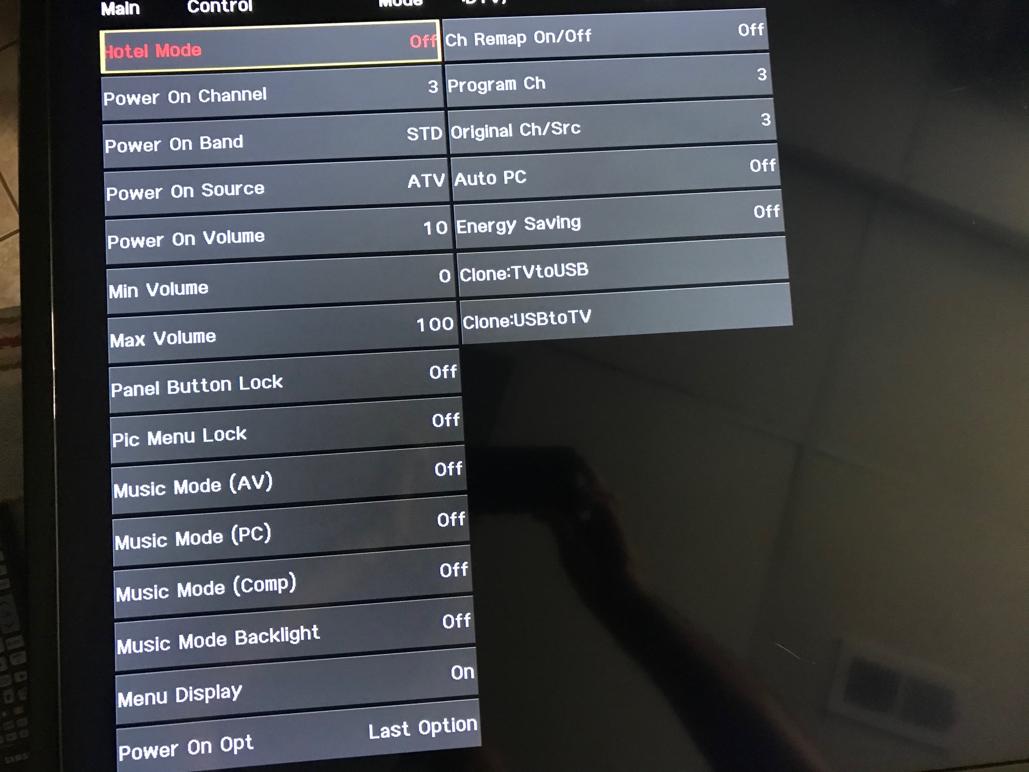

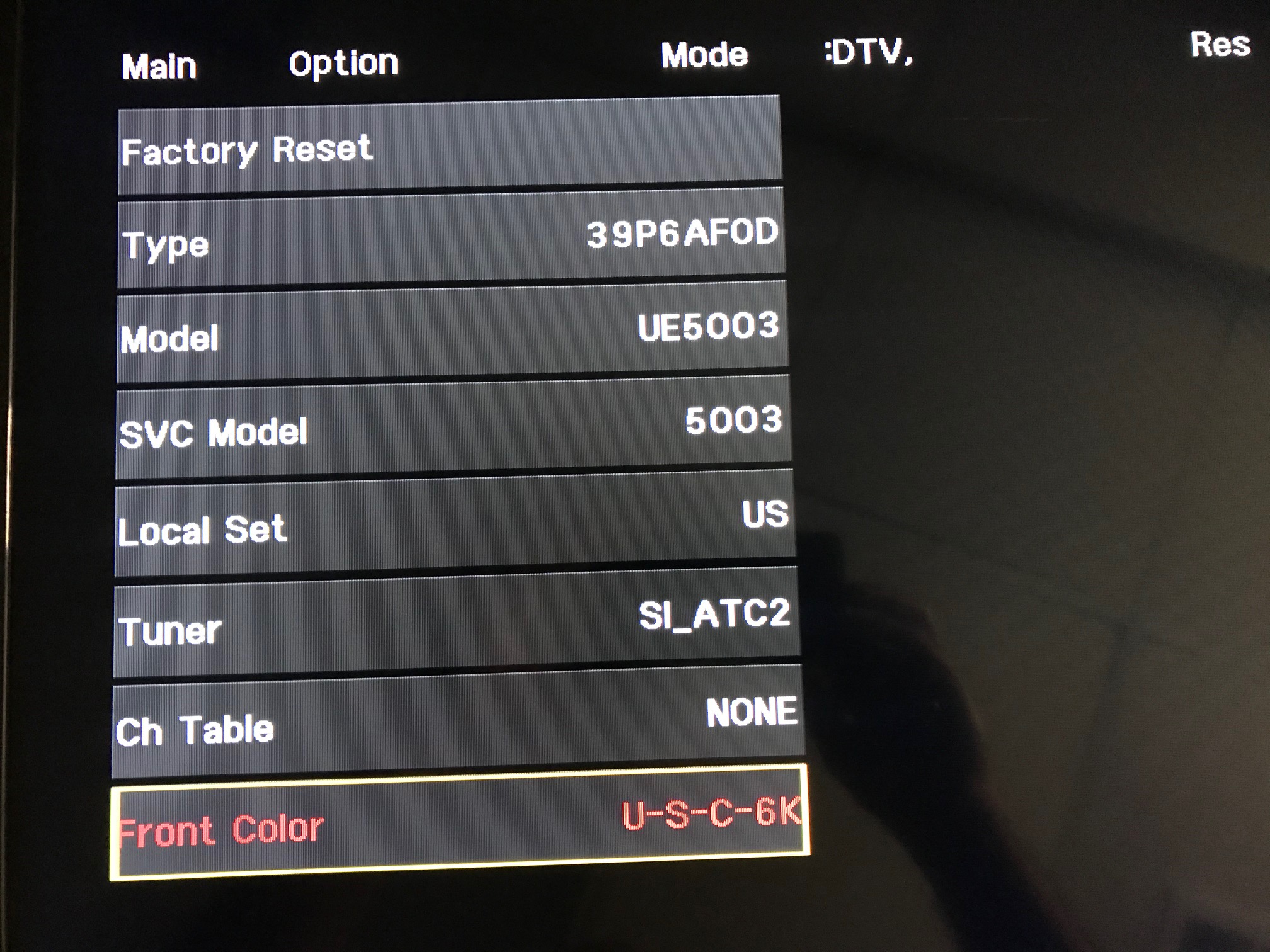

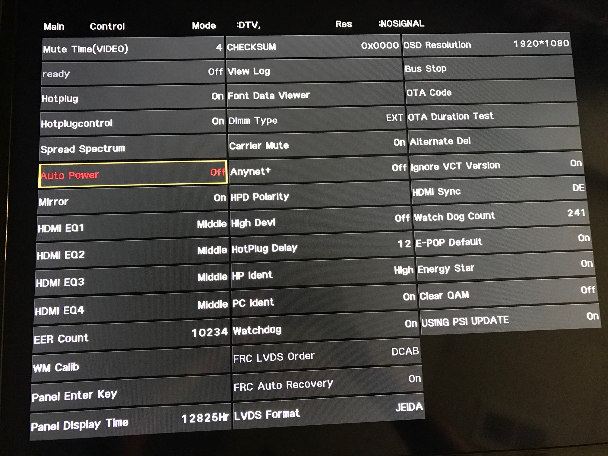

                                I have a fallback plan that gets the TV fixed, but I am not prepared to call this done yet. I ordered a used mainboard off eBay for $20 and it works. The TV behaves. But, this is a last resort!
                                Attached are the settings I hope are relevant. I tried to make a change, like the Auto Power setting but it just doesn't save. (Is there a 'save' option I missed?) Also, since I have a working mainboard to reference, I dumped the 24512 eeprom from the working board and uploaded it to the faulty mainboard, hoping it might be corrupted. No change... behaves exactly the same. I also tried to disable the Watchdog without success.
                                So I still have the TV in pieces, because I'd like to fix the bad mainboard if at all possible. Any ideas?!? I picked a real head scratcher!

                                  there are no save. any change will be active at next start,
                                  yours photo https://www.badcaps.net/forum/attach...4&d=1616707728
                                  the last one "power on opt" change it from "last option" to standby. if it didn't work then the I2C on chip fault need empty one to write it with dumps you have.
