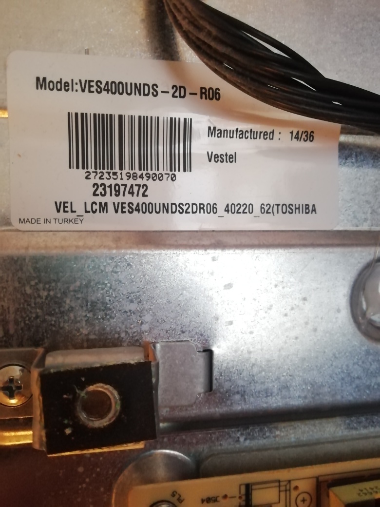

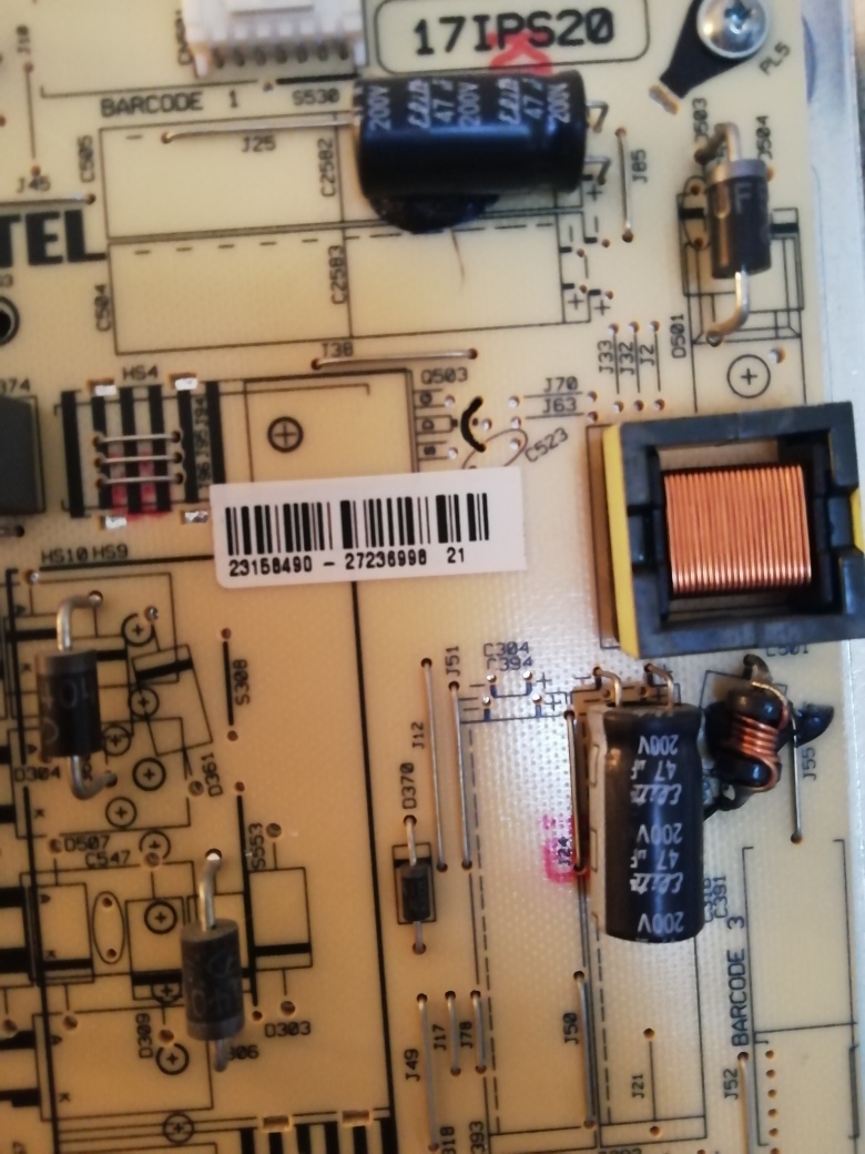

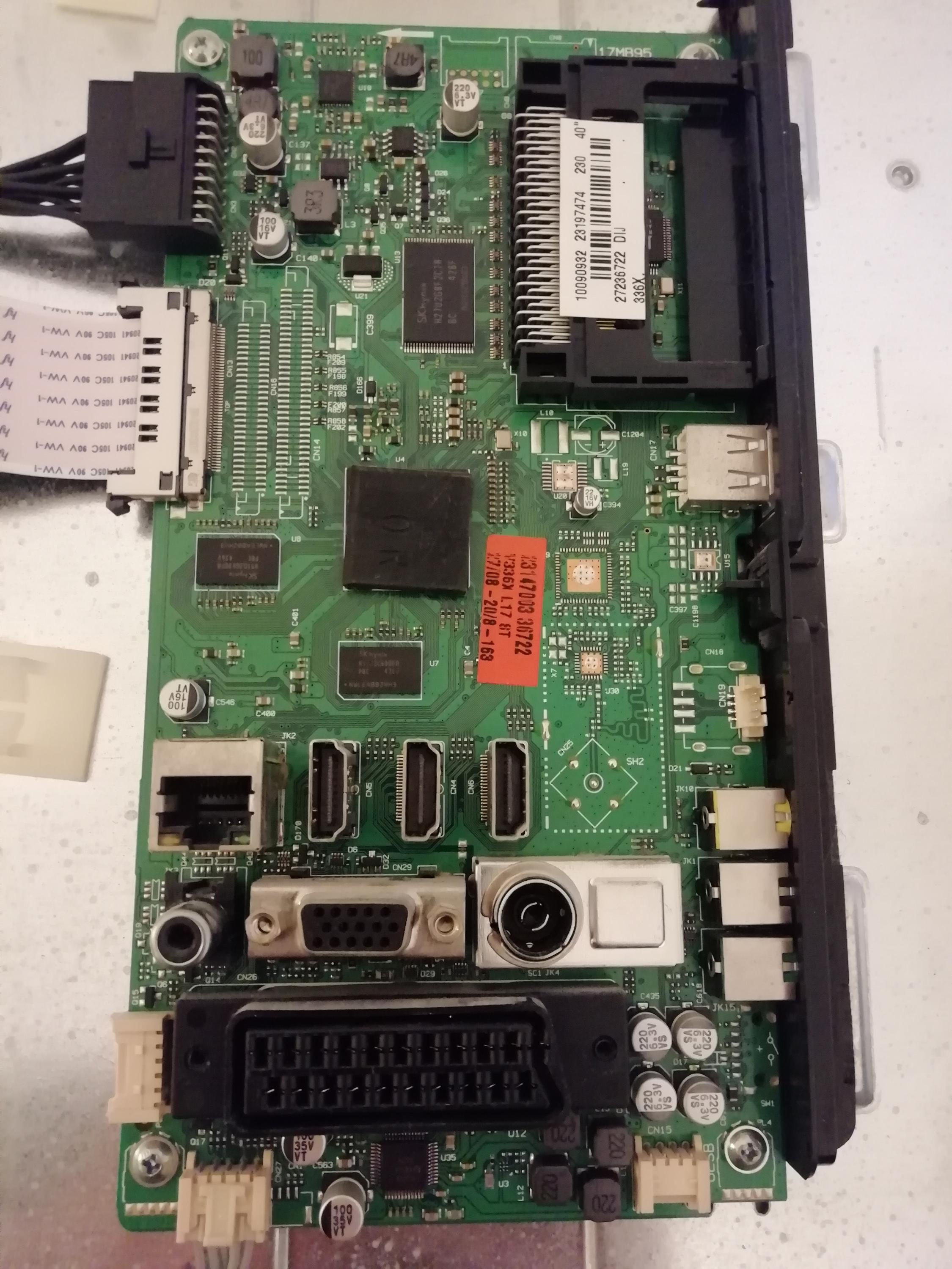

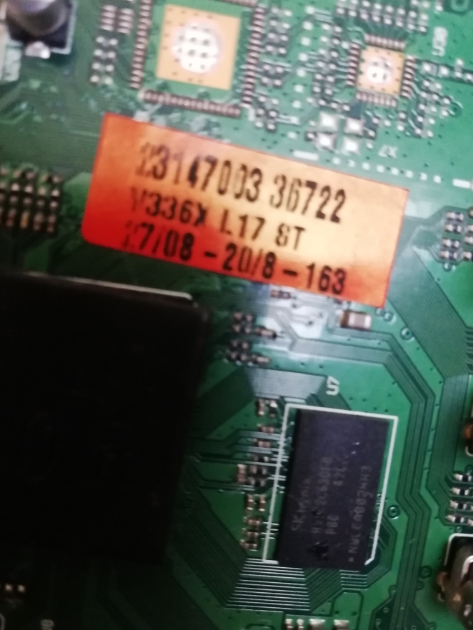

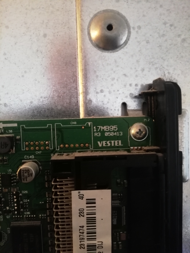

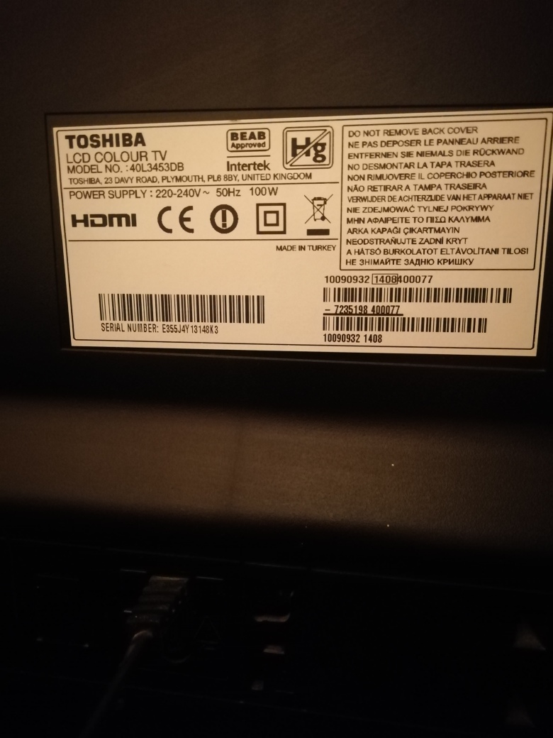

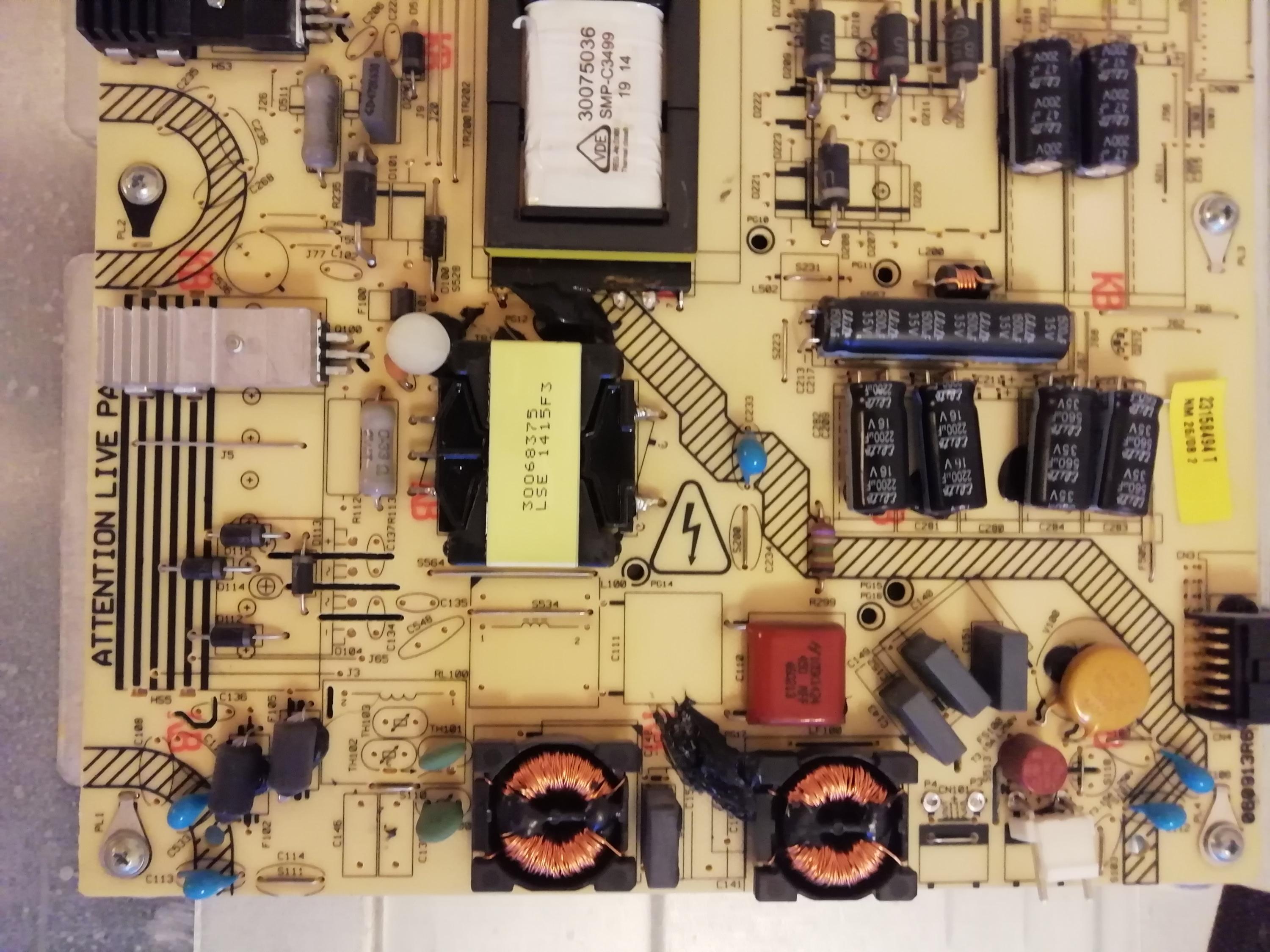

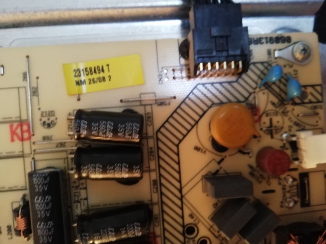

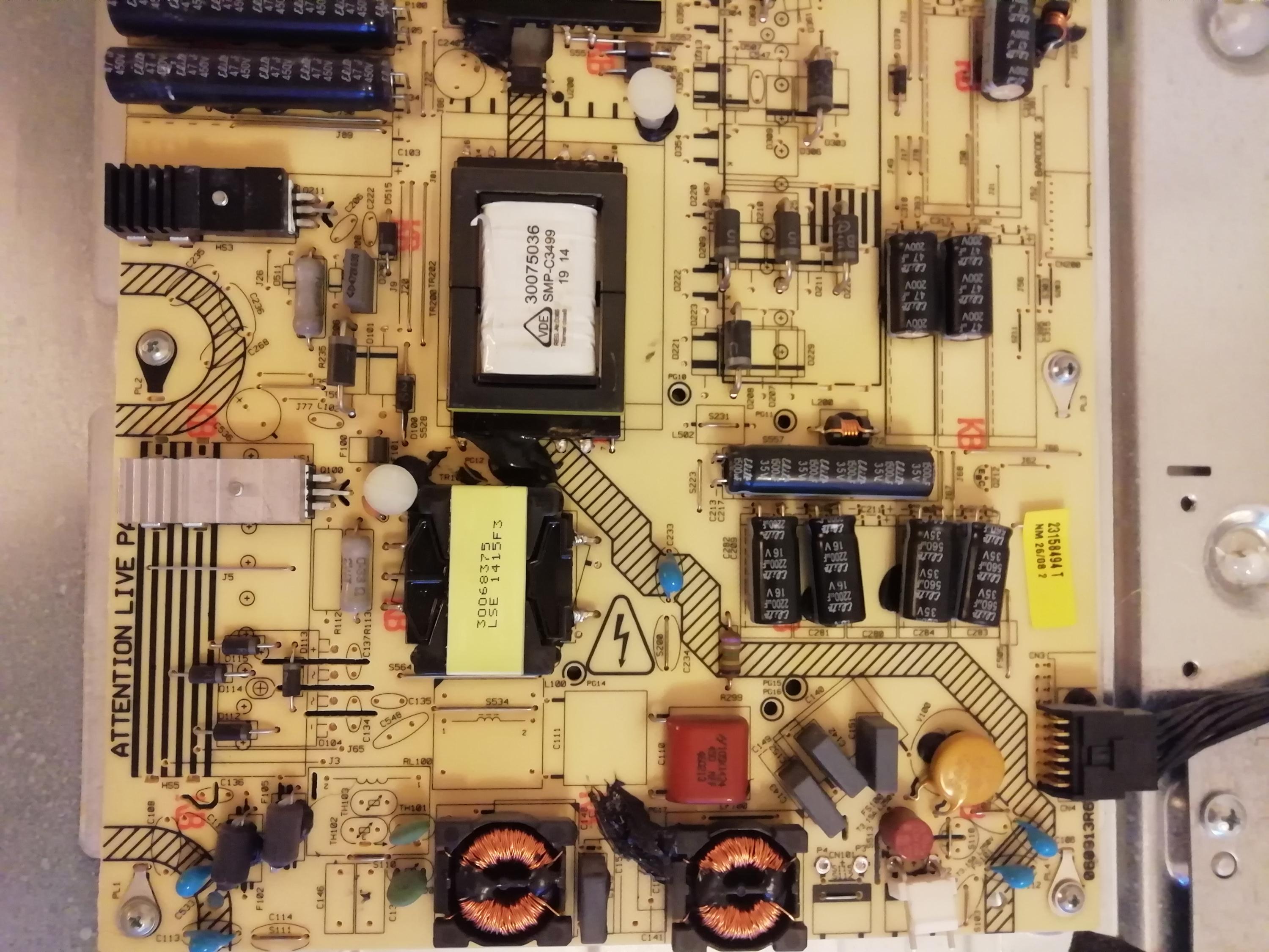

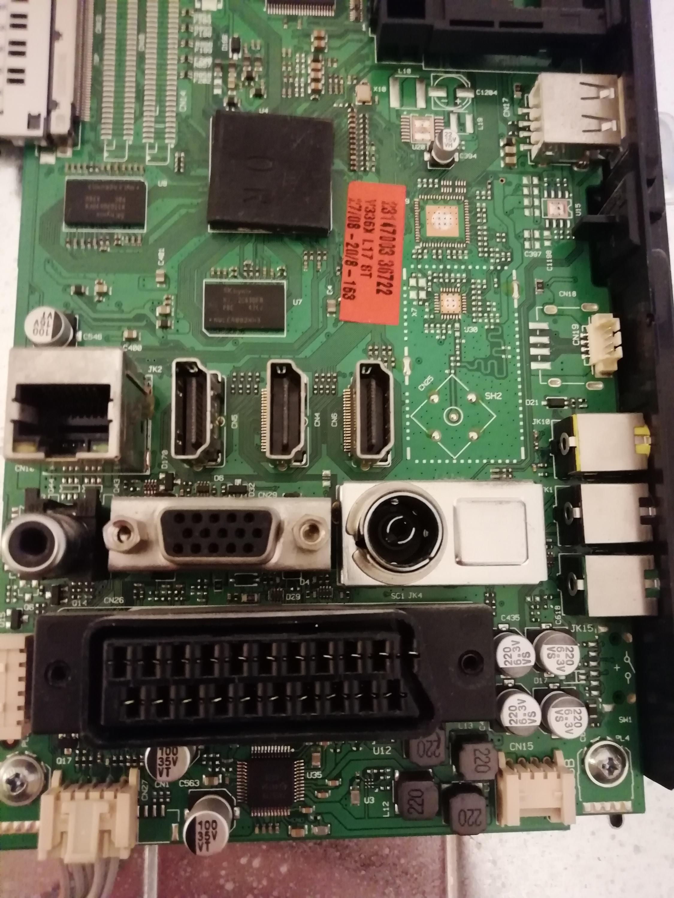

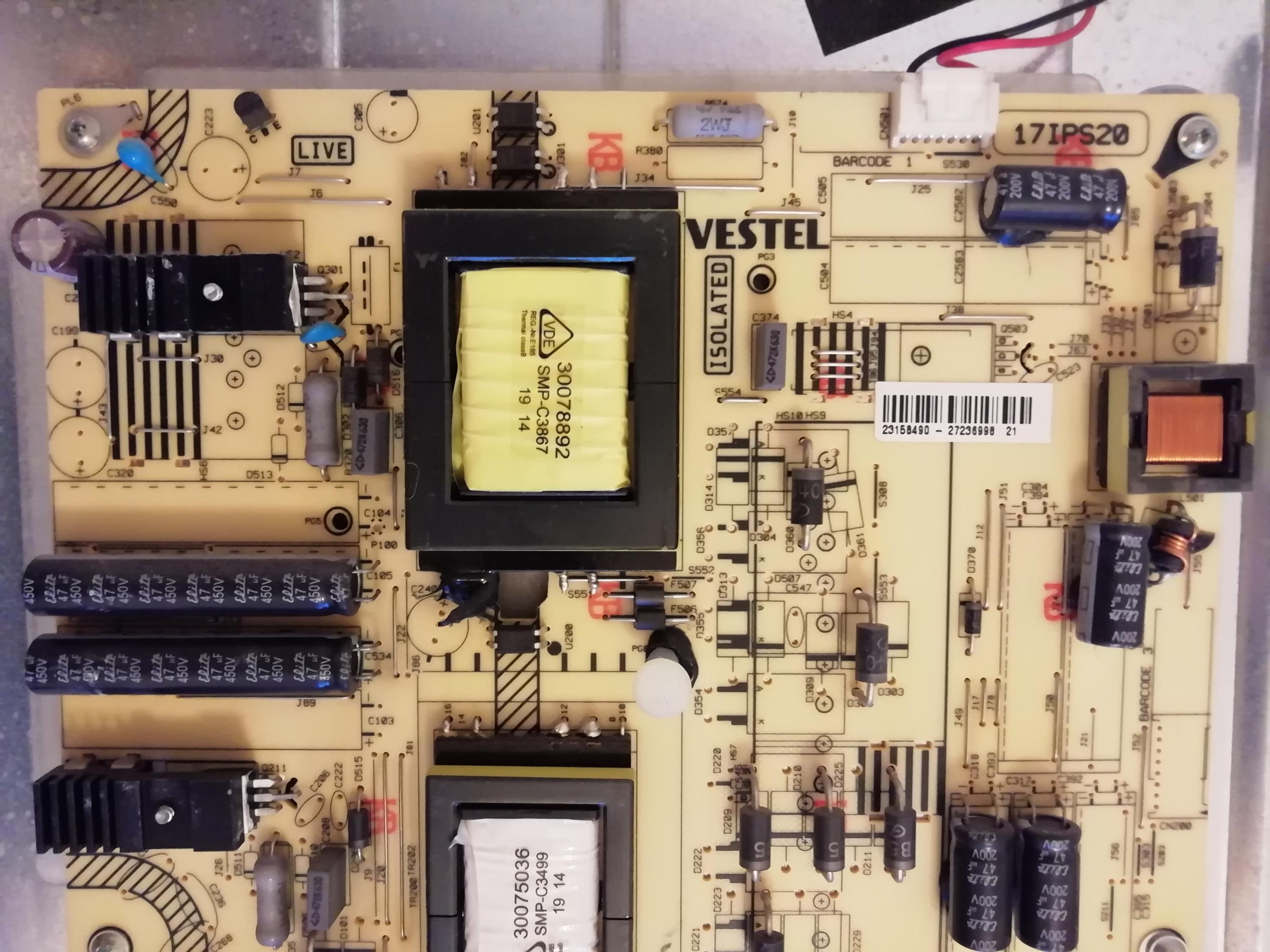

TOSHIBA 40L3453DB red-green blinking light
  • Fergal22
    replied
    Re: TOSHIBA 40L3453DB red-green blinking light
    Originally posted by Diah
    show me please clear focused photo on the whole mainboards.
    Hi, thanks for the reply,
    I have attached more pictures, my phone camera is not the best, if you let me know what particular area of the board you want to see i will take a close up shot of it
    Leave a comment:
  • Diah
    replied
    Re: TOSHIBA 40L3453DB red-green blinking light
    show me please clear focused photo on the whole mainboards.
    Leave a comment:
  • Fergal22
    replied
    Re: TOSHIBA 40L3453DB red-green blinking light
    Originally posted by Diah
    the other threat you are mentioned and compare to yours set .. they were not sure about firmware.. so they comment the mboot section, here at your threat i am sure of yokoono firmware 100% yours.... so no need to write "try" ..
    if we were not polite enough.. then will never share and answer you. but if some one dont trust this forum & the answer from users, let him go to pay for recovery firmware from ebay..
    I never said i did not trust the forum, i have the upmost respect for people who have the knowledge and share and help others, i just found your reply a bit harsh towards a newbie that's all, i just wanted to make sure there was nothing else i had to do before going ahead and trying it as i did not want to run the risk of bricking it
    Well it looks like it has bricked it as i tried the firmware from the second link yokoono posted
    plugged usb in, turned power on and pressed and held the ok key on the remote
    The red/green blinking light changed to a constant red, not a fast blinking red/green light as it should do so left it for 10 minutes then turned it off, removed usb stick then turned TV on again and now there is no light whatsoever on the tv. no blinking light, no grey screen no booting, its dead no life at all
    Does anyone have any suggestions apart from throwing it in the skip?
    Last edited by Fergal22; 02-15-2021, 05:17 PM. Reason: Spelling
    Leave a comment:
  • Diah
    replied
    Re: TOSHIBA 40L3453DB red-green blinking light
    Originally posted by Fergal22
    A simple No you don't need to alter anything, just give it a try would of sufficed
    Politeness and manners especially to a newbie costs nothing my friend
    the other threat you are mentioned and compare to yours set .. they were not sure about firmware.. so they comment the mboot section, here at your threat i am sure of yokoono firmware 100% yours.... so no need to write "try" ..
    if we were not polite enough.. then will never share and answer you. but if some one dont trust this forum & the answer from users, let him go to pay for recovery firmware from ebay..
    Leave a comment:
  • Fergal22
    replied
    Re: TOSHIBA 40L3453DB red-green blinking light
    A simple No you don't need to alter anything, just give it a try would of sufficed
    Politeness and manners especially to a newbie costs nothing my friend
    Last edited by Fergal22; 02-15-2021, 01:10 PM.
    Leave a comment:
  • Diah
    replied
    Re: TOSHIBA 40L3453DB red-green blinking light
    Originally posted by Fergal22
    Thankyou both for yor help
    Before i try it i noticed in the other thread about the "40L1333DB" tv
    ASEk94 states about commenting out certain parts of the "usb_auto_update_A1.txt" file
    https://www.badcaps.net/forum/showpo...52&postcount=9
    Will i have to do the same for my 40L4353DB" or can i just go ahead as is?
    Man, your issue firmware... even if you flash firmware now from the Mars you can always to reflash another firmware.. why you keep talking on model didn't related to yours !!!!
    Leave a comment:
  • Fergal22
    replied
    Re: TOSHIBA 40L3453DB red-green blinking light
    Thankyou both for yor help
    Before i try it i noticed in the other thread about the "40L1333DB" tv
    ASEk94 states about commenting out certain parts of the "usb_auto_update_A1.txt" file
    https://www.badcaps.net/forum/showpo...52&postcount=9
    Will i have to do the same for my 40L4353DB" or can i just go ahead as is?
    Last edited by Fergal22; 02-15-2021, 09:24 AM.
    Leave a comment:
  • Diah
    replied
    Re: TOSHIBA 40L3453DB red-green blinking light
    Originally posted by Fergal22
    mb90_en.bin
    mboot.bin
    usb_auto_update_A1
    any further help would be appreciated
    use the second link thankfully yokoono provided at the his post..
    Leave a comment:
  • yokoono
    replied
    Re: TOSHIBA 40L3453DB red-green blinking light
    Below you will find 2 softwares for 17mb95. With MBOOT of 1 and 2Mb respectively.
    https://file.fm/u/x5xrafm2s
    https://file.fm/u/6ygn8fapd
    Leave a comment:
  • Fergal22
    replied
    Re: TOSHIBA 40L3453DB red-green blinking light
    Originally posted by Diah
    if the firmware name you downloaded upgrade_mb90.bin and its size about 108 MB then its core firmware should work.
    Ok i tried doing it but nothing happens
    I have found more software for the "32W1333DB" which is the smaller model tv than mine and the folder is called "CORE UPDATE ONLY, USE THIS IF SET WORKING - v2.1.9Z" in the folder there is a "upgrade_mb90.bin" file and a PDF called "MB95_Core-SW_update.pdf"which i have attached
    It says that the "upgrade_mb90.bin" file is only used if the tv is working and you do it through the menu's, my tv is not working so cannot do this
    It also states
    "IMPORTANT:
    There exist 2 Core-SW files for MB95 models:
    a) for models with DVB-T & -C tuner (D/DL/L/W133x / 134x based models)
    b) for models with DVB-T & -T2 & -C tuner (D/DL/L/W135x based models)
    Notice: Files for T2 models have nearly double file size.
    As both Core-SW files must be named “upgrade_mb90.bin” in order to be detected by the set, make sure, NOT to mix up files for T and T2 models !
    Flashing a wrong Core-SW can lead to malfunction of the set after updating !"
    so it looks like i need a file package containing 3 files like the one "ReeceyBurger123" uploaded for the "32W1333B" but for the "40L3453DB" model tv which i have but cannot find one anywhere containing the following files for my model TV
    mb90_en.bin
    mboot.bin
    usb_auto_update_A1
    any further help would be appreciated
    Last edited by Fergal22; 02-14-2021, 05:17 PM.
    Leave a comment:
  • Diah
    replied
    Re: TOSHIBA 40L3453DB red-green blinking light
    Originally posted by Fergal22
    if the firmware name you downloaded upgrade_mb90.bin and its size about 108 MB then its core firmware should work.
    Leave a comment:
  • Fergal22
    started a topic TOSHIBA 40L3453DB red-green blinking light
    TOSHIBA 40L3453DB red-green blinking light
    Hi, just need a bit of advice please
    I have a Toshiba 40L3453DB tv with the blinking red/green light and the light grey screen but no picture or sound
    there are no swollen caps as far as i can see
    I have searched the forum and found this thread for the smaller size tv
    https://www.badcaps.net/forum/showthread.php?t=58640
    which recommends redoing the firmware, so i have searched and the only firmware i can find is this one
    h**ps://repairalltv.com/toshiba-40l3453db-software-17mb95-download/
    the 17MB95 board is the same as mine but the Panel model panel number is slightly different to what they show on that link, there's is Panel NR- VES400UNDS-03
    mine is VES400UNDS2DR06-2D-R06
    I have download the file and all it contains is the "upgrade_mb90.bin" file
    Does anyone know if this will work and will it flash using this by powering on holding the ok button down on the remote or do i need mboot and usb_auto_update_A1 file to go with it like in the other thread on here in the first link?
    I have attached pictures of my boards, any help would be appreciated
    Last edited by Fergal22; 02-14-2021, 03:38 AM.
    09-06-2024, 05:27 AM
    09-06-2024, 05:59 AM
    09-06-2024, 05:59 AM
    09-06-2024, 05:59 AM
    09-06-2024, 05:33 AM
