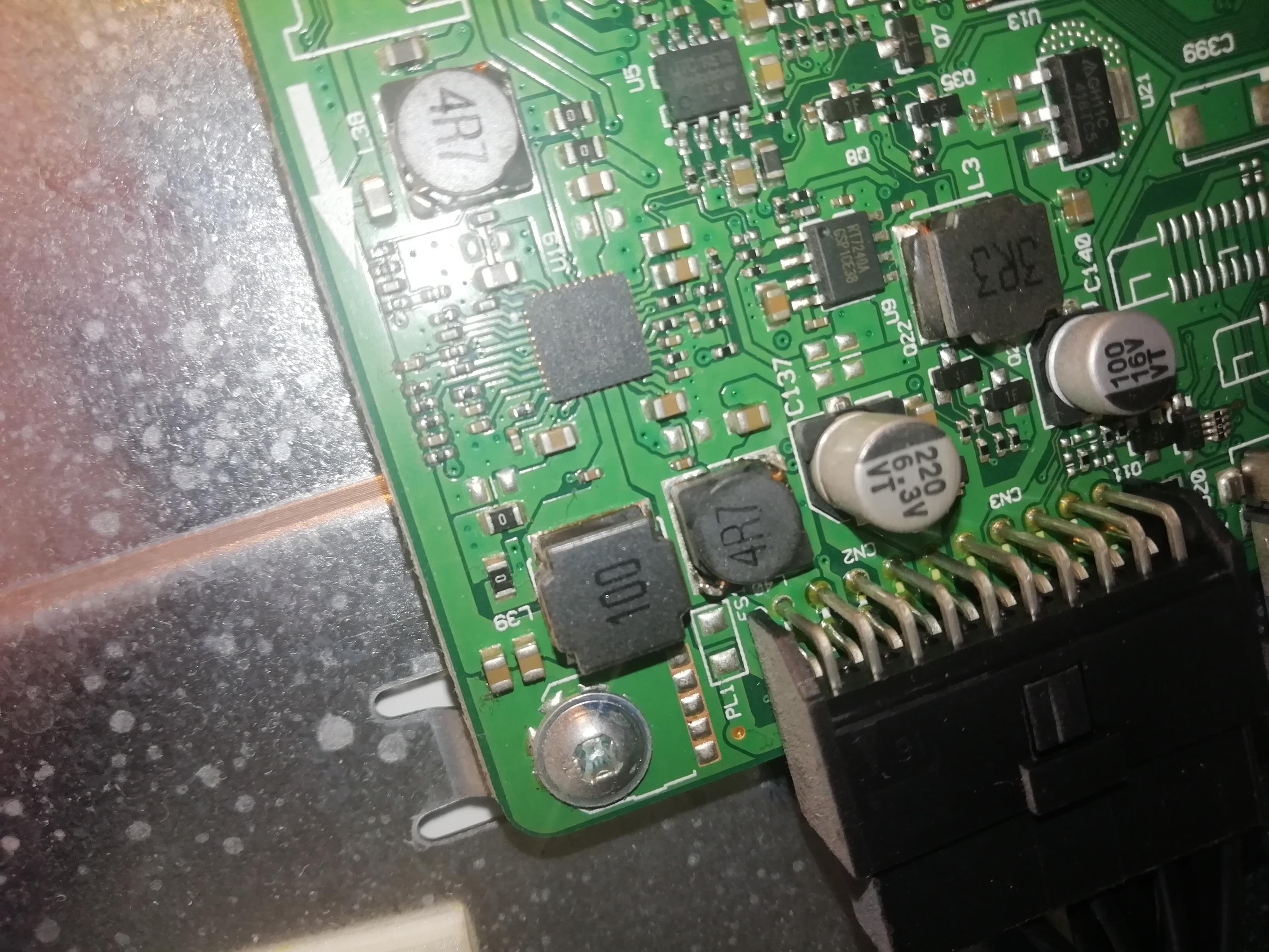

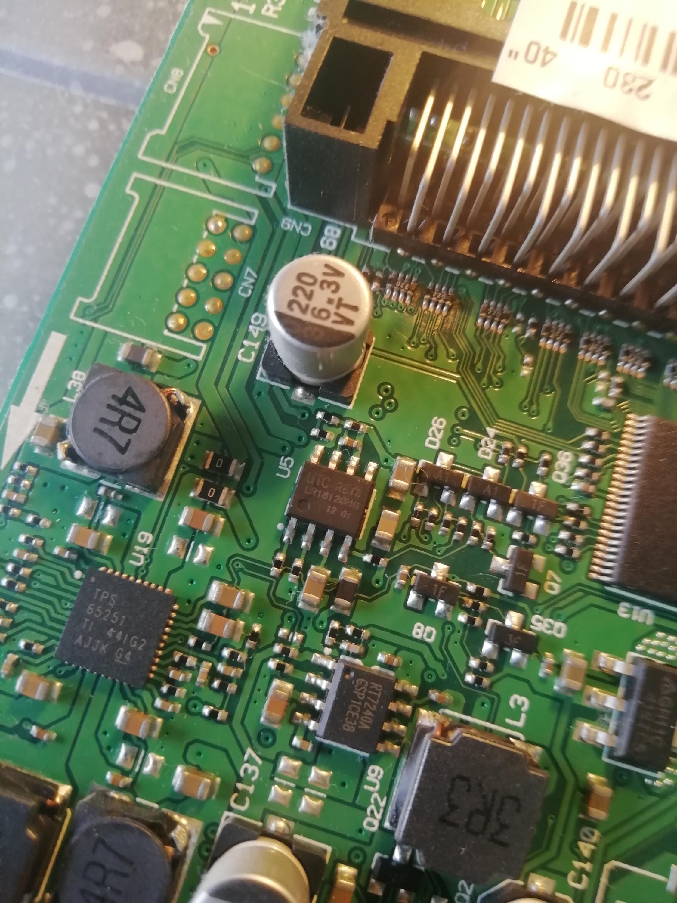

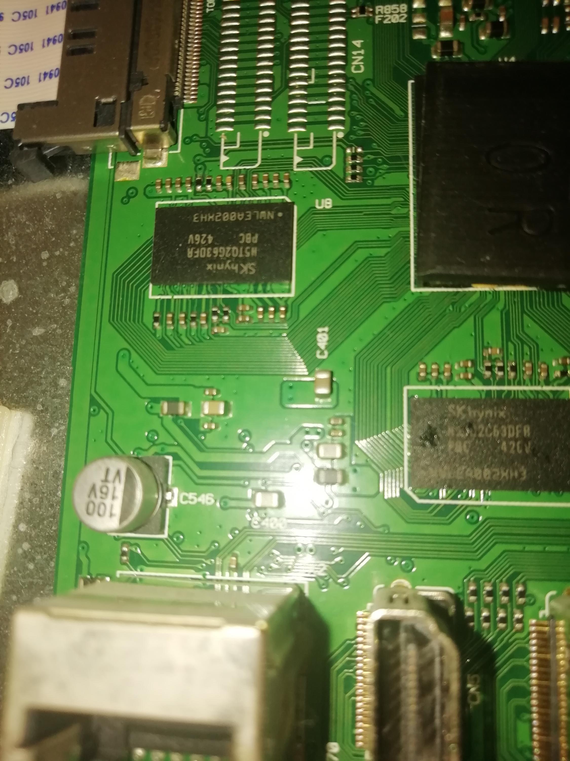

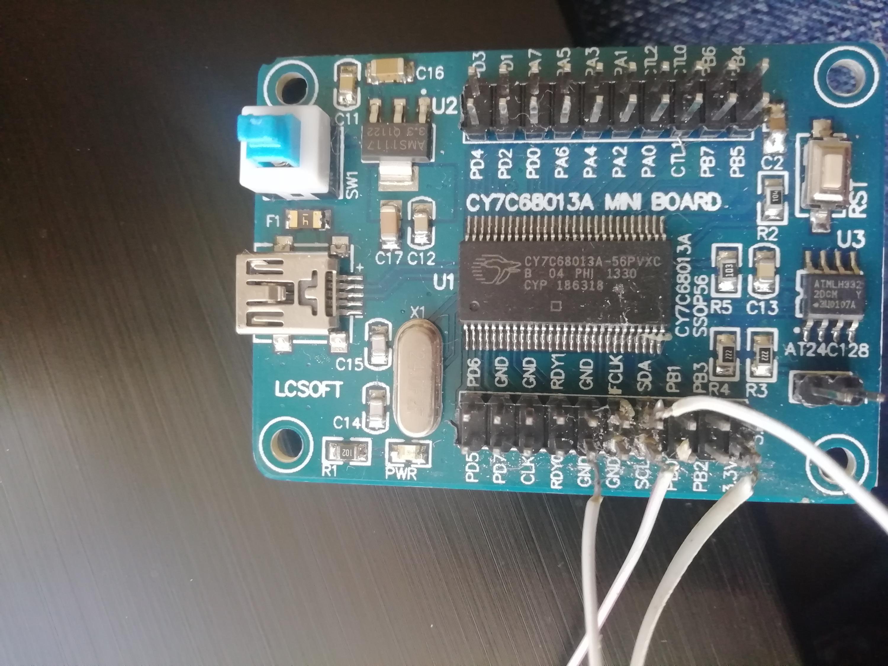

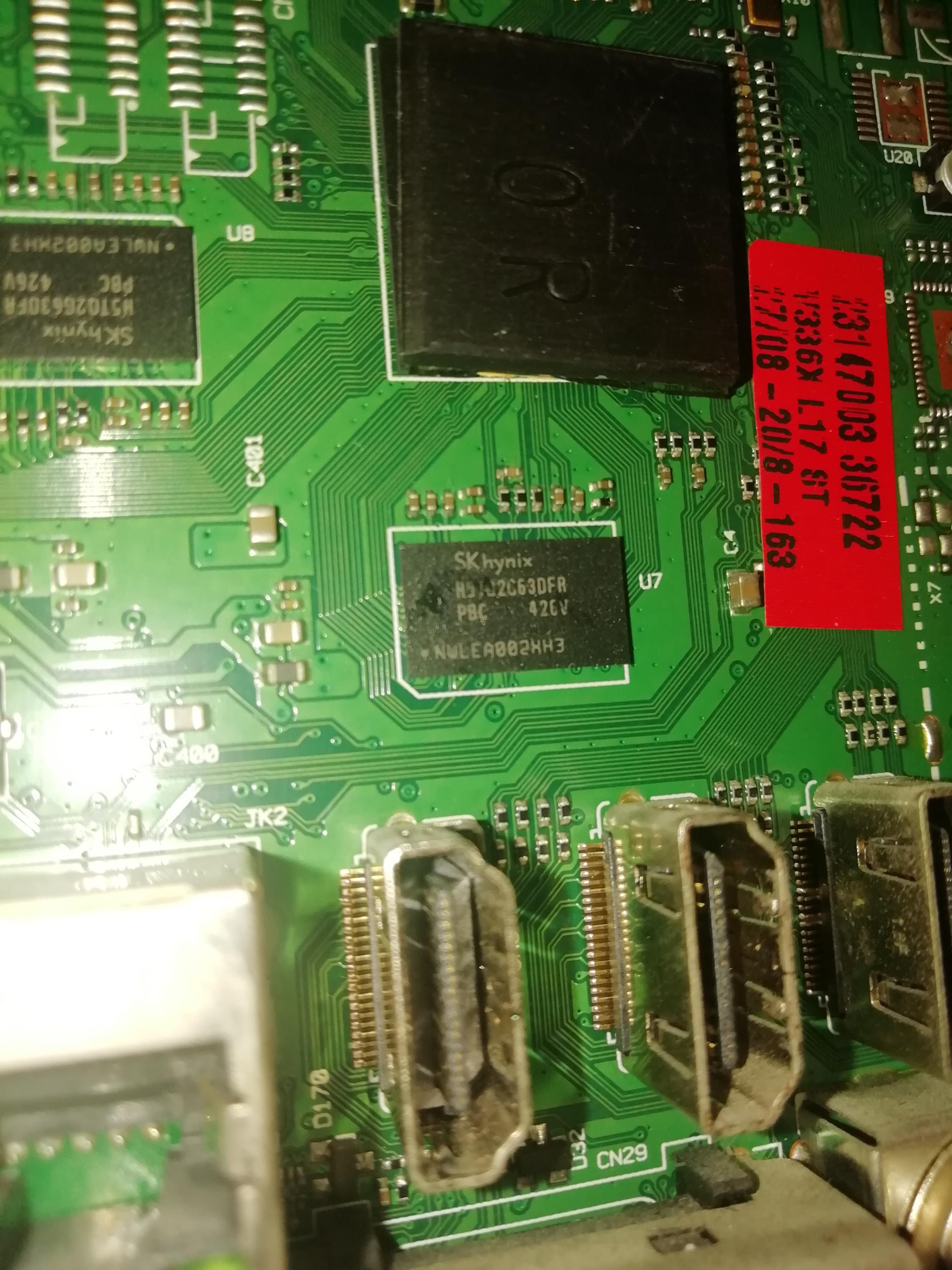

TOSHIBA 40L3453DB red-green blinking light
  • Diah
    replied
    Re: TOSHIBA 40L3453DB red-green blinking light
    Originally posted by Fergal22 View Post
    This is what i have, is it of any use for anything nowadays?
    I will buy the
    CH341A 24 25 Series kit
    yes of course it did but need software interface to do this job.
    yes CH341A more easy specially with clip also it can be used as programmer and serial USB to TTL too for tracing log, also you can use it afuture to program mini Arduino too with mini OLED (1$ panel ) .. it make more fun and good start to learning somethings new.
    Leave a comment:
  • Fergal22
    replied
    Re: TOSHIBA 40L3453DB red-green blinking light
    Originally posted by Diah View Post
    then you can use the CY7C68013A LOL or its model which cant be writing .bin file
    This is what i have, is it of any use for anything nowadays?
    I will buy the
    CH341A 24 25 Series kit
    Is ths the main board to get if i cannot fix it buy re programming it
    https://www.ebay.co.uk/itm/MAIN-BOAR...8AAOSwGvZf-D5K
    Last edited by Fergal22; 02-16-2021, 09:26 AM.
    Leave a comment:
  • Diah
    replied
    Re: TOSHIBA 40L3453DB red-green blinking light
    Originally posted by Fergal22 View Post
    I will buy the programmer and learn as it gives me something to do, i will start to read up about it while i wait for it to come and If it don't work i can always buy a mainboard
    I still have a CY7C68013A Mini board which i used many years ago to bring VU+ clone sat boxes back to life, only used in 2 times and its been gathering dust in the draw ever since as they put paid to that way of watching P*rate tv
    then you can use the CY7C68013A LOL or its model which cant be writing .bin file
    Last edited by Diah; 02-16-2021, 09:04 AM.
    Leave a comment:
  • Fergal22
    replied
    Re: TOSHIBA 40L3453DB red-green blinking light
    Originally posted by Diah View Post
    the cheaper one to you include the clip and no extra fee for shipment..
    for example
    you need to consider 2 option
    1- you start to repair it your self and this mainboards will be good candidate to learn with programming .. or
    2- easy way you buy one used mainboards with 10 more extra as same to yours or where you can upgrade yours Toshiba model with one had SAT tuner if you like... all ab to you
    I will buy the programmer and learn as it gives me something to do, i will start to read up about it while i wait for it to come and If it don't work i can always buy a mainboard
    I still have a CY7C68013A Mini board which i used many years ago to bring VU+ clone sat boxes back to life, only used in 2 times and its been gathering dust in the draw ever since as they put paid to that way of watching P*rate tv
    Leave a comment:
  • Diah
    replied
    Re: TOSHIBA 40L3453DB red-green blinking light
    the cheaper one to you include the clip and no extra fee for shipment..
    for example
    you need to consider 2 option
    1- you start to repair it your self and this mainboards will be good candidate to learn with programming .. or
    2- easy way you buy one used mainboards with 10 more extra as same to yours or where you can upgrade yours Toshiba model with one had SAT tuner if you like... all ab to you
    Leave a comment:
  • Fergal22
    replied
    Re: TOSHIBA 40L3453DB red-green blinking light
    Originally posted by Diah View Post
    the 2 file attached need to flash them direct to the U10, by using cheap CH341A programmer adapter and One Clip for 8 pins.
    the mega file you can do it as you did before by because no response from RC so need to use the side panel..
    Could you recommend which one to get as there are a few different ones on ebay if you don't mind
    https://www.ebay.co.uk/sch/i.html?_f...sPageName=GSTL
    Leave a comment:
  • Diah
    replied
    Re: TOSHIBA 40L3453DB red-green blinking light
    Originally posted by Fergal22 View Post
    Hi thanks for all your help so far, which one do i try first and is it the same procedure as before
    usb stick in then power on tv while holding ok button until i see something happening?
    the 2 file attached need to flash them direct to the U10, by using cheap CH341A programmer adapter and One Clip for 8 pins.
    the mega file you can do it as you did before by because no response from RC so need to use the side panel..
    Leave a comment:
  • Fergal22
    replied
    Re: TOSHIBA 40L3453DB red-green blinking light
    Originally posted by Diah View Post
    yes this one 25L606E, the other NO no need. you need to reprogram it because its now erased or corrupted when you did the flash so tv doesn't boot
    i am putting here dumps for this 17mb95 with vestel panel.. could be help and make it booting again... and also one complete firmware which its include the file of this chip need to try too by using the side panel key of the tv
    Note. if any other users have dump please share too to this threat.
    Mega download
    Hi thanks for all your help so far, which one do i try first and is it the same procedure as before
    usb stick in then power on tv while holding ok button until i see something happening?
    Leave a comment:
  • Diah
    replied
    Re: TOSHIBA 40L3453DB red-green blinking light
    Originally posted by Fergal22 View Post
    ok i found the little bugga, it was on the other side of the board
    U10
    25L1606E
    ?21-126...................i cannot make out what character the ? is
    30797900
    K142072
    yes this one 25L606E, the other NO no need. you need to reprogram it because its now erased or corrupted when you did the flash so tv doesn't boot
    i am putting here dumps for this 17mb95 with vestel panel.. could be help and make it booting again... and also one complete firmware which its include the file of this chip need to try too by using the side panel key of the tv
    Note. if any other users have dump please share too to this threat.
    Mega download
    Leave a comment:
  • Fergal22
    replied
    Re: TOSHIBA 40L3453DB red-green blinking light
    Also the number on the board is
    17MB95
    R3 050413
    Leave a comment:
  • Fergal22
    replied
    Re: TOSHIBA 40L3453DB red-green blinking light
    ok i found the little bugga, it was on the other side of the board
    U10
    25L1606E
    ?21-126...................i cannot make out what character the ? is
    30797900
    K142072
    Leave a comment:
  • Diah
    replied
    Re: TOSHIBA 40L3453DB red-green blinking light
    look under the cover of CI module if you find it or the downside of the boards .. and tell me under the 17mb95 you have another No
    Last edited by Diah; 02-16-2021, 06:39 AM.
    Leave a comment:
  • Fergal22
    replied
    Re: TOSHIBA 40L3453DB red-green blinking light
    I found U20 but there is no chip on it plus it has more than 8 pads were a chip would be soldered on there
    I managed to get what was on chip U5
    UTC RET8 (I think its an 8)
    LR18120MB
    12 01
    there are no other chips with 8 legs on the board anywhere
    Leave a comment:
  • Diah
    replied
    Re: TOSHIBA 40L3453DB red-green blinking light
    check again it should had label with 25L1606 or some things ells after L
    Leave a comment:
  • Fergal22
    replied
    Re: TOSHIBA 40L3453DB red-green blinking light
    There is no u10, there is a U9 with this on it
    RT7240A
    GSPICE38
    There is another 8 leg chip by it (U5) but its very hard to make out what it says on it
    Leave a comment:
  • Fergal22
    replied
    Re: TOSHIBA 40L3453DB red-green blinking light
    Originally posted by Diah View Post
    try the first link to download and play it..
    Hi, I tried the first link firmware a few times and nothing happens, no lights, nothing
    I have added close up pictures of some of the chips in case that helps
    sorry never seen you last post i will do that now
    Leave a comment:
  • Diah
    replied
    Re: TOSHIBA 40L3453DB red-green blinking light
    also look closely on the mainboards... you will have ic chip with 8 pins (SPI FLASH) with label No 25 could you focused photo on it or write its full label over here
    EDIT: should be U10
    Last edited by Diah; 02-16-2021, 05:38 AM.
    Leave a comment:
  • Diah
    replied
    Re: TOSHIBA 40L3453DB red-green blinking light
    try the first link to download and play it..
    Leave a comment:
  • Fergal22
    replied
    Re: TOSHIBA 40L3453DB red-green blinking light
    Originally posted by Diah View Post
    hmm. yours NAND from the Korean Hynix. its sector construction need specific partition.
    its same issue with any other android tv boxes with this type of NAND.
    so what the status you are in now.. ?
    It does not do anything now, it's like its dead
    i have no standby light blinking and no grey screen
    Leave a comment:
  • Diah
    replied
    Re: TOSHIBA 40L3453DB red-green blinking light
    hmm. yours NAND from the Korean Hynix. its sector construction need specific partition.
    its same issue with any other android tv boxes with this type of NAND.
    so what the status you are in now.. ?
    Leave a comment:
